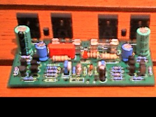

I've just received my boards and am populating the first for webpics. Checking for board problems.

Whoops,
That was it clipped onto my test heatsink. Here's the one showing the thermal sensing BJTs.
Isn't that the best place? Reduces the thermal lag! They regulate the input stage current sources which control the bias current for the output stage.
Greg
Greg
