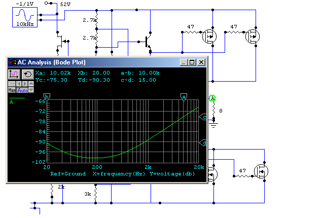

Well Hi to all the gurus, particularly you Mikeks - you keep defending the tired conventional topology of diff pair - Vas - EF/SF now stating it has the least and only minor shortcomings.
When I highlighted the BIG weakness you tell me RC filters are simple solutions. When I say show me 40dB at 20Hz you disappear from the face of the Earth. So, c'mon show us how simply you can get your conventional topology to match/beat the PSRR of my inherently simpler and considerably better PSRR topology. Here's your opportunity... don't just snipe at the sidelines.
Why is it important? Because this is why my little topology, and my previous Eidetic amplifier (140dB PSRR) was SOOOOOoooo superior to the monster amps! It's simply amazing the detail, the width and depth of the soundstage the sheer delicacy and sweetness of the sound - the detail that resurfaces when the miasma of power supply artefacts is not there.
As soon as my 6" monoblock is ready, I'm happy to challenge any ML, Krell, or Classe or any monster amp fairly and squarely, because I know it's chalk and cheese - and I have science on my side! Likely RRP US$499 ready to go.
Oh and Mikeks here it is again, just in case you can't find it -
Greg:smash:

Hi darkfenriz,
This is one approach to take but leads to extra complexity. You can regulate at higher voltage all stages from Vas back but it's an extra supply feed /windings/rectifiers/filter C's/wiring, bridge outputs are doubly complex. You end up with either a simple amp and a complex supply trying to compensate for it or a doubly complex amplifier.
I prefer a wholistic approach considering the amplifier and power supply as one - with a low impedance 'noise' source at each supply line trying to intrude on my signal circuits and cloud the output. The simplest topology that keeps this out is then half the battle won, the rest to achieve performance targets.
Greg
