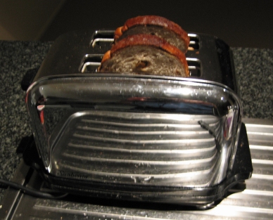

amplifierguru said:I recall jamming a piece of toast in the toaster at 6am one morning with my 1yo daughter sitting in a high chair and running out to pick up the morning paper from the driveway. When I returned the kitchen was full of smoke and the toaster had charred and flamed a jammed piece of toast, searing overhead cupboards. I bought a more expensive safety toaster that day!
Hi toasterguru,
Any advice on toasters. I'm having trouble getting my raisin toast to brown just right. I either burn it or its underdone. I also find the toast doesn't seem hot enough to melt the butter properly. 😉
Just to keep things on topic, I often eat raisin toast while listening to my AKSA (a "simple killer amp" IMHO).
- Simple Killer Amp!
