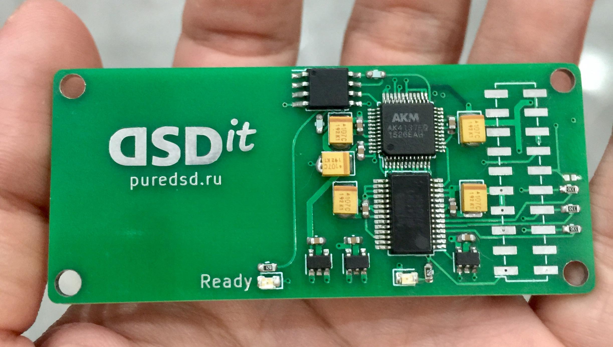

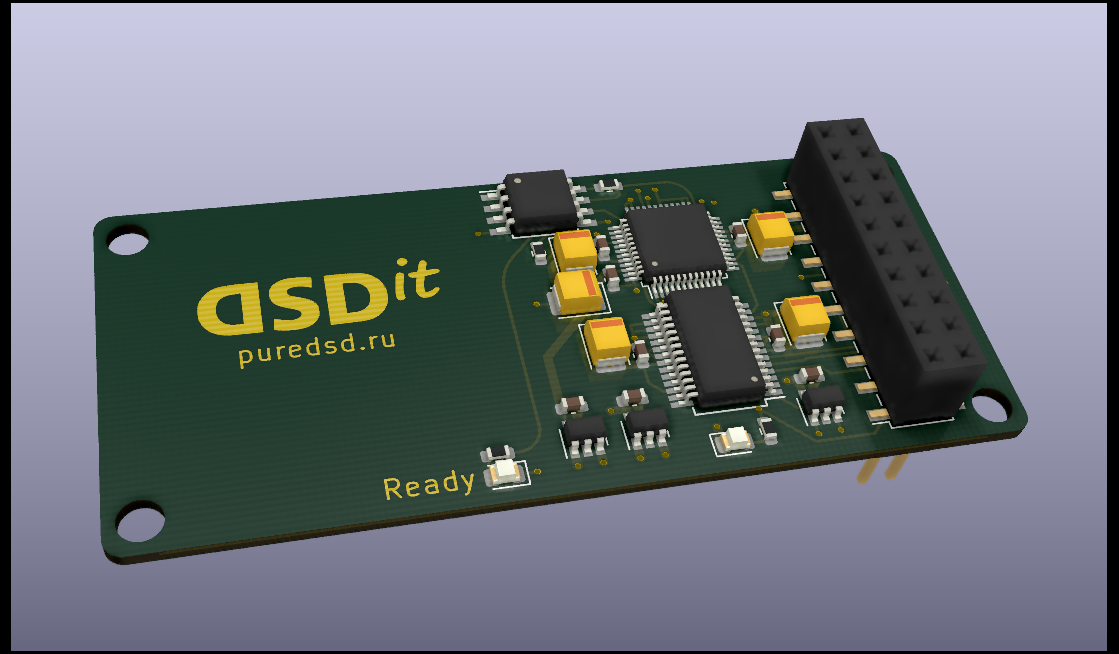

When I commissioned the factory to manufacture the DSD'it SRC4192+AK4137 board, I encountered some troubles. They said they couldn't understand which of these two inductors should be purchased, so the current manufacturing process has stopped, so I need to know the specific values ​​of these two inductors. thank
L_Core_Ferrite_Small L_0603_1608Metric
L_Core_Ferrite_Small L_7.3x7.3_H4.5

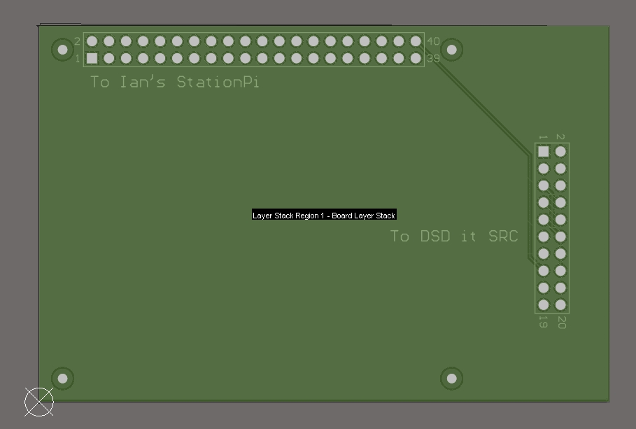

According to the original design of the DSDit SRC board, it is to provide the DSD signal required by the DSC dac. However, the conversion board I designed by myself can connect the I2S signal output by the DSDit SRC board to Ian's Reclock.
However, no matter what kind of DAC can accept I2S signals, of course it includes the I2S signals of the DSDit SRC board, but you need to find a way to correctly connect the I2S output of the DSDit SRC board and the I2S input of any DAC.

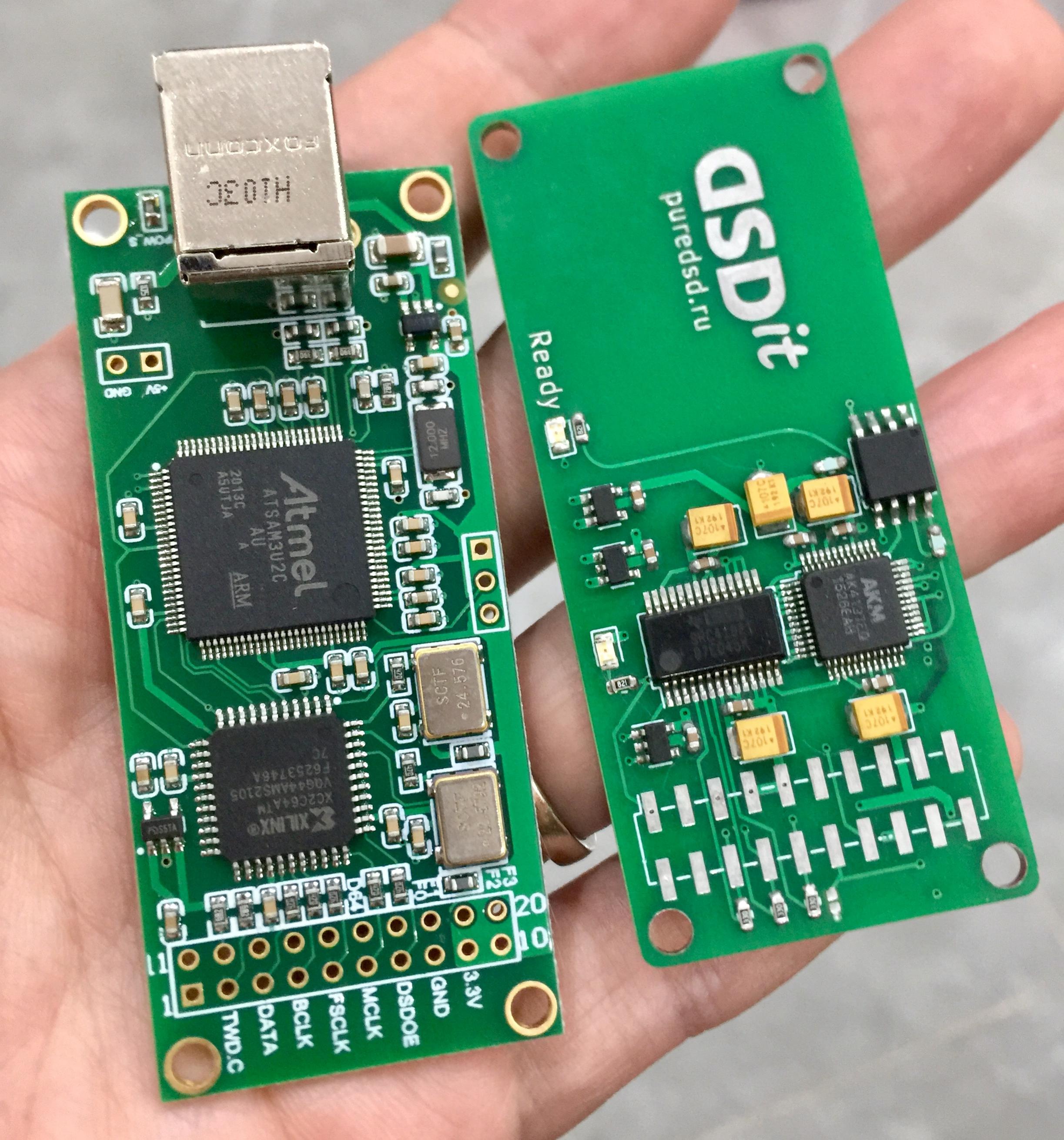

Just done soldering the board.. this will be for the DSC2 DAC with tube output stage.
