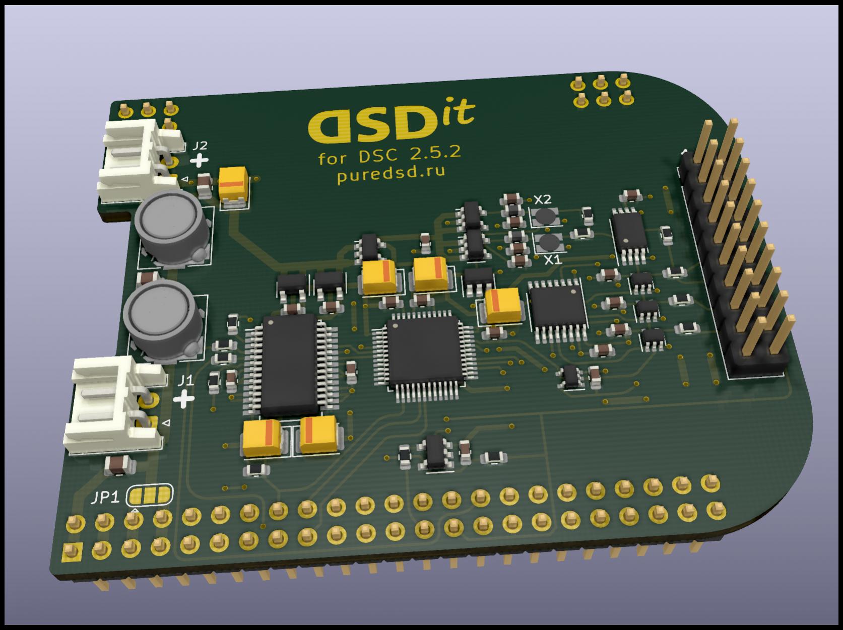

I take my words back. SRC4192+AK4137 sounds very good.
The problem was with the fake SRC4192 chip. The donor was a board purchased in China on Aliexpress. After I bought the chip from a reputable supplier, everything fell into place.

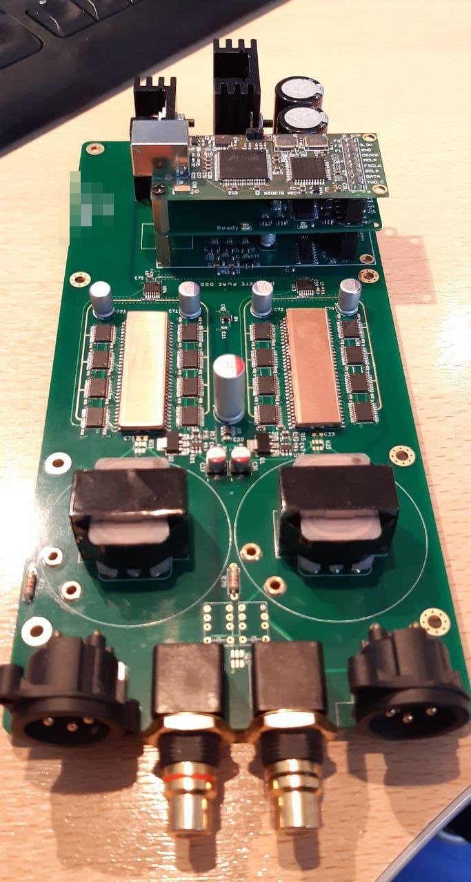

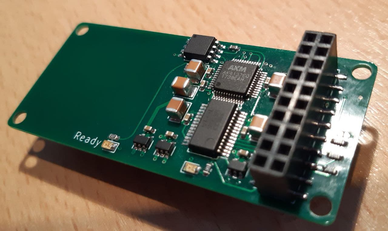

I made a mini version of DSD'it for Amanero in slave mode. And I am very pleased with the result.
I can't hear the DSC2 murmur on the test tracks. In the 2xAK4137 variant, murmur can sometimes be heard.

Hi pavel,
it will be something for public release ?
i am interested to listen to the new DSC you showed in the photos...
the fact that you blurred the silkscreen led me thing it would fit some "commercial" products... so my hope is very short 🙁

I would publish all my developments. But now not everything depends on my desire.
Yes, indeed, there will be a commercial project of a finished device soon. But what you saw in the photo is just a prototype. The design of the finished product will be different.

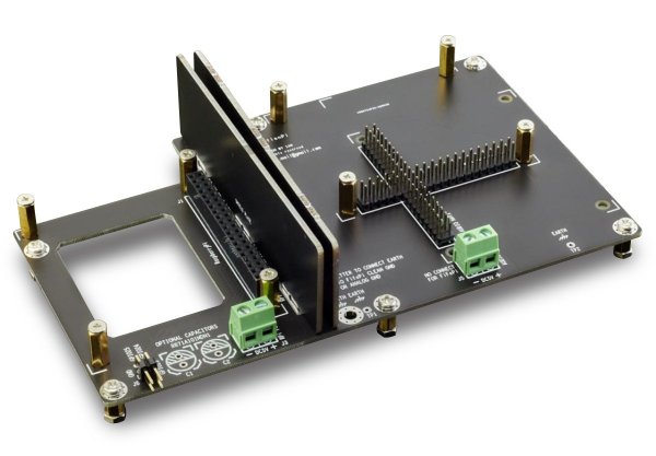

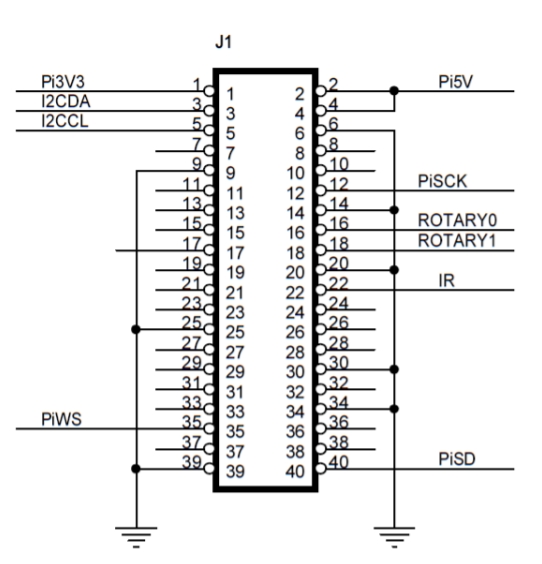

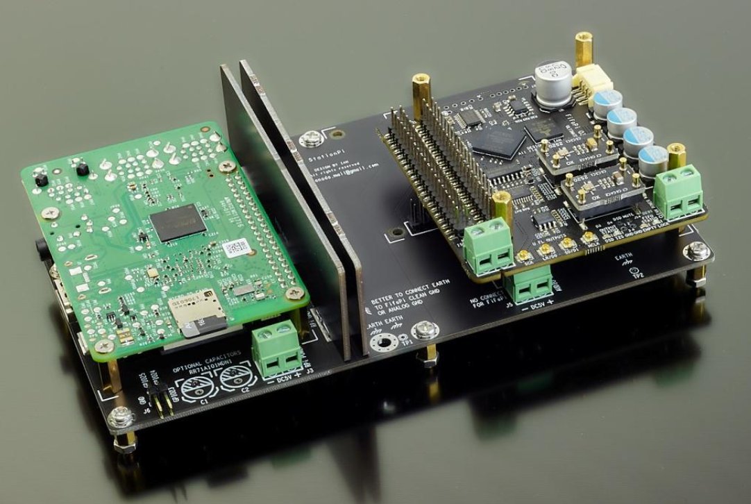

I thought of an easier solution. I designed a conversion board between your SRC board and Ian's STATIONPI, so that the I2S output of your SRC board can be passed to Ian's reclock via STATIONPI. If I am right, I only need to pass the LRCK, DSDCLK, and DATA output from J4 of your SRC board to PiWS (LRCK), PiSCK (SCK), PiSD (DATA) of J1 of Ian's STATIONPI respectively. This should be correct, right?
