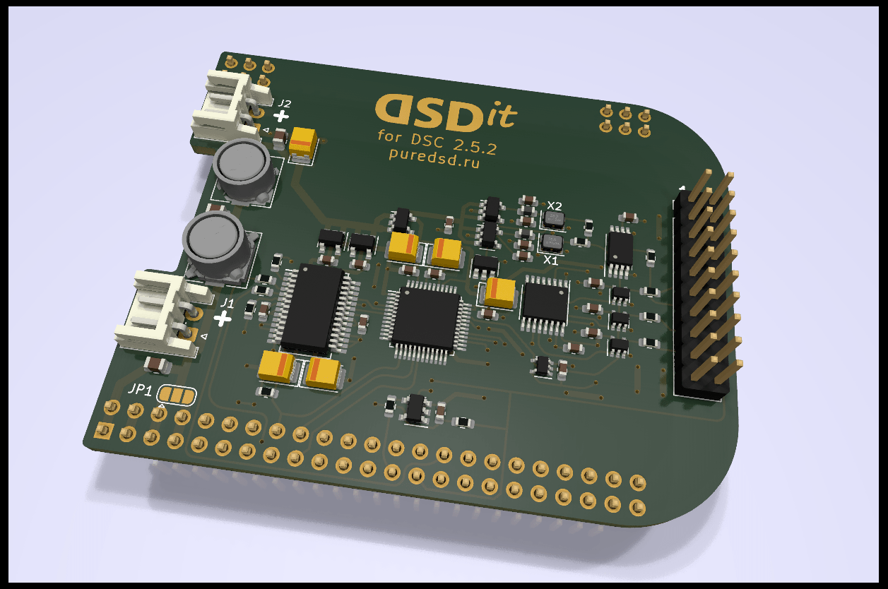

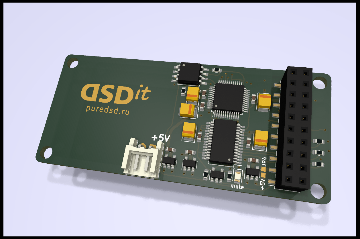

Simple DSD SRC for BeagleBone
I updated the DSD'it versions. A complete set of documentation always available at http:://puredsd.ru

Anyway, I ordered a small batch of PCBs for the new version of DSD'it last evening. I remembered just how difficult it is to solder the NKD oscillators so I ordered an SMD stencil too with the intention of asking my friend to solder the boards in his reflow oven.

Hi @ppy,
Thanks so much for publishing DSD’it. I own a AK4499EQ DAC and would love to build one. As I’m studying the documentation, a couple of questions and perhaps suggestions:
Questions:
  1. How does the 44-48 signal relate to Cable_Plugged? I understand to forward Cable_Plugged from J1.1 to J4.1. But why have J3 to instead forward the U5 output for a XING U30? I also understand that U5 outputs whether the signal is an integer multiple of 44.1 or 48 kHz, but how does this relate to Cable_Plugged? From the U30 datasheet I believe that it too has Cable_Plugged on pin 1.
  2. C2 and C3 are the decoupling capacitors together with C4 and C8, right? The SRC4392 datasheet suggests 10 uF for them; in this BOM they are 100 uF. Is this on purpose?
  3. The AK4137 data sheets suggests to use two sets of decoupling capacitors, one on both of the DVDD pins: 0.1 uF || 10 uF. This seems distinct from this design with one set of 0.1 uF C19 || 100 uF C21. Is this on purpose?
  4. Same and final question on the decoupling capacitors 🙂 suggested values for C9 and C10 are 10 uF, but the BOM specifies 100 uF.
  5. Could the startup time be improved? What is the wait for 3 seconds beginning of setup and 1 second after writing the configuration? From the datasheets it seems that the AK4137 starts in 5 ms maximum and the SRC4392 in less than that. This is also the minimum interval between I2C writes.
Suggestions:
  1. Per the SRC4392 datasheet, the RDY signal could be used to set the MUTE signal. This could prevent pops and clicks when the input sample rate changes. U4 could be replaced with a gate with 3 inputs.
  2. When DSD_on is high, the SRC4192 and AK4137 could be powered down to save power, decrease heat dissipation and increase lifetime. An PNP transistor could be used with DSD_on at its base and RST as emitter.
  3. The AK4137 datasheet suggests for a microcontroller to cycle PDN immediately when SRCEN is high, indicating over-current or over-voltage was detected. SRCEN could be connected to PB4. I can write the necessary Arduino code if you’d like.
  4. The AK4137 datasheet also indicates to leave XTO open instead of connected to DVSS. Looking at datasheet figure 21 it may now draw more current than necessary, which may induce jitter on the side of the clock.
  5. On the AK4137, disable semi-auto soft mute. It seems redundant with the manual mute logic in place, which is more accurate. Also from the datasheet it is not entirely clear to me whether enabling the bit makes it follow the SMSEMI pin, which is pulled low anyway.
  6. On the AK4137, enable FORCESTB to disable checking for IRCK and OLRCK changes. ILRCK won’t change for sure, and I don’t think OLRCK would either even in slave mode.
@Markw4 I too fancy I2SoverUSB boards for their galvanic isolation and optional clock upgrade board. It should improve the audio quality, as lower noise-induced jitter will mean that the SRC4192 can keep its resampling coefficients more stable. Am I right that the DSD'it jumper configuration for Amanero master should work fine? As the 45/49 MHz oscillators on the I2SoverUSB are divided into 22/24 MHz.

Questions:
This project was made a very long time ago. Much has already been forgotten. I will only answer what I remember without diving back into this project.
1. The board design was developed for Amanero. Pin 1 there can be assigned to switch 44-48. U30 can use F0 and DSDon signal. But the circuit board needs to be modified.
2. I used my favorite and sound tested KEMET T520B107M006ATE040 tantalum polymer capacitors.
5. I don't remember anymore. There was a reason for this, but now I find it difficult to answer.
