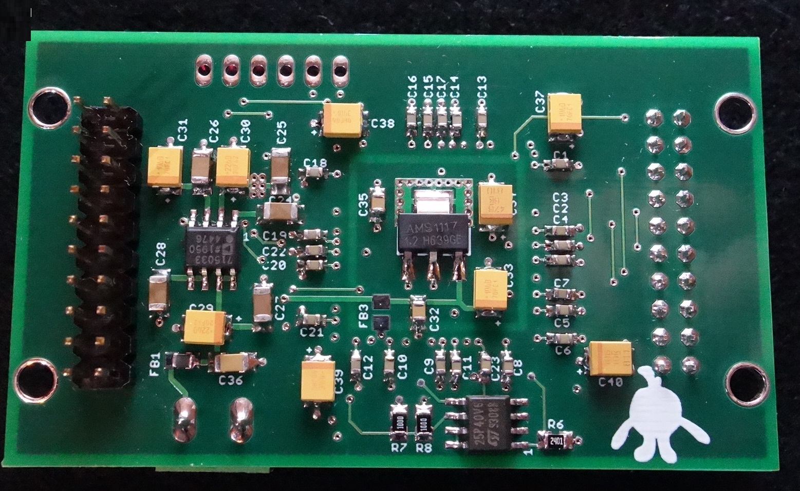

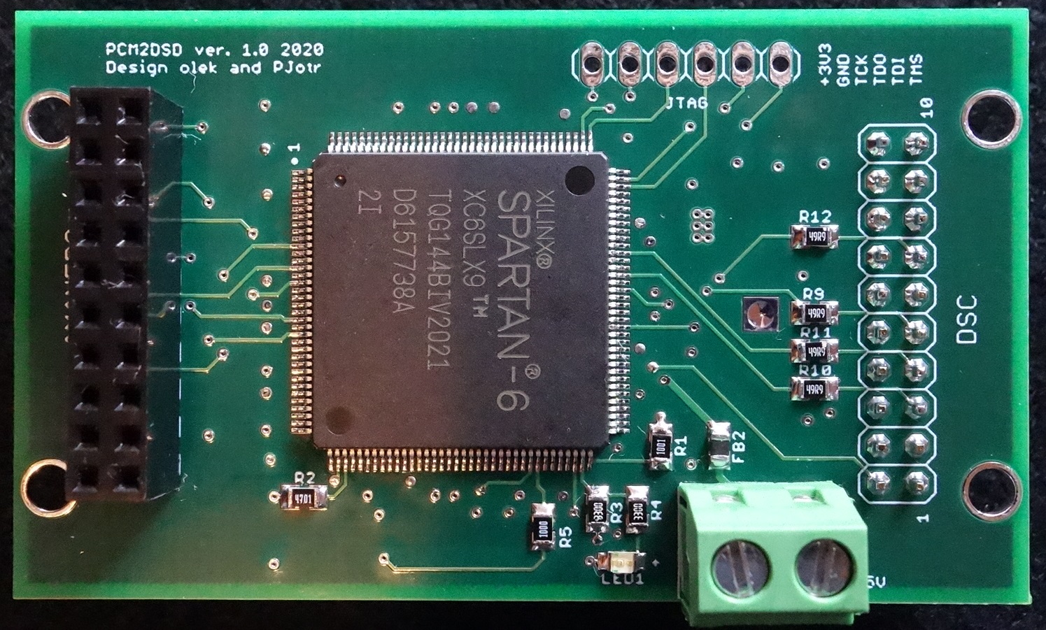

Do you know if someone can do the same job as AK4137 with FPGA?
Yes.
I have done this with my friend PJotr.
This little board has an i2s/dsd input (Amanero style). Dsd is passed thru unchanged, PCM up to 24/192 is converted to a DSD256 stream via upsampler and sigma delta 7th order 1-bit modulator.
Output connector fits perfectly to the dsc board.
Currently I'm working on an RTZ version of the dsc.

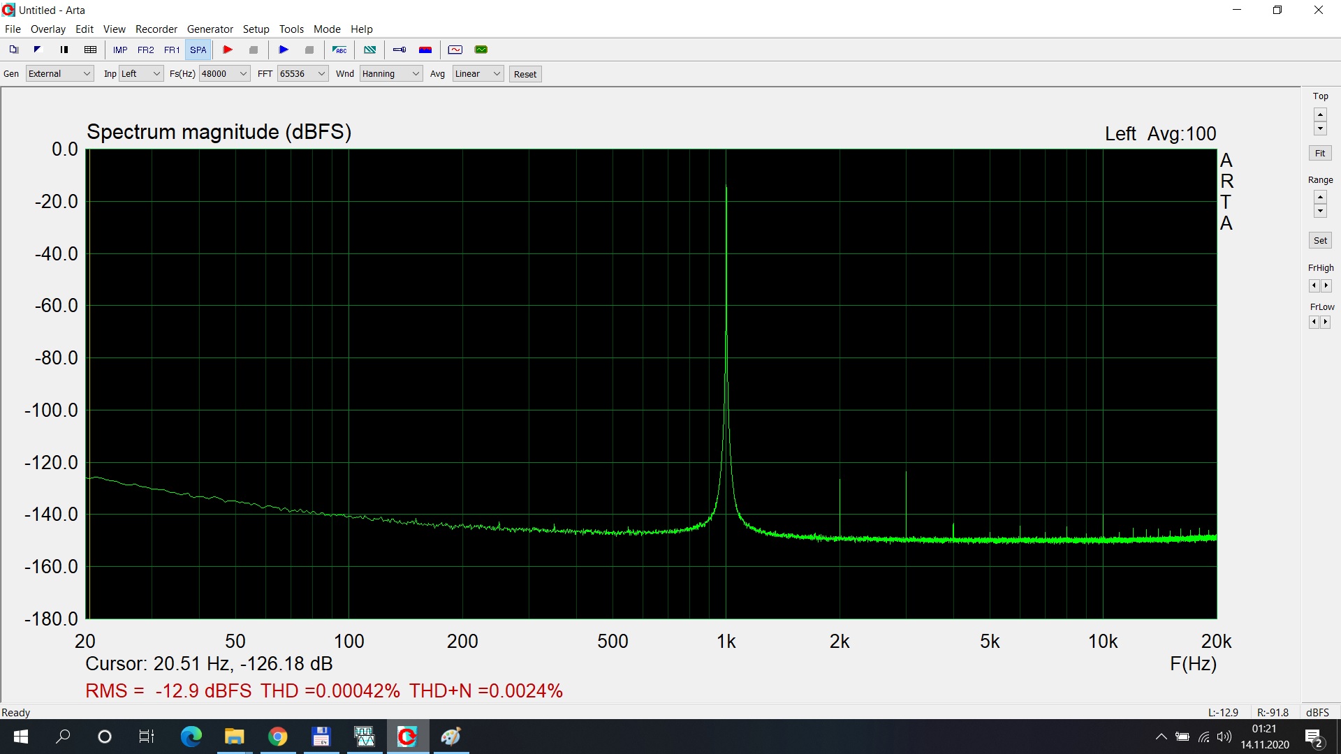

How does it sound? How does it measure?
The sound is comparable to HQPlayer, so is not bad. I'm quite happy with the results. It measures like ordinary dsc.
Cool that you managed to squeeze it all into an XC6SLX9! I had difficulty enough fitting everything into an XC6SLX45.
This is much simpler project than Valve DAC
Main trick is that I'm using CSD arithmetics, so there is no multipliers in the modulator. Long carry chain path is the limit.
