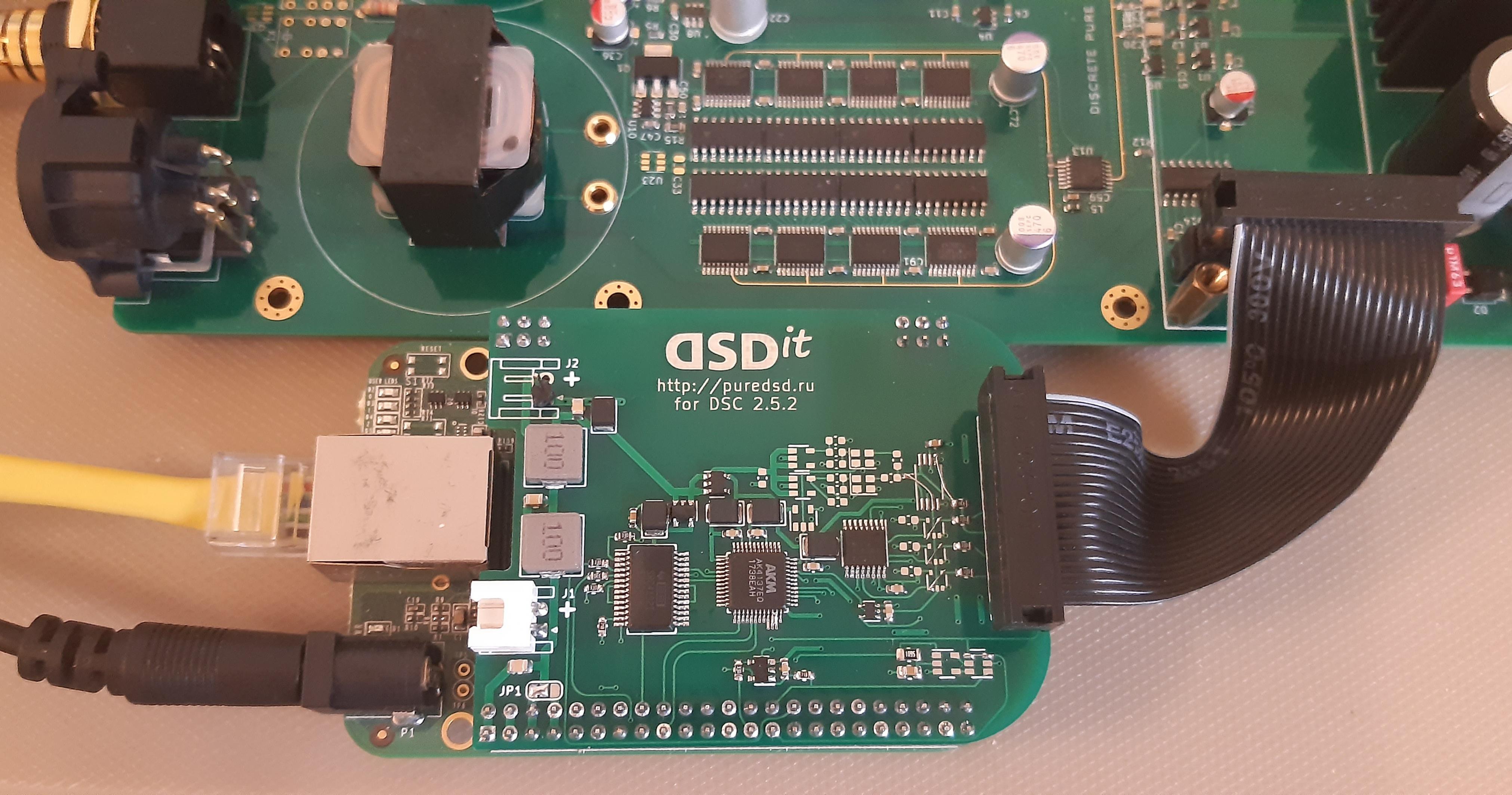

In an experiment, SRC4392 was compared audibly against AK4137. The former would be my 2nd choice, but its quite close in sound to AK4137 for upsmapling. Could be they have a little bit different filter designs, and or they behave a little differently in the presence of low level incoming jitter.
Made a DSD'it layout with the first stage on SRC4192.
Sounds a little worse than on two AK4137s.
I noticed that the SRC4192 makes a lot of noise on the ~ 45mV power bus. You need to think carefully about the topology and power supply.
But there is good news as well. Switching DSD<->PCM without clicks.
