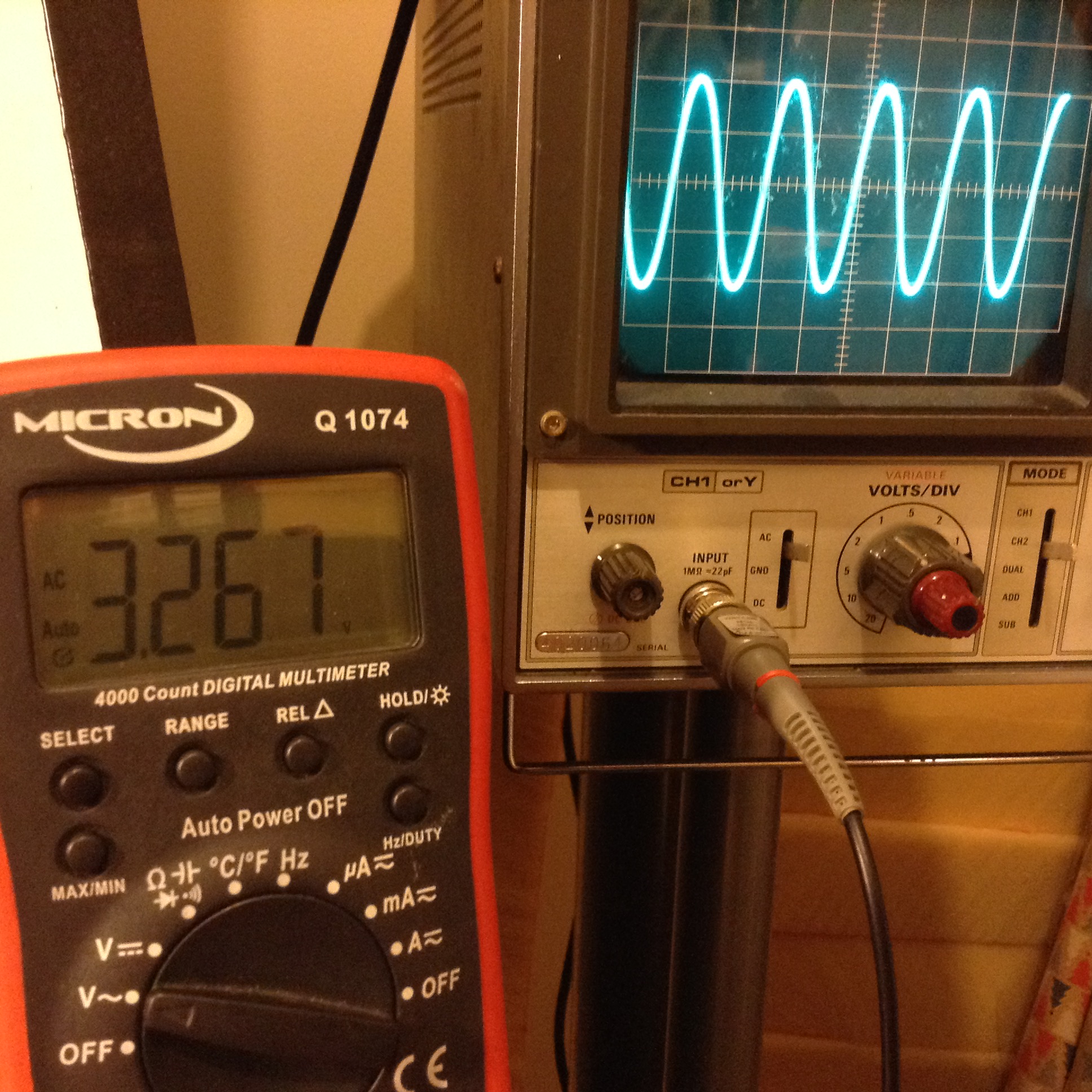

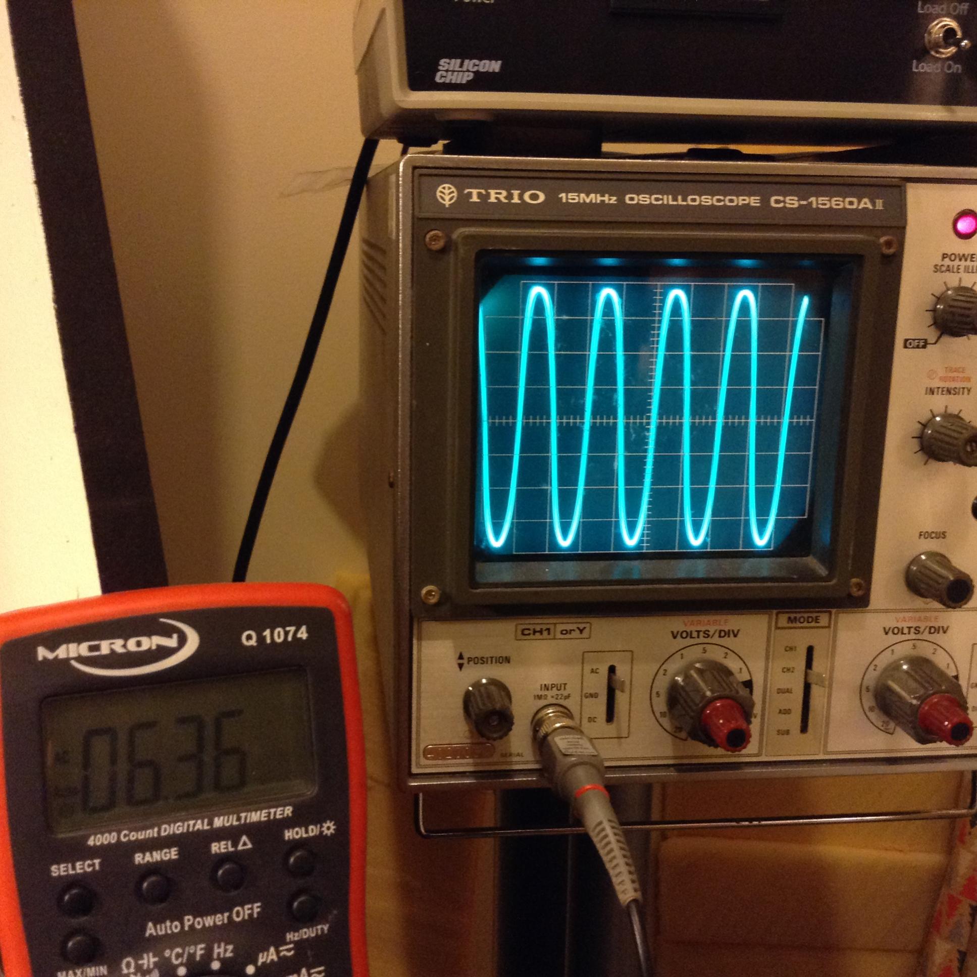

Here some actual screenshots with the amp operating into a 10 ohm resistor.
The amp is as per the amendment original schematic with the 2.2k MOSFET bias resistor replaced with a 2.7k resistor. Frequency is 1kH. Channel 2 is shows.
Pic 1 is befor clipping and is close to 4 watt on the output. Pic 2 is at around 50% before clipping and 1 watt output (no problem for my 99 dB full range speaker).

4W and 10r load is equivalent to 894mApk and 8.94Vpk (17.9Vpp)
That shows that you have current clipping @ about 0.9Apk but you have only used 36% of the 50Vdc supply rail.
The amp is set up to work into ~24ohms loads due to the low bias current setting.
If you want to drive loads <<24ohms you need to increase the bias current. Heatsinking will probably become your upper limit before you get to 2.5A of bias current.
To save heat you can reduce your supply voltage. That would allow you to use more of your available voltage swing.
then at the new lower supply voltage you can increase the output bias current.
That then allows a better balance between current clipping and voltage clipping.
Try 40Vdc and 1.5A bias. See if your heatsink is big enough.

Thanks Andrew.
I have learnt a lot by following your thought process.
I have upped my bias current to 1.8 amp by reduce the load resistor down to 19 ohm, Vdc is still 50V. I adjusted the bias resistors accordingly and get now closer to 6 Watts output. The heat sink can handle the load.
If I am not mistaken, I have increased my swing usage to 44%.

Want to judge distortion on a scope, double the horizontal frequency so you see only two complete sine wave. Your 4W picture doesn't have to clip, it's already heavily distorted. My choke loaded example above running on a 19.5V 6A HP laptop supply, minus 4V for the cap multiplier. The idle current is 1.85A for the SemiSouth JFet and producing close to 10W into 8 Ohm, half of the power consumption what you can achieve with a resistor load. Meaning it is greener and needs less heatsinking. The distortion is much better what one can get out of a class A tube output stage, and the bandwidth is around 250kHz with those cheap Hammond chokes. Almost unbeatable combination for a small room, with a good quality bookshelf spkr + a sub.

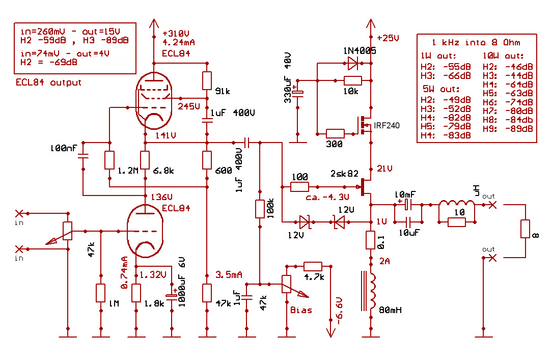

The DC choke has very low DC resistance, so the power dissipated on it is low.
The schematic shows an earlier version of the same principle.
It has a bigger choke ,uses the Sony 2SK82 VFet and the Russian version of the ECL84 triode/pentode Mu stage as the driver. Either the HMN or this MU stage would be able to drive the inexpensive IRF240 MOS Fet to. Both can deliver up to 10V clean signal for the output Fet. The 0.1 Ohm series with the choke is for to measure the idle current.

Currently more than one project is going on Diyaudio with it, one of them from Nelson Pass.
Google sk82 or vfet, an obsolete Sony VFet, but you can use the IRF240 instead. Eventually you also could use the 2SJ18, with opposite polarity on the power and bias supply, but it has lower power rating.

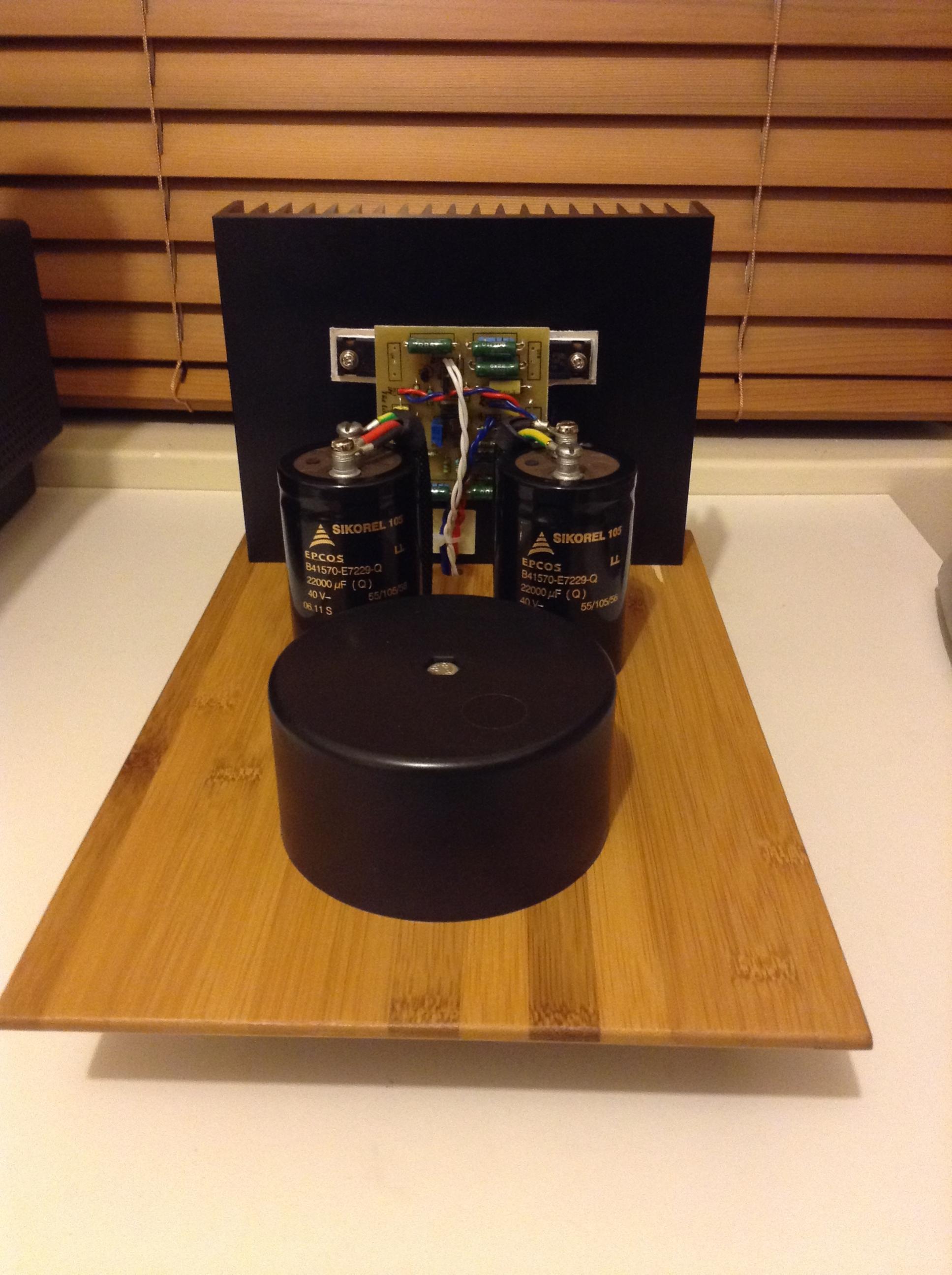

Same for me, this 20W Class A mono block runs at 75C without extra cooling like in this picture. I made provisions to plug in a 24Vdc fan and with that strapped to it it stays at a balmy 45C. Work in progress.

Glossmaster,
Nice amp you have there. I like bamboo cutting board as main structure. Which 20W class A design is that?
