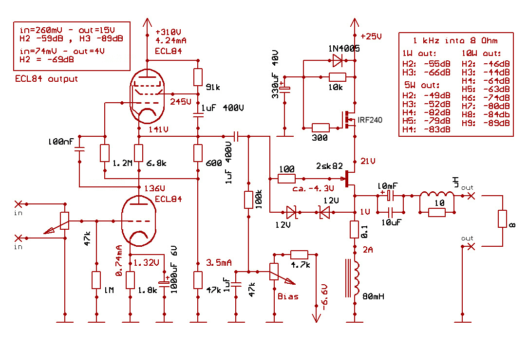

Interesting circuit, I would recommend considering a bootstrapped cascode though. Output FET capacitance is already reduced by the regular cascode, but input stage quiescent current still isn't very much to write home about, so further reduction would certainly be appreciated in the interest of high-frequency distortion.
I'd also consider going for a gyrator or adjustable current source instead of the choke. 80 mH @ 2 A (comfortably) doesn't sound cheap or small.

It has a bigger choke ,uses the Sony 2SK82 VFet and the Russian version of the ECL84 triode/pentode Mu stage as the driver. Either the HMN or this MU stage would be able to drive the inexpensive IRF240 MOS Fet to. Both can deliver up to 10V clean signal for the output Fet. The 0.1 Ohm series with the choke is for to measure the idle current.

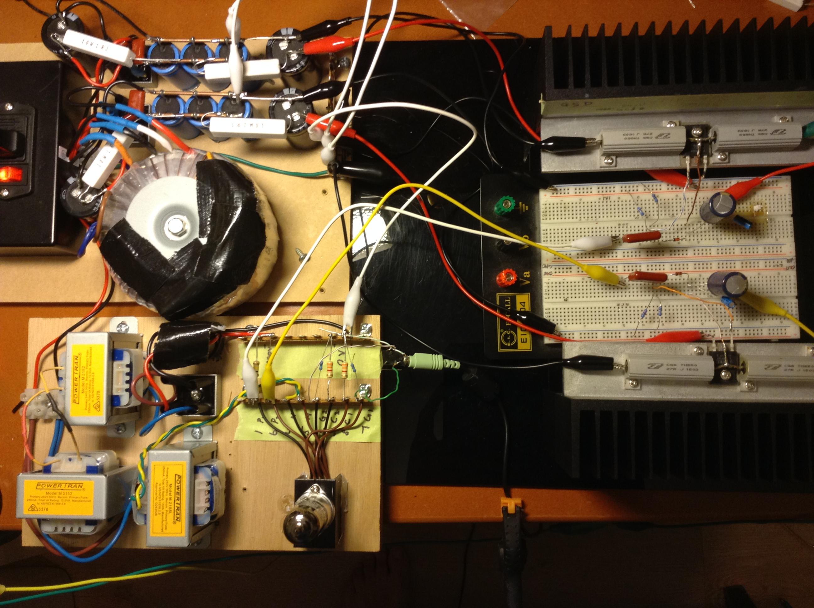

I am in the process of beefing up my power supply for the Hybrid. I increased the bias current to 2.5 Amp as suggested by Andrew T. I paralleled two 27R 50W resistors for a 13.3 load but the 5 A draw for the two channels is a bit much on the current setup. Lucky I have a bigger transformer in my draw.

5A of current draw for the two channels requires a massive transformer.
The absolute minimum is one rated @ 10Aac, but his ends up running the transformer at maximum rated output and it will run hot.
I suggest you use a transformer rated at 20Aac for a 5Adc continuous current draw.

Beefed up power supply ready.
Rail is at 43Vdc, bias current 2A, load resistor is now 13R, power out 6w measured against a 10R resistor.
Base has segnificantly increased to a point where I replaced the output cap to 1000uF down from 4700nF to suit my ZU's.
I might look into implementing a 200V supply for the tube to get it to operate In a more linear region.

Thank you for your assessment of the amp.
Maybe you could tell me what's wrong with the biasing, it's a filtered, regulated 6.6V supply. The noise on it will appear on the speaker terminal, but it has minimal noise. After power on ,it has to come up faster than the main Low voltage B+.
I'm using the robust 6F4P ,the Russian version of the ECL84. The 6F4P tube pentode section is a CRT driver and can take -150 to +200V between the cathode and the filament. I have built a few of these Mu stages with this tube trough the years and non of them failed yet.

The HMN has lower output impedance and wider bandwidth, but a bit more complicated to build. The advantage is that uses 165V for the high voltage supply, while the 6F4P 320V. The 1W -1dB poit for this 6F4P/SK82 amp is 112kHz.
The price of the chokes , especially the 60mH 2A Hammond one is not much, and since I building it for my self , not for sale, I can take it.

The choke, why do you need the 0.1R in series - is there not enough DCR in the choke ?
Did you try/consider LED bias for the lower triode instead of traditional RC ?

Thanks Bigun.
The 0.1 Ohm is just for the easy measurement of the idle current.
Yes, I considered it, but never got around it in this amp.
I built one i/v amp, for a CD player with red LED in the triode catode and it's working well.

Here is my last update. I paralleled two 50W R27 resistors as a load. I had the bias current at 2 A at one stage but for the sake of the heat generated dropped it back to 1.6 A.
I have been playing around with different bias resistor ratios a bit.
And last but not least for the sake of linearity I just finished implementing a HT supply for the tube (164V on the Plate).

Also wondering if I can use a simple wall wart AC transformer used by small electronics as the fillament heater source? Or I need to whip up an LM317 VR to generate 6.8vdc. Can DC work for the filament or is there some magic to having an AC for the filament heater for it to work? Also need to figure out how to heat sink the sand cast resistors as I know they can get smoking hot. I had a 25w 10ohm one the other day get 25v across it for a few minutes and I accidentally touched - it's like touching the tip of a soldering iron. 🙁
Hehe, no AC magic happening here. It is just a matter of simplicity. I had a transformer with a 6.3V tap handy, as simple as that. You can use a wall wart without a problem. DC is not really required. There are actually builders that only use AC on the driver's filament. Some say DC flattens the dynamics.
I used 5 100R 10W in parallel as a source resistor before I got my hands on the 27R 50W and messured them to be 130C with 2.4A of current running through them.

By the way I hooked up the bread board to my ZU's with the HT supply in place for the 6922.
Oh my! Well worth the 35$ for the parts.
