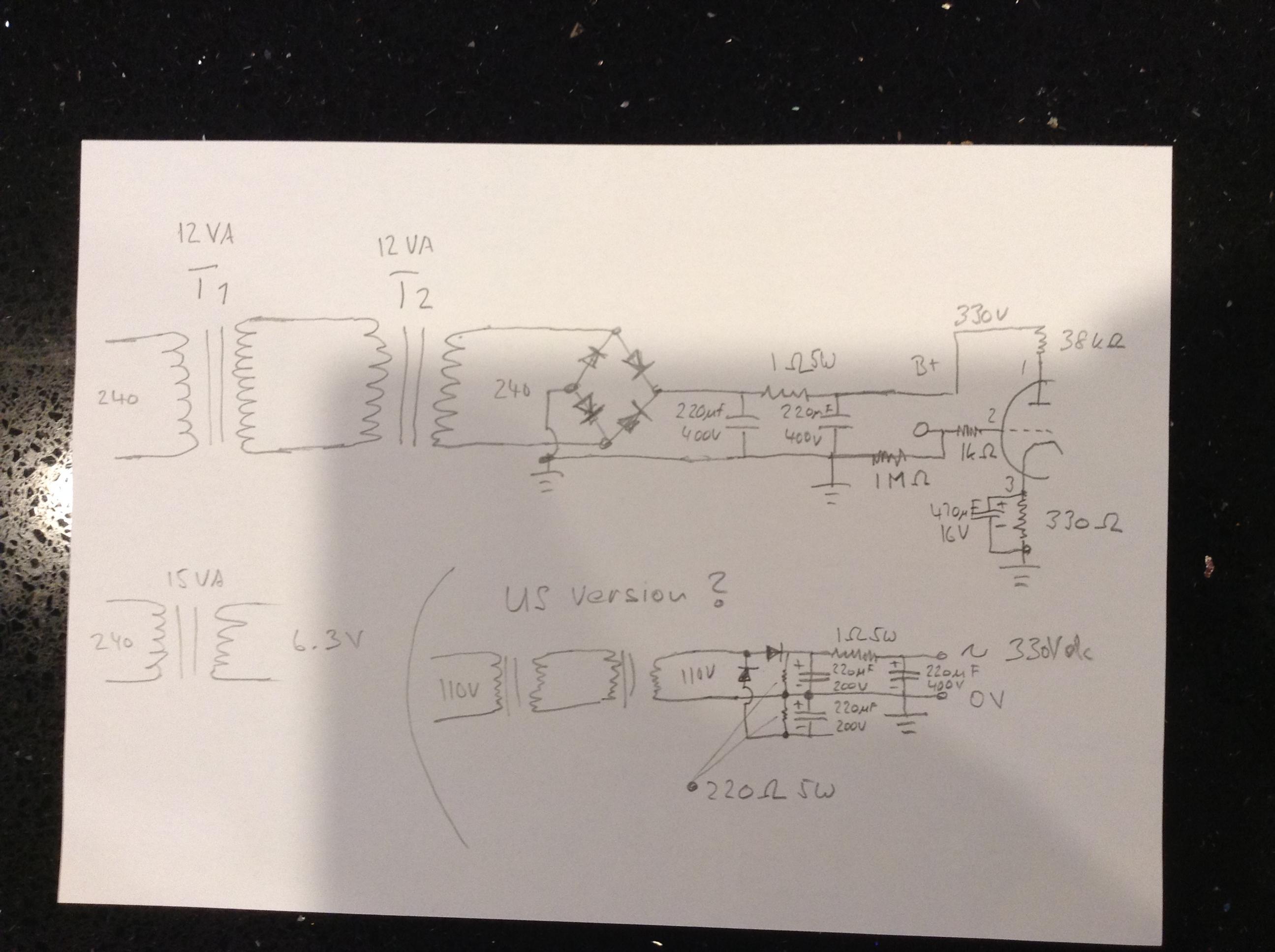

I plan on building the high voltage version (330V B+)of this amp during the coming weekend as I am seriously piqued by the potential of this hybrid amp (and just so happen to have the needed components in my parts bin)
Could anyone advise on a schematic with 1.8A bias for the IRF and 330V B+ for the 6922?

Can you give a rough diagram of the 330v supply? When you say back to back transformer and a doubler do you mean two 58v transformers with outputs in center tap series to get 115, then voltage double to 230v x 1.41= 324v? I have a bunch of 450v mkt 10uF caps. Also several motor start 50uF 450v caps. How many uF's needed and what R value to use in CRC? Would 60uF and 2.2k and 60uF as a filter give me enough current? The B+ doesn't use much current I assume as it's a plate voltage.
I did not use a doubler as we have 240v here down under. I used just back to back transformers and presto,330VDC rectified.
You might have to use a capacitor doubler like on the drawing. Do not fit the resistors parallel to the caps. Values are flexible, except for the voltage.
Resistor values for the tube work for my setup. I forgot to include the cathode bypass capacitor. (470uF 62v)
Did you actually get 330Vdc from your two back to back transformers.

I am not sure what the purpose of the back to back trafo is? You end up with 1:1, why not just use straight line voltage from wall to a doubler?
As far as I know, a back to back trafo configuration should take care of any high frequency content on the power lines.

You don't get 1:1 using back to back transformers.I am not sure what the purpose of the back to back trafo is? You end up with 1:1, why not just use straight line voltage from wall to a doubler?
that's why I asked what input volktage he used and whether he achieved his required 330Vdc.
a 230:12 8% regualtion transformer has an open circuit output of 12* 1.08 Vac Therefore the output voltage is 12.96Vac. The Turns Ratio is 17.747:1
Now put in a back to back and the output voltage with no load on either transformer will be 230Vac input gives 230Vac output.
But load up the transformers and the output will drop to ~197Vac
If one uses 245Vac as the input instead of 230Vac one gets a loaded output of ~210Vac. That would give well short of 330Vac, maybe as low as 296Vac.
The Back to back transformer is for safety. I was not keen on using the 240V out of the socket without isolation..
The B+ when loaded, is 294Vdc, this is plenty for a 6922 as the max Plate voltage is 300Vdc. An avarage plate current of 15mA per side is easily achieved.

It is Xrk that got it wrong by saying 1:1
And your new info stating 294Vdc from the back to back transformers confirms that the two regulation values need to be taken into account.

Don't they make 1:1 isolation transformers for line level output? What do you think of the step up switcher unit?
And what if one uses an 18vac step down connected back to back with 20vac step up - would this offset the regulation losses? These are $10 ea for a 10VA trafo.
http://www.antekinc.com/an-0118-10va-18v-transformer/
http://www.antekinc.com/an-0120-10va-20v-transformer/
Does that lower the final output voltage?
You need a higher turns ratio in the second transformer, i.e. 18:260Vac. But that becomes a special at considerably extra cost.
The idea of a single 1:1 (230:230Vac) isolation transformer is better.
Or find a standard high voltage transformer that is rated for the current and voltage that is required.
I like single isolation better too. I think Inhad it flipped around 20vac first then 18vac second.
