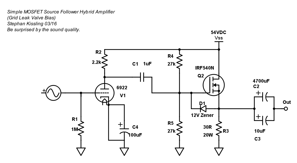

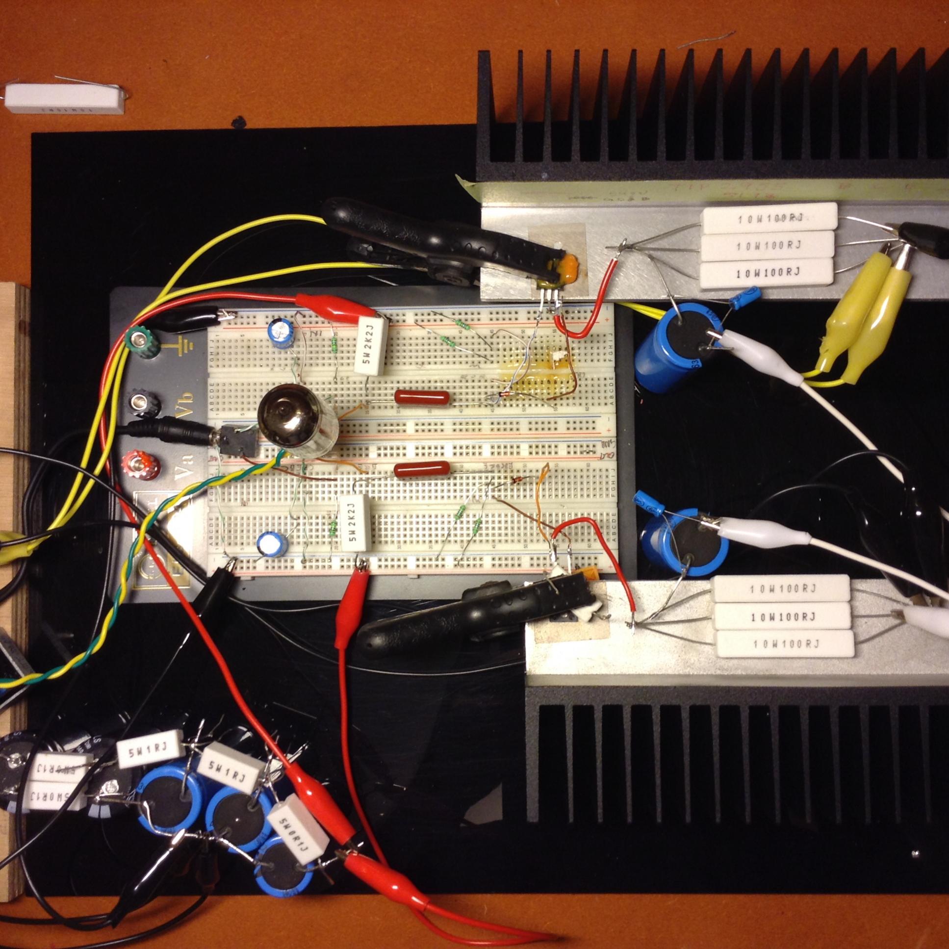

I have bread boarded this simple circuit and found it rather nice sounding.
I proceeded to do the second channel and hooked it up to my ZU's.
It must be my ears getting old, but I am so pleased with the sound that I will make a proper build of it.😛

I would suggest replacing the resistor source load with a choke and reduce the voltage of the power supply . For the driver stage , you need a much higher HT rail and a much higher value load resistor . 6922 probably has far too much gain , look at some lower mu valves such as 12B4A or 6AH4 . I currently run a similar hybrid but I use RD16HHF1 RF MOSFETS which have low capacitance . Current driver is a type 26 which has mu of 8 , if your speakers are efficient like mine , this is all you need up front for enough system gain

An inductor will double the efficiency, but at much higher cost - in Australia, I had two built, each of 100mH 0.47 DCR with 0.5mm gapping and GOSS for $250 EACH. I'm trying for 45W into 8R from 4A quiescent and 36V rails, 144W dissipation from each channel.
A 6922 has a rp of 2750 and mu of 33. They run at around 10mA and 100V, and the plate load should be around 3.5 times the rp for best sound, approx. 10k and a total B+ of 200V and an Av of 26, or 28dB, about right. Clearly the mosfet should be run from a separate power supply...... but this is hybrid, so you would expect this.
We are using the mosfet as source follower, so it's high Ciss is not too relevant because it is effectively bootstrapped, particularly if an inductor is used. I would use a simple hexfet with rating to 280W and at least 100V. Should be high gm too, so should be just fine.

Personally I would give it a fighting chance by replacing the source load resistor (a sizeable component) with an active load. Spend another MOSFET!

The sound is as good as my other class A efforts and beats my AB builds so far.
The power supply I am using for the bread board is a simple CRCRCRCRCRC.😕, Ripple is approximately 60mV. Sitting back in the listening position I can hear no noise through my ZU Soul (99db).
316A
I was looking for more voltage gain in the driver stage as I was planing to use the MOSFET to add current.
Might be a wrong though process but to me this is all a big learning curve.

Thanks for sharing photo - it gives me a great view of how complex/difficult something like this might be to undertake. I am totally ignorant when it comes to tubes/valves so can you give more details of ancilliary equipment/components needed to fire up that single tube? (small transformer and diode bridge/caps)

Besides lightbulb, a hotplate coffee cup warmer might be useful to keep your team warm. 🙂

I use a small multi tap transformer that has got a 6.3V tap for the tube heater. The 6922 does not require DC for heating. You might just have to watch the current.
I would like to think the power is somewhere around the 5 watt. This is plenty for all my speakers (93db, 94db and 99db). If one takes into consideration that the average listening level is in the 80db region, amp power is overrated imho.

A 7806 regulator would do, current requirement is only about 300mA.
Just keep in mind your max (35V) and min (8.5V) voltage to supply the regulator.
No HV required. Bias is done via the 1meg resistor on the grid (grid leak bias).
I could not see a problem using the IRFP240.
Enjoy and happy playing around and experimenting!

No SS device will sound like a simple tube...... this is why tube are still used for very high end audio amps. Running up to 200V and a 6V filament is not too difficult if you scout around for a surplus amp, or mix 'n match..... eg two trafos mains to 8-24Vac secondaries and back to back will give you high voltage at low current; a couple of 12VAs will do it. 120Vac then rectified and smoothed gives you 170Vdc.

I did add a 68R cathode resistor to the 6922 and changed the plate resistor to 33K to tidy up the sine wave a bit and at the same time increased the gain.
However, I am tempted to increase the plate voltage to where it should be as I find that I can not get a nice output on the CRO.
But like always, the ear has got the last say. And it was not disappointed with the low voltage set up. 🙂
