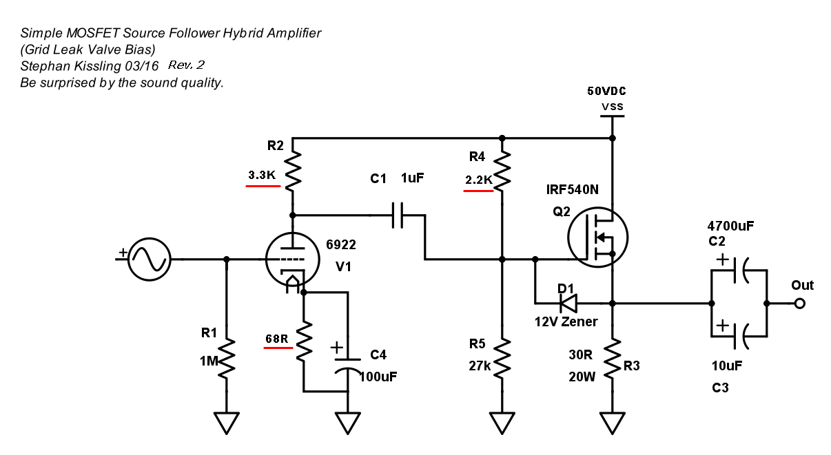

If you refer to the schematics in post #1, you will find that the B+ is only 50VDC and all the values concerning the operation of the tube are accordingly.
The idea was to make a simple low cost nice sounding amplifier. I belief the circuit in post#1 has achieved that. Everyone that has listened to it agreed.🙂
If you like to keep cost down, stick to the basics. However, if you do not mind spending a bit more and make it a bit more complex, go for a higher B+. You just need to recalculate the resistor values.
If you like to keep cost down, stick to the basics. However, if you do not mind spending a bit more and make it a bit more complex, go for a higher B+. You just need to recalculate the resistor values.![]()

XRK971 if you get your bits, just check out my revised schematics.
The value of some of the resisters has changed. I have added a cathode resistor (68 Ohm) and I have changed the plate resistor to 3.3K Ohm. This improved the sine wave and increased the gain.
When I load tested the amp, I found the bias needed a bit of tweaking to center the sine wave. So R4 is now 2.2K Ohm.
The output is now just under 4W on the onset of clipping.
These values are for a 50Vdc supply on the rail.
I did run it with a pre amp just for the sake of it, but it is not really needed. That is what your 6922 is for.

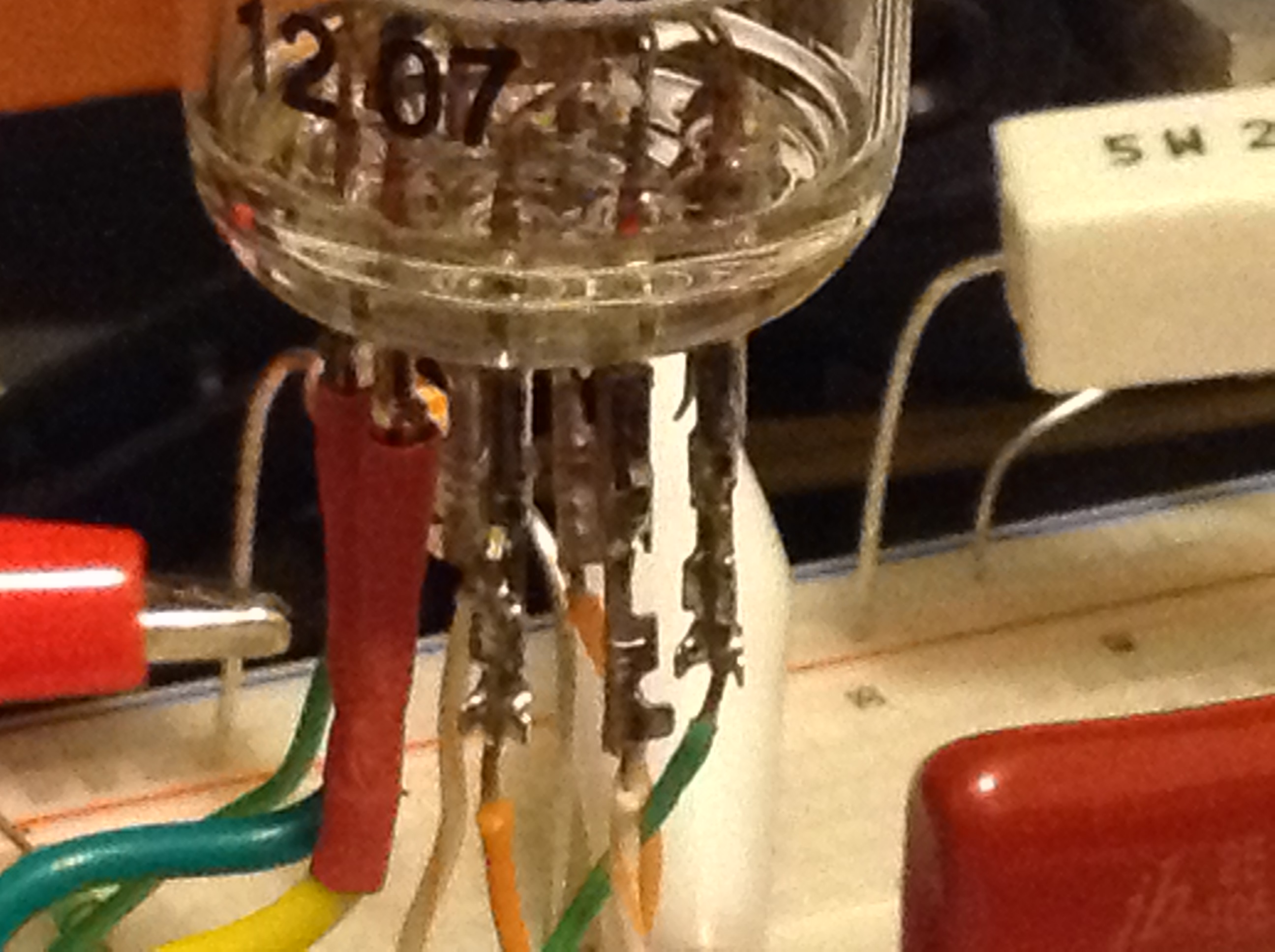

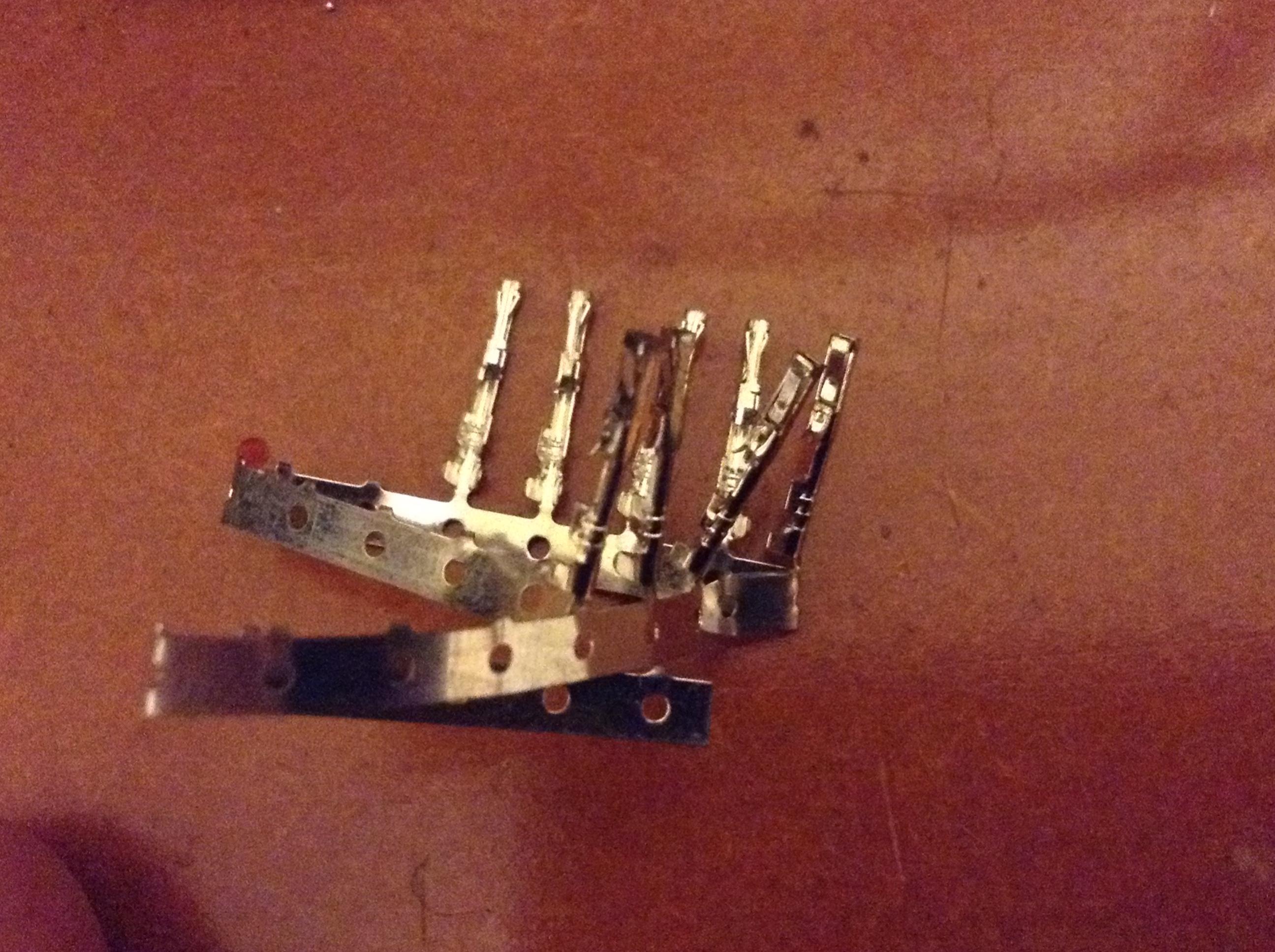

In preparation for the tube's arrival, I realize I don't have tube sockets. Is there a budget way to connect tube pins? Is it ok to solder flying leads to pins?

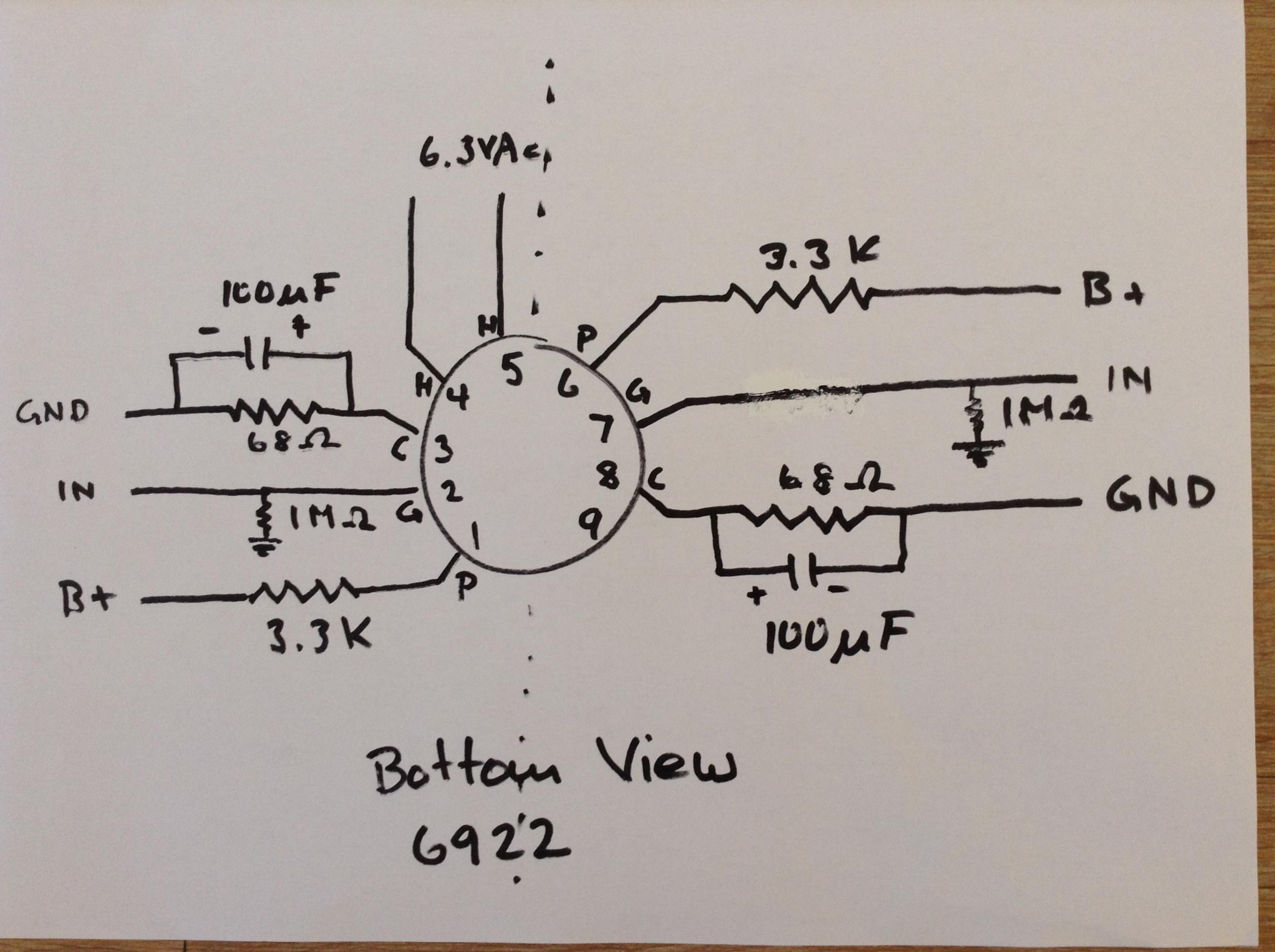

I was looking at your photo and tube pin out diagram and just realized that the tube and your protoboard amp has two sides - stereo in one tube. That's convenient. 🙂
Soldering to the pins is just not going to work reliably (the pins will wick away to much heat to get a good solder), but Glossmaster's idea would get you going.
Valve sockets are cheap though so do yourself a favour and get some.
