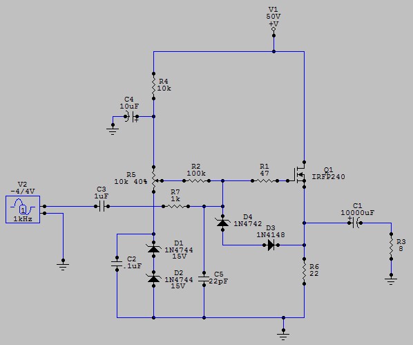

That looks interesting - so the tube output feeds into the 1uF cap? What does setting the voltage at 30v via the two two Zeners do?
I've some 22R/50W are they to low?
I did some measurements with a 20R resistor and found it reduced the output dramatically before clipping. You are better of to have two of your 22R in series.

The original circuit needed a coupling cap to be called grid leak bias, and there wasn't one shown. The 6922 is a very good tube when used right. I'd put a volume control after it. It will run more linear with a higher voltage. Put a passive Rf filter at the input. The 22p cap in the circuit on this page will roll you off at 7mHZ. Putting a 2nF cap there instead will roll you off at 80kHZ. Digital sources can have low level Rf energy that is not helpful. The output impedance might be a bit high, which can un-calibrate a passive crossover in a speaker system. I'd measure that. Global negative feedback might be wise if the output Z is over 0.5 ohms.
The 22r shown in post41 is the output device Source resistor.
It sets the bias for the ClassA output stage.
If one assumes the maximum output is 20Vpk, equivalent to 25W into 8ohms, then the bias current should be set to >= 20Vpk/8 = 2.5A
To allow that bias to pass through the combination of mosFET and Source resistor, one would set Rs = 10r and dissipation would be 62.5W. Q1 needs a very big cooler !
A pair of 22r 50W in parallel is equivalent to 11r 100W. That will do the job and allow upto 2.2Apk to the load. Well quite a bit less because a resistor source load allows the stage to generate high 2nd harmonic.
2.2Apk and an 8r0 dummy load is equivalent to 19W from the Buffer.
A 2.5A CCS will allow higher outputs at lower distortions.

post42 shows D1=D2 = 15V Zeners
That places more than 30V on the gate of the mosFET.
When the output is biased to mid supply rail @ ~25V the gate should be around 4 to 5V above the mid rail voltage.
i.e. ~29 to 30V
The Zeners should add to less than that to keep the variable resistor R5 off it's end stop.
I suggest a pair of 12V Zeners, or a 12V + 15V, to allow the VR to operate.
C3 is a bit big, C1 rolls off the bass at a higher frequency than what C1 passes into the amplifier.
This generates avoidable distortion.
Change the ratio of C1:C3 to reduce the audio and sub-audio signals on the speaker capacitor.
I would try C3 @ 330nF to 680nF (F-3dB ~4.7Hz to 2.3Hz)

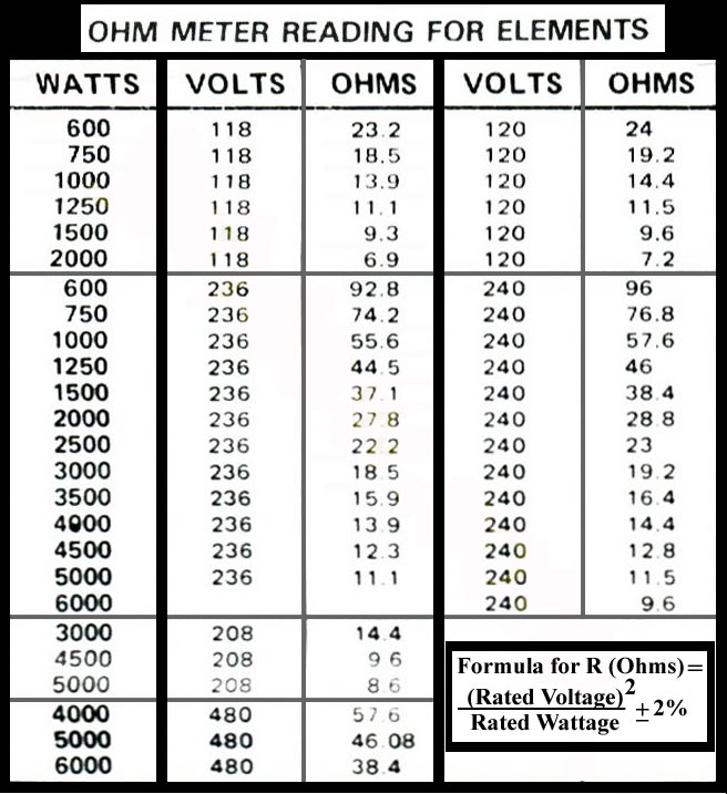

If I want to use incandescent light bulbs as the bias resistor - how do I go about selecting the bulb? Would two 25w 110v bulbs in parallel basically serve as a 50w resistor for 50v potential?

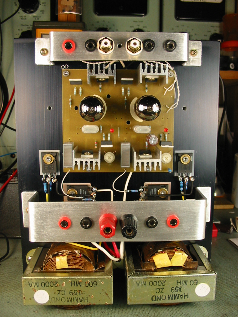

My valve tubes arrived from China. Still waiting for sockets and then sort out this lightbulb or power resistors. I will probably use a fan cooled heatsink so dissipating 60w is not a problem.

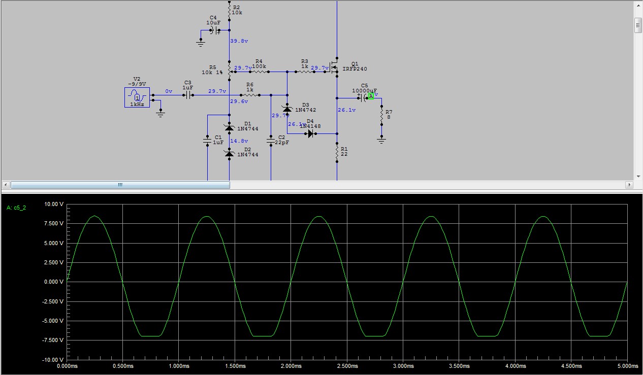

In a resistor loaded stage such as this, having the output set to 1/2 B+, the negative half cycle will always clip first. Ideally we want to increase the voltage across the resistor until it clips symmetrically. This is where the output power will be the greatest for a given load resistor.
Another alternative for high power resistors are actually hot water heater elements. I have a pair of 4000watt 240volt elements I use. They test at 14.8/15.2 ohms when fed 30 volts.

Plain incandescent automotive lamps would be better suited to low voltage applications.

What an interesting approach 🙂An inductor will double the efficiency, but at much higher cost - in Australia, I had two built, each of 100mH 0.47 DCR with 0.5mm gapping and GOSS for $250 EACH. I'm trying for 45W into 8R from 4A quiescent and 36V rails, 144W dissipation from each channel.

It's a no global feedback stage.In a resistor loaded stage such as this, having the output set to 1/2 B+, the negative half cycle will always clip first. Ideally we want to increase the voltage across the resistor until it clips symmetrically. This is where the output power will be the greatest for a given load resistor.

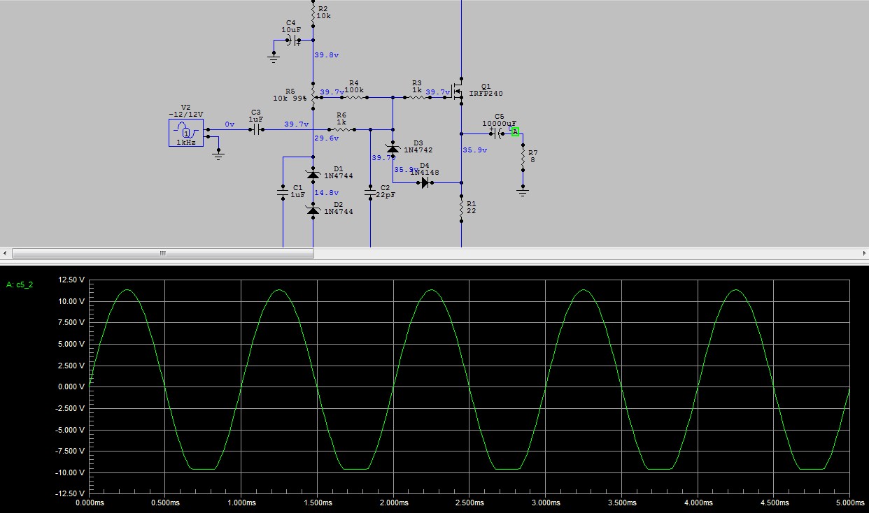

It does not clip like a global feedback stage.
It starts to generate 2nd harmonic as the output level increases.
By the time the output voltage is up around 50% of maximum, the distortion is just becoming visble, as a change in shape, on the scope.
Is the distortion mechanism with using a resistor as a current source caused by the variation in current with frequency (not flat)?
distortion due to not maintaining the linear amplification as the signal level changes.
It's typical of all ClassA single ended stages.
Sometimes we design for only using a limited portion of the output level capability to help keep the linearity reasonable.
Or we use NFB to linearise the output with signal level. That allows a higher proportion of the output to be used, but the downside is the sudden onset of clipping when the NFB runs out of headroom.

It simply has to do with the fact that the resistor can not sink as much current as the mosfet can source. It can easily be seen in the following examples, with the output set at 26 volts and 36 volts, the output before the negative half clips increases. ~39 volts is where it begins to clip symmetrically. At this point the output is ~6 watts compared to 26 volts where the output is only ~3 watts.
