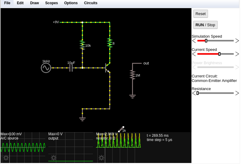

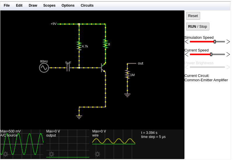

I have uploaded the Falstad circuit diagram screenshot for reference. I changed the supply to 9V and the top resistors accordingly to preserve the same current.

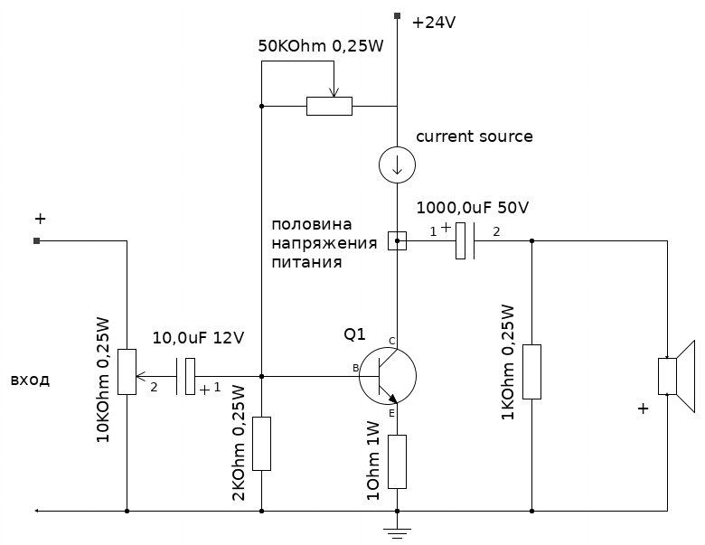

BasicHiFi1: you need to know what a potential divider does, and that a bipolar transistor is primarily controlled by the base to emitter voltage.
Let's start at the beginning. What do two resistors across a supply line do assuming that nothing else is connected? No I can't wait for your answer- it's like watching a snail race.
It's a voltage divider. So the voltage at the junction between the two resistors is a ratio of the two resistance R2/(R1+R2) times the supply voltage. (R1 being your "top" and R2 your "bottom" resistors).
Now hook a bipolar base up to that. You've just set the base voltage of the transistor, assuming it takes a low current compared to the current flowing in the resistors.
What have you been told/learned about the base-emitter voltage of a transistor?
It's about 0.6 to 0.7V. Once the base voltage is set the emitter will want to "follow" it at 0.6 or 0.7V or thereabouts below it. You use that information to set the emitter current.
One caveat: that base voltage needs to be at least 0.6 to 0.7V higher than the emitter voltage you want.
Now you check that things are looking about right by estimating the base current and ensuring that it is less than at least a fifth of the current flowing in R1+R2. Then the circuit will bias close to what you want.
That emitter resistor provides some degree of negative feedback and thermal stability as a result. It's not perfect but miles better than having nothing unless there is a sense resistor in the collector.
Now, last point, you can set the collector resistor value. You've been told (several times) that the collector needs to sit at about half the supply voltage, or better, half the voltage difference between the supply rail and emitter voltage.
You know the current as you just set that with the emitter resistor (and base voltage, which sets the emitter voltage, approximately), and noting that the collector current is almost identical to the emitter current.
You know the voltage you need to drop across it now.
So Ohm's law again.
Please see if you can follow this before commenting again.

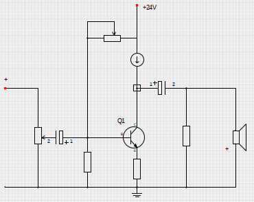

Resistor R3 needs to be adjustable. Best operated with a current driven input.

The Falstad sim shows the following for the standard Common-Emitter Amplifier circuit, 20V without modification: Current in 110k resistor = 177 uA, 10k resistor 110 uA, base current Ib is listed as 5.2 uA

Collector current and emitter current 1.432 mA and 1.451 mA respectively.

OLDIY your diagram is a real clear solution. I probably need to do this. The second potentiometer is a gain control. The resistor across the speaker is to reduce hum and distortion?

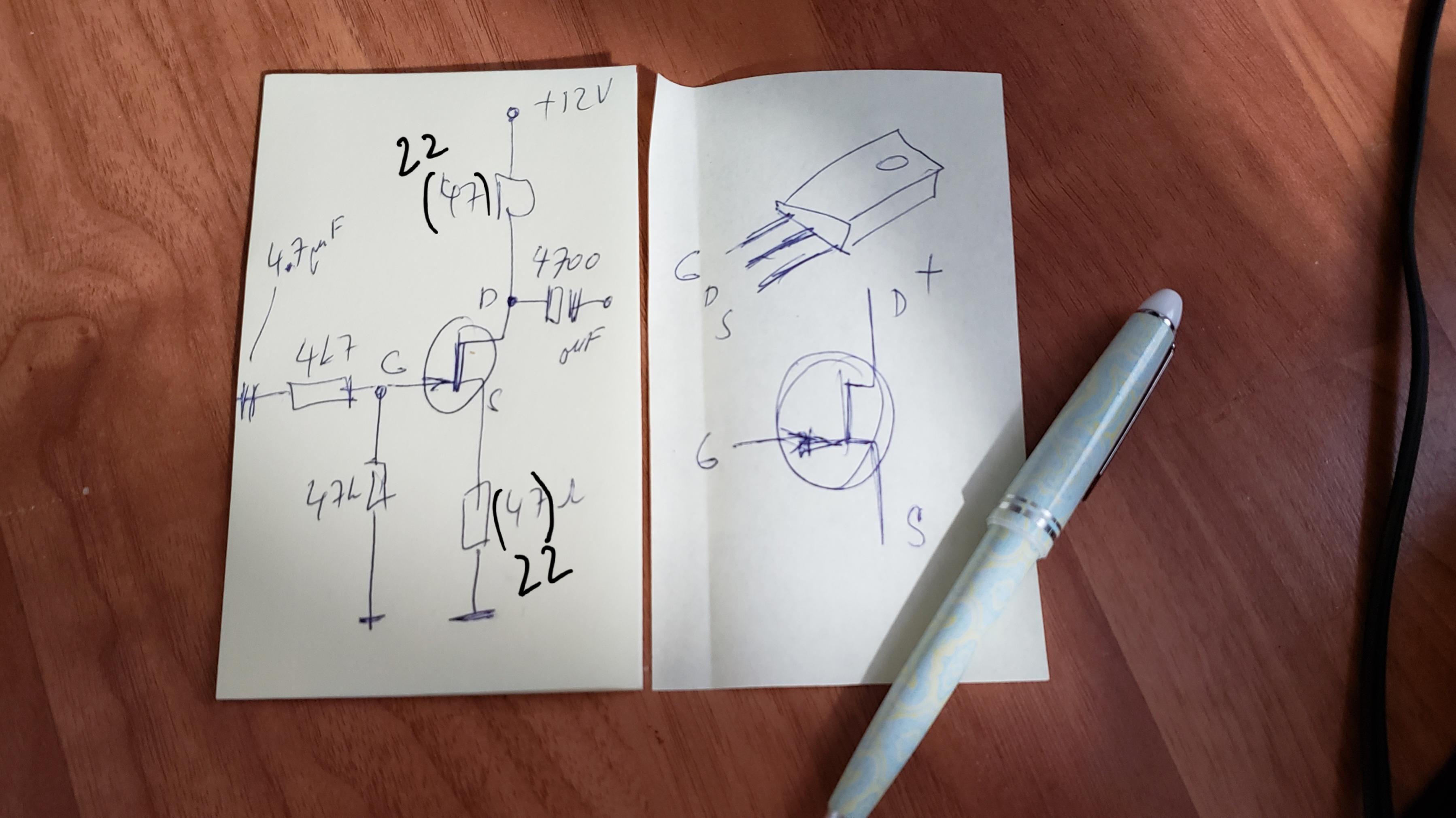

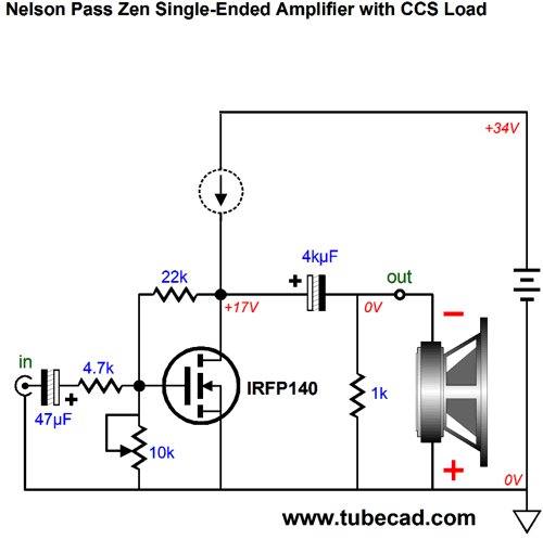

Few days back I put this together. Meant as headphone amp, but it can drive bookshelf to moderate spl. Sounds really good, only second harmonic. It uses power jfet lu1014d.
Thanks. Need to source the jfet.
Circuit in Circuit Sim, actual components
Actual components used:
1) 50V 10 uF non polarized capacitor
2) Resistor - -Brown- Black -Orange - Gold - 10k Ohm
3) Transistor - TIP 41A
The simulator plot taken across the 8 Ohm resistor, representing the speaker, is pretty ..... awful.

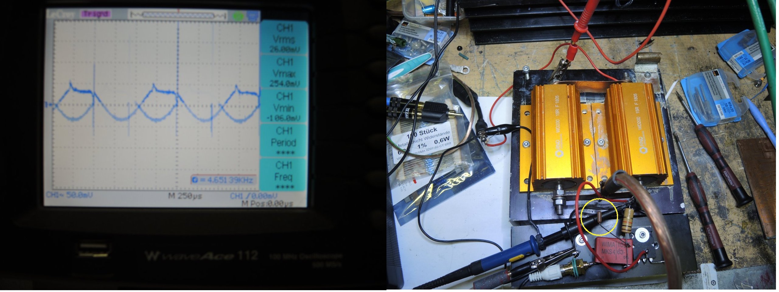

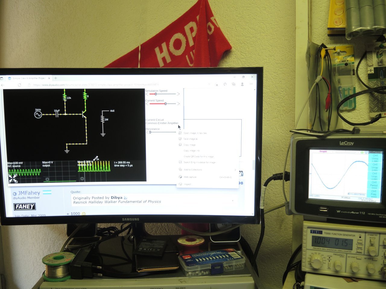

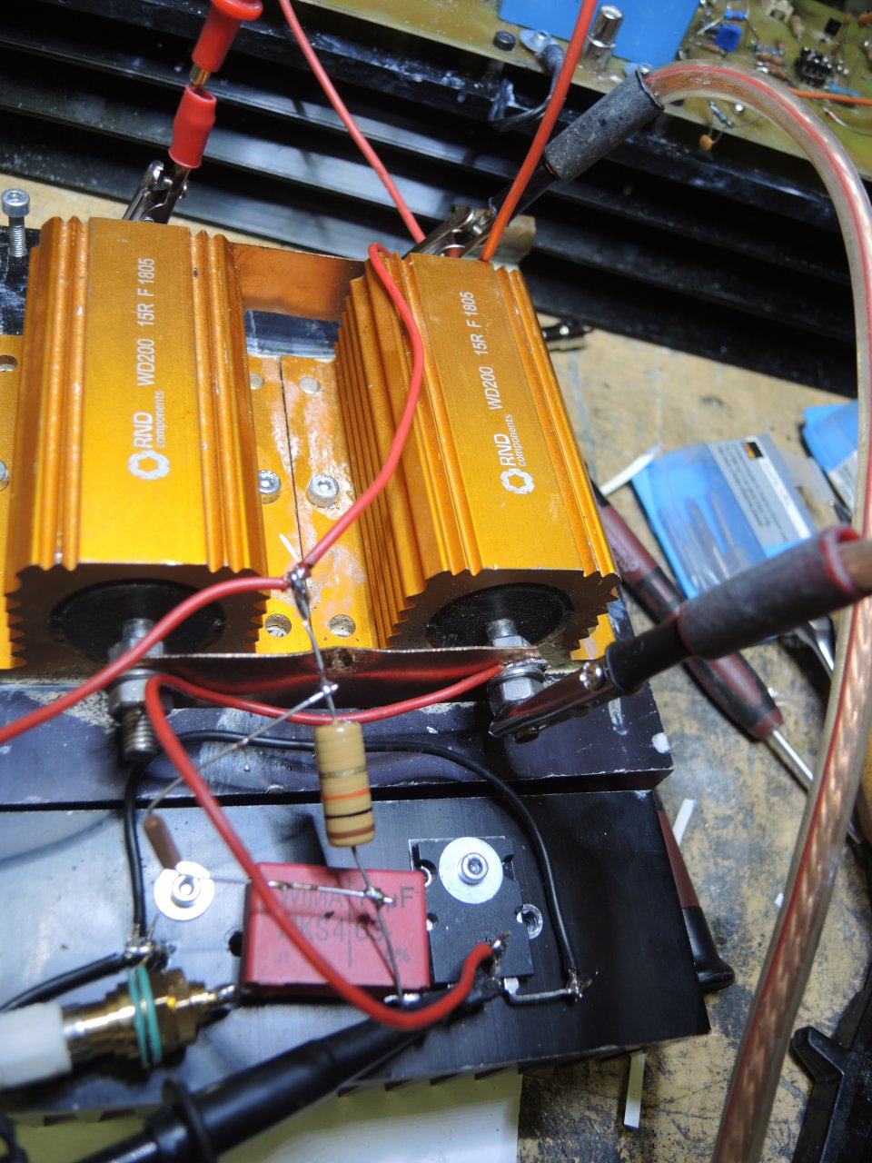

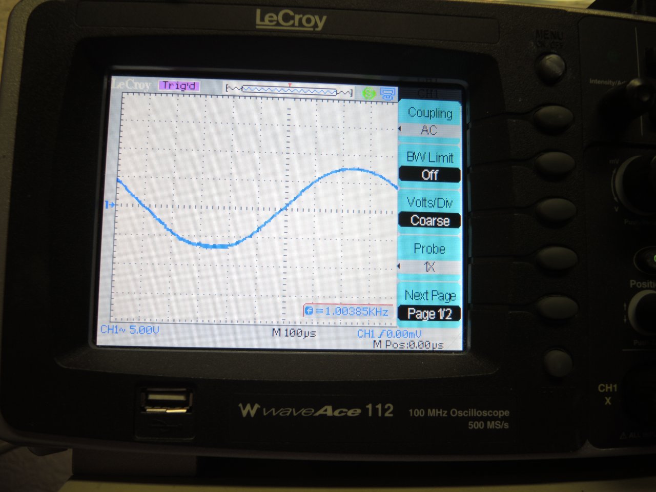

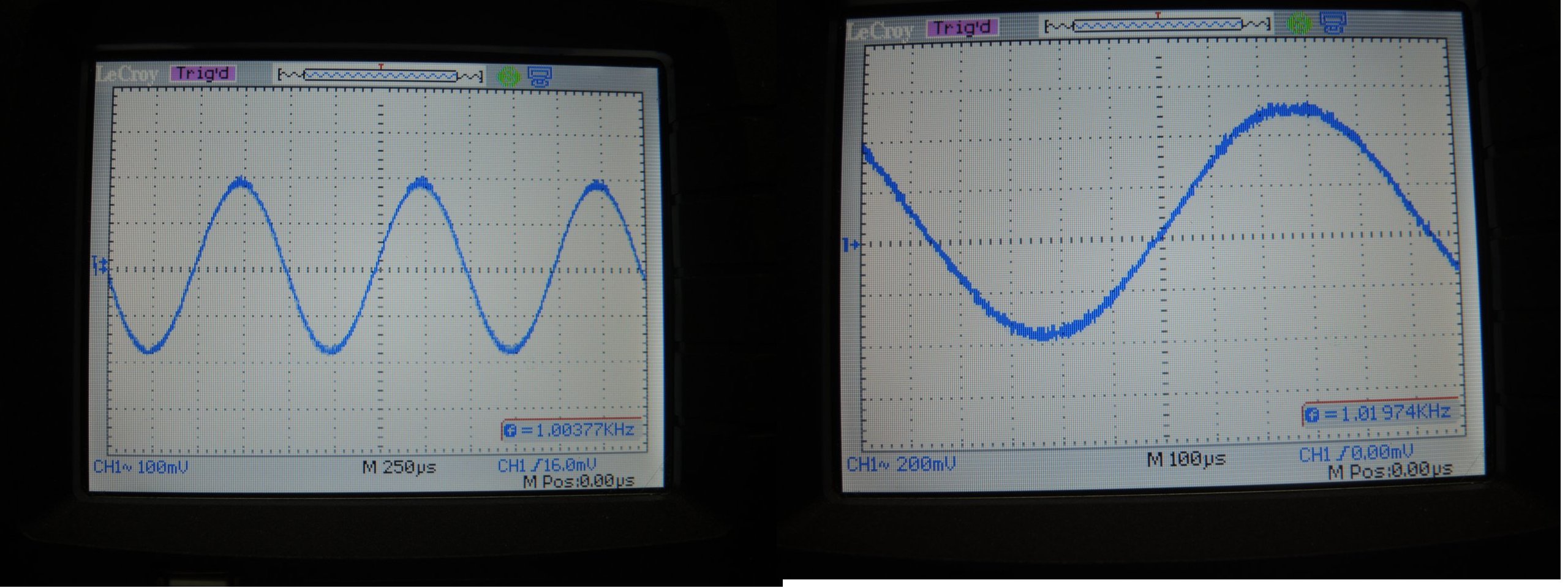

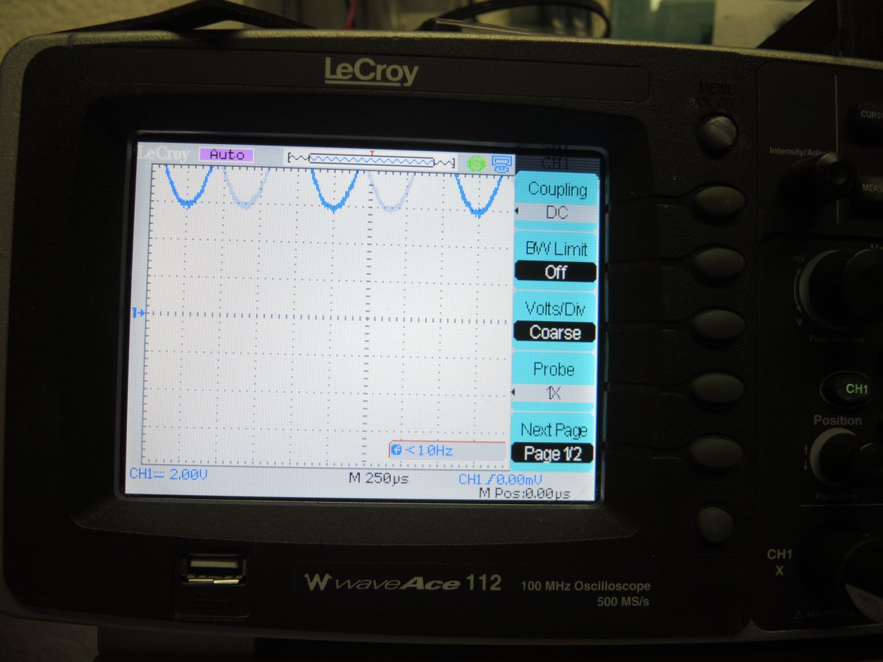

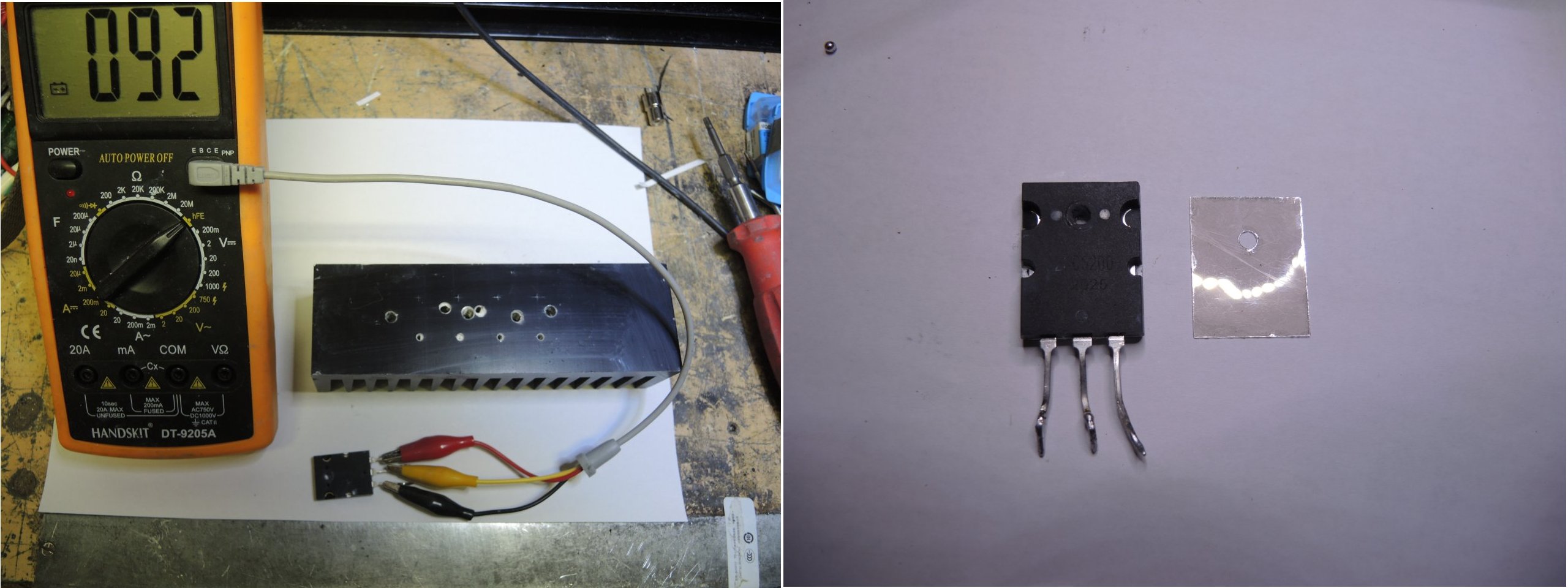

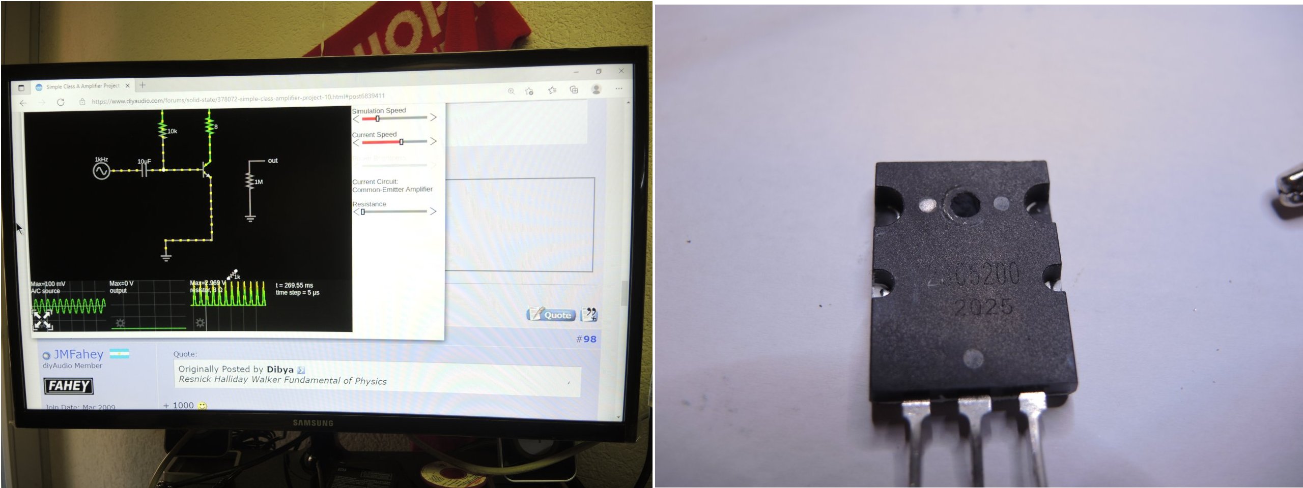

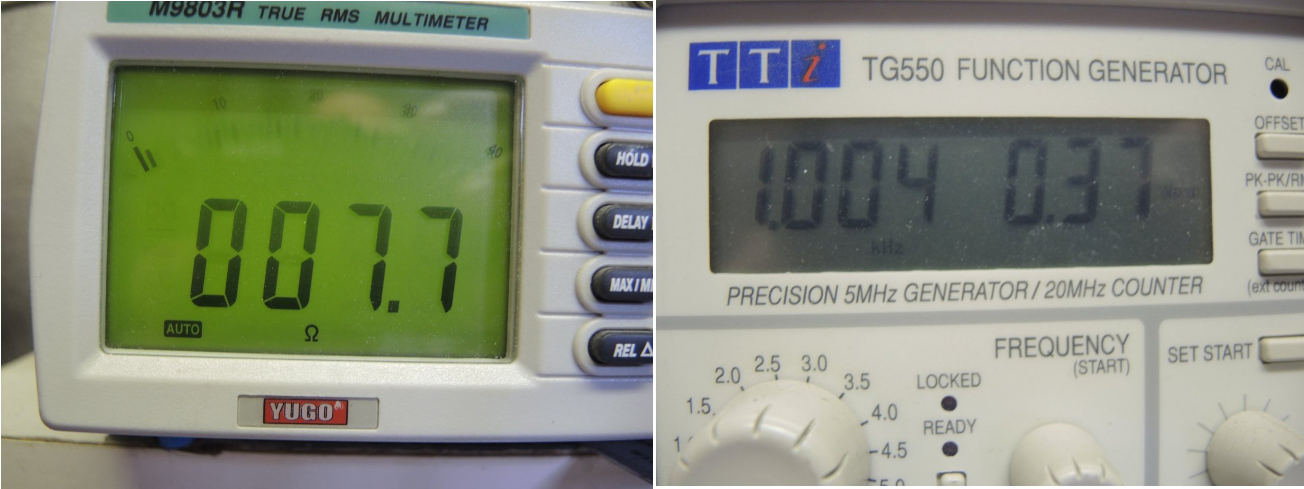

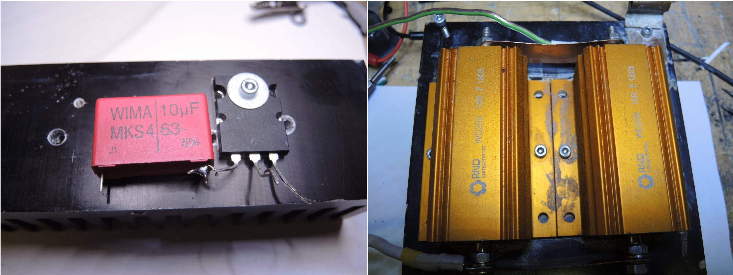

And just that you see that this what I type here is true, I took some time, took some components and Build your Circuit according to your last Simulation. Exactly that way,
I used another Transistor which fits better for a CLASS A
I used Double Voltage because with 9 Volts you will never hear any sound out of your Speakers.
I used Huge Resistors with a resistance of 7.7 Ohm and since you are using 5% Components, the Resistor is just a good match. Tolerance is within this 5% it's even less.
Also I used a High Grade Cap at the input with 10Uf 63 Volts Non Polar.
I hooked up Oscilloscope and Function Generator voltmeter Ohm Meter and all what one uses to test a circuit to get REAL MEASUREMENTS OUT OF IT, and not DREAMS like you do.
So check out the pics, and then start with the BASICS learn them.
Forget to talk about Distortion, rather inform yourself what an Resistor Array does, what an Resistor divider is meant for and that a LOAD Resistor for the COLLECTOR of a NPN Transistor isn't a equivalent for a SPEAKER and that the Circuit you try to build lacks of at least 2 Components.
At the Output you need to add a OUTPUT CAP to block DC off from the output signal
at the input it would take a BASE GND RESISTOR to lock input impedance to some certain level..
Then also you will need at least double voltage to have sound emitting from the Speaker. Good sound I mean not only Squeezed noise..
But the most important of all is, Listen to guys like John_Ellis, JMFAHEY and all the others who are trying to explain this for quite some time. These guys knowing what they talk about.
Enjoy Sunday and look a the pics I place here.. look good because these consists of some secrets I like you to find. And it's your Circuit in REALITY what you see in these Pics..
Also Note that up to Picture No 7 all Signals were measured with NO SPEAKER CONNECTED and then Check out Pic 8 ..
This way the sine wave is looking when connecting the speaker because there is not enough BIAS on the BASE of the Transistor..
If there are any mistakes in that documentation then let me know, where..
I apologize herewith already if this happens,, no one is perfect..

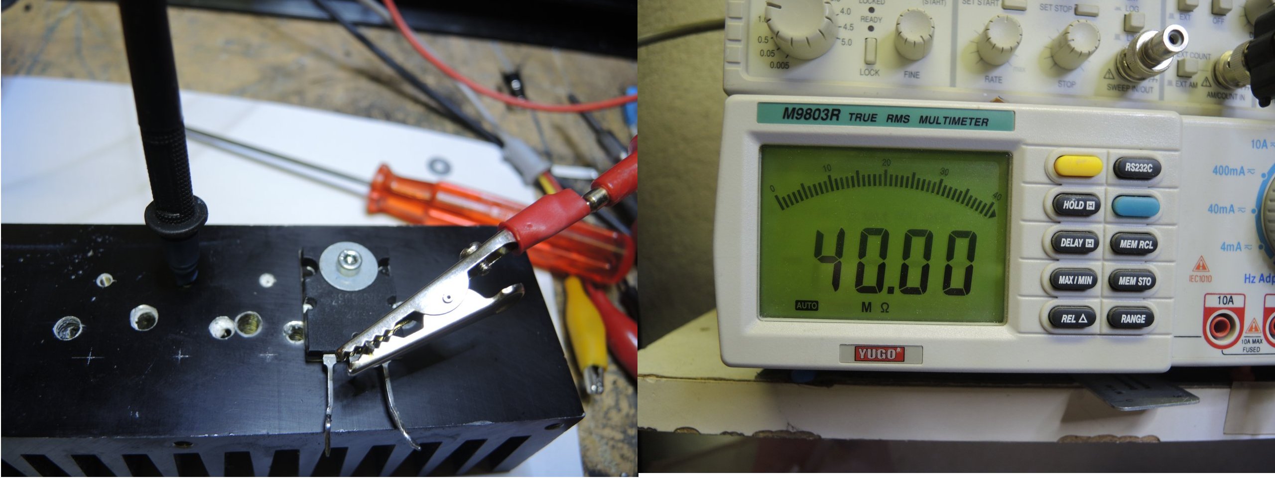

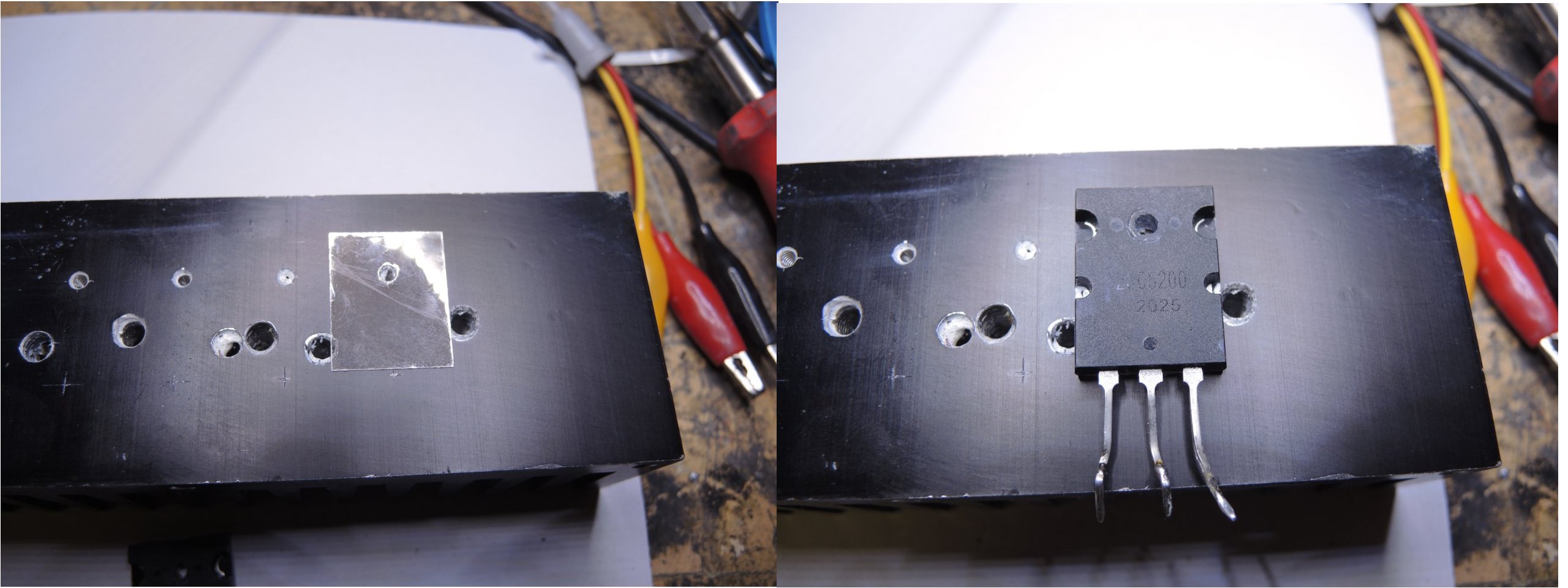

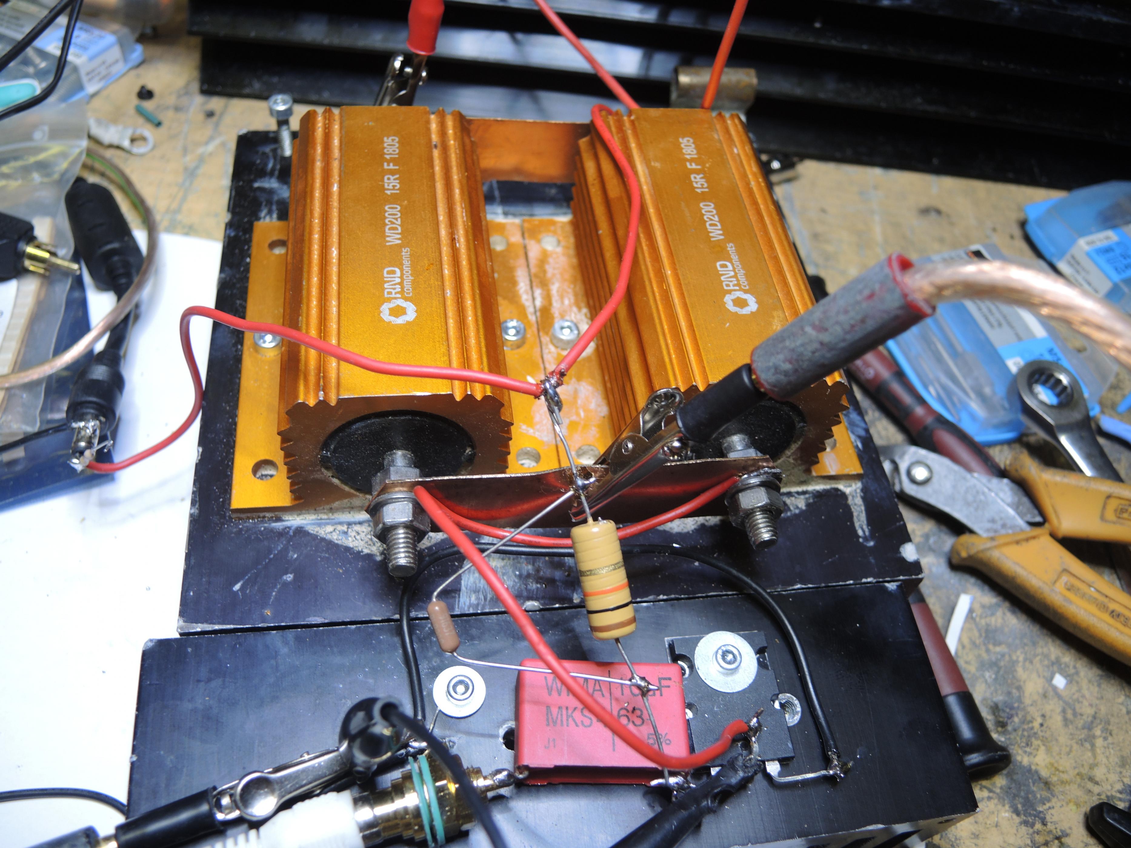

Hi BasicHIFI1
I think you do not understand what everyone here tries to say and teach you.
Go with the FUNDEMENTAL BASICS. This is were you show a big LACK of.
And it's Sunday
Good luck
Regards
Chris Hess
May I add this here as well, I could clarify some misunderstandings
I need to add a few Pictures, because these Pics you see above are partly modified Circuit of BasicHifi1 -
His Original Circuit you can see here also with Readout, but it will definitely burn Speakers connected as he drew it..
His speaker is connected (R8Ohm) as he writes, to VRail - Vcollector without output Cap I understand that this is a no go.. Using the Loudspeaker as a LOAD RESISTOR for the collector I tried all of his approaches and none of them actually would give, in view to speakers, a safe connection that speaker wouldn't send out smoke signals sooner or later.
Just was curious about his approach of building this simple class a amp, which turns out to become a bit complicated.. that's why I used another way to get that collector fed with Power, and max DC-out is about 150mv - 300mv depends on Rail voltage used.. But I think it's still a need to connect a Output Cap. In picture 2 here you will see the Readout with the scope if connected like in Pic 4, and we are talking about 10 Volts DC when Rail is 18.VDC
Shown in the pictures in my earlier Post.
Reason that I have to make this here, is because Camera saved this few pics in a folder, which had only place for 5 more pics.. the rest from my last post, camera created a new folder, and I just saw a minute ago that these were missing .. now here you have them. I hope it helps that Basichifi1 gets his Class A.. Secret tip for you: Go to Firstwatt.com and check out what Nelson Pass is writing about Class A amps..
Sorry for the inconvenience.
Regards
Chris Hess
Regards
Chris Hess
