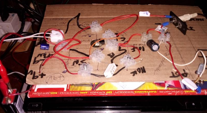

I followed John's advice and added a large 5W resistor between the collector and the power supply. Next I moved the capacitor and loudspeaker to connect to the ground and the collector.
Not wanting to take a chance, I used a 9V battery to power the circuit. Initially, after connecting a resistor incorrectly, I was able to get the thing working.
Back to sweet music, very low volume but listenable. I could not stop listening. I have gone through 3 CDs, and nothing is getting too hot. Measurements tomorrow, but it does produce music.
Thanks to John for his suggestion. Looks like I have a working thing here.

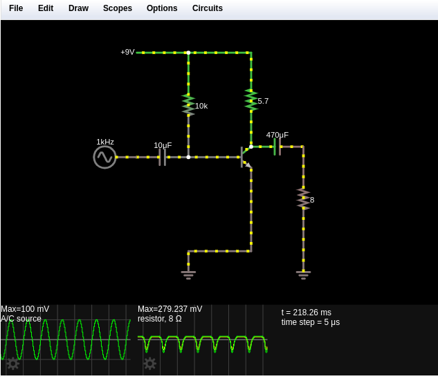

All your circuit requires is a resistor connected between the collector and supply. You can then rearrange the capacitor and loudspeaker to connect to ground.
If you operate the circuit at 9V the collector resistor - let's say 4.7 ohms - will drop about 5V across it. So your transistor will dissipate the remaining 4V multiplied by the current which will be just over 1A =4W. That makes it necessary to use a heatsink, but does not have to be particularly large if you don't mind the transistor getting a little warm (10C/W means a rise of 40 degrees C) but as with all components the cooler you run them the more reliable they will be. I's probably choose a 7C/W heatsink or maybe 5C/W. The resistor on the other hand will be dissipating 5W and should probably be a 10W component in free air or a metal cased 5W on a small heatsink too.

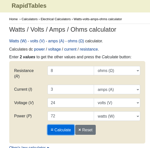

Try 24 volts and 8 ohms into the collector and 1 ohm into the emitter. Select the correct bias current. 4700 uF electrolytic capacitor.
Watts up!
Yes, but the Wattage! 72 Watts through the thing and 3 Amps! The transistor can handle upto 4 A however the resistor will light up like a bulb. I will need an arrangement like in the ZCA with a whole roomful of resistors.
Power resistors: These look like the ones used by hpro in his tests.
In the collector a resistor is 8 ohm / 50W, in the emitter is 1 ohm / 5 watts, the output power is about 1.5 watts. Quiescent current 1.5 A. This is the price of class A.🙁

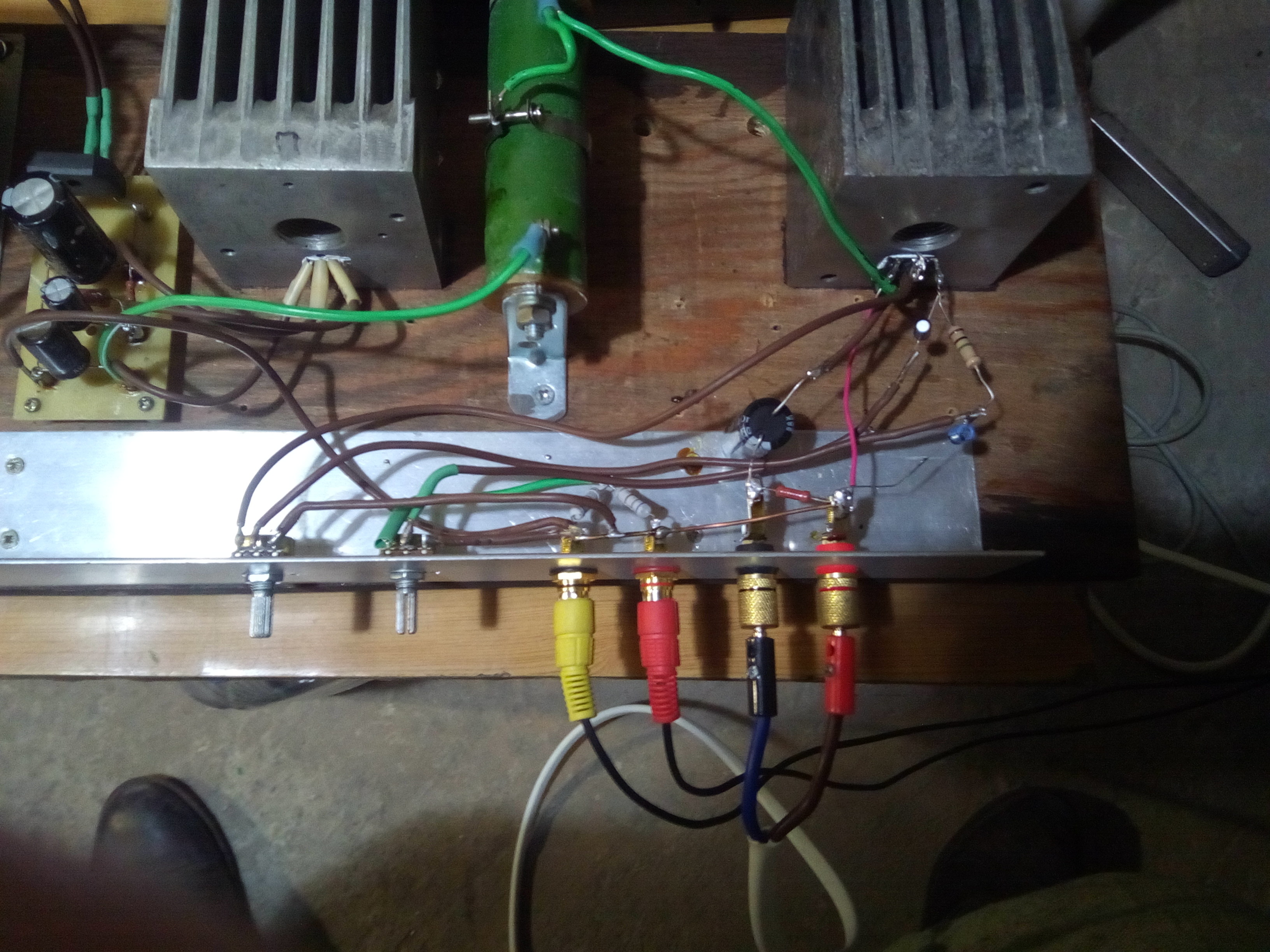

I burn over 20 Watts to get only about 4.8 audio Watts per channel! The heatsink I used is rated at 0.784 °C/W

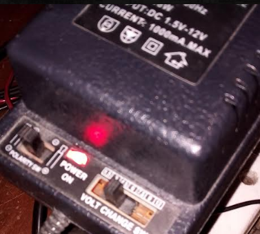

I ran the amp now at 4.5 V. The settings on the power adapter are: 1.5, 3, 4.5, 6, 9 and 12 V. The blurred picture shows the adapter. After about 15 minutes the TIP45A become too hot to touch, so I shut it all down. I need a bigger heat sink. On the positive side, the resistor did not become hot, neither did the other components.
The sound was greatly improved, much sharper and somewhat less distorted in any case quite listenable. I need to get a better heat sink - maybe I will make one - and make the circuit more compact.
