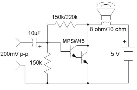

Update
First of all, an update. The amplifier shown in the last circuit works, and puts out 85 dB at 1 metre, peak music output. The amplifier was run for several hours yesterday, playing music. It is running off an AC/DC adapter set at 6V. The sound from it is quite clear and distortion free except at the highest volume. I am very happy with its performance.
Thanks to everyone who helped. It is very much appreciated and my success was due to you.

That’s a *preamp* (at least the last circuit that was being discussed there is). I guess with the right transformer you could drive a speaker - very quietly. The basic circuit could be adapted to be a power amp to put out between a handful and maybe 10 watts. Output stage bias current would need to be run up, but a 3055 emitter follower would work ok up to maybe 2 amps bias. With a bigger heat sink of course.

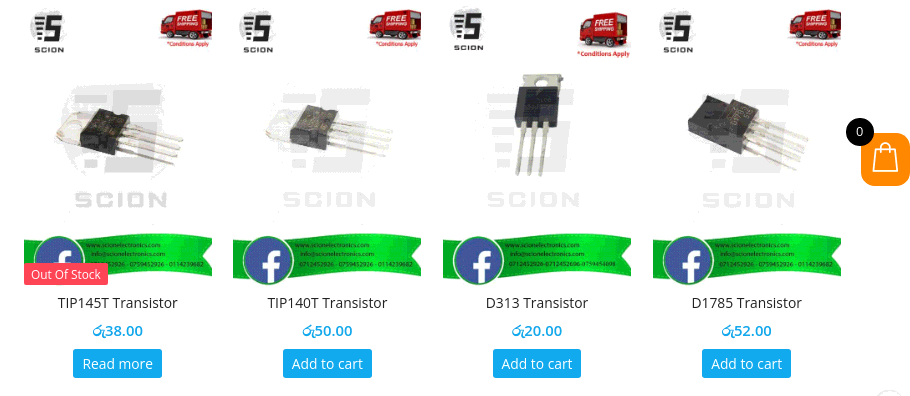

Transistors
Someone mentioned SCION Electronics. These are the transistors available.
Darlington transistors (attached image)

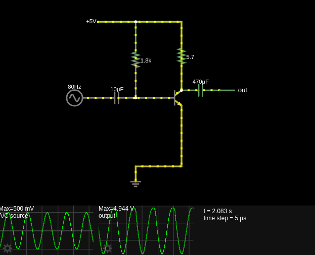

Changed bias resistor
I replaced the bias resistor of 10K Ohm with a potentiometer. I was able to increase the volume without distortion when I turn the potentiometer - there is a region where distortion is the lowest and volume is the highest, this at the highest input volume setting. I measured the potentiometer setting as 2K Ohm. The load resistor gets very hot, and only a 4 Ohm speaker.
The circuit in Circuit Sim. Strange waveform.
Circuit Diagram (Working Circuit)
The circuit diagram of the actual working circuit simulated in the FALSTAD circuit simulator. Input resistors to combine stereo channels to mono is not shown. Power source is 4 x AA rechargeable batteries.
