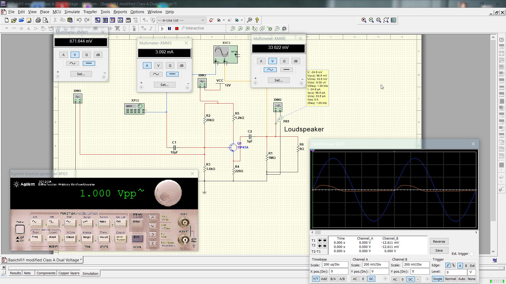

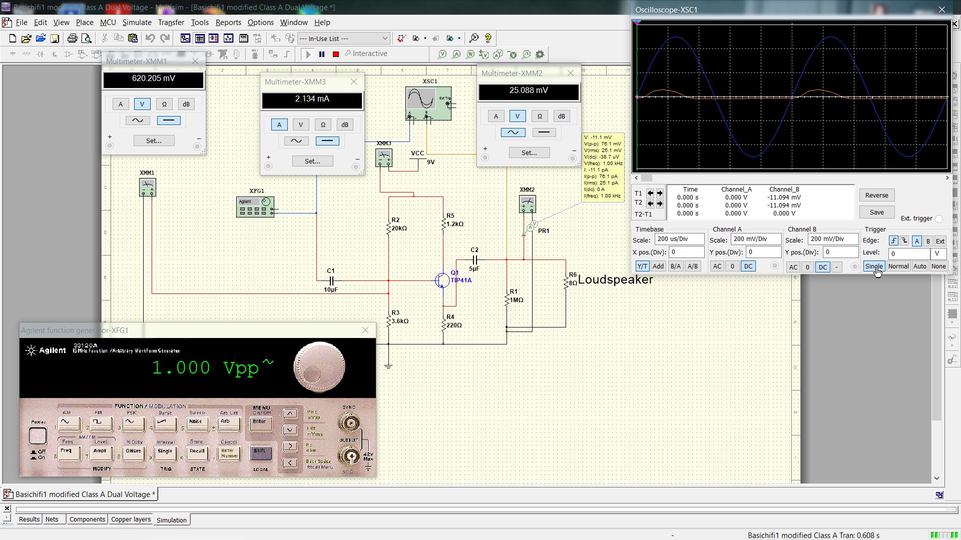

THANKS for actually building it, doubly so for DOCUMENTING the experiment.what I type here is true, I took some time, took some components and Build your Circuit according to your last Simulation. Exactly that way,
I used another Transistor which fits better for a CLASS A
I used Double Voltage because with 9 Volts you will never hear any sound out of your Speakers.
I used Huge Resistors with a resistance of 7.7 Ohm and since you are using 5% Components, the Resistor is just a good match. Tolerance is within this 5% it's even less.
Also I used a High Grade Cap at the input with 10Uf 63 Volts Non Polar.
I hooked up Oscilloscope and Function Generator voltmeter Ohm Meter and all what one uses to test a circuit to get REAL MEASUREMENTS OUT OF IT, and not DREAMS
Simulators are fine to *PRE* test options and save a lot of time, but then you must go through the Real Deal.
For example, simulator resistors do not smoke, supplies keep steady, do not burn if shorted,etc.
So check out the pics, and then start with the BASICS learn them.
Forget to talk about Distortion, rather inform yourself what an Resistor Array does, what an Resistor divider is meant for and that a LOAD Resistor for the COLLECTOR of a NPN Transistor isn't a equivalent for a SPEAKER and that the Circuit you try to build lacks of at least 2 Components.
At the Output you need to add a OUTPUT CAP to block DC off from the output signal
at the input it would take a BASE GND RESISTOR to lock input impedance to some certain level..
Good luck

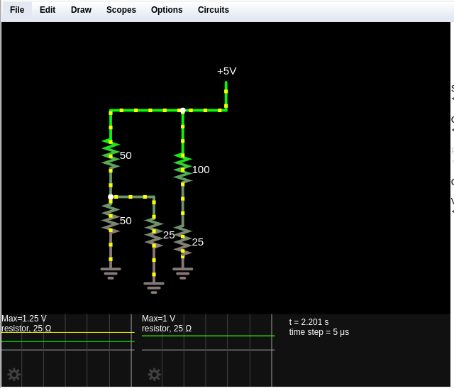

My question about the resistor array was why use two resistors? I went to the circuit sim and then found out by simulation that it is not possible to make the voltage drop anything other than 5V when only one resistor is connected.
I got my question answered with the circuit sim: please look at the two 25 Ohm resistors in the attached circuit: The current flowing through each resistor is different, the voltage across each resistor is different: In my mind, I thought they would be equal. I had forgotten my physics.

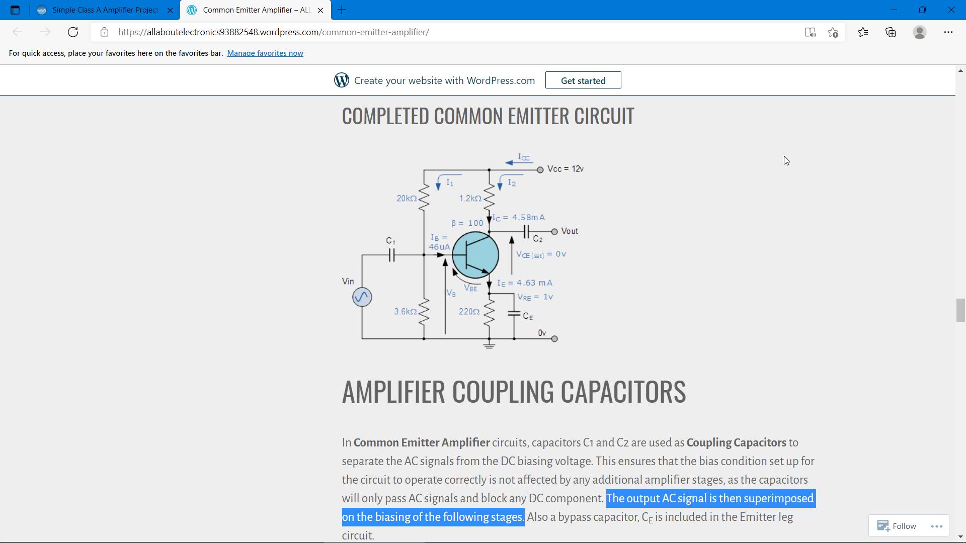

I found a circuit that will work of 12V. Set up in Falstad and it works with 9V with the resistor values shown.
I got off to a wrong start with You Tube circuits.
The solved circuit is halfway down the page, I have printed it out for reference.
Common Emitter Amplifier – ALL ABOUT ELECTRONICS

If you work with that circuit and check against the explanation you found, you will start to progress.
You still need to understand what the capacitors are doing. They are separating the signal from the circuit so that the transistor is biased in its operating configuration and that the input and output don't change it.
The output capacitor disconnects the D.C from the collector so that there will be a sinewave on the output signal across the load resistor (1M) which will swing around zero, so will go negative. Not sure what you meant by your "sinewave in negative territory", but if the capacitors are initially uncharged there will be a charging current which alters the bias (and output) temporarily while they charge.

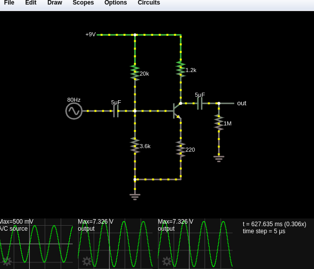

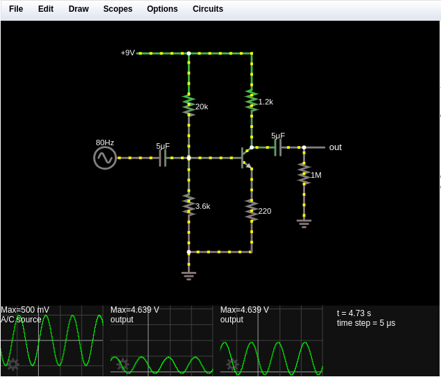

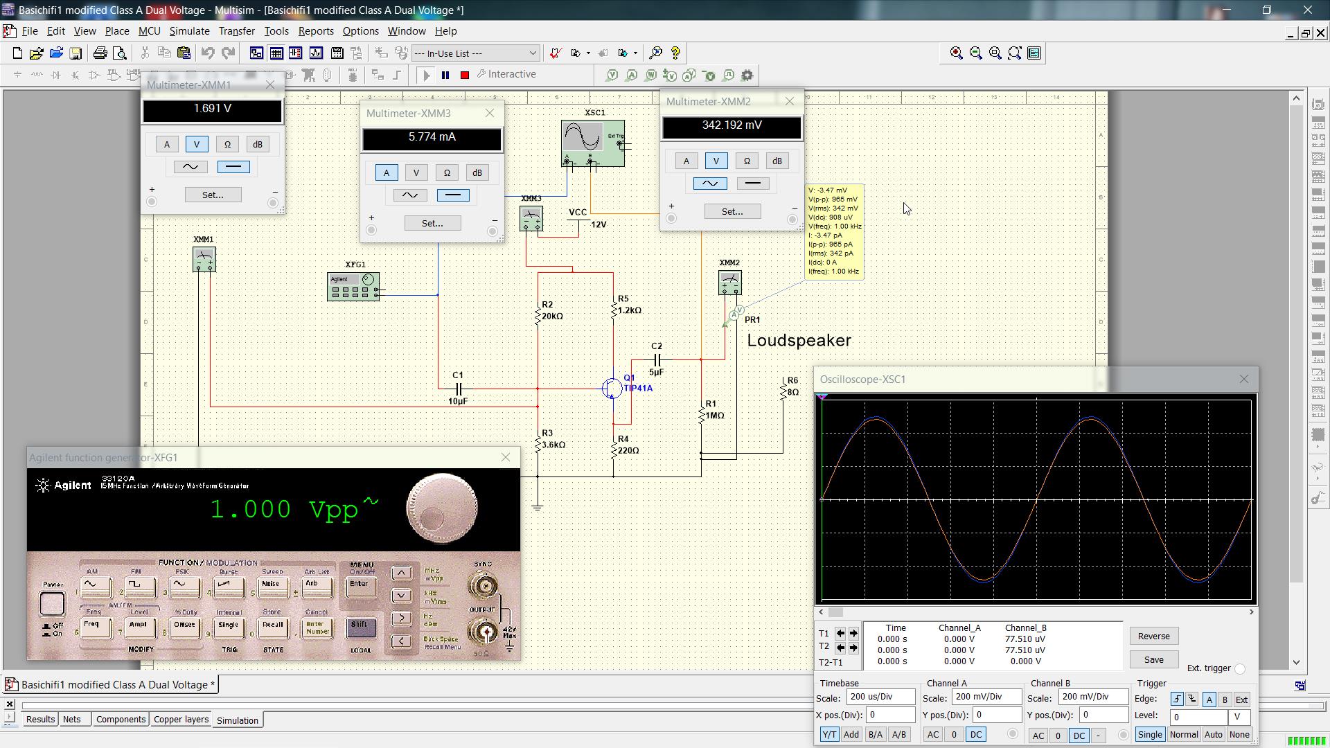

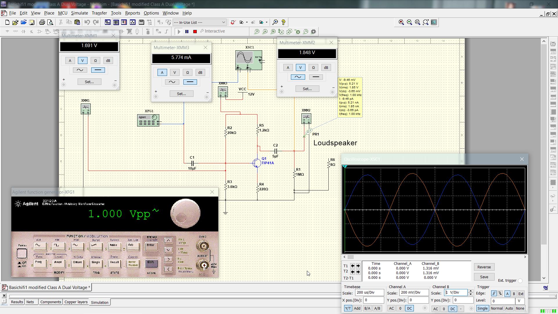

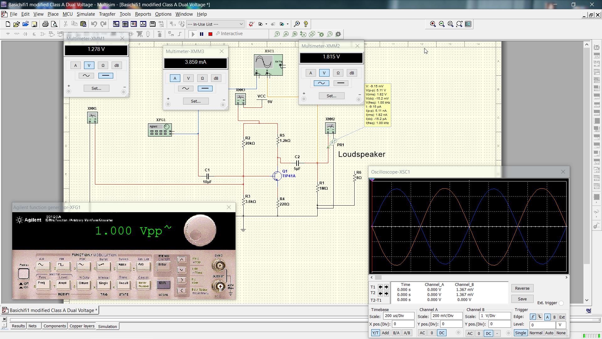

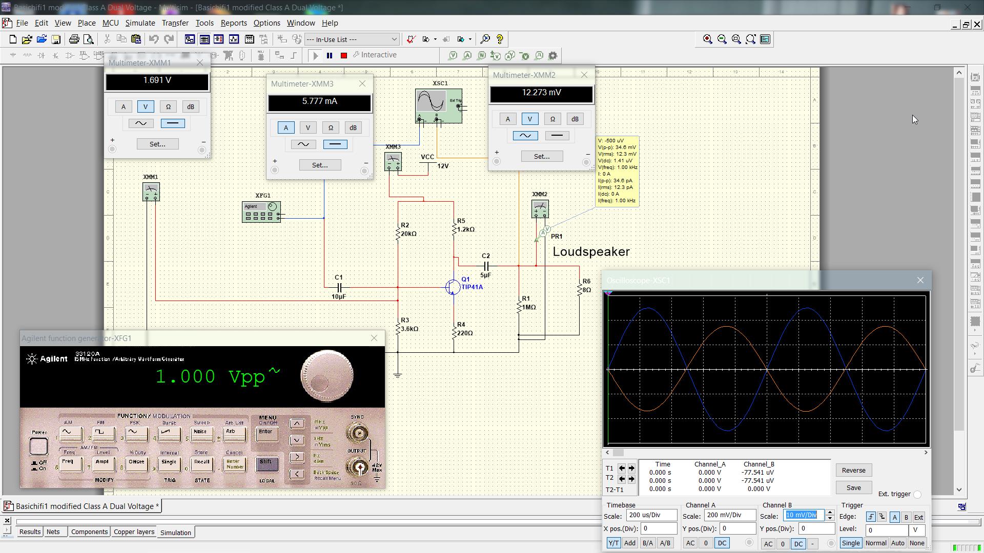

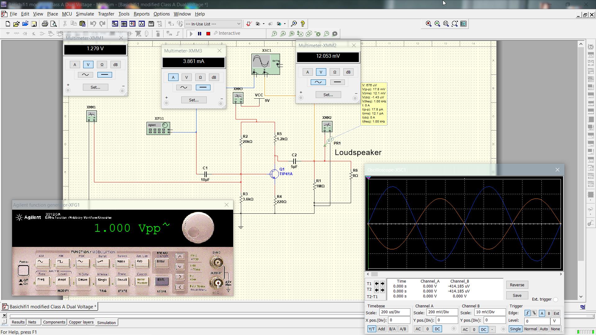

Taking your simulation onto my Simulator, then I get these Screens.
Remember, speaker impedance are 4 8 16 Ohms usually, but there aren't any with 1Mega Ohm.. *Your Output Resistor.*
So I simulated your design and what you see in these pics, that is what you got of that last of your simulation pictures.
Remember we talking about CLASS A here. I think you need to update your knowledge about Class A,
What also is, your Circuit has a 180 Degree Phase shift, which actually in nothing what someone wants. That's why I also simulated your Circuit without Phase shift.
Then also I simulated the Circuit with VCC 9.0Volts and also VCC12 Volts..
My advice to you: Go over it again with Speaker Load of 8 Ohms in mind and not 1MEGA OHM.
Again: in this screenshots you see your Circuit with all relevant
data it uses to work according to your drawing you placed in Post " Revised vertical scale on scope."
Check out the pics

Yes, you’re right, the amp that he’s working with now (in simulation) cannot directly drive a loudspeaker. It’s a small signal amplifier stage. But we’ve had to back up a few steps and learn some basics first - which is far easier and more productive in the long run than trying to learn the same basics on something that does drive a loudspeaker. This circuit could easily be built on a breadboard and verified. Learn how and why it works. Then move on to more difficult things - like driving a loudspeaker.
A few thoughts on that circuit
The Circuit you choose is a Input Stage Circuit of a Class A Amp.
You will not be able to drive a Loudspeaker directly. I highlighted a Sentence about that Circuit in the Screenshot I add. If you read all very carefully then you would know that this circuit is not suited for driving a loudspeaker..
In my prior Post please note that I made two Simulation on that circuit..
Once open, once with 8 Ohm Load. so that you can see the difference..
Here on this site are at least 100Schematics of Class A high Output Amps, to build.. So make search Class A Power Amp. Or just hit that LINK and start to build, I did already as well as many others and it will WORK,
And there are many Ways to configure that ..
Try it..
The next time you want to build an Amplifier, you need to decide what the Amp should do. A buffer, or a Power Amp.. there is a big difference with it..
Regards Chris
By the way, the circuit sim needed a new scope added after the changes as the old scope showed below zero output signal (sign wave in negative territory).
Try it..

There are amplifier circuits posted here on this thread able to drive a speaker, using a BJT?
You really need to stop and review everything you've been told, and re-read that link you found to the one-transistor amplifier.
We could tell you what MOSFET you might use but many are suitable, and it won't help because you need to know how the work in greater depth, understanding things like threshold voltage and conductance to make a circuit work.
We have told you that you CAN make a single transistor BJT circuit drive a loudspeaker but it isn't simply a matter of connecting a speaker to the circuit in that article again because the output power is so low.
We've also suggested that once you realise that a single transistor is rarely used in practice because it has limitations you really need to look elsewhere.
Nelson Pass has several examples of simple circuits which do work, and you really should spend a while over on his site (and the thread on this site) to see what his circuits offer.
For about the simplest Class A circuit using BJT's which delivers useful power there are options for three transistors, maybe delivering 1-3W, or John Linsley Hood's 10W using just four.
Take a look at these options and try to understand how they work.
