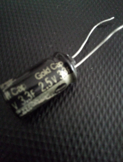

Can you get me a picture of that 3F Capacitor, Please.. do not see that one in your Picture from here..

Oh sorry, I took the photo some time ago... didn't post it: here it is. The capacitor is removed, and it was getting too hot. I am looking through the threads for a good class A circuit to build next. No more fake circuits from You Tube.
Here are the measurements: C1: 50V, 1 uF, C2: 2V, 3F
Power Off
C1: 0.199V
C2: 0.966V
Power On
C1: 0.5V
C2: 4.1V rising to 5.8V in about two minutes
As you recall replaced C2 with 47 uF and it got very hot.

It’s no surprise that it’s running hot with a 2.5 volt cap. Even if it were biased *properly* it would have 4.5 volts on it with a 9 volt supply. If you ran it on higher voltage, you might have confetti all over the room, and a capacitor can embedded in the ceiling.

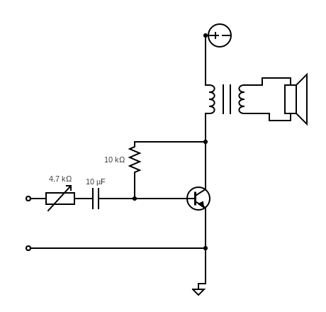

And if it were hooked up like post #5 (which is incorrect), the leakage current thru the cap is what is actually providing the bias path *through* the speaker. Output power would be very low, and clipping probably asymmetrical. Hence, the distortion.
Current amplifier circuit. Current meaning latest.
Right. Thank for saving my ceiling.

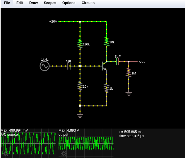

Redesign using common emitter amplifier scheme
Back to the drawing board. The simple one-transistor amplifier used as examples will not suit our purposes here. The next step up is the 'common emitter amplifier' - many examples from the more experienced lets say electronics experts online.
The Falstad circuit example seems to be quite standard, so I will use that as a basis. I already have the TIP41 transistor at hand, so here it is.

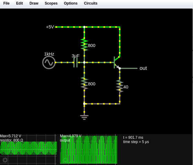

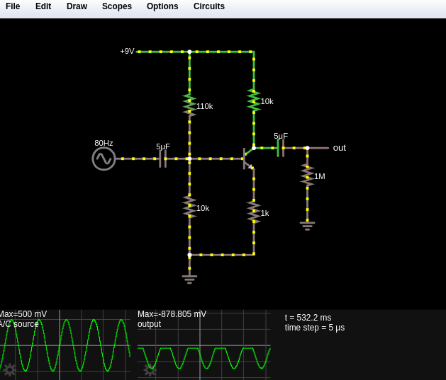

I want to use a 9V power supply, but that drops the signal into negative territory. How do I correct this? I tried changing the bias resistor but to no avail.
The other one is an emitter-follower setup which uses only 5V.
Say you have 9V supply, you want the queiscent collector voltage to be about 5V.
Decide the collector current you want, lets for the sake of an example say 10mA.
Then the collector resistor must be 400 ohms = (9-5)/0.01
For a gain of about 10 choose emitter resistor of 40 ohms. In practice that's 390 ohms and 39 ohms.
Thus the emitter voltage will be about 0.4V (0.01 * 40)
Thus the base voltage should be Vbe+0.4 or about 1V (Vbe is around 0.6 to 0.7V in
typical setups). So the base bias resistors could be 10k and 82k, dividing 9V down to about
1V. Tune these to bring the collector voltage to 5V.

BasicHifi1: if you are going to progress, why not start with the collector load you are likely to need (say 8 or 10 ohms to match the speaker) and then follow Mark T's maths to calculate the remaining three resistors.
Then plug that into your simulator and see if you get a signal out.
Simulators can be as useful as a "sketch on a napkin" even for simple circuits. But if you can't grasp the fundamentals (ohm's law) it's going to be an uphill struggle.
You actually don't need a simulator for such a simple circuit, but a calculator is handy.
