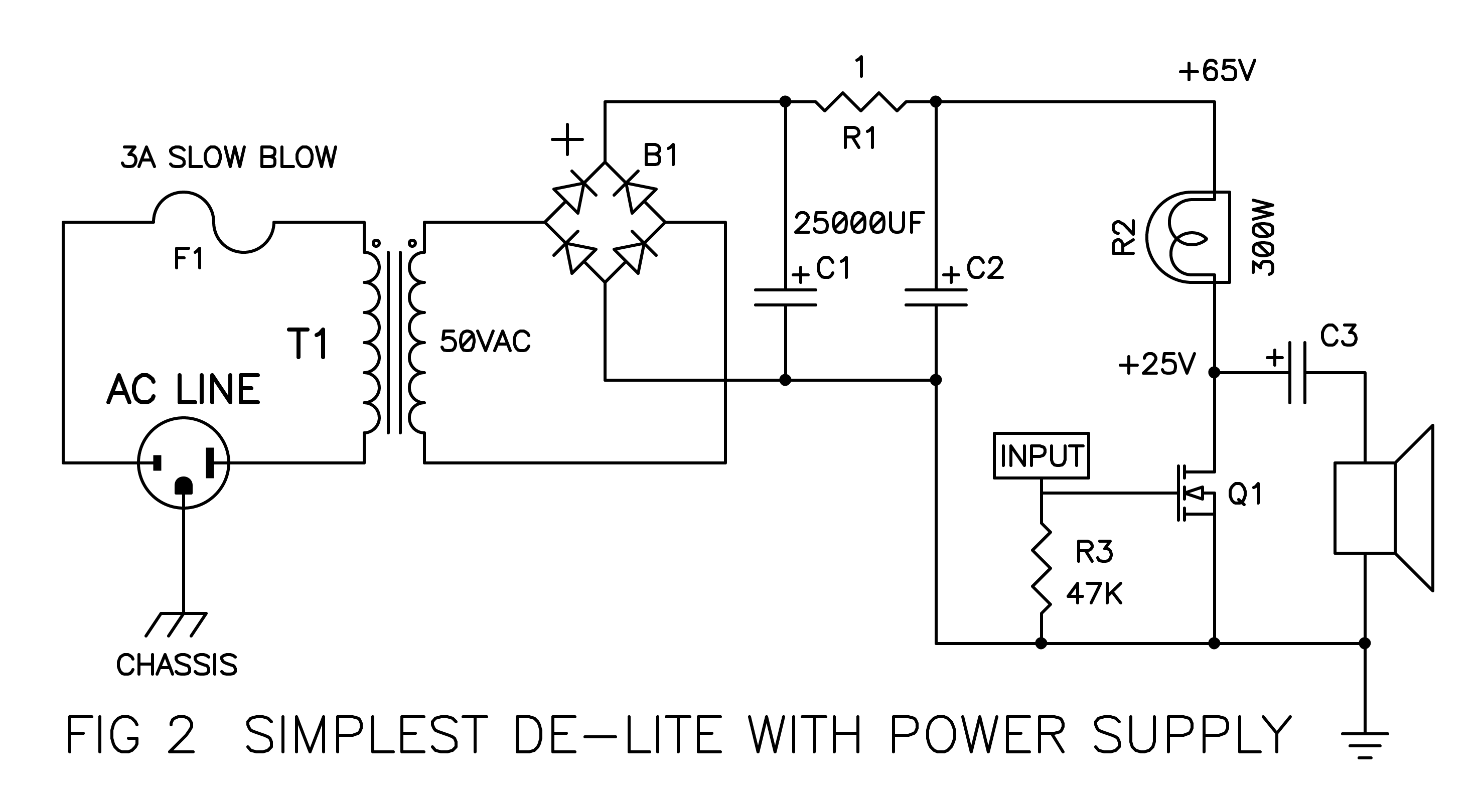

If that were my design I would choose to use a 50W power resistor and put that on an additional heatsink.
Many computer grade capacitors have equivalent series resistance and inductance (ESR, ESL) specified and are low which would make additional parallel components unnecessary.
But the circuit obviously works as shown and would probably work with many other FETs too.
Running at 9V pushes the FET into its low voltage "triode" region and if you need that to be reasonably linear, a higher current (low on resistance) FET may be better and at low voltages there are many high current/low on resistance devices to choose.
The circuit is not so different from your original concept (using a load resistor😀 ) and it could work with a bipolar too, but at lower voltages quasi-saturation will give a non-linear response too so that means it competes with a FET for best performance! (and the BJT will need a much lower bias resistor closer to your 270 ohms to provide base current)

For simple amps…
Here is one of the simplest amplifiers by Nelson Pass. I have always wanted to try this one:
A mosfet and lightbulb. Doesn’t get much simpler and you can use solderless P2P connections for this one I am sure. The above needs a depletion mode FET though. Probably LU1014D would work with a lower voltage like 19v laptop brick.

That resistor you found is the sort I'd choose, but reminder that it needs a heatsink depending on the actual power it will be dissipating.
The value of the resistance depends on the volts/amps you want out. That, in turn, depends on the power out and the load resistance (loudspeaker being the ultimate load).
A simple amp could, maybe, provide a few watts. If you want to runthe design at 9V the optimum you can do would be 3V into 3ohms, needs 1A peak, gives 1.5W rms out.
THerefore the collector/drain electrode has to be biased to 3V while having a reasonably linear capability to swing to a low voltage (Vce(sat) for a BJT or limited by Rds(on) for FET; but that may well need a significant gate voltage drive (depending on the FET characteristics)).
In short the resistor needs to drop 9-3=6V and pass 2A (making the transistor work at 2A as well) so should be a 3 ohm device with 12 W dissipation. So a 25W resistor would be adequate for this example.
As well, the transistor has to pass up to 4A peak and go to zero, a large signal swing, with potential for distortion figures of 10% or more without decent feedback.
If you don't follow the reasoning behind the figures, you really do need to learn some basics and I'd concur with JMFahey - I missed the point that the course was not actually a Georgia Tech one nor seems to be accredited. Many older books will cover the basics although quasi -saturation dates from perhaps the late 70's when epitaxial base technology became the dominant method of manufacturing (existed before then but it takes techy books a few years to catch up). Power MOSFETs too only appeared in the 80's so looking up IR's (now part of Infineon) early Hexfet info may be useful.
As a simple evaluation what is the efficiency of the circuit if the collector (assuming a BJT) load resistor was 3 ohms and the speaker impedance was also 3?
You should be able to work out the (collector) load resistance for peak efficiency? (as a ratio to the load).
(Clue: you just have to assume that whatever transistor you use is able to be set to the volts/amps needed, however that might be achieved in practice i.e. don't worry about the device as such. Just see if you can use Ohm's law and power equations. And the peak efficiency is where the (collector) load resistor is not the same as the load!)
