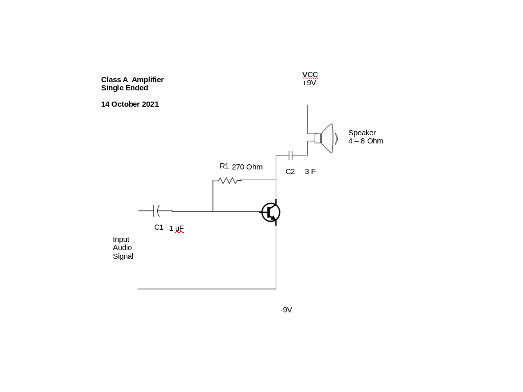

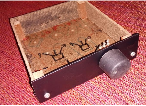

I ran the amp now at 4.5 V. The settings on the power adapter are: 1.5, 3, 4.5, 6, 9 and 12 V. The blurred picture shows the adapter. After about 15 minutes the TIP45A become too hot to touch, so I shut it all down. I need a bigger heat sink. On the positive side, the resistor did not become hot, neither did the other components.

In POST 131 I can see a Cardboard Amplifier run on a 9 Volts Battery named N2. I would not show such things here, that's more likely for Kindergarten or first Grade, especially after 5 years of Developing which has lead to nothing but Trolling. So why don't you stop to post that none sense.

This thing on your cardboard amplifier, with what you try to COOL down the Transistor is called a WASHER and not HEAT SINK. Remember that.

First of all, an update. The amplifier shown in the last circuit works, and puts out 85 dB at 1 metre, peak music output. The amplifier was run for several hours yesterday, playing music. It is running off an AC/DC adapter set at 6V. The sound from it is quite clear and distortion free except at the highest volume. I am very happy with its performance.
Thanks to everyone who helped. It is very much appreciated and my success was due to you.

That’s a *preamp* (at least the last circuit that was being discussed there is). I guess with the right transformer you could drive a speaker - very quietly. The basic circuit could be adapted to be a power amp to put out between a handful and maybe 10 watts. Output stage bias current would need to be run up, but a 3055 emitter follower would work ok up to maybe 2 amps bias. With a bigger heat sink of course.

Changed bias resistor
The circuit in Circuit Sim. Strange waveform.
I replaced the bias resistor of 10K Ohm with a potentiometer. I was able to increase the volume without distortion when I turn the potentiometer - there is a region where distortion is the lowest and volume is the highest, this at the highest input volume setting. I measured the potentiometer setting as 2K Ohm. The load resistor gets very hot, and only a 4 Ohm speaker.
