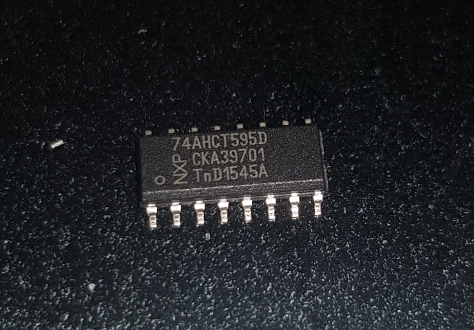

and... i have found this one.
Do you think is new nexperia or old NXP ?
they doesn't have the "X" new-marking on top, but not sure what to think.
