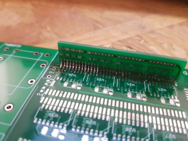

I don't quite understand the "solder bridge" you mention.
Could you make a picture of your solution?
like this
(not my finest job... please, don't judge 😛 )

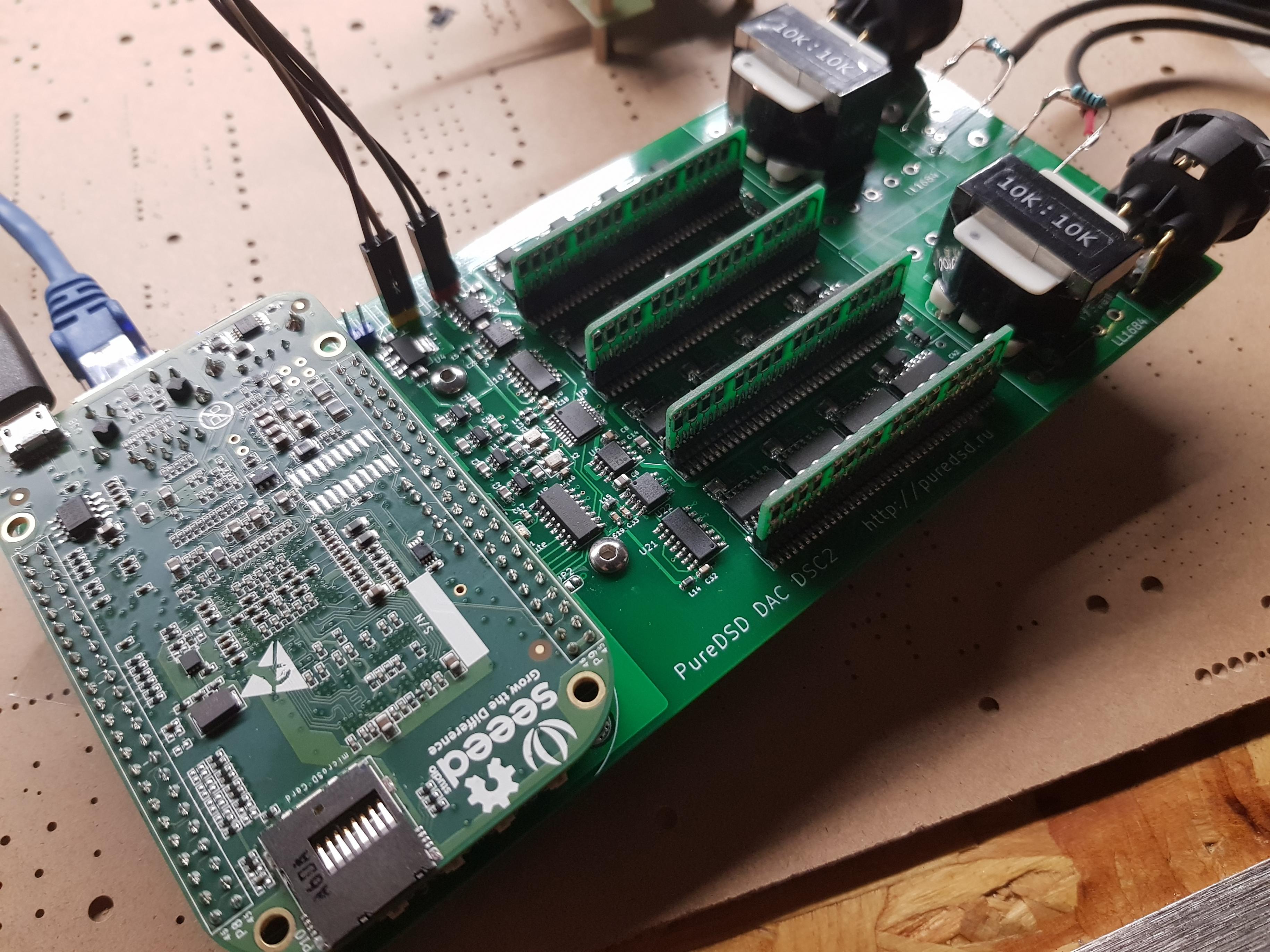

finally...
freshly baked from the modded oven...
beside few scary moments upon power-up...
now it sings...
and i am speechless... maybe for lack of better comparison... but this thing to me sound like nothing else...
addictive to volume to say the least.
Thanks to all the people that has contributed to make this project possible. Today guys you make a person happy. Feel good about that.
Very neat job Michele, congrats.
I fully agree with you, it sounds like nothing else. I join you to thank everyone that made this project a reality and for sharing it with all of us.
