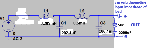

Attention guys I don't hear any kind of pop click using abraxalito 4th passive filter when I change formats between DSD & PCM or viceversa, only a pop when power on I guess because I don't use a bleeder resistor after the output capacitor. Attached schematic.
