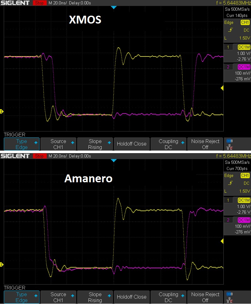

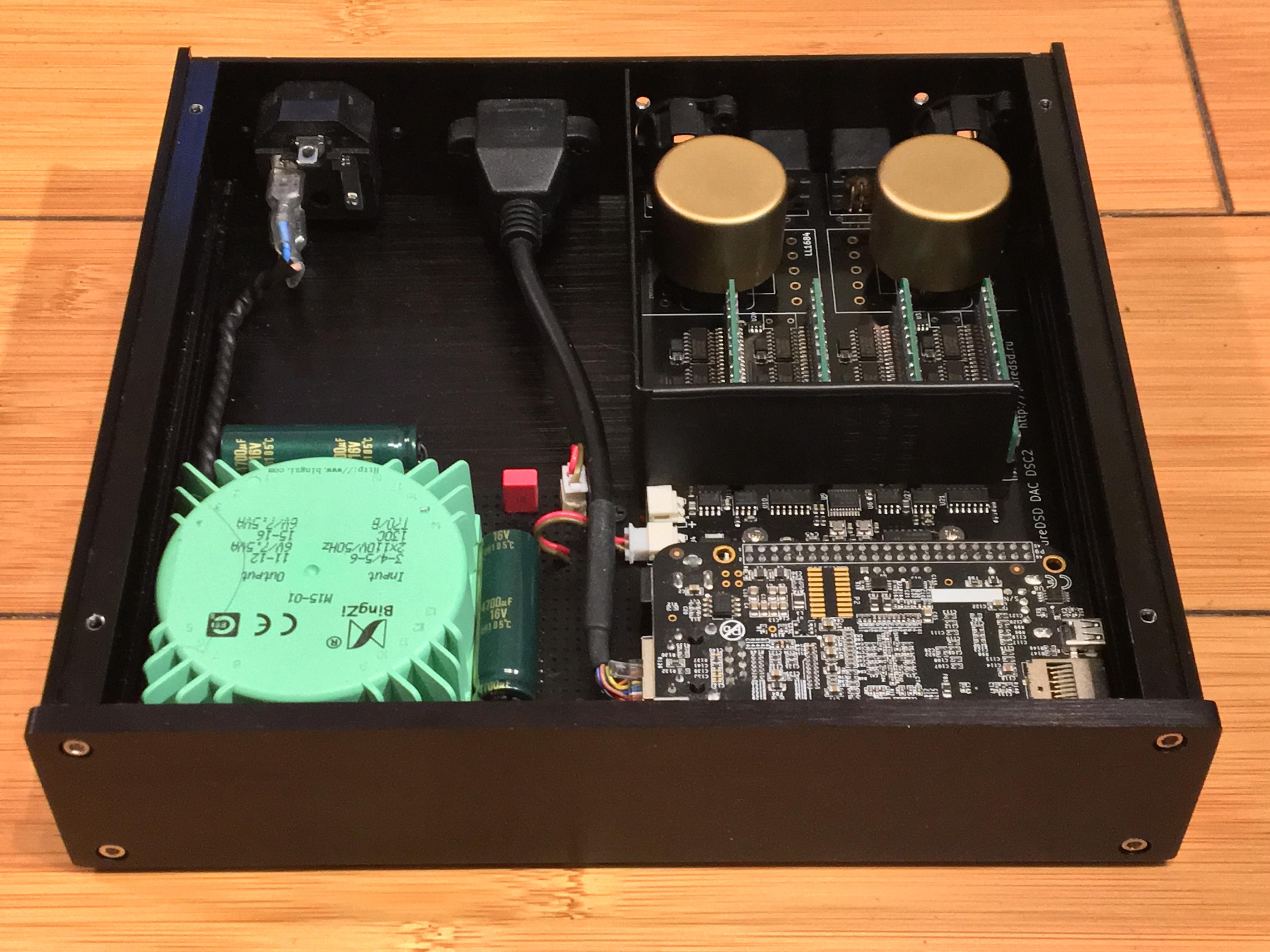

I just finished building a DSC2 board.
I was experiencing noise in the left channel; after investigating I found that touching the clock lines (outputs of U11 and U22) with a finger or an oscilloscope probe, I could make the noise disappear in the noisy channel or appear in che clean channel. I added 4x 220R terminations to ground across pins 8-11 of U15, U19, U26, U30 (74AHCT595), that is at the end of the 4 clock tracks. The problem disappeared and the board is not sensitive anymore to external contact on these tracks.
Hmm ... This problem used to be when using only Xmos and DSC2.5-2.6 versions.
The fact is that the Xmos MCLK phase is slightly different from Amanero. And apparently the registers AHCT595 were in a metastable state.
You also slightly shifted the MCLK phase with resistors.

It seems to me that in my case it was a simple problem of reflection along the clock line.
The sensitivity to external contact on the trace was almost zero at the output of U11/U22, while it was very high close to the last 595's of the line (U15, U19, U26, U30).
Do you think the phase shift could be a problem?
