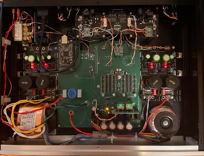

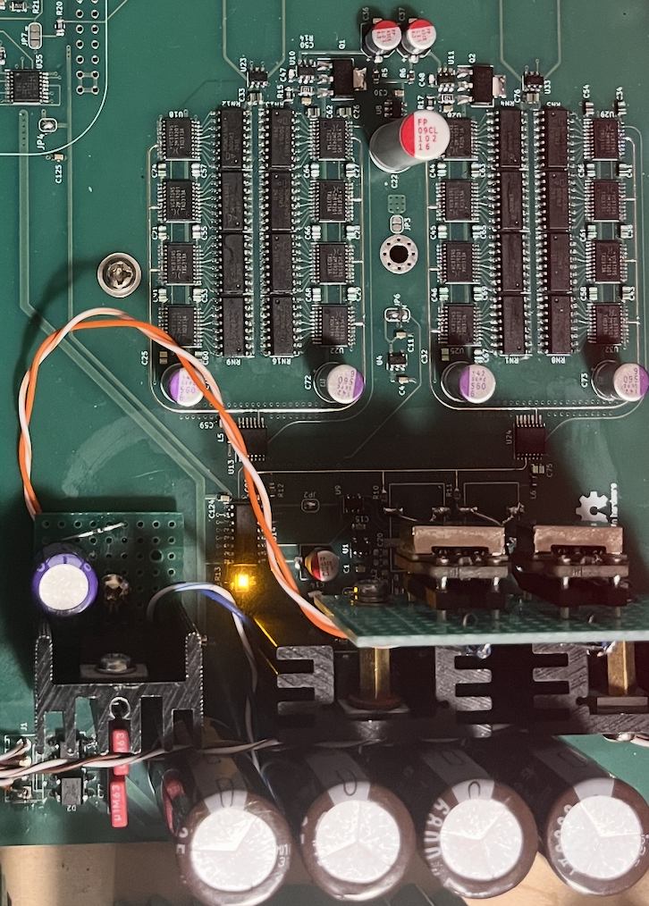

Since I am using Amanero, the second power feed is not used (for BBB).
The trace is cut (ground is on dirty side) to feed an off board 5V regulator to the onboard 3.3v regulators for the clocks separately,
Ferrite bead is not used, just 5V directly to LP5907.
This is an easy and very positive upgrade.
By the way, the bypass capacitors are all upgraded to Rubycon MU.

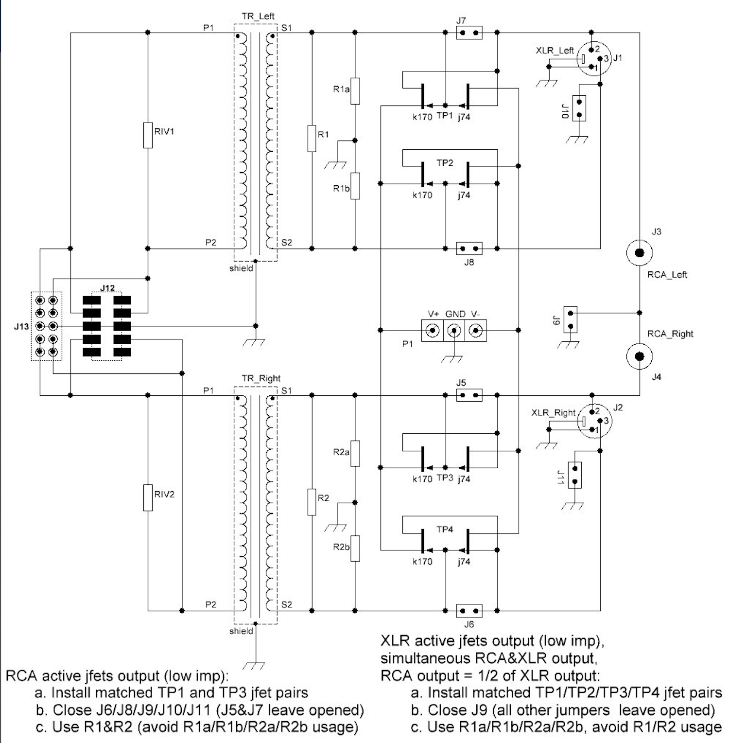

Made one with Bisesik's 1:16 Ag:Ag transformer + buffer, primary loaded with 22R AN silver Tantalum.
You should hqplayer letting remodulating the DSD source, sounds better. More often then not, DSD source modulation is not all that good. In addition, source material, if good quality without too much compression, almost always is at -10dB or less at average. Exactly there where the DAC performs optimal.Any concern changing Vccb on 8T595 from 5.5v to 3.3v to lower the output -4.4db?
I see bandwidth wide enough from the spec.
Reason about that is the transformer performs better with lower input (-8db to -10db from HQP)
With PCM material, HQPlayer can control the volume.
While for DSD material, with direct SDM volume control is disabled.

Cześć, czy mogę użyć bezpośrednio podłączonego niebalansera Broskiego zamiast transformatorów?
Hi, can I use a directly connected broskie unbalancer instead of transformers?Cześć, czy mogę użyć bezpośrednio podłączonego niebalansera Broskiego zamiast transformatorów?

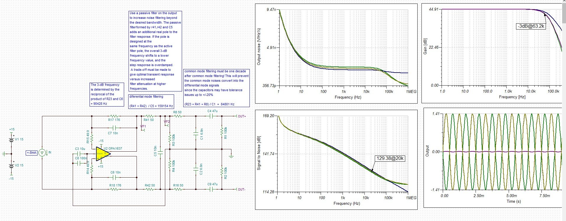

I going to implement dsp so that analog tone control I no need anymore, so I have simplified my frontend for dsc2. Transformer or this one frontend instead, whats your opinion?
does broskie unbalancer act as buffers too?Hi, can I use a directly connected broskie unbalancer instead of transformers?
