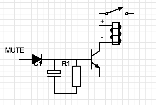

Problem I have right now is pop noise during sample rate change can't be muted.

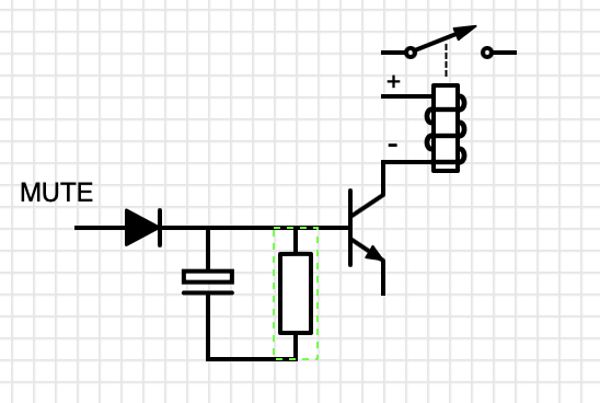

What is this noise!? Is it the noise (pop) when Next/Stop to Play!? If this is the case, I think it can be solved by delay the Mute signal with RC.
It's the pop noise switching tracks when there is rate change 44k<>48K, background noise I think the DHT is louder.
With hqplayer and BBB/NAA, this mute delay needs to be 2-3 seconds at least.
Will play around with the mute line.

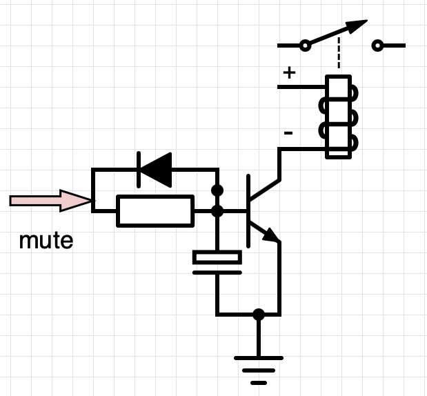

Correction, mute pin is 0 for mute, 1 for music.
There are two pops during rate change,
Initial one is so quick even though relay responds right away.
Second one can be muted with delay (3K & 15uf).
I am using the default JP5 (PIN28) and JP6 (mute MR pin on 8T595)

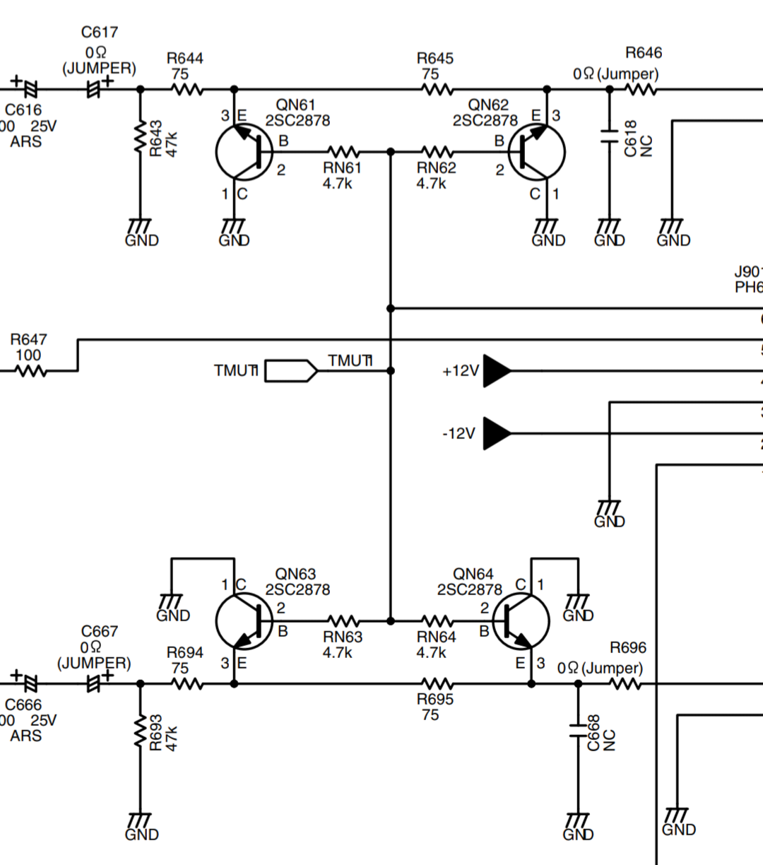

I would never use a mechanical Relay for muting as it always has a large delay and often has a Pop when the contacts hit. Instead I would use an Opto-Transistor at the final output of the Analog. The Opto input can use a Schmitt-Trigger like SN74LVC1G14/17 for buffering. The front of the 1G14/17 can use an R-C (Ceramic) for Delay. Commercial products often use this method.

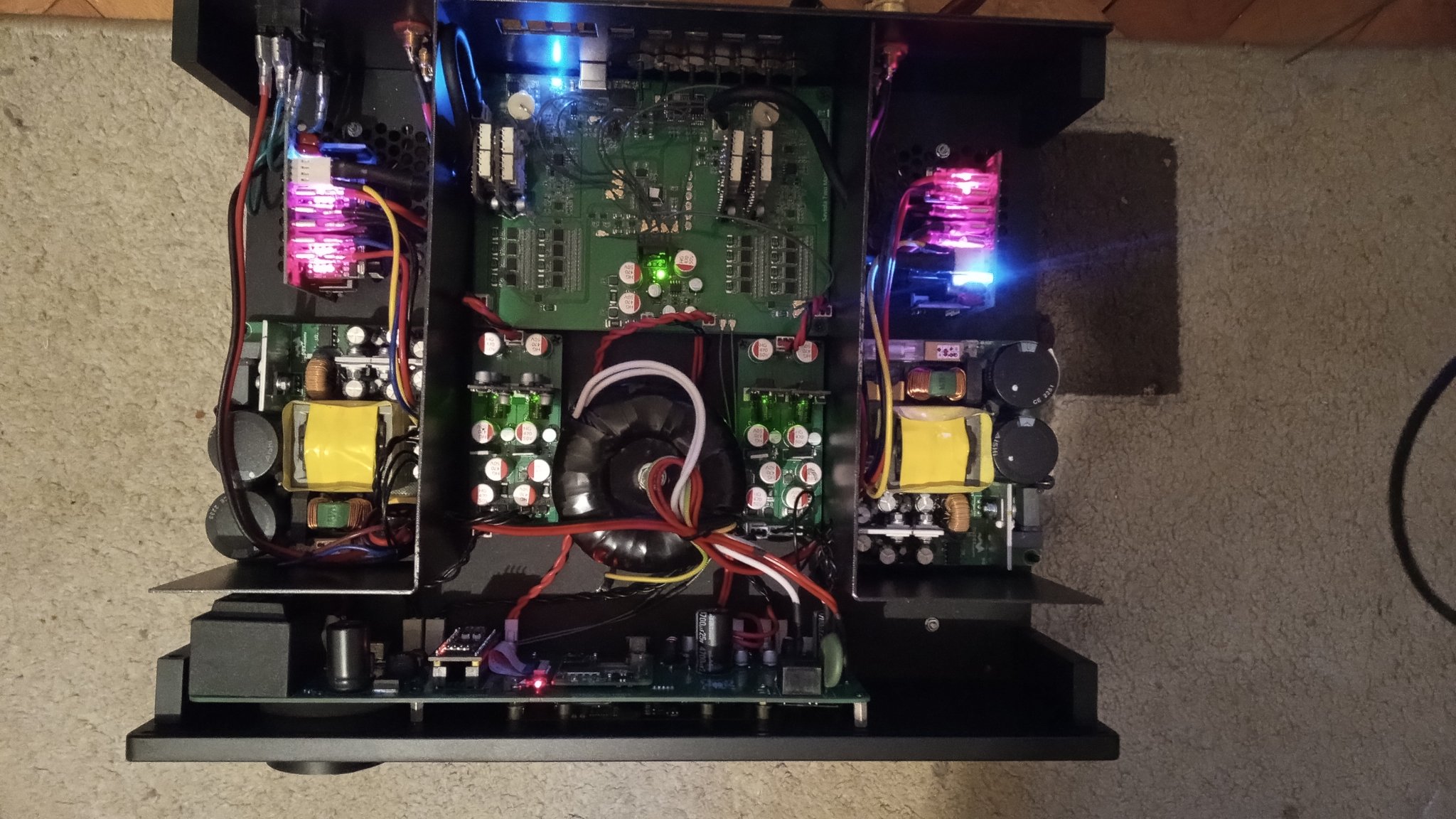

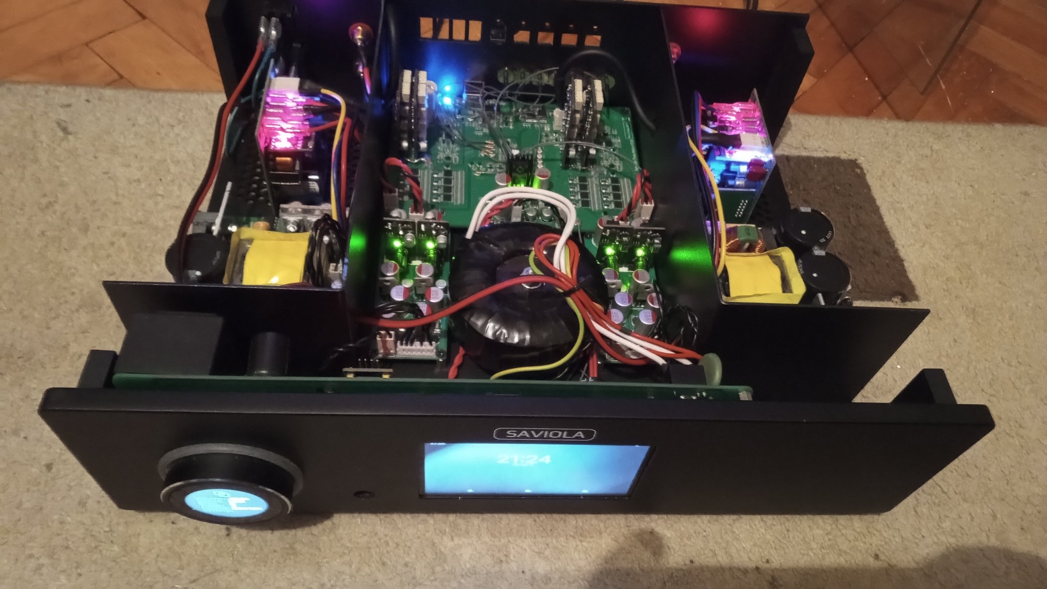

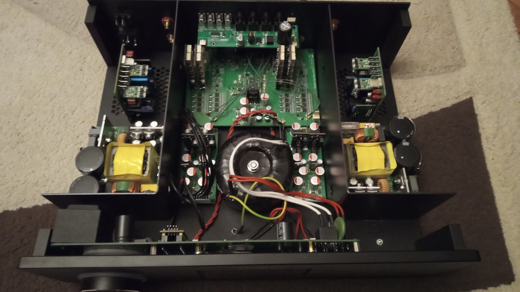

After so much development, problems, finally got sound from the device : ) The relay based tone control is definitely worth it, the treble has become nice and soft, I'm very happy. Next is shielding, I have to shield that analog part with something, in revision 3 everything will go horizontally and the preamp + tone control have to be shielded, I'm very happy, especially that I finally managed to get the device running, I'm also very happy that I removed the Amanero and replaced it with the ct7601, it works very well. Plan for version 3 is: to move torus transformer to the front panel, and make single main pcb, that way is easier for mount and in the same time the less wiring, better. More shileding. Two more section regulators, the free space will be nicely filled to the max.

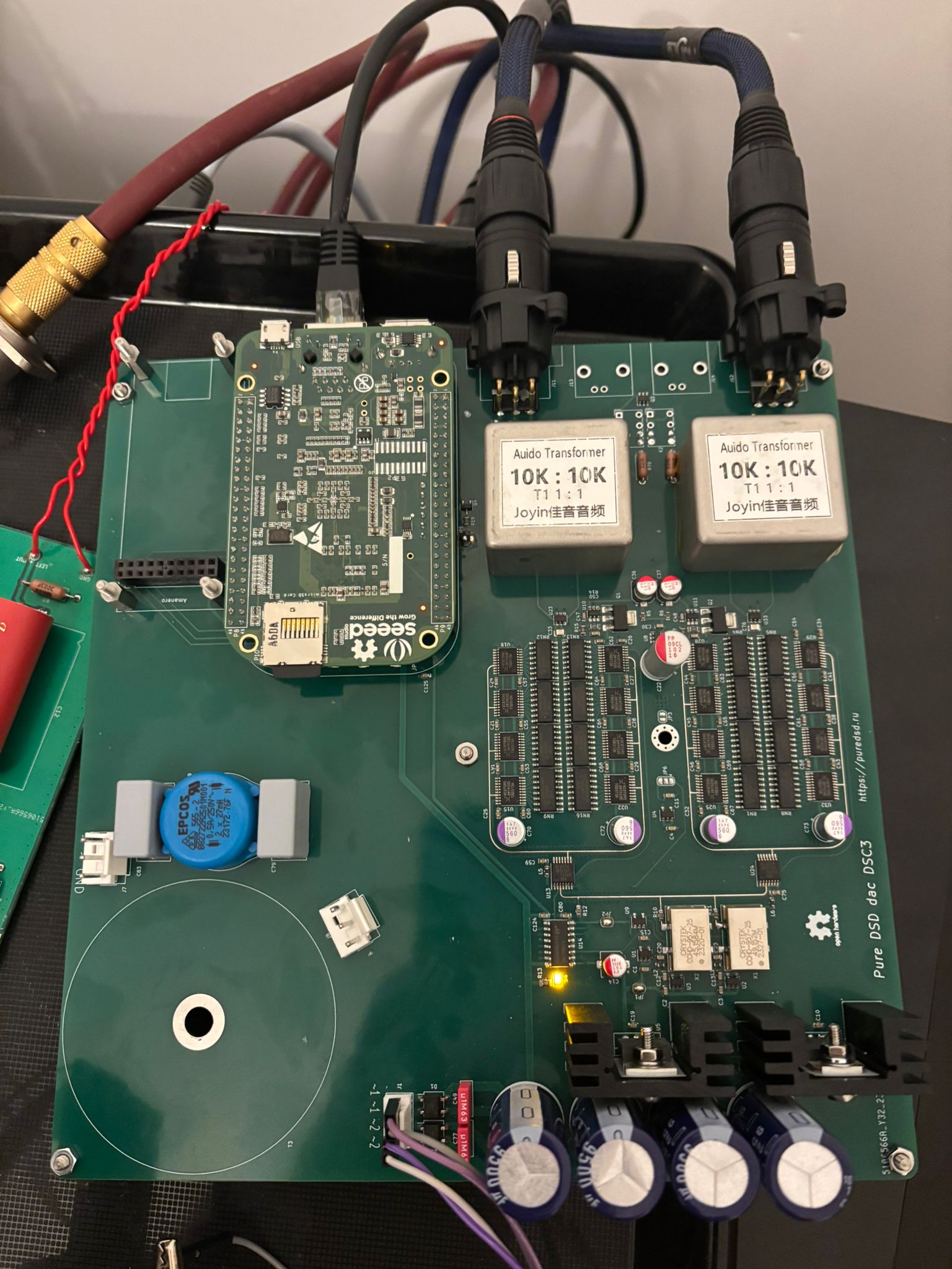

Hi all,
I just finished assembling the DSC 3 board. Transformers are on order (using a LAB DC PSU for now). I must admit I had a few problems to get the DAC to output signals. I have not yet manage to get it working with the Amanero but with the Beablebone works ok for me.
I have bypassed the relays for now. I think that they are the wrong model in the BOM they should be IM03TS non latching instead of the ones in the BOM v2 (IM43TS are listed in the BOM, easy mistake to make when building a BOM that big. These are latching and to unlatch then a negative voltage is required, yes strange). I was seeing a signal on the I/V resistor but I was losing it after the relay so for now I have bypassed the relays but I am seeing that some people are experiencing POPs during rate change so I might put them back (IM03TS).
Also I have taken some notes from the assembly and test process so I will share it just to hopefully help some people as I found the lack of a guide the biggest obstacle to building the DSC). There is not much in terms of original content but merely a collection of forum post information/notes all put together in one place.
The DSC3 sounds very nice but a little different from my reference (Holo May). I have found that the HQplayer settings make a big difference to the overall DAC tonality so it is difficult to compare it with another DAC. Ultimately I will compare the DSC3 to the HOLO May by playing the same DSD upscaled content from HQ player on both DACs to compare Apples with Avocados 🙂
