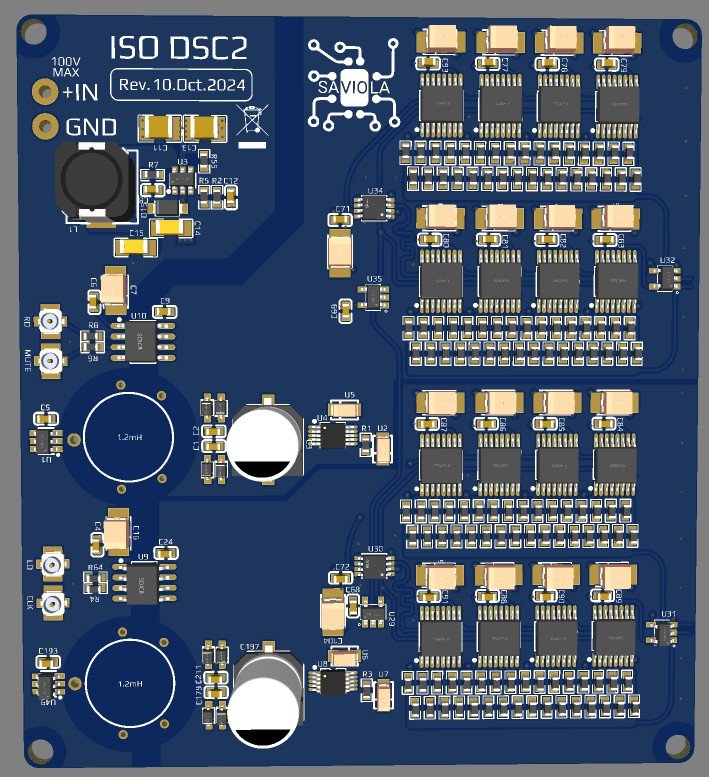

Work in progress on isolated dsc2, Dimensionaly to expect something like 790 x 900 mm.

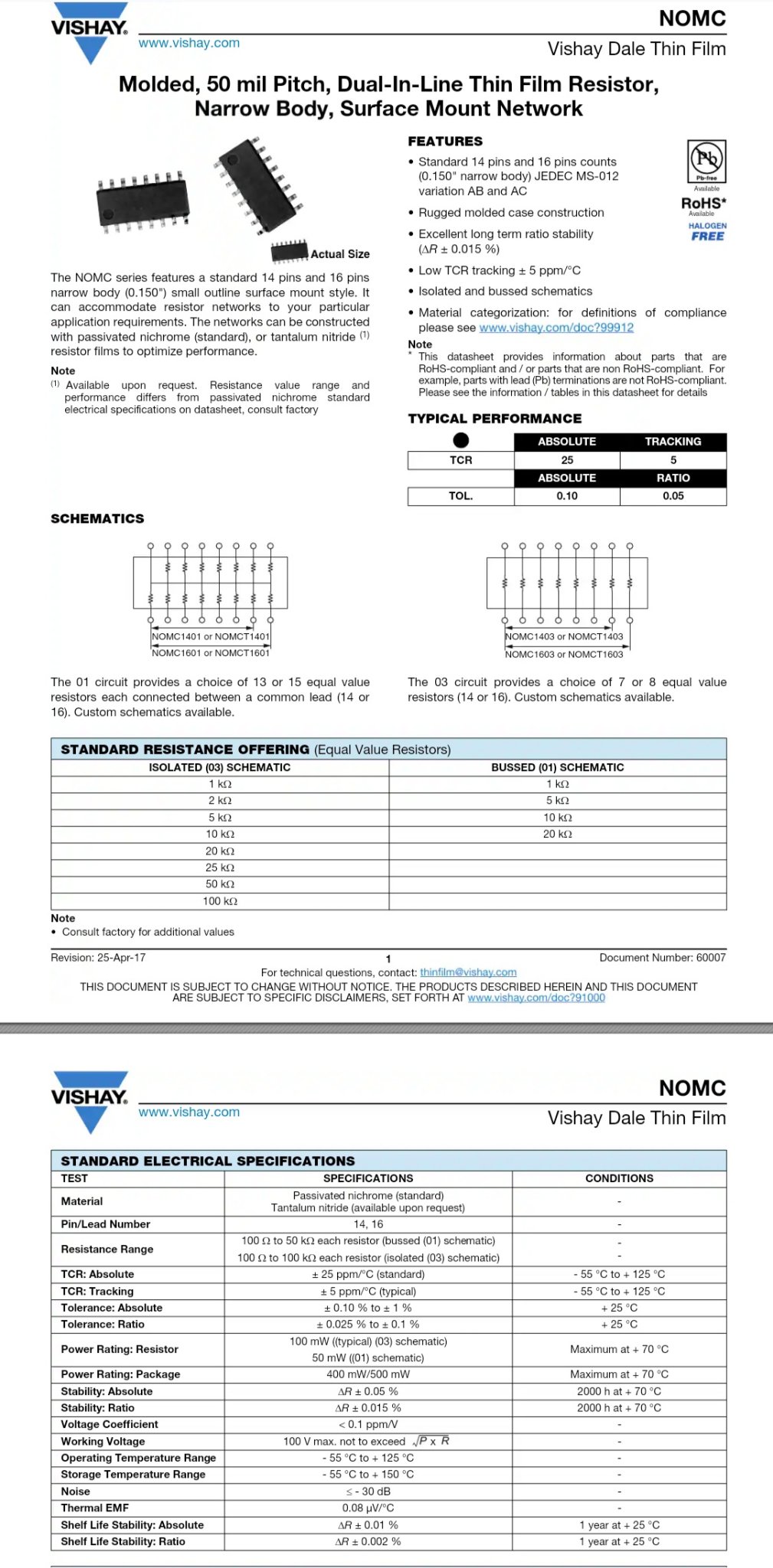

Your link to the resistor does not confirm whether it is passivated nochrome or tantalum nitride.
If the shift resistor is not a max 5.5 type, you will have less performance and less output level.
The shift resistors have been tested extensively and all sound different, see earlier stages of development in this topic.
The original DSC1 design used deliberatedly 74AHCT595.
I would advice against your choice.
Sorry, I mean shift register, not resistor. The 74AHCT595D works with max 5.5V power supply (so you are able to get output level of 5V with the right supply) and accepts 3.3V input level. That is what you need.
With respect to the resistor, see the note in the datasheet that tantalum nitride has to be specifically consulted with the manufacturer. If you don't do that, you will get passivated nichrome which does not sound as good as tantalum nitride.
