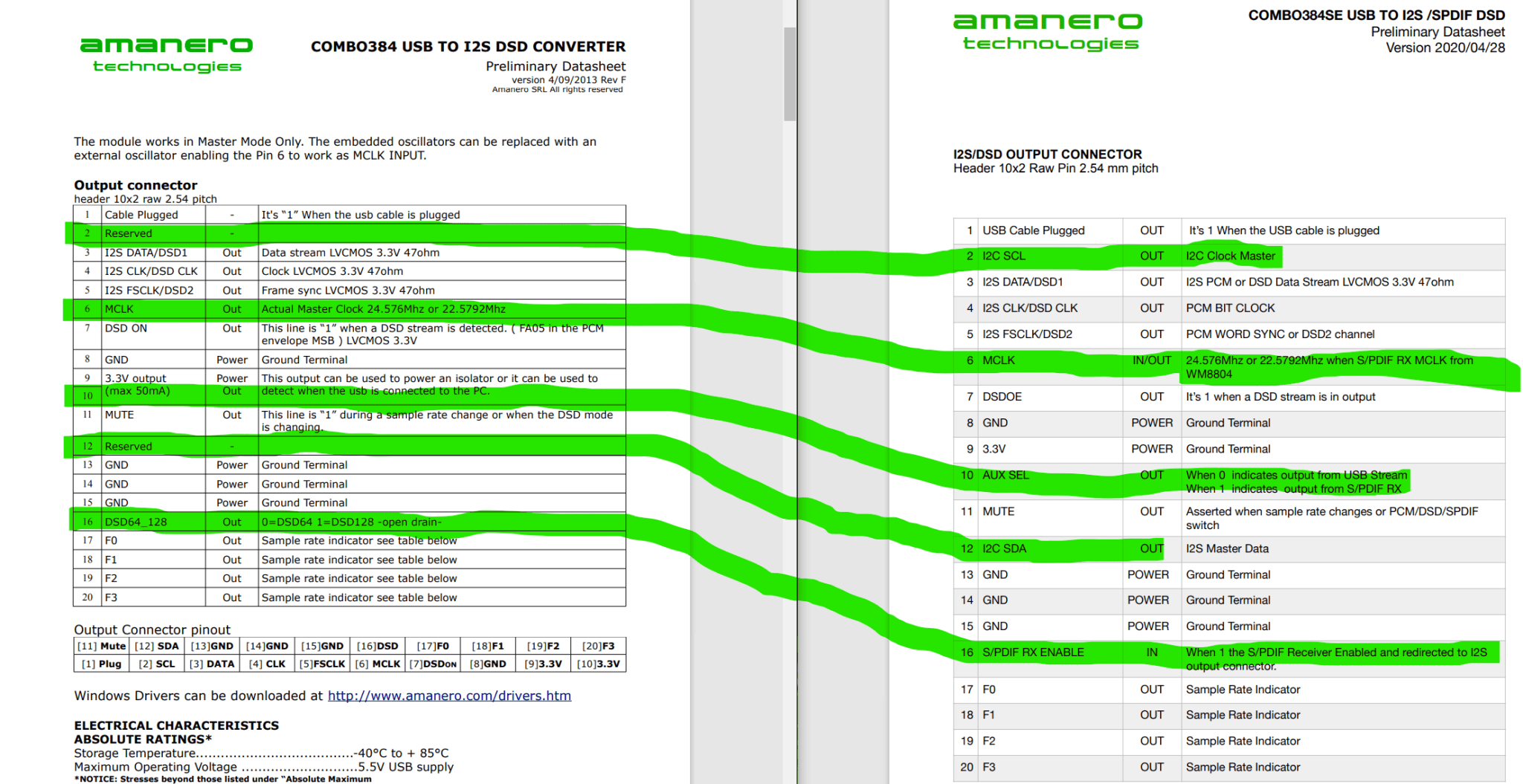

In second DSC3 i have combo384SE and i search for some information and i got it ... so : not pin compatybile?
the one with no sound and 3v3 from u13 u24 ..... not 1,6v like in the first one ....
My first DSC3 only works with CPLD 1080 and FW 96 etc. (old amanero combo) only DSD256
i change the pid to _023a ant still same ... hqp dosent recognize when I flash it to CPLD 1081 and 2006 FW with proper bit configuration

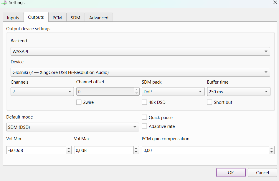

Can someone tell me ho to install this xmos drivers??? .... i got UAC2 .... hqp dosent recognize .... Xmos software dosent connect...
In menager i see "Xingcore USB ..... " i'm just tired with this :/ ....

Dsdit + Xmos in slave working well
Can some send me a pics from HQP? how to configure it?

This Dop ... only this is working :/ ..... now i have no F idea whats going on i reinstall hqp.

I cannot setup the Xmos in my PC i try a lot of drivers right now. When I open a software for the Xmos and click connet then "No device found"
In normal mode and in configuration mode.

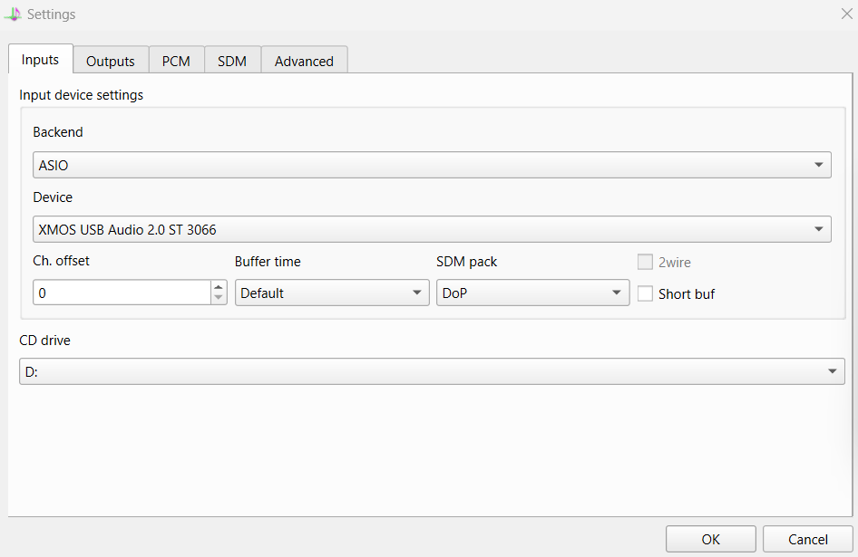

fight whole night, i have proper drivers now. On one PC when i set hqp an Input ASIO (sdm pack = none) Backend WASAPI (sdm =none) it plays DSD
On my PC for audio when i Set the same settings i have PCM mode ... bud when i set Backent to Dop it sends DSD

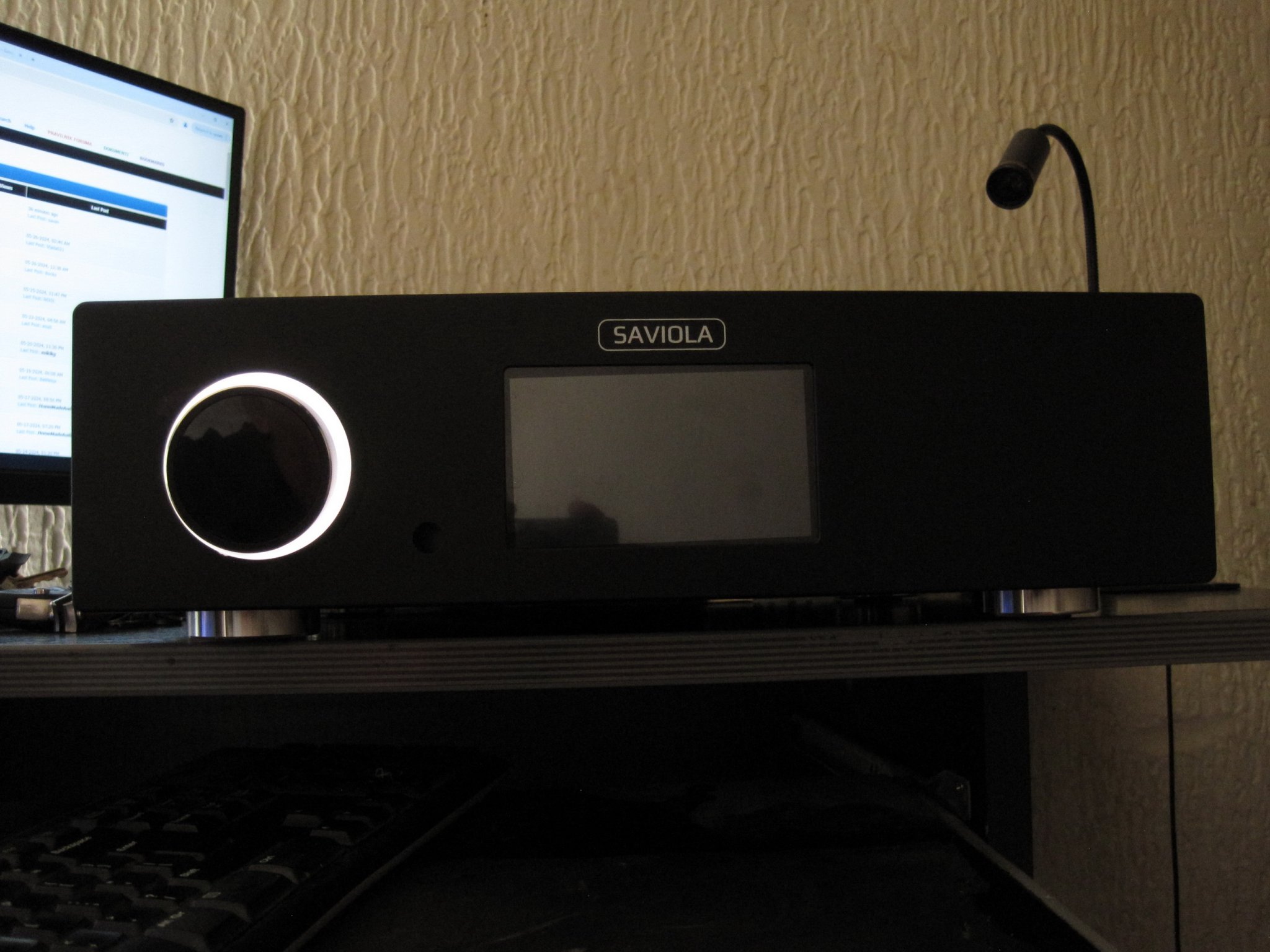

In relation to post I decited to abandon clasic power button and command structure on touch screen and decided to add Smart Knob which will be the main control thing so that CM4 is now free for anything else for example for an media server or android or whatever I like, no need to care about gui implementation and things : )
Smart Knob will get also an diy rgb ilumination so that whole things look even better : )

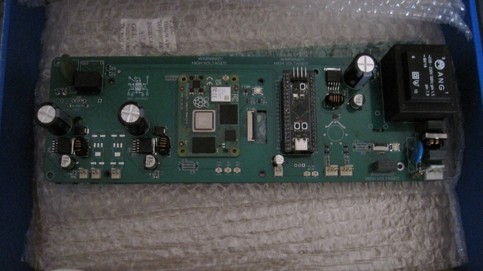

Done some work on modify front panel, hard work to make new hole and in the same time not broke anodized aluminium, done them and it look ok. Next time the transparent rgb ilumination panel will not have an edge that covers the irregularity of the drilling, but it will be without that edge, thinner, in the plane of the panel, it will look definitelly better. 3d printed and sandblasted, absorbs light very well, evenly, so I will only need 3 rgb diodes. Now time for finaly designing pcb with predregulators and power supply for cm4, some easy thiny push pull isolated regulators for smps on-off control... etc, and when it get done it will be time for designing inputs pcb, backplane and finaly aluminium cover. : )

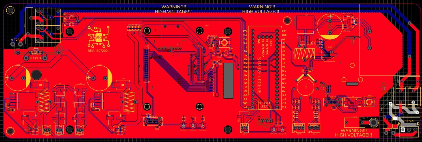

Pcb for the control panel, the most boring part, somehow I mustered up the will to finish it, it's going slowly, hope in next 30 days I finish front panel which will control our amplifer, I was bored doing it, a lot of work : )
This contain all the control things, soft start for main transformer, small print transformer to supply front panel electronics,, some iso push pull regulators, ir led, 4.3" display, smart knob, cm4 board... etc. After this get finished in our amplifier only remain back panel with optic inputs, usb, iso usb hub for cm4, bt antena... etc, the thing to design, and finaly top cover, those two things to the finish.
