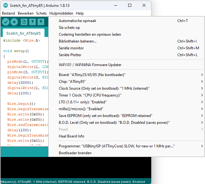

Thanks @jeroen_d for the replay 🙂... I juz buy a SparkFun PGM-11801 .... It is hard to program it with this AVR?
You better also buy this with the PGM-11801: https://www.sparkfun.com/products/13153?_ga=2.181346855.1244100876.1713855901-285933747.1713290558 and https://www.sparkfun.com/products/9385?_ga=2.106965506.1244100876.1713855901-285933747.1713290558
If you use Windows then use the program Zadig to install the correct drivers and so that Windows will be able to recognize the AVR programmer.
The AVR programmer then will perfectly run the test program with the LED blinking when you program with Arduino (I use version 1.8.13). See the hookup guide: https://learn.sparkfun.com/tutorial...76.1244100876.1713855901-285933747.1713290558
Use a 1MHz internal clock setting! And it will correctly show the LED blinking with a frequency of 1Hz.
But it will not be able to program the scetch provided with the DSD'it design by Pavel. For this, you need an extension of the Arduino software to be able to be fully compatible: https://github.com/SpenceKonde/ATTi...-head-submit-PRs-against-this/Installation.md
After this installation, you will be able to choose the right settings under "hulpmiddelen" tab which will probably be "tools" with an English version.
