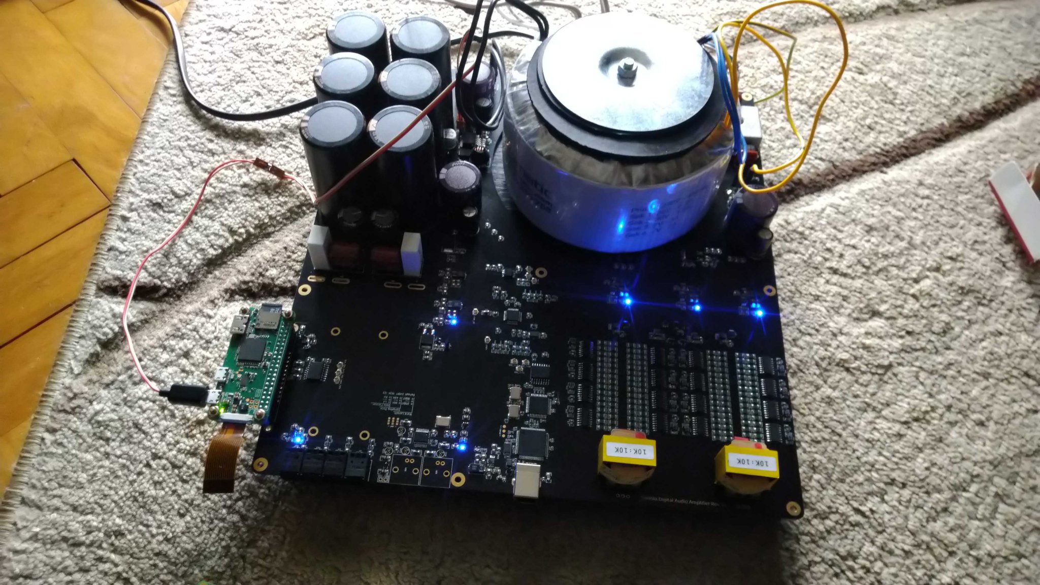

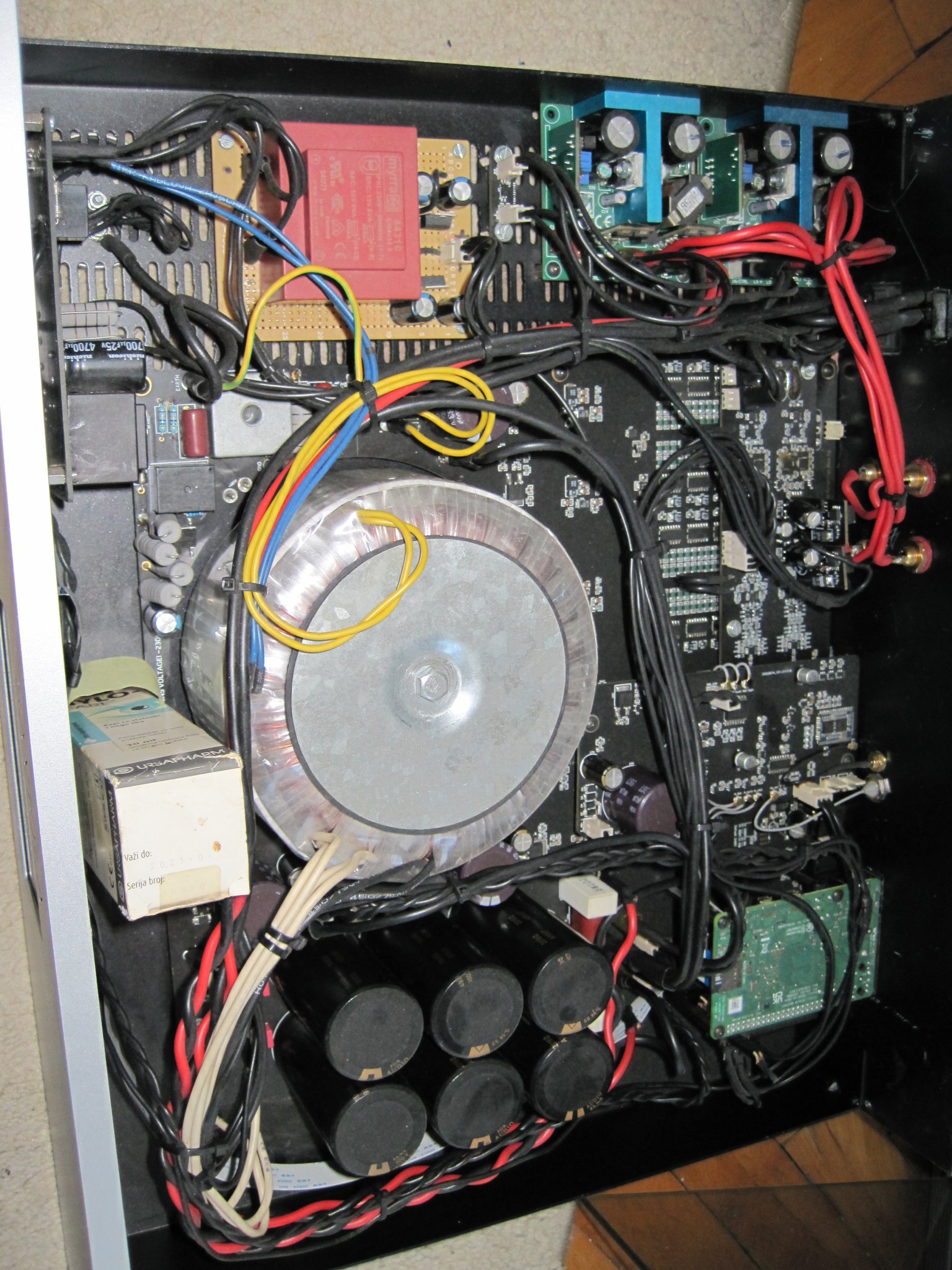

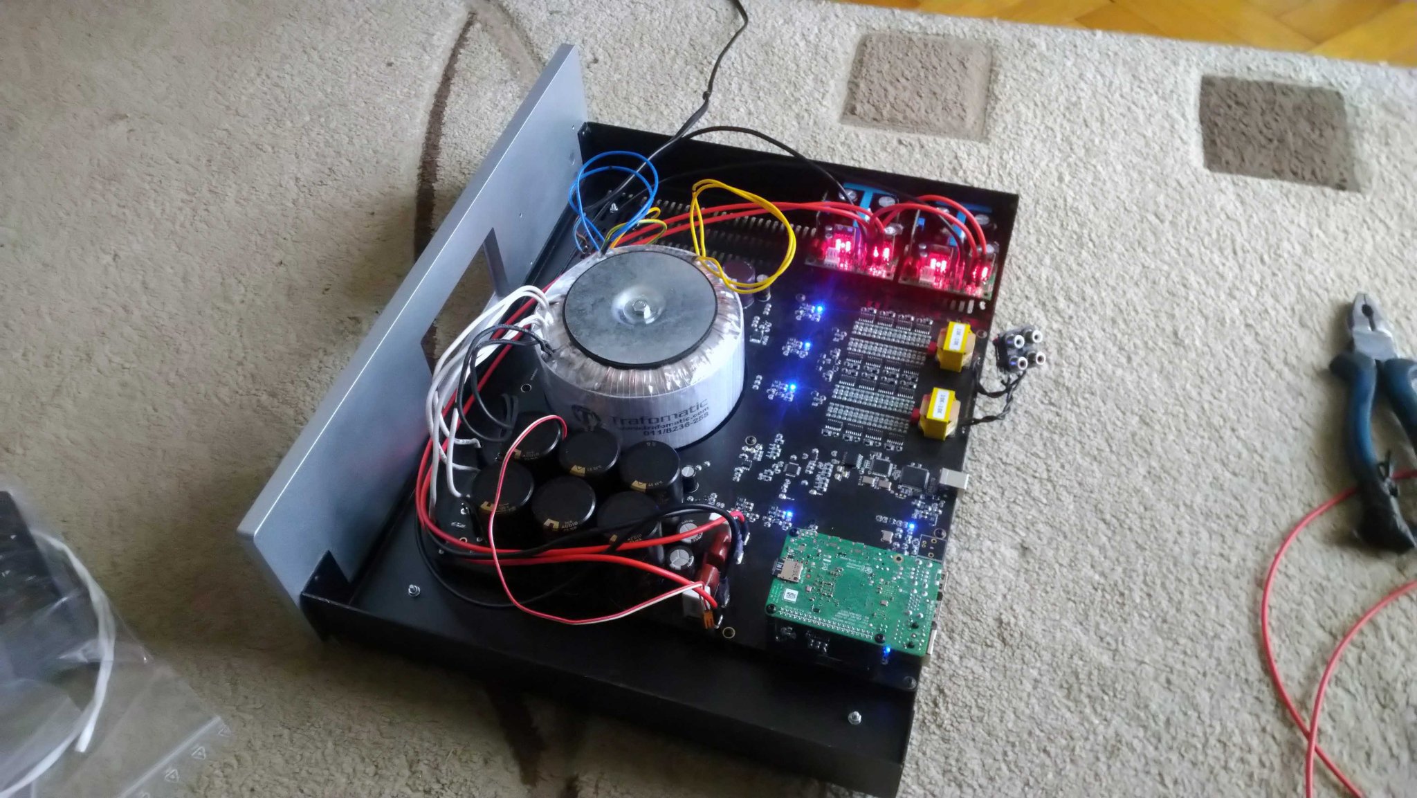

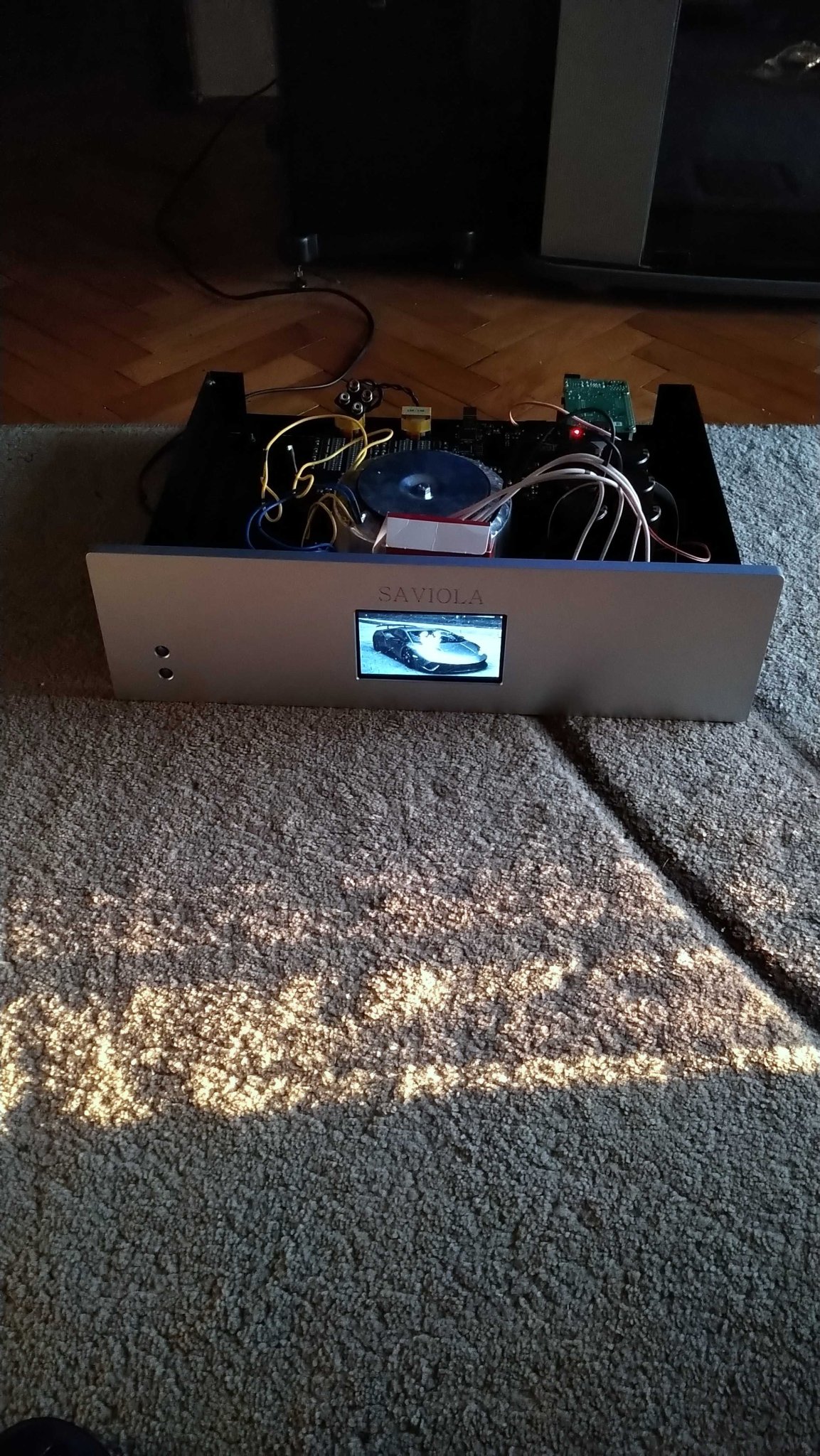

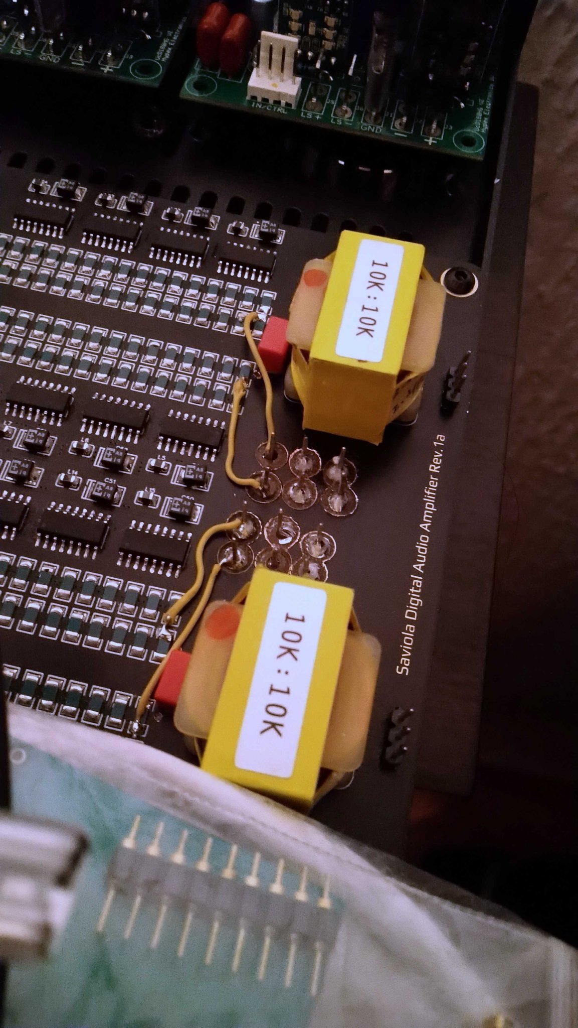

Some pictures from old development concept. Initial version was with yellow transformers, last two pictures is evaluation without yellow transformers, added tone control, bluetooth, fm radio... a lot of wires around and too bad layout, even with all that things I'm getting 17.9 enob which is a good result for too bad implementation and layout around with long wires : ) Now developing dual mono, half the size of dev version.

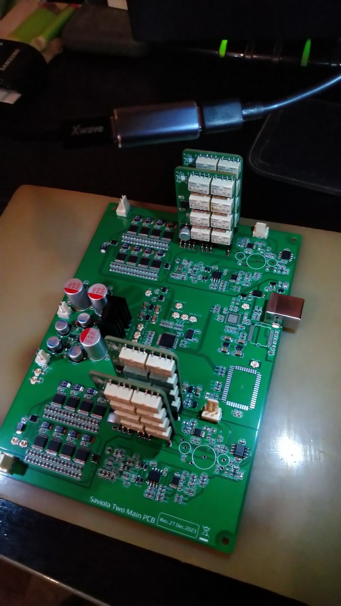

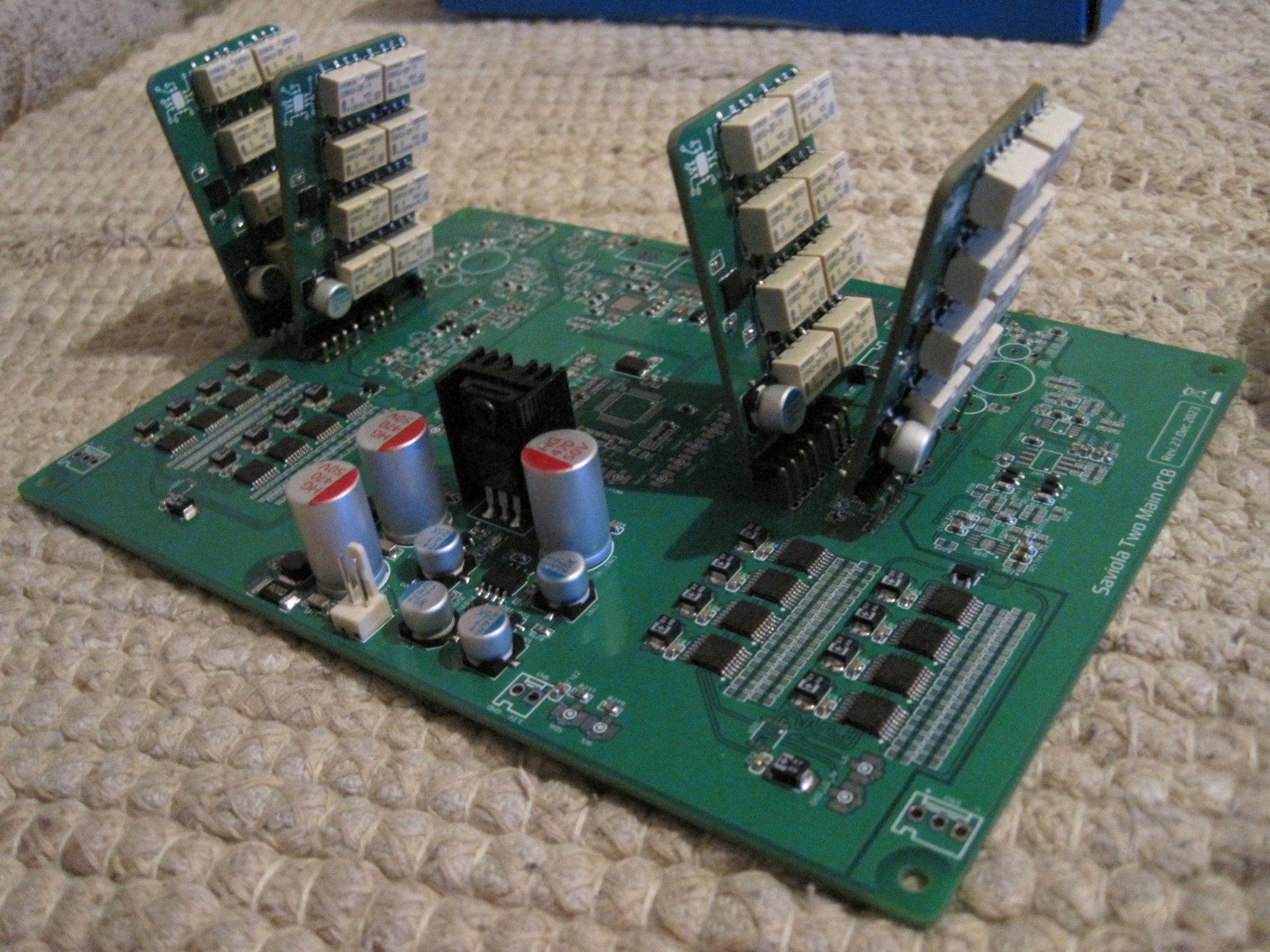

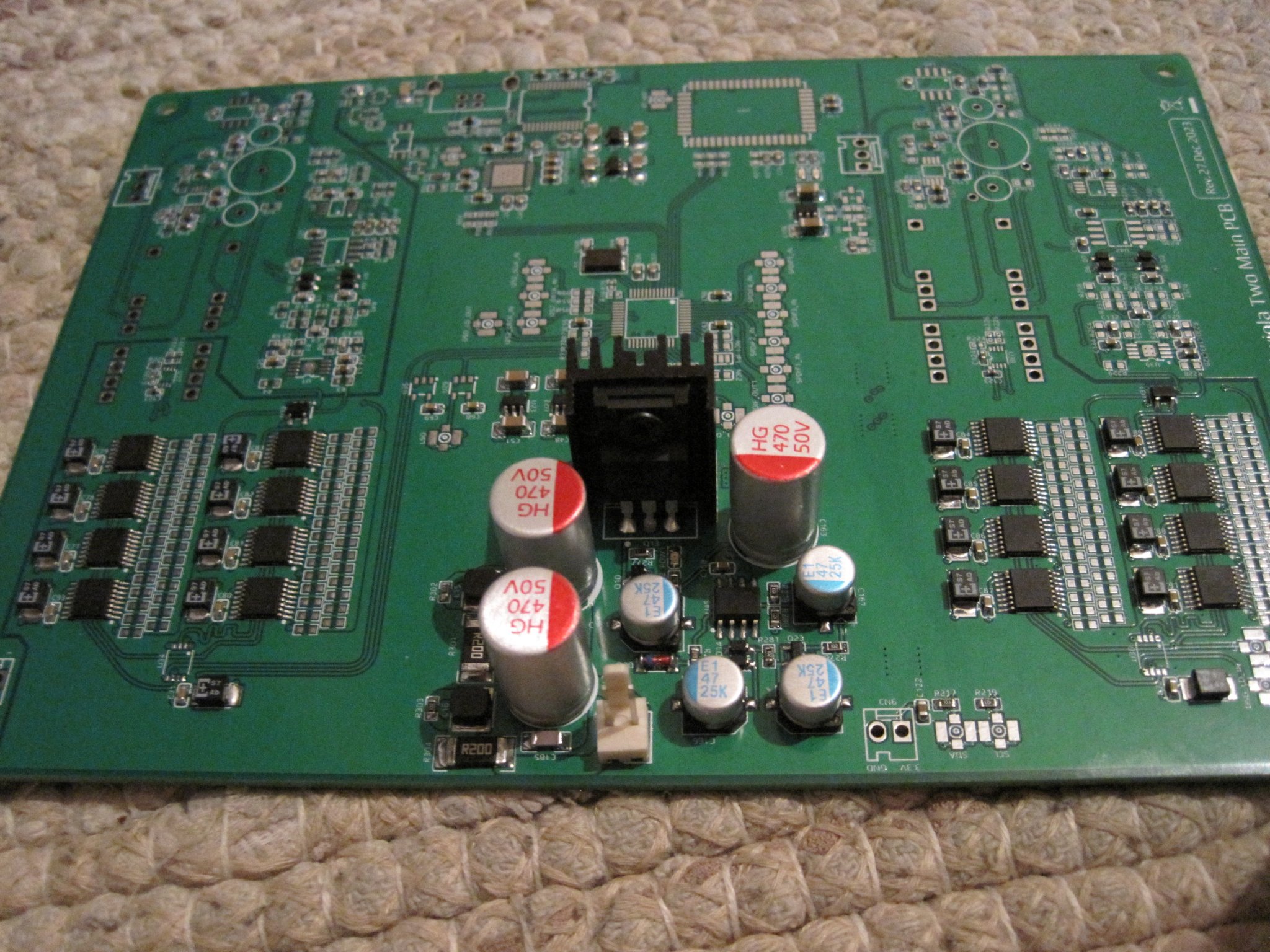

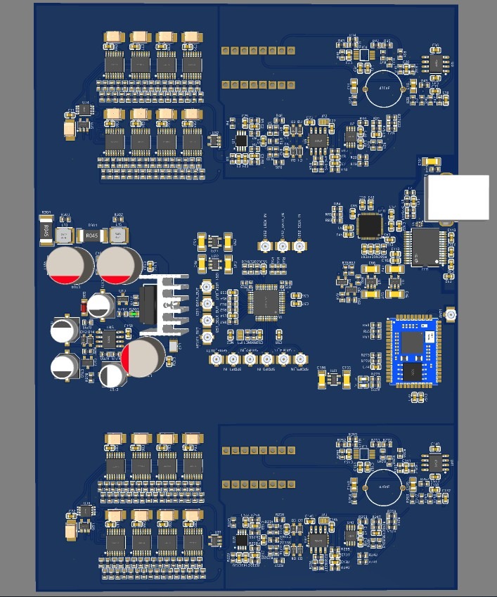

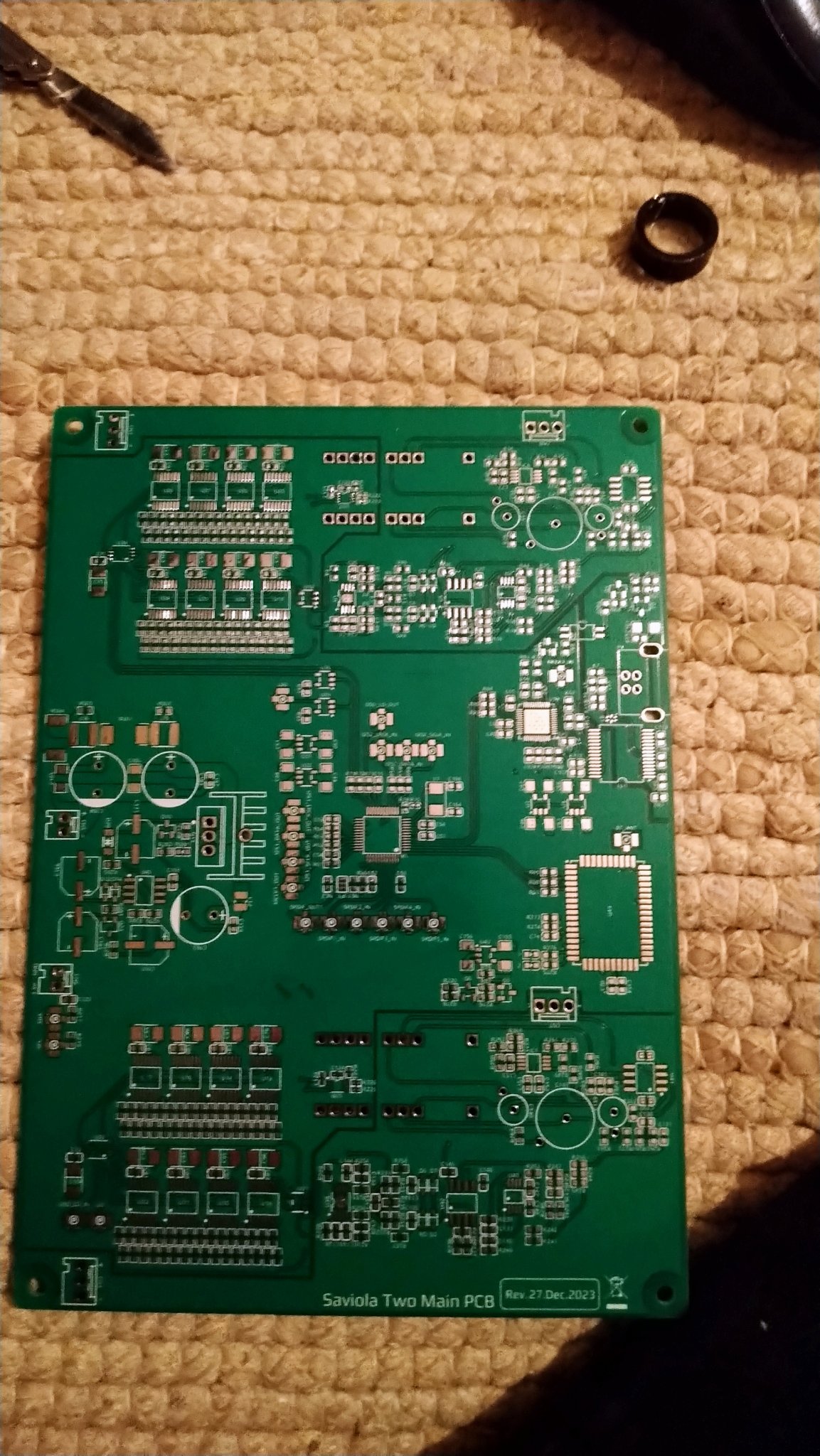

Main pcb around 115x160mm. CT7302, CT7601, Bluetooth, DSC2, dual mono (diff i/v, diff to se, mfb, tone control, se to diff), J.D. Super Regulator with inline dc filter. J.D. regulator will be suplied by xl4015 buck from torus transformer. Supply for output frontends will be suplied by discrete J.D. regulators +-15V, it will be supplied from smps aux.

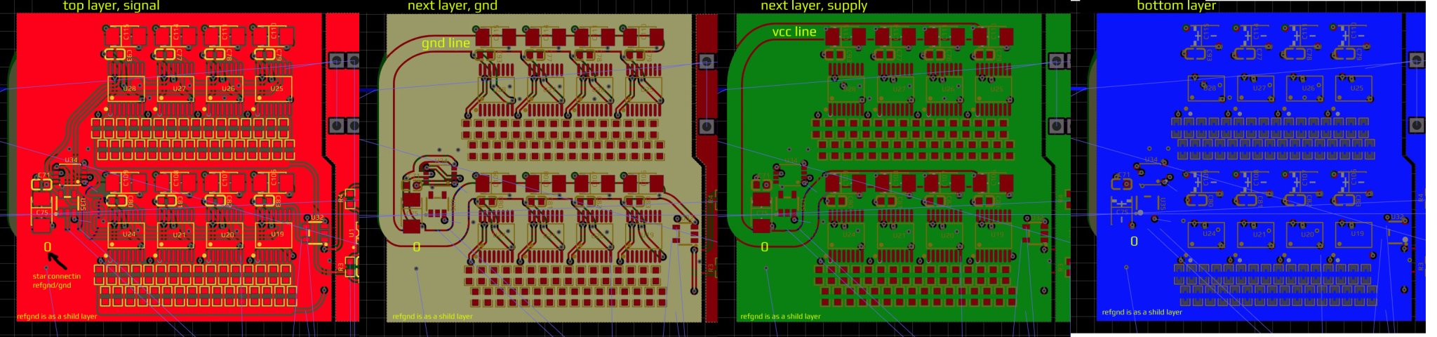

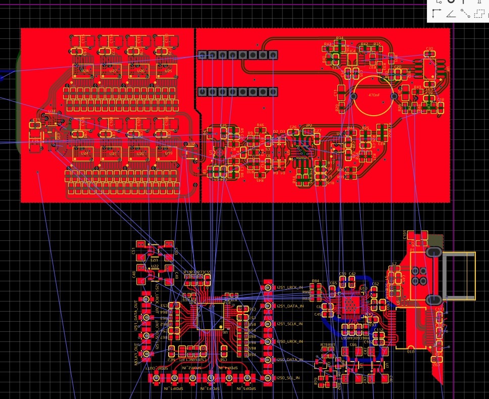

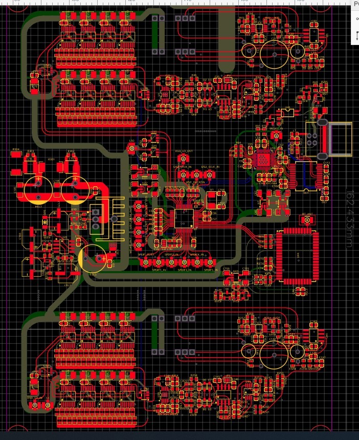

Digital VCC/DGND ruting, one over other, inside lajers 2 and 3, that will form some capacitivity and in the same time less supply noise. Top layer and bottom layer is master gnd/shild connected at the vcc out capacitor in star connection. Analog frontend for dsc diff is on their own potential and have their own isolated supply, that remain to be ruted. Top layer is signal layer. Working on this ten days, its moving finaly, the hardest and most important part is done. Some track can't be routed, I don't want to force route them over/through some important lines, bottom dsc, so I installed u_fl connectors and going to route them coaxialy. Gpio functions from ct7601 and I no need external circuity to control BTon and ISOUSBon, two wire trought i2c whole main pcb control : ) Very hard layout! Pcb size 115x162mm, well done! : )

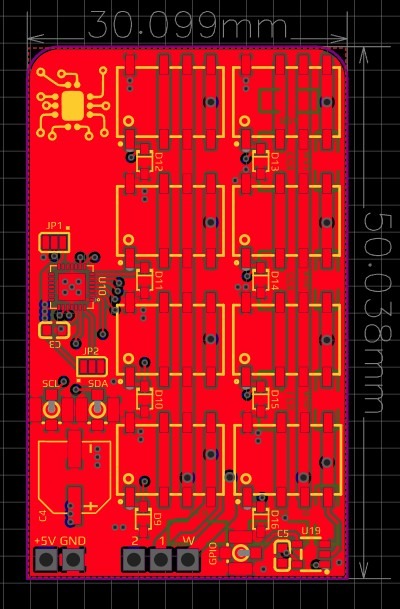

Picture 2, i2c controled relay based digi pot, 8 steps, for tone control.

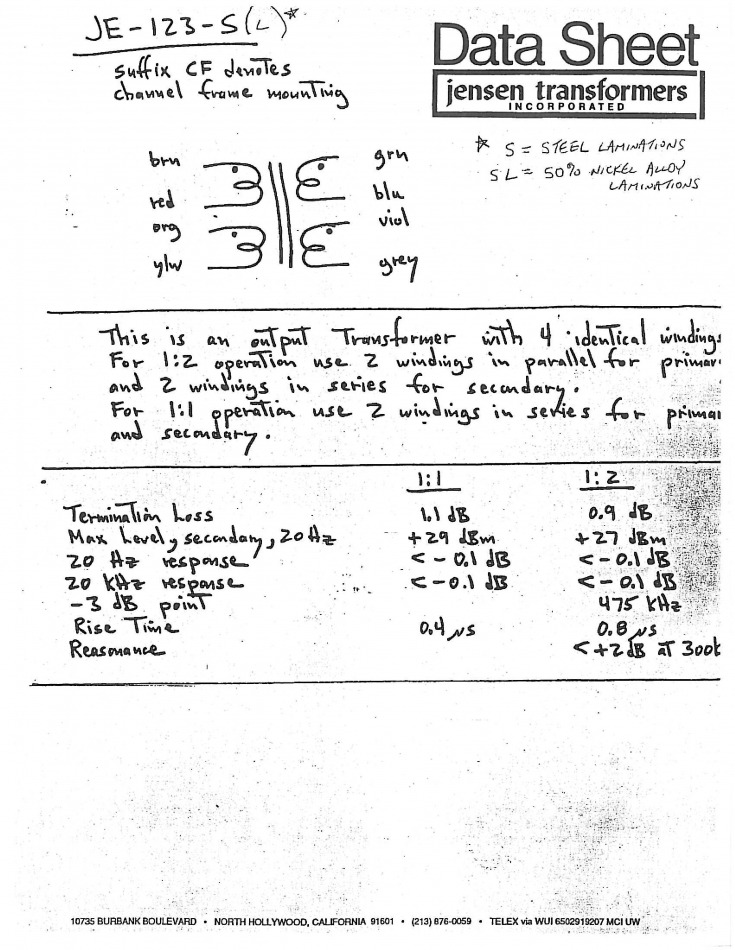

I have a pair of jensen transformer, it’s je 123-s. I’m quite headache when looking for infor that these ones can be use as output transformer for dsc dac or not?
Some say yes, some say no. (Actually I still haven’t had this dac yet)
So anyone here tried it before? Please tell me is this possible? Or I have to choose the edcor or Chinese one with exactly 10k 1:1?

You could try 1:1 and see what you think. Its probably not going to be optimal in various ways, but it might be acceptable enough. Have to try it and see.
OTOH, if you want to try something more high-end maybe consider: https://www.lundahltransformers.com/wp-content/uploads/datasheets/1588.pdf
Tone control pots, relay based, finished today, my hope tommorow main pcb will be almost done, missing some parts like isousb211 for ct7601 usb and also i/v based on opa1633, those two ic will become available on 3rd quartal this year so I'm unable to finish project completely : ( In the meantime enclosure will be finished and everything else.

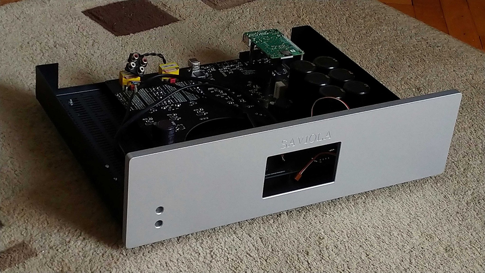

Looks fantastic.Done until receve some missing parts, time for enclosure and designing CM4 based mediaserver/control pcb with their power supply and also back panel inputs. Enclosure is on the way from 19th, hope receive them in 10 days.
Is it possible to get pcb’s and scheme?
