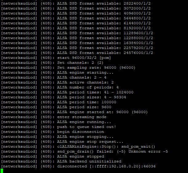

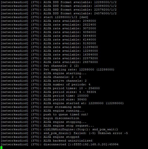

I'm having problems with getting my DSC2 (version 2.5.2) working, similar to those being experienced by lindamar.
I run HQ Player on a music server. I know that is all working fine because I run another HQ Player BBB/NAA into a Twisted Pear DAC.
DSD data is to be provided to the DSC2 from a Beaglebone Black via a Twisted Pear Hermes/Cronus combo. I have installed Pavel's DSD specific distro on the Beaglebone Black and it is 'seen' by HQ Player but I cannot get it to play without it erroring and stopping. Trying to isolate the problem I have set the botic flag to use the onboard oscillator but still have the problem - see attached items for the errors being reported, the first is for DSD and the second for PCM - both using the same 48KHz sample rate flac file.

With the Arch_Botic_DSC2 distribution package, what Masterclock input is the BBB expecting to see - just want to make sure I've got the clock divider jumper set correctly on my Twisted Pear Cronus - I currently have it set to 2:1 so outputting 22/24MHz Masterclock signals to the BBB (I have 45 and 49MHz oscillators on my Twisted Pear Cronus).

I removed the Hermes and ran the BBB on its own with just its onboard oscillator and it worked fine so, as I have no reason to believe the Hermes or Cronus are faulty, I concluded that the issue was with the configuration of the BBB botic software, perhap pin mappings or data type.
Anyway, having studied the configuration and compared it with my working BBB botic DAC the most likely culprit looked to be the setting 'snd_soc_botic.dai_format' so I amended it to 16835 (to remove LRCK and BCLK inversion). It now 'plays' and I have run files through it at up to DSD512 (upsampled on HQP).

No progress on the problem I've been having. With the BBB on its own and using the internal oscillator I can play files. If I plug in the TPA Hermes I get the ALSA timeouts and it won't work, even if I configure the BBB to use its internal oscillator.

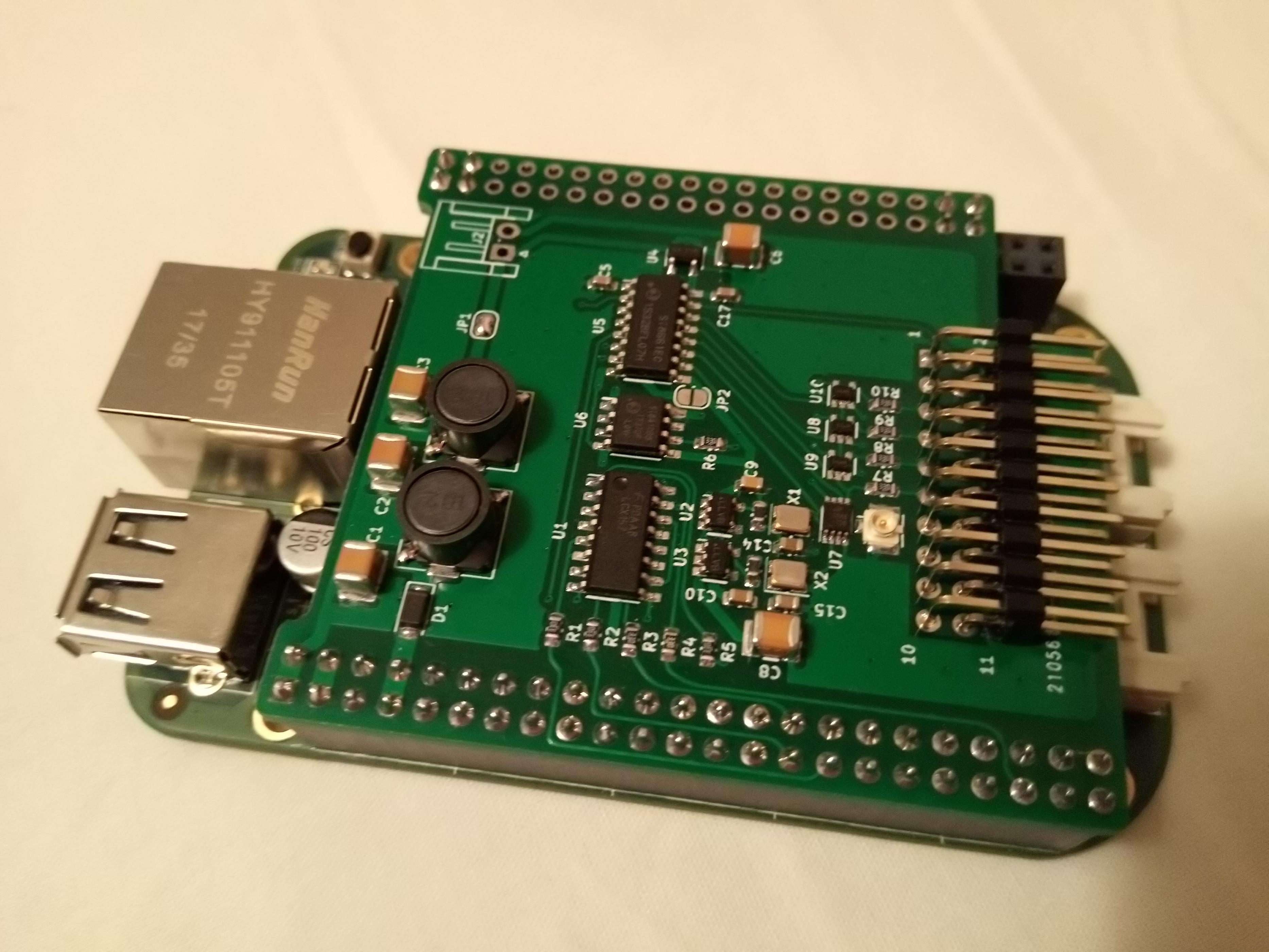

I finished the universal recloker isolator (PCM/DSD) fully compatible with the Amanero connector.
Can be used as a more compact solution instead of Hermes.
Must be consistent with older versions of DSC2 2.5.2 and 2.6.2. Included with this board will soon publish a new firmware for the BBB. The firmware supports UPNP, NAA, RAAT. Made on the basis of buildroot. It occupies a total of 76M on disk and 17M in RAM.
