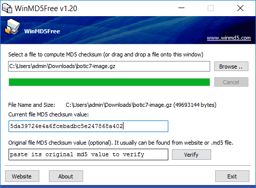

I checked it again, wrote it down to SD, and wrote it down to eMMC.i think the image is corrupted.
i can't flash with etcher neither unpack with gzip
No problem.
md5sum 5da39724e4a6fcebadbc5e247868a402
No problem.
the one from mega worked fine in the end.
