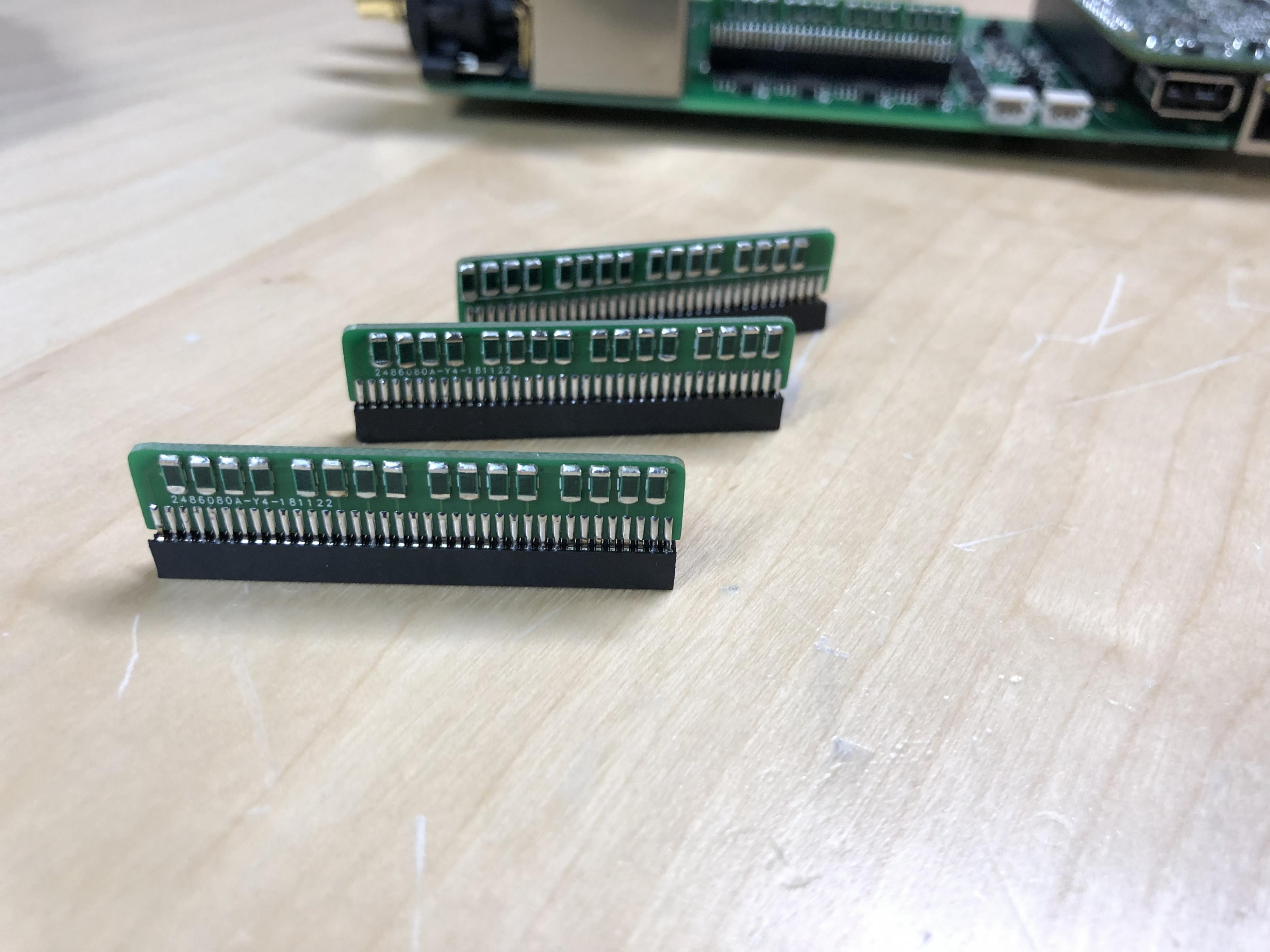

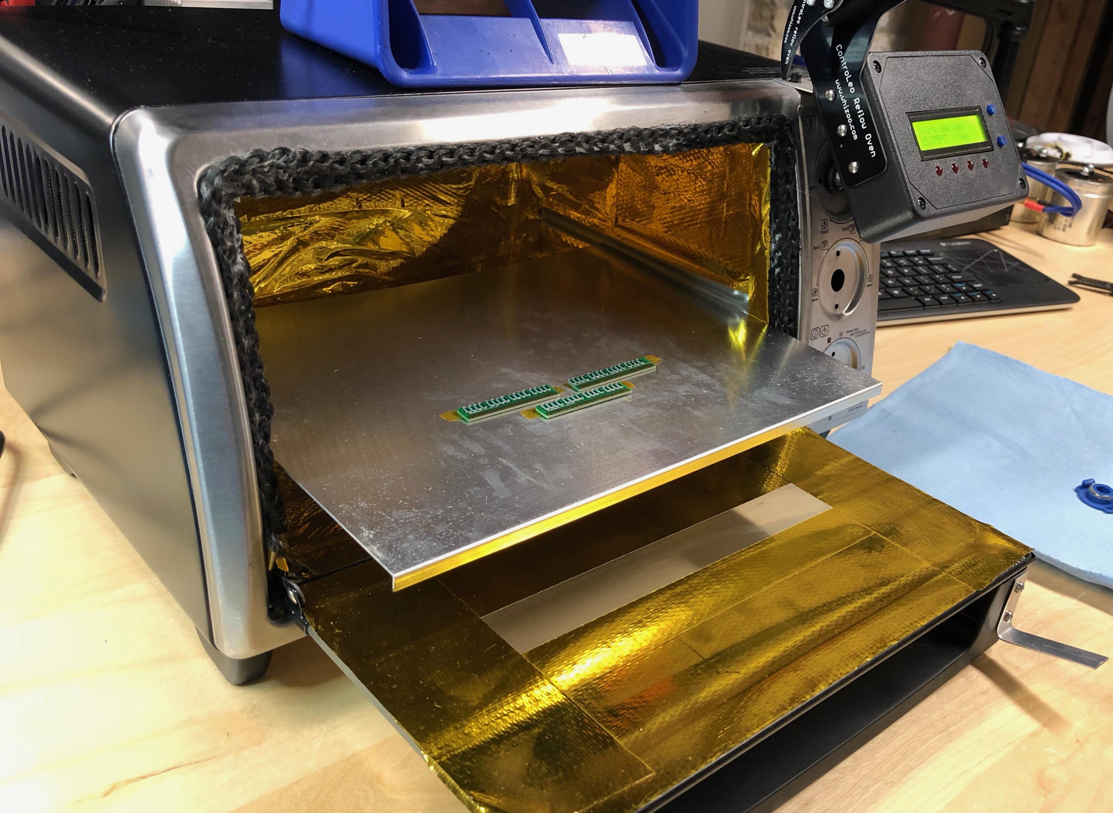

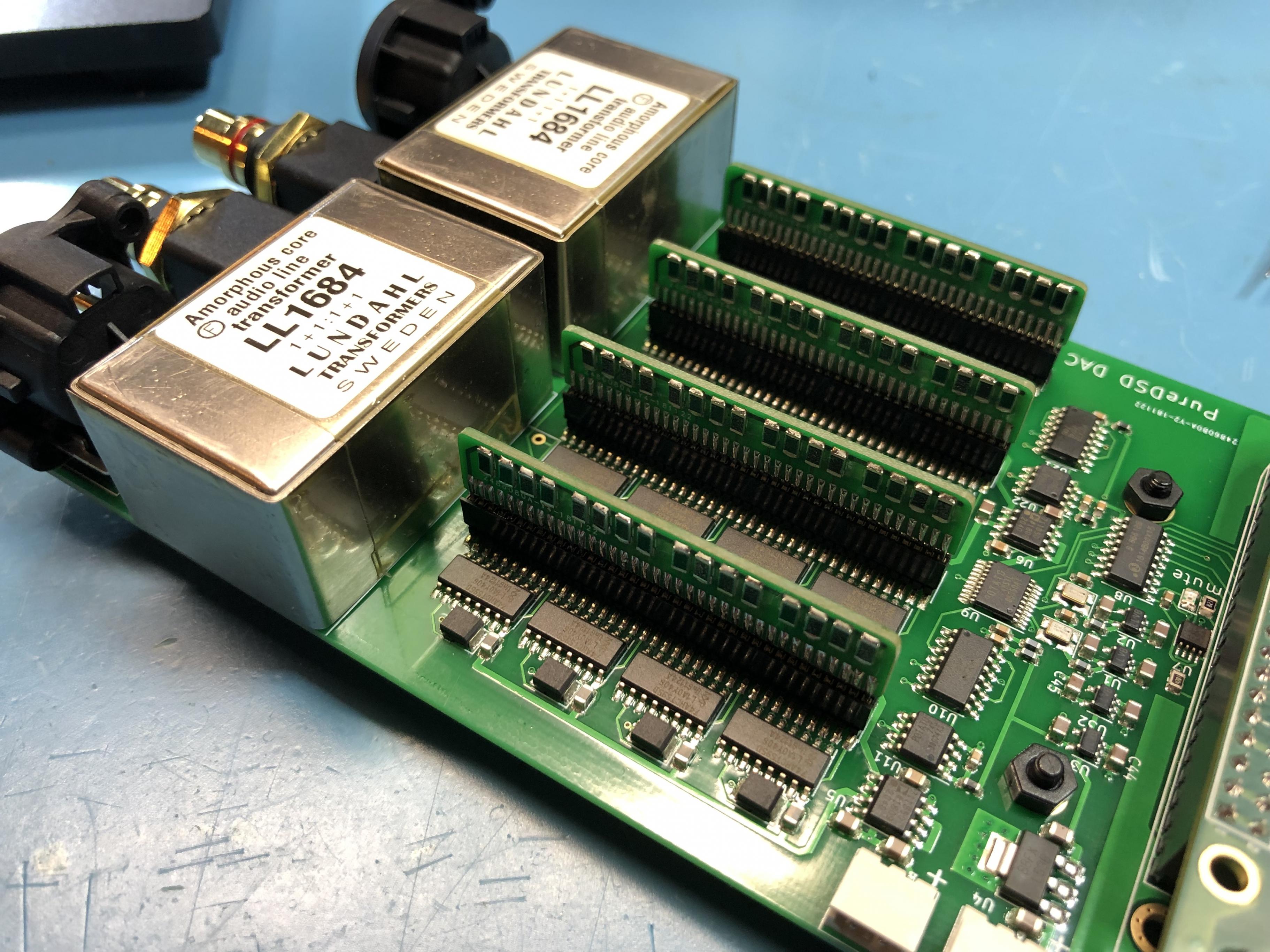

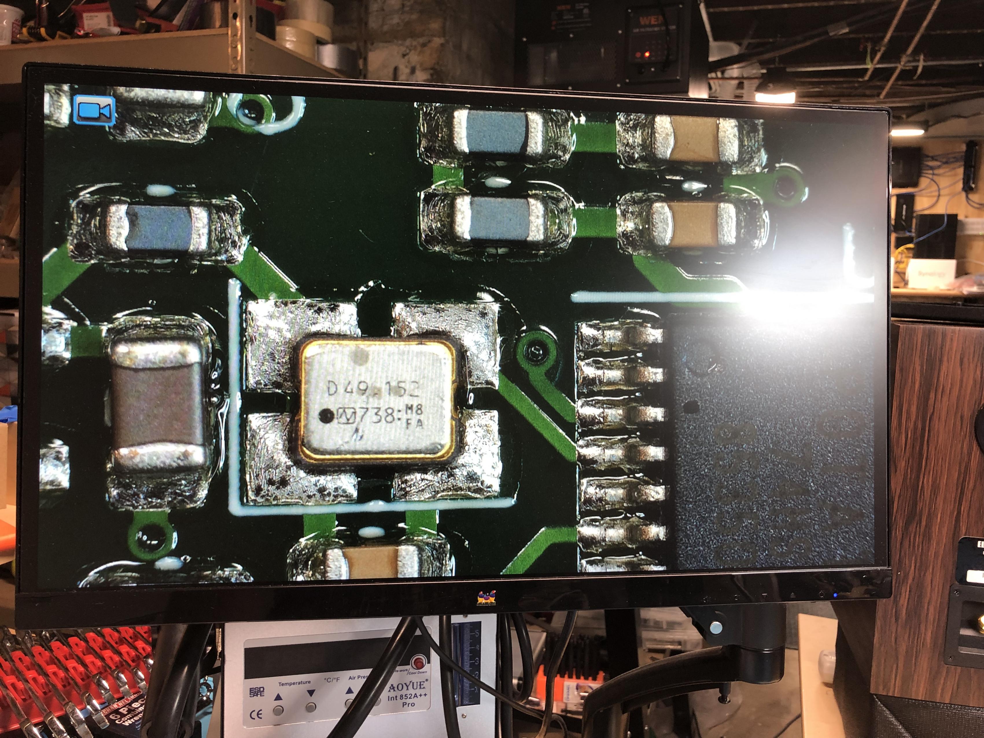

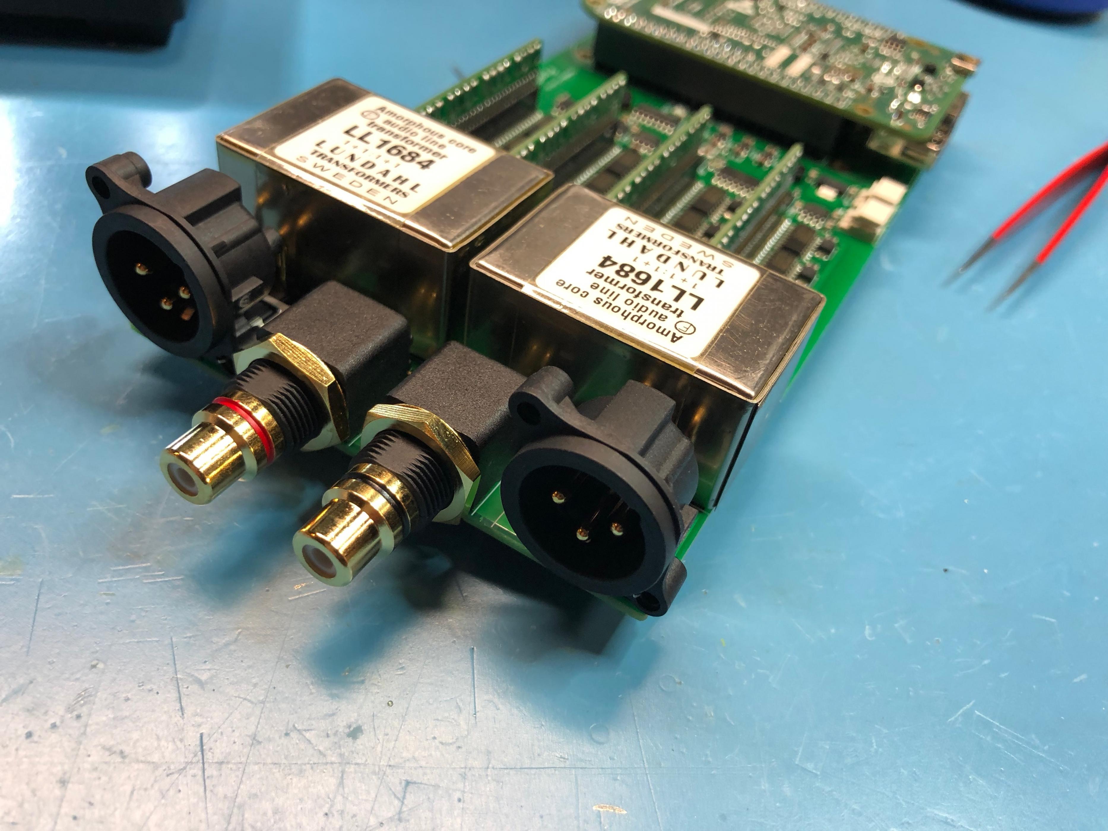

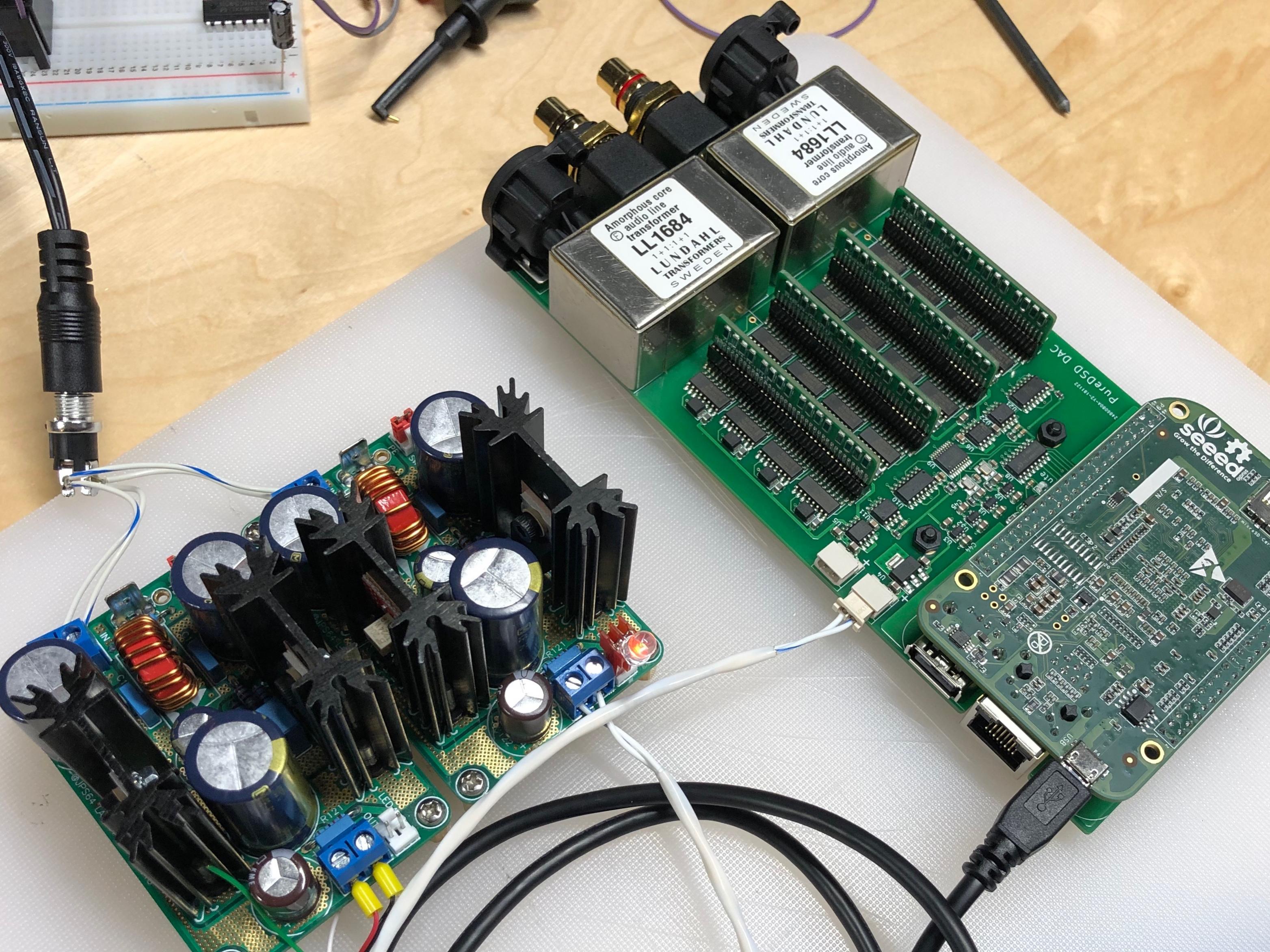

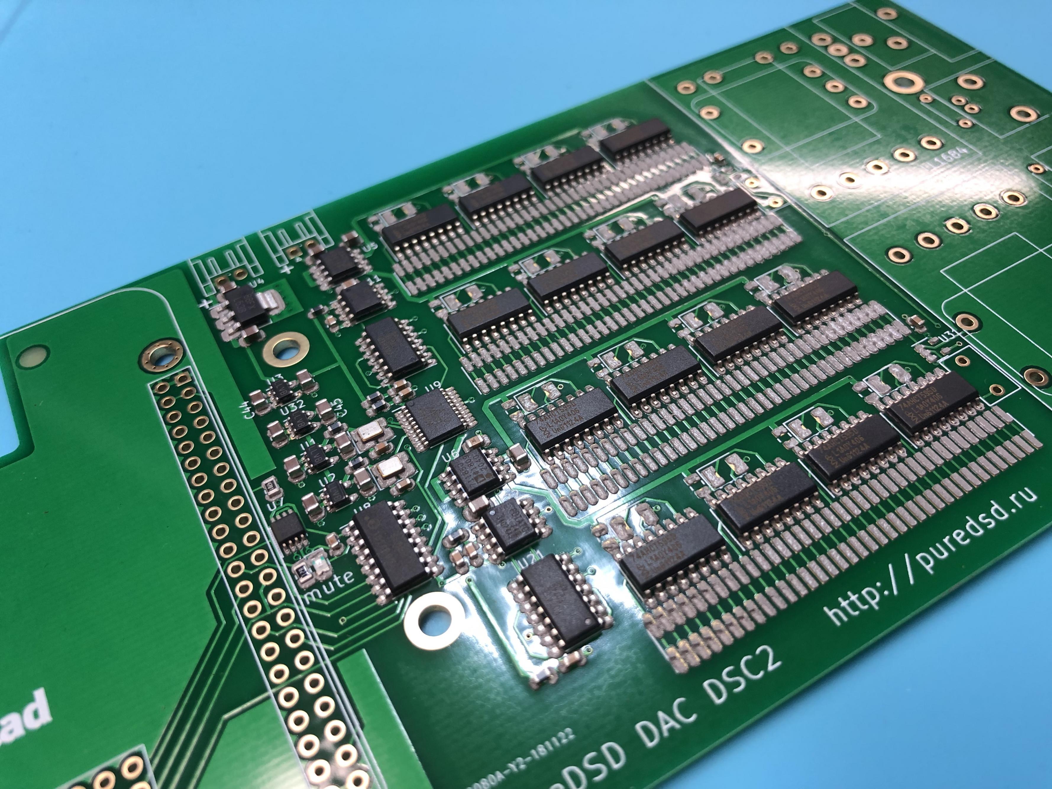

My DSC2 build
After some intense soldering (luckily mostly with a modified toaster oven for reflow and solder stenciling), my DSC2 is up and running. I am using LL1684s, Vishay PAT tantalum nitride resistors, and (presumably NXP) 74AHCT595Ds from Taobao.
I am using a BeagleBone Green with ppy's latest botic image without any hiccups. I'm converting to DSD512 and streaming from Roon.
Power supplies are 5v for the BeagleBone and ~7v for the DSC2 provided by xrk971's, CLC / CapMX / Regulator board: GB for Simple Cap-Mx Regulated Low-Noise PSU. I'm using a boring LDO for the BeagleBone and a TPS7A4701 for the DAC.
ppy, thank you so much for providing this awesome and challenging project to the DIY community! I have really enjoyed my time listening to the DSC2 and it will likely replace my long standing Soekris DAM1021 and RPI combo on my main system.
Awesome job gtose, very neatly done !! How come you chose the lundahls for the output stage ?.
I see you are using a toaster as a "reflow machine". Some time ago I bought one toaster too for this very same purpose, but never had the time to finish the project. Yours looks great, how happy are you with the results ?. According with your pics it seems the controler is the Controleo3 (can be bought here just in case Buy Controleo3 ).
Out of curiosity, may I ask where you had the stencils (and pcb) done ?
Again, congratulations for your project.
Congrats to you for all the hard works and positive reasoning!
Please explain, what do you mean under latest botic image? Botic7 is old and need to be updated!
What software or OS You use for Beaglebone (Debian BUSTER or Arch Linux)?

Yep, makes for a nice and cheap temporary mounting board. IKEA in the US has them for about $3 a piece 😀I see you also use a kitchen plastic cutting board for DIY.
Because I have been dying for a project to try Lundahl transformers out on. They are definitely expensive, but the overall build quality and pure heftiness of them seemed worth it, especially considering how much I was already paying in resistors alone.How come you chose the lundahls for the output stage ?.
That's correct! It is an older version than the one they have on sale. I love it, I had to replace the relays that came with the kit (cheap chinese ones that burnt out, replaced with legit crydom SSRs) and I ended up buying additional Reflect-A-Gold for the internal lining. Looks like they now ship with a ceramic fiber blanket. I added a fiberglass welding blanket for additional insulation when I built my kit. Overall, it was a fun project and it provides very consistent results. I use it with a tub of Kester NGX1 that I bought a few years ago and have kept sealed in the fridge.According with your pics it seems the controler is the Controleo3
