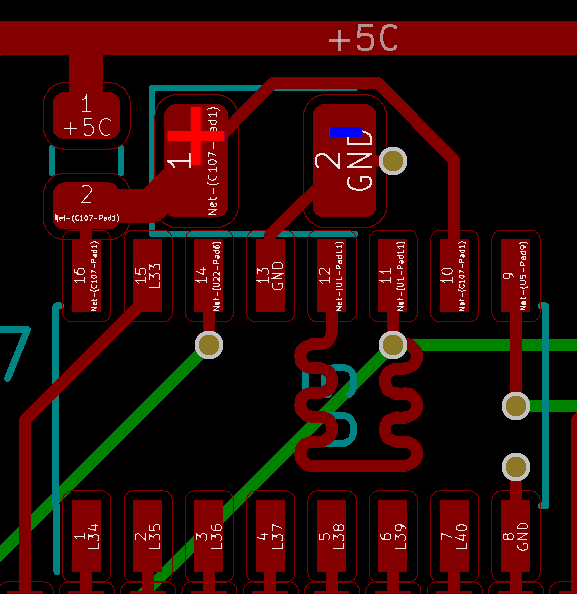

Hi guys! Can you disclose me connection process between PC and BB after Linux was booted from SD card with Botic image? I was not able to connect to BB so there is no possibility to record datas to eMMC. 172.16.0.16 address does not work for me. Thanks in advance.

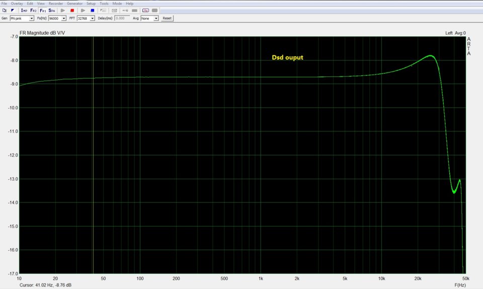

Hi all!!!
I have measured the dsd test on version 2.5 and 2.6 with dsd 64. The results are as below! Did anyone ever see this! treble sound very much, please give me advice! thank you! and in particular I see some transformer for better sound.
