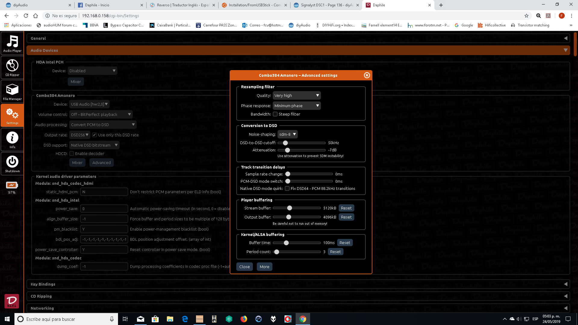

I use Daphile with Intel I7-8550U 8GB RAM 512GB SSD 1.8GHz and have short cutoffs when upsampling to DSD512 and also with native, can be I don't have enough power, Daphile is configured to upsample all to DSD512, when lowered the upsample all to DSD256 can play native DSD512 with any issue.
Other people used the new version reporting good results: Amanero card now supporting DSD native * Issue #12 * lintweaker/xmos-native-dsd * GitHub
Thanks Merlin, I will check the Github thread as well... Problem is there everyone does not usually post their set ups. I would think you would have enough power to play a native DSD 512? No blasts of static or anything really crazy though, just dropouts it sounds like, so maybe it is a playback problem (Does Daphile allow for different buffering settings?)...
I am hoping for "perfect" results as I get with DSD 256 and the 1099 FW...
Thanks barrows what hardware are you using because ROON or HQPlayer also needs a horsepower PC, yes no blast of static or anything crazy tought, just dropouts and sometimes needs a lot of time to start the song. Attached Daphile settings.
