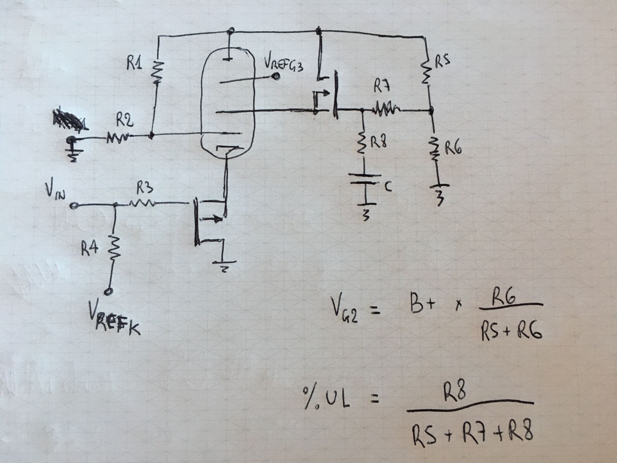

I post here an upgrade to this UNSET+UL design, in order to adapt it to whatever tube and to be able to use a standard output transformer without UL taps, so to avoid all possible distortions coming from the transformer: it is just the pentode linearizing itself by correcting g1 through R1 and R2, and correcting g2 through R5 R7 and R8. It has to follow the following rule:
R2 / (R1+R2) = R8 / (R5 + R7 + R8)

The previous post is the "morning shower idea", not simulated yet, so it could have something wrong in it.

I totally agree with you. I'm a Mechanical Engineer and so I don't have the deep electronic knowledge to understand how to optimize circuits beyond a certain level. Maybe a 10% local nfb can give more margin to add gnfb (the other triode on the LTP is there just for that purpose) and increase DF plus reduce THD even further. I would like to see it go even further if possible, and thanks to the contribution of you all it is already more steps above in what I would have been able to do alone.

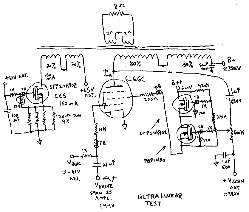

In a true UL output stage that uses an output transformer the plate voltage will be lower than the screen grid voltage at the moment of peak conduction in the tube, as the CT of the OPT is tied to B+.
The circuits shown in posts #76 and #82 are not capable of doing this which will cause distortion under large signal conditions.
See post #22 in this thread, and look over the entire thread for a discussion of this concept.
Adjustable distributed load discussion

In a true UL output stage that uses an output transformer the plate voltage will be lower than the screen grid voltage (omissi) circuits shown in posts #76 and #82 are not capable of doing this which will cause distortion under large signal conditions.
We can solve this simply by connecting the output transformer to the right part of circuit at post #82 (the nmosfet side), then add a 10 Ohm resistor between the nmosfet and pentode's plate. It could also become useful to measure bias.
Morning shower made me understand I was totally wrong with this statement:
I realized George was not talking about zero signal status, but full signal, when plate is at 100% its swing, whilst screen at 20-40% of it, so screen is 80-60% higher, and that circuit cannot do it.
So the schematic at post #82 works well with tubes like GU50 where screen are at 270V and plates at 900V (so if the plate goes down to 100V, 23%UL screen goes down to 270 - [(900-100)*0.23] = 86 V.

Yes, if you want full control of the % fb signal you apply to g1 and g2, the ac signal is easy to control as a ratio of anode ac voltage. But you have to be careful with the dc bias. 50% fb does not necessarily mean 50% ac AND 50% dc.
Thanks dgta, it will probably be an evolution of schematic at post #82 by referring the mosfet to B+ (plus something more, depending on how much class A I have) instead of the plate. I will elaborate it more.

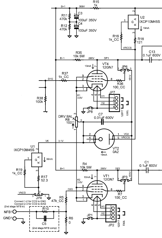

4. The topology of the driver is also not essential. For example, I was able to get similar results with a single stage driver consisting of a pentode LTP. I used Pete Millett's "PPP807 driver" without the first stage and I was able to produce the same swing and distortion.
Hi dgta, I would like to ask you some details.
I've found the schematic here: Push-pull driver board
Which tubes you used for that single stage, and did you apply some different values or modification?
I would like to simulate this driver stage as well to see differences.
Thanks in advance
Same tubes, but I was able to get similar results with other tubes. I used pretty much his exact circuit, adjusted for A-G feedback, which you implement differently. I'm sure you can refine/optimize it for other goals. Here is the .asc file. The second file is the same driver with a very conventional power stage so you can do some comparisons.
Keep in mind he didn't intend this to be a one-stage driver. If you add his 6J4 front end and the corresponding additional amount of GNFB, both distortion and Zo improve by an order of magnitude, as you would expect.
