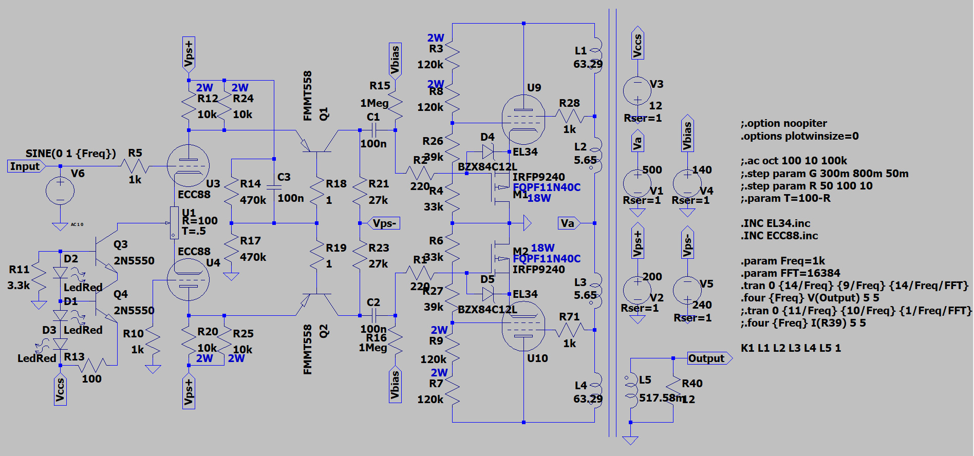

I was thinking about a RCA-50W-like plates to driver cathodes feedback with a pair of resistors in series (because of the voltage rating) from power tubes' plates to U1's sides (like R22 and R23 here: https://www.angelfire.com/vt/audio/rca50wdia.gif )
Of course the CCS on the tail of the LTP needs to take into account of that extra current.
I've also a pair of 6k6 Raa 23%UL output transformers that could be used with EL34. I've just dropped in the EL34 without optimisation and I've got 60Wrms with a B+ of 500V and a Zout of 1.93 Ohms (DF of 4.13).

I'm finalizing the components to perform some early tests, so I'll pose some (probably newbie) questions on SS devices:
As for the high voltage regulation: is this circuit from tubecad ( Shunt Regulators )
Something I can use for the driver's asymmetrical voltage (+200 & -240Vdc) PSU?
Is there anything better/simpler for this purpose?
As for the BJT of the driver, I'd chose this one because it should easily handle the needed 1W thermal dissipation:
https://www.mouser.it/datasheet/2/308/1/MJE5850_D-2315747.pdf
Is there any drawback you can see and I don't?
As for the cathode driver pmosfet, I'do go for this one:
https://www.mouser.it/datasheet/2/308/1/FQPF11N40C_D-2313913.pdf
Again, any cons about it?
Are these heatsinks 588-FA-T220-64E with 3 K/W:
https://www.mouser.it/datasheet/2/303/sink_f_r-1265536.pdf
enough for one bjt and one pmosfet, or +60°C (that's 20W multiplied by 3°C/W) is too much?
Thank you all in advance

I haven't studied that regulator but a shunt regulator would probably not be my first choice. Not enough info to offer an informed opinion.
I would first decide on an amp circuit, optimize it as much as possible (including some thought to power supply requirements) and breadboard it. Use lab supplies to provide all necessary voltages. Testing will probably result in some circuit changes and those may change the supply requirements. Once the amp is running the way you want it, then you can come up with the simplest supply scheme that meets the requirements.

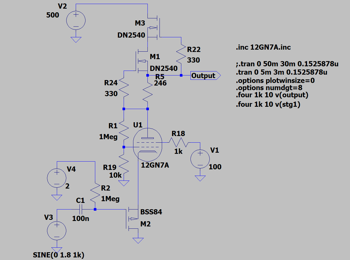

yesterday evening I've done some simulations and Millett's pentode preamp seems to behave better on overloads (I can reach around 95 Wrms at less than 5% THD keeping a 1/10 ratio between one odd harmonic and the next one).
I'd like to implement the CCS loaded pentodes with a-g1 plus UL (via n-mosfet) on the LTP as well, but I can't see how to do it with a CCS on the bottom as well (to avoid the expensive input transformer as done here: If UNSET and the RCA50W Had a Baby ). Will a simple CCS on top and shunt CCS on bottom make the latter preveal?

If you have some high-value resistors in parallel with the loads like I had in that other thread, three CCSs should work. They just get set so that the difference in current is what passes in the resistors.
Alternatively, the resistors can go from plate to GND, which I would think would give better PSRR.

In this case my goal, as is probably clear, is to linearize the pentodes of the the LTP as I've done for the KT88, plus have your CCS loaded extra gain to get linearity and DF as well. ...or better: to be able to have a very low THD before applying any feedback, then have high gain so high DF available if needed.

I just sketched (I underline "sketched" because most probably it will break some limits of the valves and it can be deeply improved) half of the driver I had in mind, in order to give an idea of what I have in mind.
I've used the resistor in parallel with the CCS as a a-g1 feedback as well.
I can get 360Vpp with 0,24% THD with 1.8Vp at its input. More than what is needed for the KT88s.
It seems there's not even need to apply the same concept of a-g1&UL feedback for the driver.
It needs to be optimized and converted in a PI, but seems very promising.
Code:
Harmonic Frequency Fourier Normalized Phase Normalized
Number [Hz] Component Component [degree] Phase [deg]
1 1.000e+03 1.803e+02 1.000e+00 0.06° 0.00°
2 2.000e+03 4.232e-01 2.347e-03 -89.46° -89.52°
3 3.000e+03 1.013e-01 5.621e-04 0.91° 0.85°
4 4.000e+03 3.482e-02 1.931e-04 91.56° 91.51°
5 5.000e+03 1.243e-02 6.897e-05 -178.55° -178.60°
6 6.000e+03 4.249e-03 2.357e-05 -90.27° -90.33°
7 7.000e+03 1.323e-03 7.338e-06 2.21° 2.15°
8 8.000e+03 5.055e-04 2.804e-06 105.07° 105.01°
9 9.000e+03 2.619e-04 1.453e-06 -178.47° -178.52°
10 1.000e+04 1.021e-04 5.664e-07 -148.62° -148.68°
Total Harmonic Distortion: 0.242227%(0.242227%)

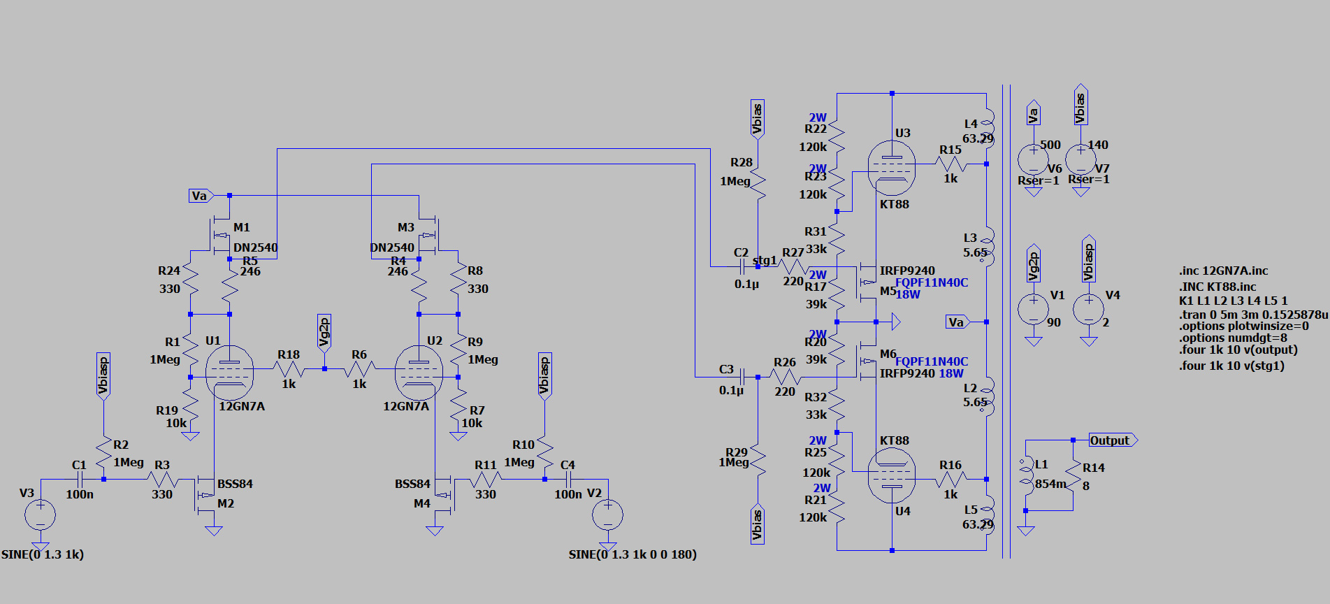

I anticipate here what I'll propose this evening for the driver:
- the circuit above with a single 10M90S CCS;
- feedback a-g1 as above;
- input on the pmosfet as above;
- feedback from KT88s plates to drivers' screens through voltage dividers joined into a CCS to ground (à la SpreadSpectrum's UNSET&RCA);
- if there will be any need, there's the possibility to apply global feedback on the pmosfet of the complementary 12GN7A of the PI/DRIVER.
The advantage I see is that it should have a very good PSRR, so PSU should be simpler as well. As I said, I'd like it to be a well performing plus cheap amp to build.

I've had no time to work on this, but that's what I was simulating.
It needs an input transformer (the same can be used for SE without input transformer). Can you suggest a good input transformer that will not costs an arm and a leg? I've seen Nelson pass using some pcb mounted ones on his amps.
THD at 1 Wrms (yes, parts per million):
THD at 10 Wrms:
THD at 83 Wrms:
Code:
1 1.000e+03 4.027e+00 1.000e+00 179.88° 0.00°
2 2.000e+03 3.306e-05 8.208e-06 6.75° -173.12°
3 3.000e+03 2.395e-04 5.948e-05 -178.08° -357.96°
4 4.000e+03 1.645e-05 4.086e-06 -0.02° -179.90°
5 5.000e+03 1.331e-05 3.306e-06 0.07° -179.81°
6 6.000e+03 1.097e-05 2.723e-06 -0.00° -179.88°
7 7.000e+03 9.400e-06 2.334e-06 -0.00° -179.88°
8 8.000e+03 8.226e-06 2.043e-06 -0.00° -179.88°
9 9.000e+03 7.312e-06 1.816e-06 -0.00° -179.88°
10 1.000e+04 6.580e-06 1.634e-06 -0.00° -179.88°
Total Harmonic Distortion: 0.006047%(0.006068%)
THD at 10 Wrms:
Code:
1 1.000e+03 1.263e+01 1.000e+00 179.88° 0.00°
2 2.000e+03 1.615e-04 1.278e-05 51.39° -128.49°
3 3.000e+03 8.278e-03 6.552e-04 -178.17° -358.05°
4 4.000e+03 5.190e-05 4.108e-06 -2.44° -182.32°
5 5.000e+03 9.546e-05 7.556e-06 3.25° -176.63°
6 6.000e+03 3.446e-05 2.727e-06 -0.09° -179.97°
7 7.000e+03 2.828e-05 2.239e-06 -0.42° -180.30°
8 8.000e+03 2.584e-05 2.046e-06 -0.15° -180.03°
9 9.000e+03 2.301e-05 1.821e-06 -0.12° -180.00°
10 1.000e+04 2.067e-05 1.636e-06 -0.12° -179.99°
Total Harmonic Distortion: 0.065536%(0.065538%)
THD at 83 Wrms:
Code:
1 1.000e+03 3.644e+01 1.000e+00 179.86° 0.00°
2 2.000e+03 1.673e-02 4.590e-04 89.26° -90.60°
3 3.000e+03 4.241e-01 1.164e-02 -178.21° -358.07°
4 4.000e+03 9.288e-03 2.549e-04 -89.81° -269.67°
5 5.000e+03 8.947e-02 2.455e-03 1.91° -177.95°
6 6.000e+03 6.328e-03 1.737e-04 86.36° -93.49°
7 7.000e+03 2.914e-02 7.996e-04 179.85° -0.01°
8 8.000e+03 5.057e-03 1.388e-04 -93.75° -273.61°
9 9.000e+03 1.210e-02 3.322e-04 -4.19° -184.04°
10 1.000e+04 4.476e-03 1.228e-04 83.28° -96.58°
Total Harmonic Distortion: 1.194115%(1.195247%)
THD at 40 Wrms:
As a comparison, the shunt cascode simulates this way (https://www.diyaudio.com/forums/tub...iver-meets-unset-push-pull-post6658251.html):
1 Wrms:
42Wrms:
80 Wrms:
From what I understand and know, on paper it's a better slope of harmonics than with CCS loaded pentodes driver.
Any comment?
Code:
1 1.000e+03 2.510e+01 1.000e+00 179.87° 0.00°
2 2.000e+03 1.342e-03 5.346e-05 82.44° -97.43°
3 3.000e+03 7.643e-02 3.045e-03 -178.03° -357.90°
4 4.000e+03 1.748e-04 6.963e-06 -50.78° -230.65°
5 5.000e+03 3.304e-03 1.316e-04 4.52° -175.35°
6 6.000e+03 7.073e-05 2.817e-06 16.95° -162.92°
7 7.000e+03 3.272e-04 1.303e-05 -175.14° -355.01°
8 8.000e+03 5.191e-05 2.068e-06 -4.12° -183.99°
9 9.000e+03 9.230e-05 3.677e-06 1.37° -178.50°
10 1.000e+04 4.127e-05 1.644e-06 -0.01° -179.88°
Total Harmonic Distortion: 0.304821%(0.304821%)
1 Wrms:
Code:
1 1.000e+03 3.921e+00 1.000e+00 -0.77° 0.00°
2 2.000e+03 2.642e-04 6.737e-05 -93.89° -93.11°
3 3.000e+03 3.495e-04 8.913e-05 2.21° 2.99°
4 4.000e+03 4.938e-06 1.259e-06 173.87° 174.64°
5 5.000e+03 4.051e-06 1.033e-06 175.50° 176.28°
6 6.000e+03 3.280e-06 8.365e-07 175.75° 176.53°
7 7.000e+03 2.812e-06 7.172e-07 176.39° 177.16°
8 8.000e+03 2.453e-06 6.255e-07 176.94° 177.72°
9 9.000e+03 2.177e-06 5.552e-07 177.28° 178.06°
Total Harmonic Distortion: 0.011174%(0.011144%)
42Wrms:
Code:
1 1.000e+03 2.599e+01 1.000e+00 -0.80° 0.00°
2 2.000e+03 1.106e-02 4.254e-04 -92.04° -91.24°
3 3.000e+03 1.181e-01 4.545e-03 2.81° 3.61°
4 4.000e+03 1.003e-04 3.858e-06 99.03° 99.82°
5 5.000e+03 4.331e-03 1.666e-04 -170.76° -169.97°
6 6.000e+03 6.877e-05 2.645e-06 100.98° 101.78°
7 7.000e+03 5.625e-04 2.164e-05 12.39° 13.19°
8 8.000e+03 3.805e-05 1.464e-06 103.35° 104.15°
9 9.000e+03 7.935e-05 3.052e-06 162.45° 163.25°
Total Harmonic Distortion: 0.456776%(0.456775%)
80 Wrms:
Code:
1 1.000e+03 3.597e+01 1.000e+00 -0.83° 0.00°
2 2.000e+03 2.179e-02 6.059e-04 -91.90° -91.07°
3 3.000e+03 4.654e-01 1.294e-02 3.22° 4.06°
4 4.000e+03 5.609e-04 1.560e-05 89.59° 90.42°
5 5.000e+03 7.209e-02 2.004e-03 -173.66° -172.82°
6 6.000e+03 1.214e-04 3.375e-06 99.40° 100.23°
7 7.000e+03 1.778e-02 4.943e-04 7.09° 7.92°
8 8.000e+03 7.186e-05 1.998e-06 92.02° 92.85°
9 9.000e+03 3.179e-03 8.839e-05 -170.70° -169.87°
Total Harmonic Distortion: 1.311753%(1.311753%)
Any comment?
