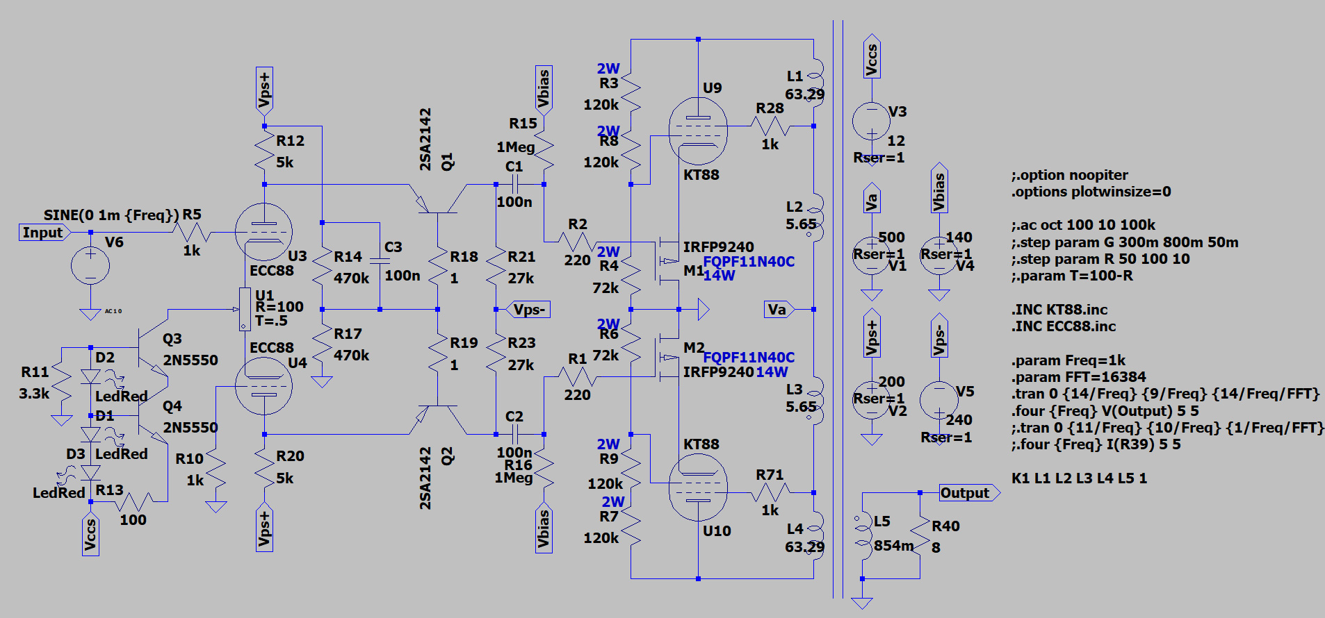

A darlington BJT pair instead of Q1 is better because there is effectively no base current error, and the capacitances are lower with BJTs (compared FETs), and the gm higher.
I will implement this solution as suggested.
The limit here should be pmosfet input capacitance, as far as I know. The lower its capacitance, the higher the admissible load resistance, the lower the needed input swing, the lower the distortion.The high R-load works better, because the grid has to swing less for the same output. This reduces triode distortion.

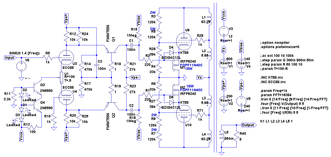

Looking at this datasheet ( https://frank.pocnet.net/sheets/086/k/KT88.pdf ) è see that Pg2 is 6 W and pa+g2 is 40 W. Rg2 is needed to be 1 kOhm instead of 100 Ohm to stay on the safe side.Zintolo - you should check the screen dissipation at higher output levels, looks a bit high!

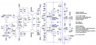

In attachment the schematic with latest upgrades.
The harmonic content seems better with a-g1 exactly the same as UL, indeed.
Seems also the simplest way to keep V(g2,k) constant.
Yes, LTSPICE thinks it is better to use a Darlington. But when the circuit meets real life, it is worse.
Notably, the very pleasant and simple cadence of harmonics vanishes, and is replaced by an unstable mix of higher harmonics - in real measurements. Stay with the single PNP!

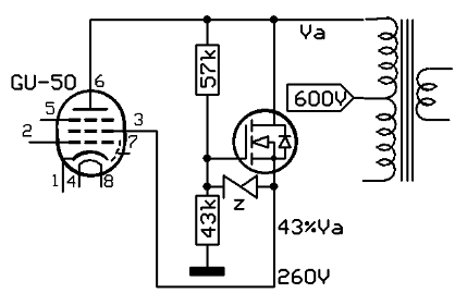

As a reminder and starting point for future implementations, I attach here a schematic Ketje posted years ago to drive g2 without a UL tap (here could be used to experiment different plate-g1 and UL feedback without depending on UL taps).

Here it is the version with the protection to the pmosfet.
Am I missing something?
Results at 1 Wrms:
42Wrms:
Results at 1 Wrms:
