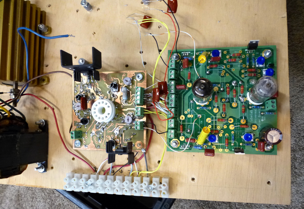

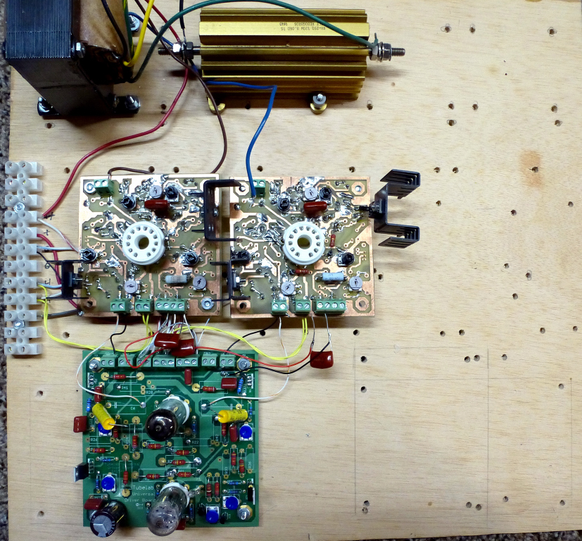

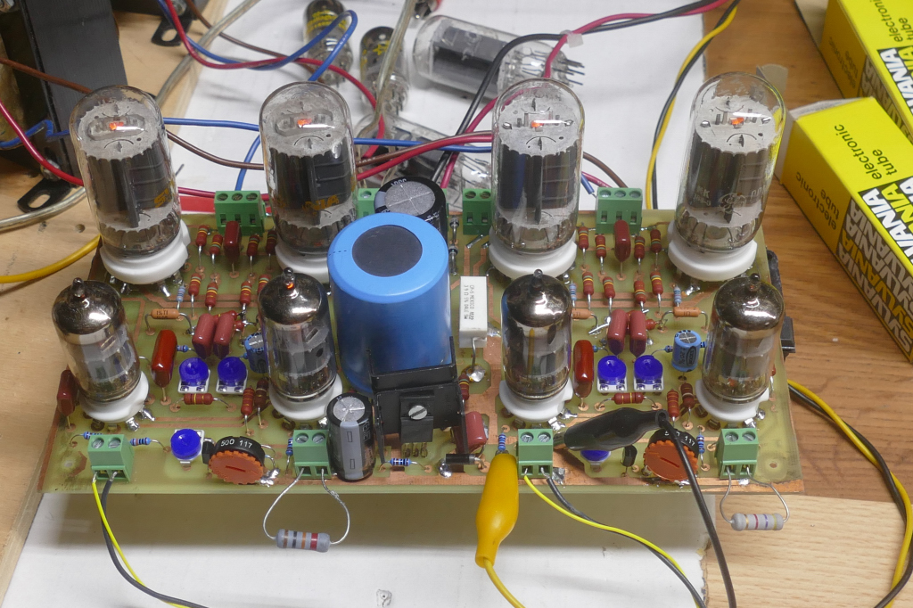

I created a push pull driver board in 2015 from the design work I did in this long thread from 2008. There are plenty of details there for those with plenty of time. The new driver is much like the 2008 version except for the tube sizes. It can output both polarity drive signals with a variable DC offset (bias) that can be positive (screen drive) or negative (G1 drive).
6L6GC AB2 Amp
I then created a pair of prototype boards with a mosfet tied to each pin of the tube except for the heater and plate. Both P and N channel fets were tried for sourcing current, and sinking current, with variable AC drive or either phase.
These pictures are from 2016. I played with these boards and LT spice off and on for a couple of years before making the first successful amp in 2018, a push pull design with small 6GF5 sweep tubes.
May ask why you have two pmosfets in parallel on the cathode of the power tubes?
The schematic shown is for the PC board layout. In order to accommodate both top of board and bottom of board population two mosfets must be placed in the schematic. Only ONE is placed on the board at build time. Same with the screen regulator N fet.
