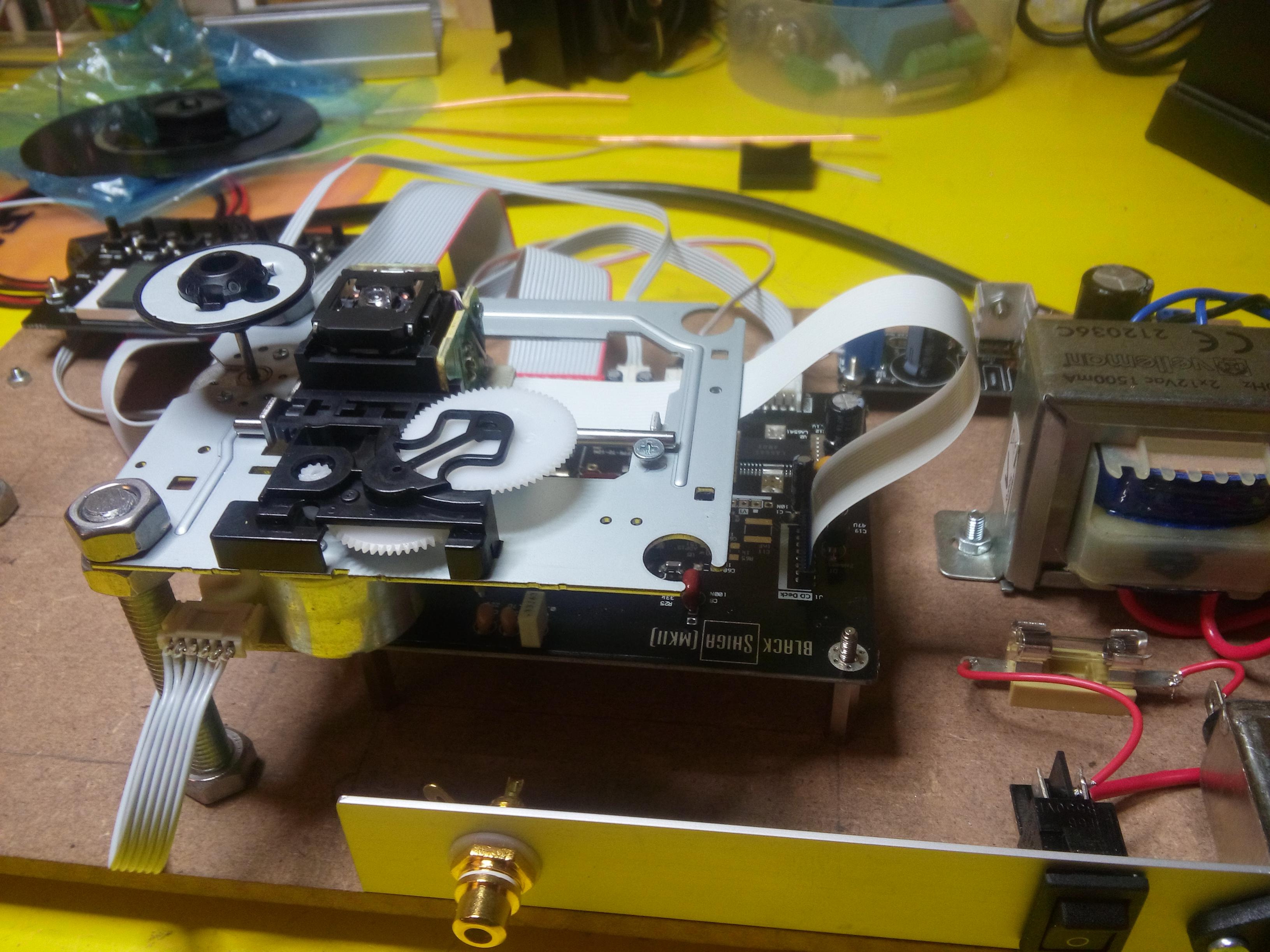

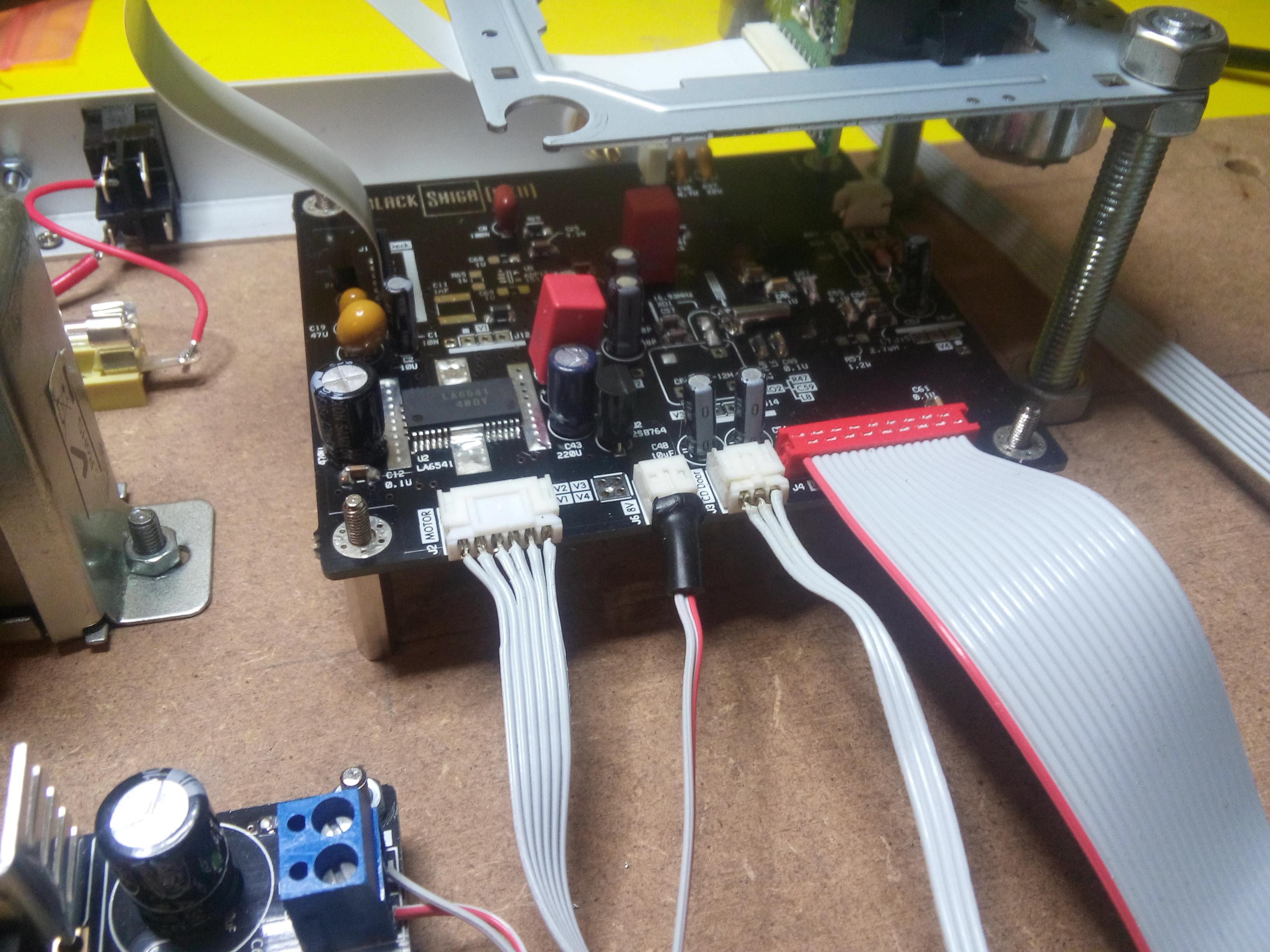

TIC37,
Thank you for your pictures !
Due to the way you have arranged the mechanic and Shiga MKII, the ribbon optical cable is reversed.
You need to place mechanic such way that connection is like in the picture from my website.

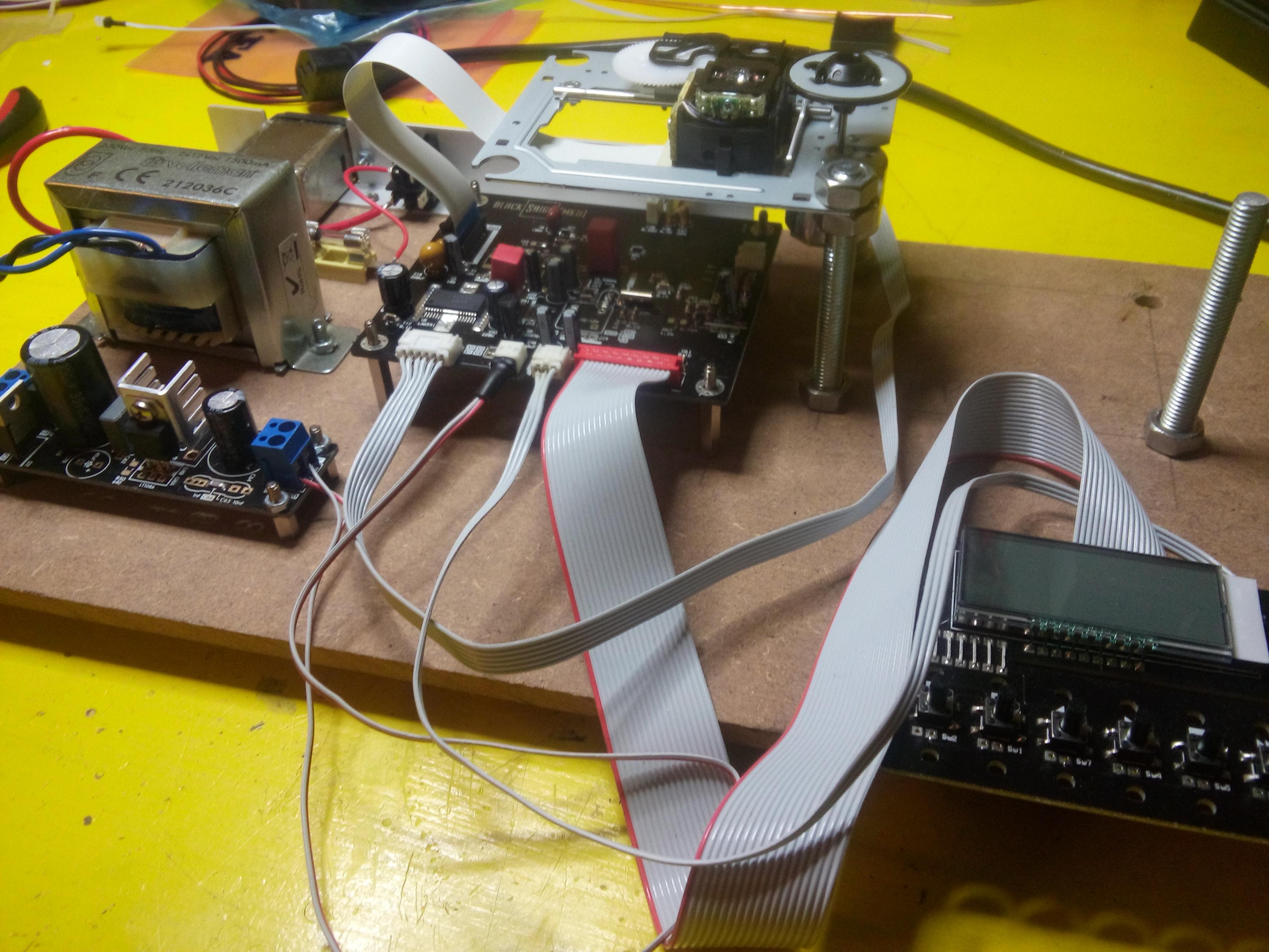

Playing
After some rearangements on the board we are good!
Me like! From cold start it is way better than my PS1 cd player with Salas shunts. Better resolution, 3 D stage, bass whatever you want to compare it is way better and still, my PS1 cd player wipes the floor with many good cd players already.
Now it is on repeat for some days and then I will start making it betterb if that is possible but appearantly it is doable according to this thread.

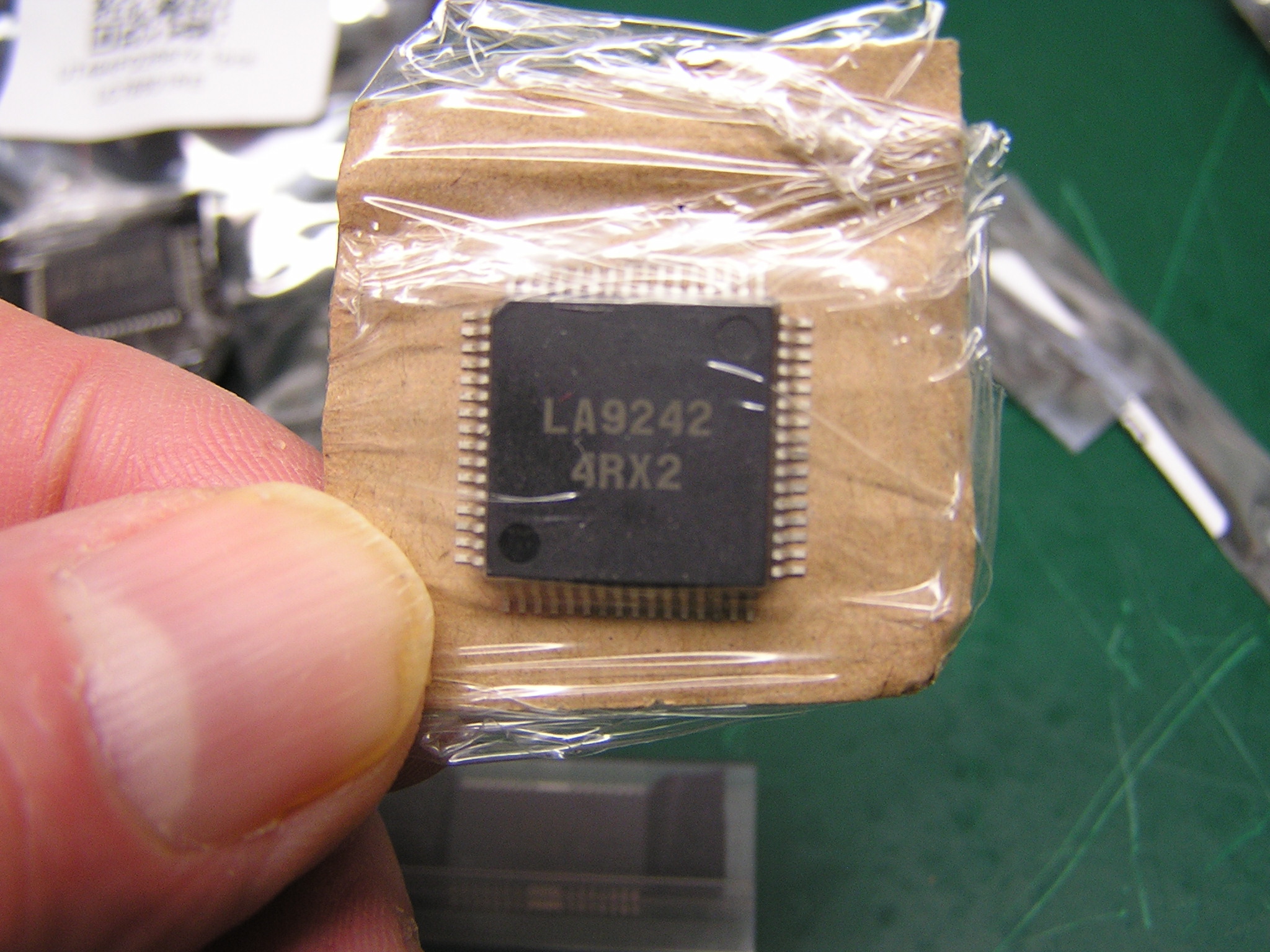

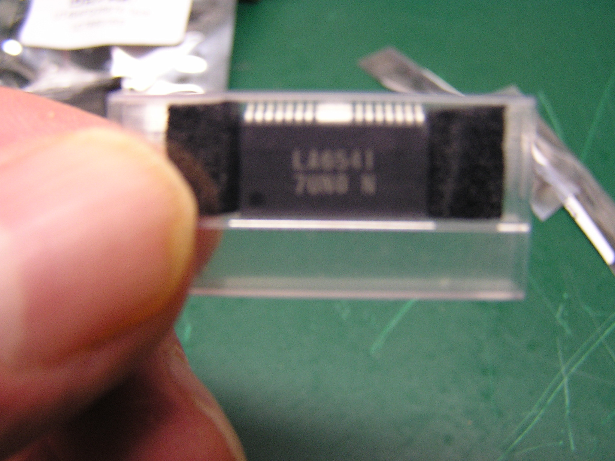

Hi Tibi,
All new connectors and cables did not change anything so I am committing to changing IC's. I bought the pictured IC's when I originally purchased shiga because I was not sure of my soldering skills. I ended up waiting and getting the soldering experience but looks like I still will need. Do these IC's look right for replacement. Thanks!

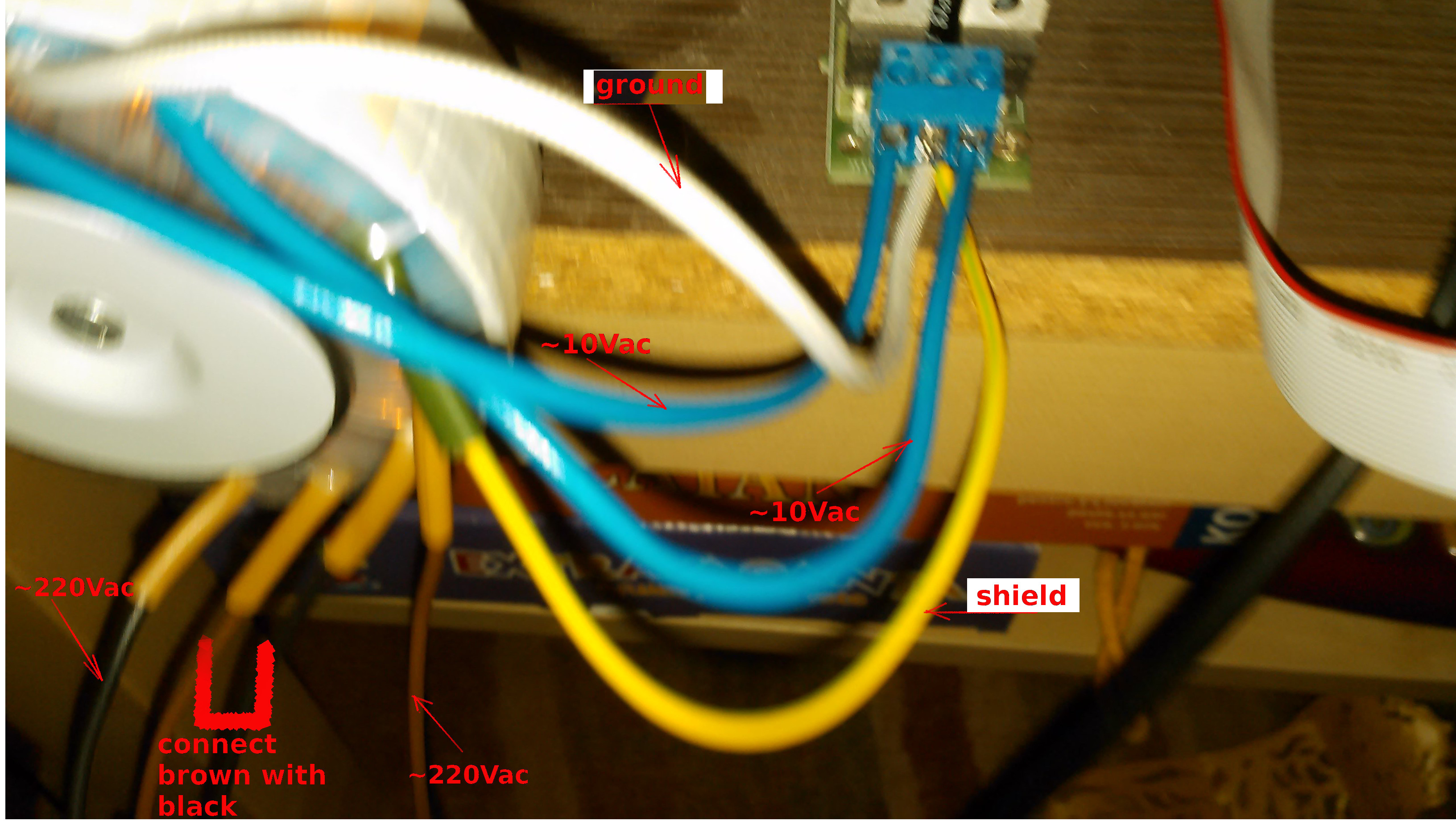

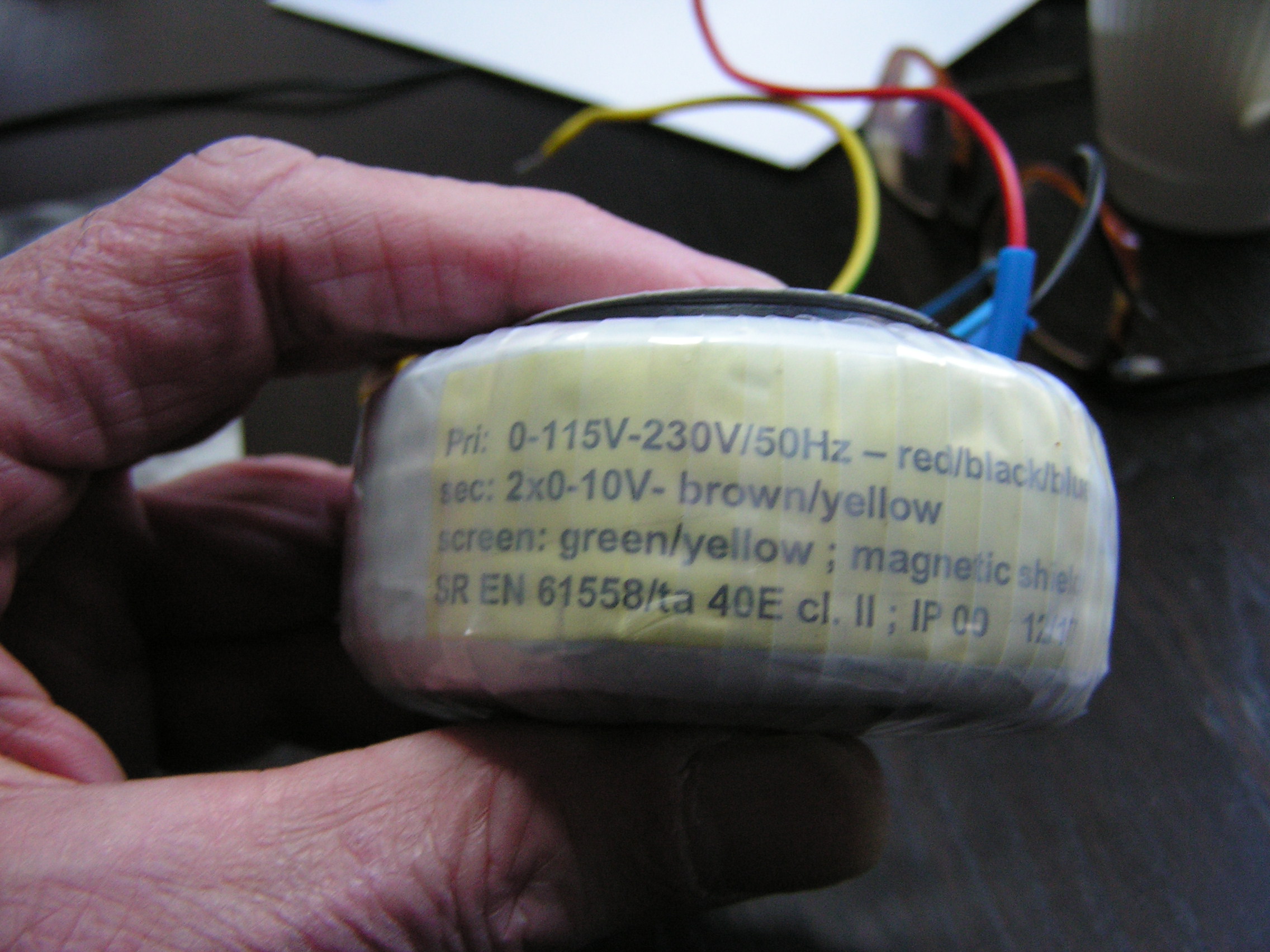

Hello Tibi,
First of all I feel sorry for you for the loss of your good friend. Please keep him in good memory!
The transformer you send me recently acts wierd. Refurring to your picture (see attachtsment) I have to use other wires to make it work. I have to connect the two 220Vac and use brown and black for current to make it work. Doing so the PSU lights up. Did not dare to connect it to the board. I used my old transformer and wired it as shown on the picture and everything works fine, but the backlight of the LCD stays dark. What is wrong?
Robert
Steve,
Please check if LC78601 oscillator is working.
Chips looks good. Replace first LA9242.

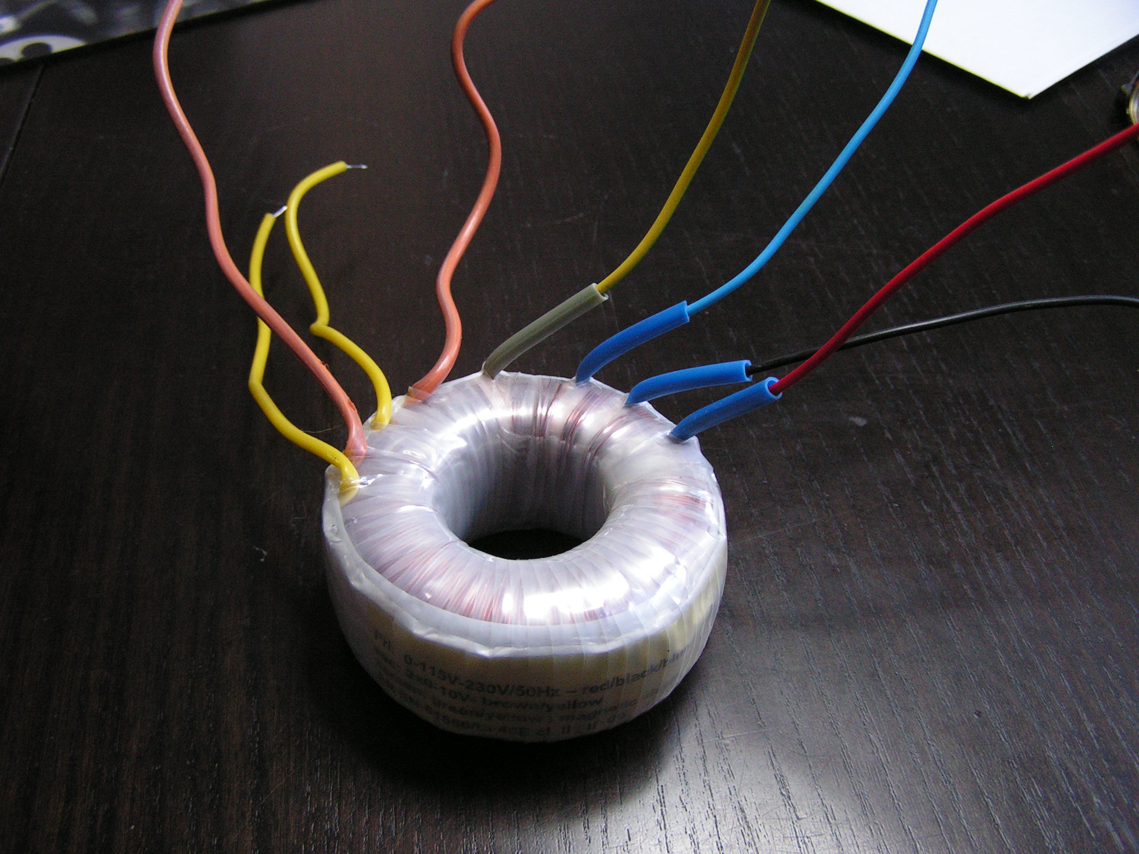

Hello Robert,
Thank you ! Please post a picture with your transformer paper stick. I had several types. The one in picture is 2 x 9V, while latest is 2 x 10V.
Tibi

Hello Robert,
For 220V you need to connect red and blue.
For 110V you need to connect red and black.
Backlight have nothing to do with trafo. Backlight have pins made from pcb, sometimes this do not solder properly. Please check and resolder.
Tibi

Hi Tibi,
I know backlight has nothing to do with trafo, but I wanted to raise two questions in one massage.
In the Netherlands current is 220/230V. When I connect red and blue as you recomment, nothing happens. Using my old trafo connected as the picture attached to my massage on page 172, it works well.

Robert,
Please check primary continuity between wires and secondary as well. These are factory tested transformers and when properly used are 100% working proof. Maybe one primary wire was broken due some stress.You may check up to where the connection is done with CuEm wire winding start.

Hi Steve,
You may check if LC78601 oscillator still work by connecting your scope on pin 60 or over capacitor C58. If you see a deformed square signal (due oscilloscope input capacitance) at 16,9344MHz, than LC78601 may still work and you need to proceed replacing LA9242. LA6541 may work up to 12V, so this is not be replaced.
