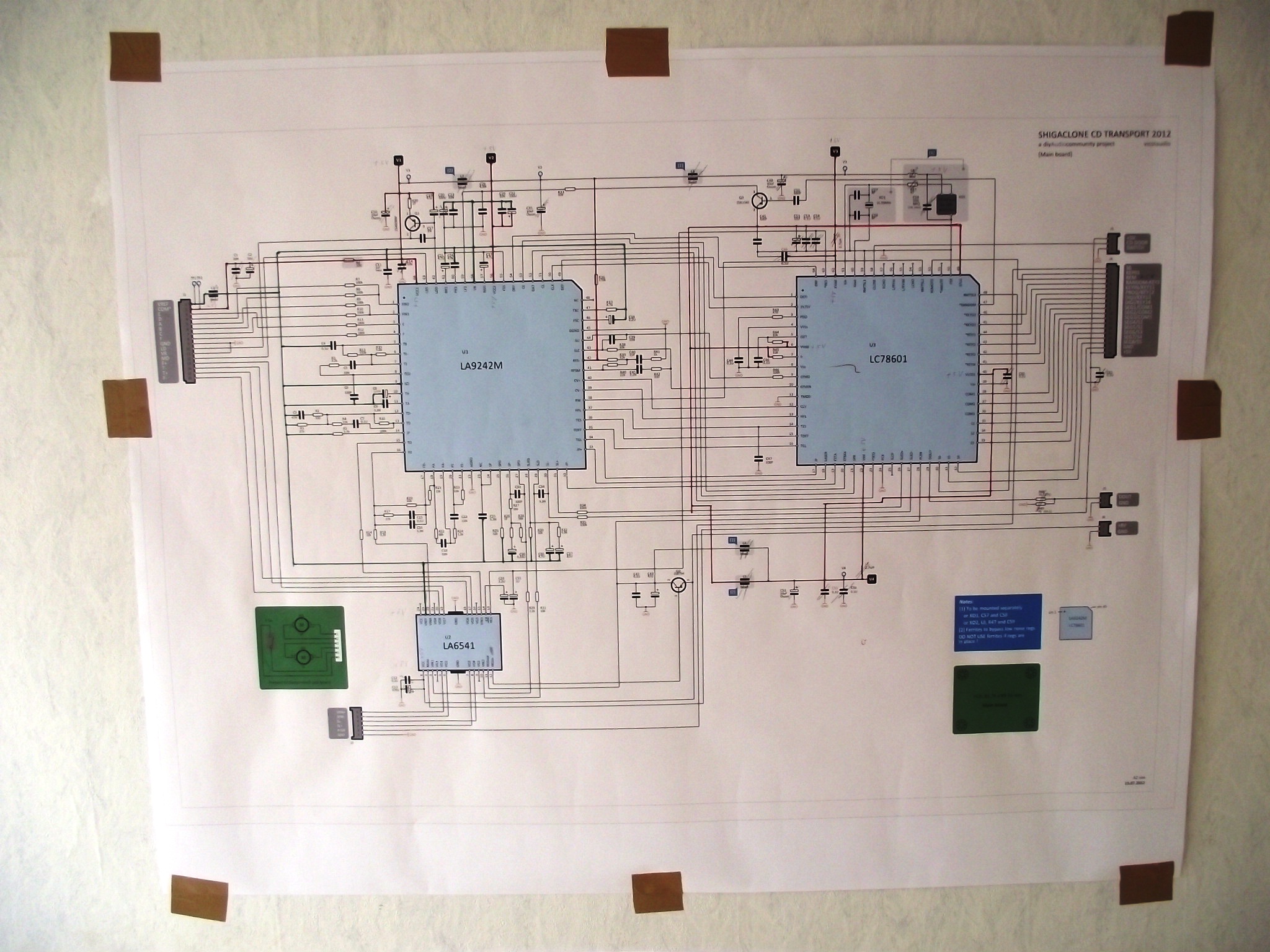

Hi Tibi,
I had been using the wiring diagram attached from MKII. I matched J6 Motor pinout matching 1-6 to 1-6 on sled. Unfortunately this was backwards,
PUIN and Gnd was going to spindle motor. So I reversed now[J6 1 to Pin 6 CD deck etc.] and spindle motor activates, laser head motor moves, TOC activates with laser trying to read but it does not happen. Eventually it stops, I can press CD door again and it repeats the sequence. I am using a stock transport, no mods, solidly mounted and contact clean/lubrication on ribbon cable. What should I check next? Thanks!
best regards,
Steve
While I am still waiting for my MK II board to come, I followed some of the MK II changes to apply them to the MK I board. Since then, it never failed to read TOC even I tested with CDR. The only moment that it stopped working was when I put a new mechanism in (old one was going through the mech mods) and forgot to remove the protection blob. Your symptom sounded like the protection blob is still intact in the mech.
Another occasion that I ran into this symptom was I lifted the trace (and didn't know) while replacing caps. This can be a possibility as you replaced the chips and might introduce bad contact. Unfortunately, this kind of problem can be very difficult to track.

Hi Tibi,
It is the kit so I have done all the build. MKII Black. I am using my unmodified CD mechanic while troubleshooting. Solder blob is removed. Straight line ribbon cable. Laser is performing all functions. Laser searches in all planes and is on. TOC switch activates search. Display DOES NOT change, only displays 88 with Play, Repeat, Memory. I am waiting for a micro clip for my scope so I can check digital IC signals as analog [servos] appear to be functioning. Using Tentlab clock and appears to be working. I posted images several days back. I don't know if photo diodes are why tracking fails or the signals are not reaching IC's for processing, or not getting through after making it to IC's. My first idea was to try to find a way to check photo diodes functioning and then move to IC's. I use textbooks and online resources to teach myself as I go. I am a true amateur but I really enjoy this and this project is really pushing my learning curve. So my challenges are my own making and not an indication of any problem with your player! If I get close to the results posted by others it will be totally worth it! Thanks for all your help.

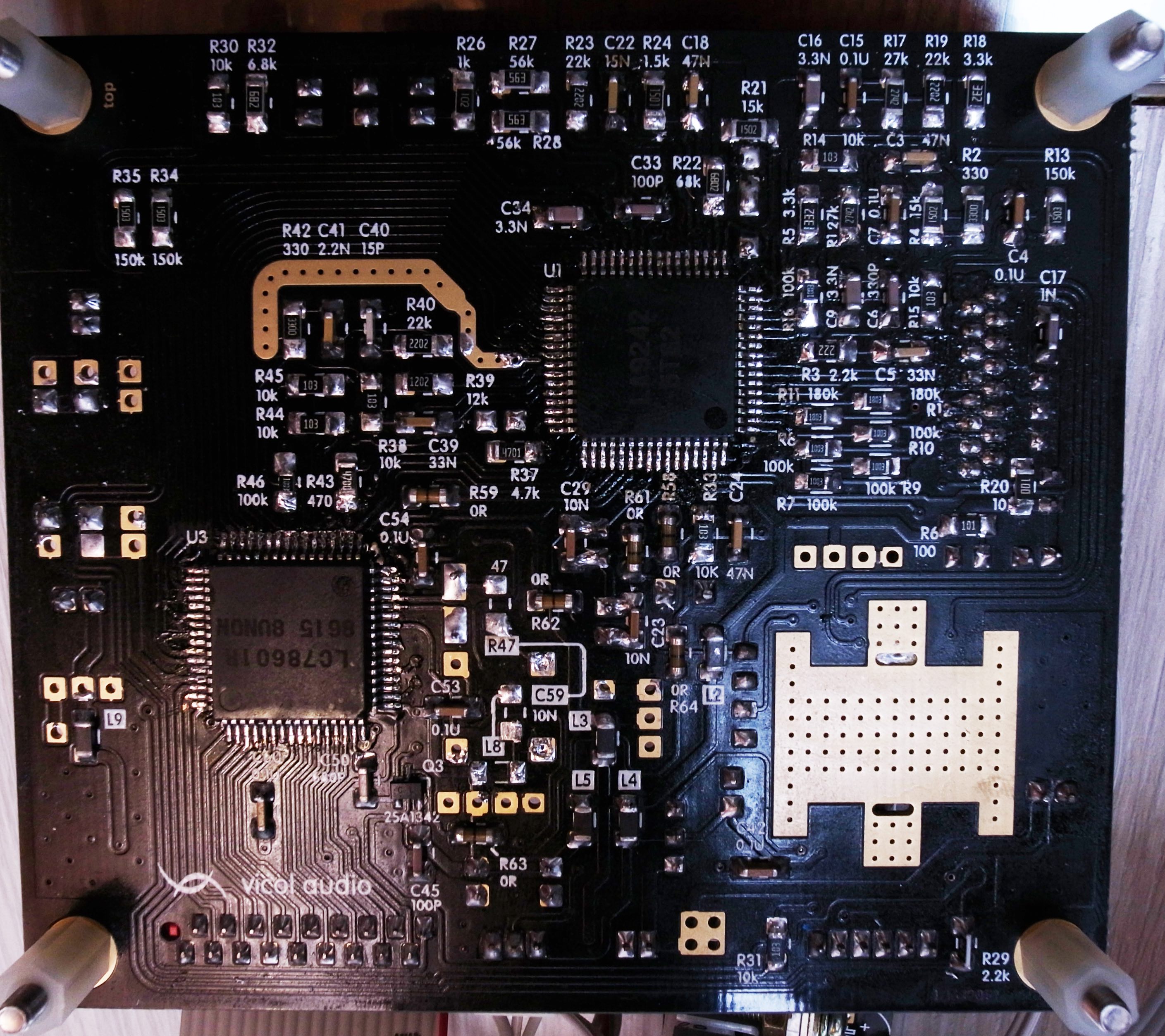

... Display DOES NOT change, only displays 88 with Play, Repeat, Memory. ...
Hi Steve,
Display should indicate -- while reading TOC and if not successful 00, not 88 all the time.
This clearly indicate that LC78601 is improper soldered, or have some pin shortcuts. Take a good lens magnifier and look closely on each pin, see if it make solder contact with PCB. Measure continuity on adjacent pins with a multimeter. If there is continuity, there is a good change that you have a shortcut.
Brgds,
Tibi
Hi Tibi,
I have flashing -- while searching then 00 and stops. I have 3 different ribbon cables all new including yours. Is it safe to spray electronic component cleaner/lubricant into the 16 pin connector on the laser unit? The laser drive motor seems to be searching correctly as it stays within the CD size. The laser optics move up and down for focus. The spindle motor activates and changes speed correctly. I am able to detect red not white light through phone camera lens[cheap phone] during search/focus activity. As I stated before I have no solder bridges detectable or visualized. Tkanks again!

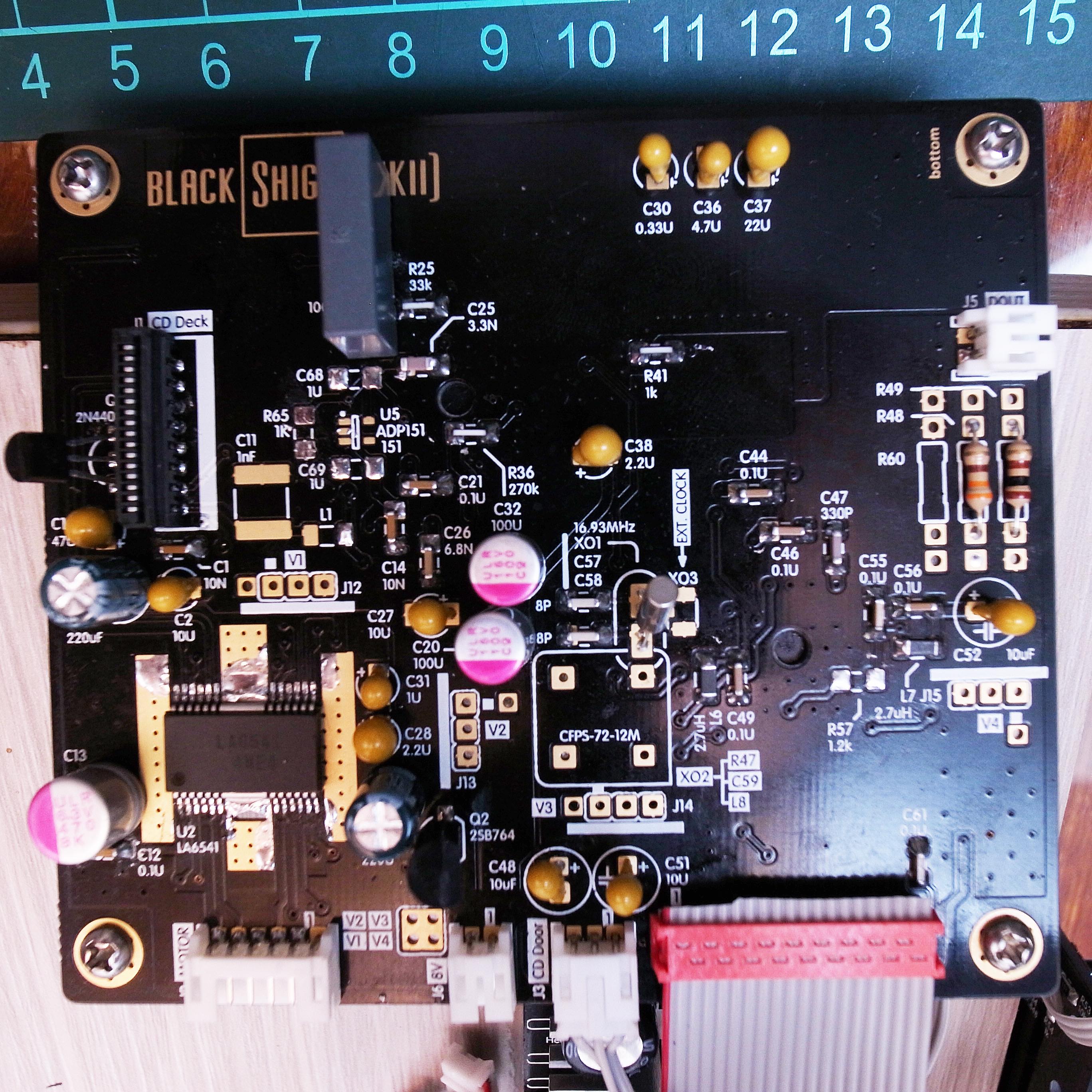

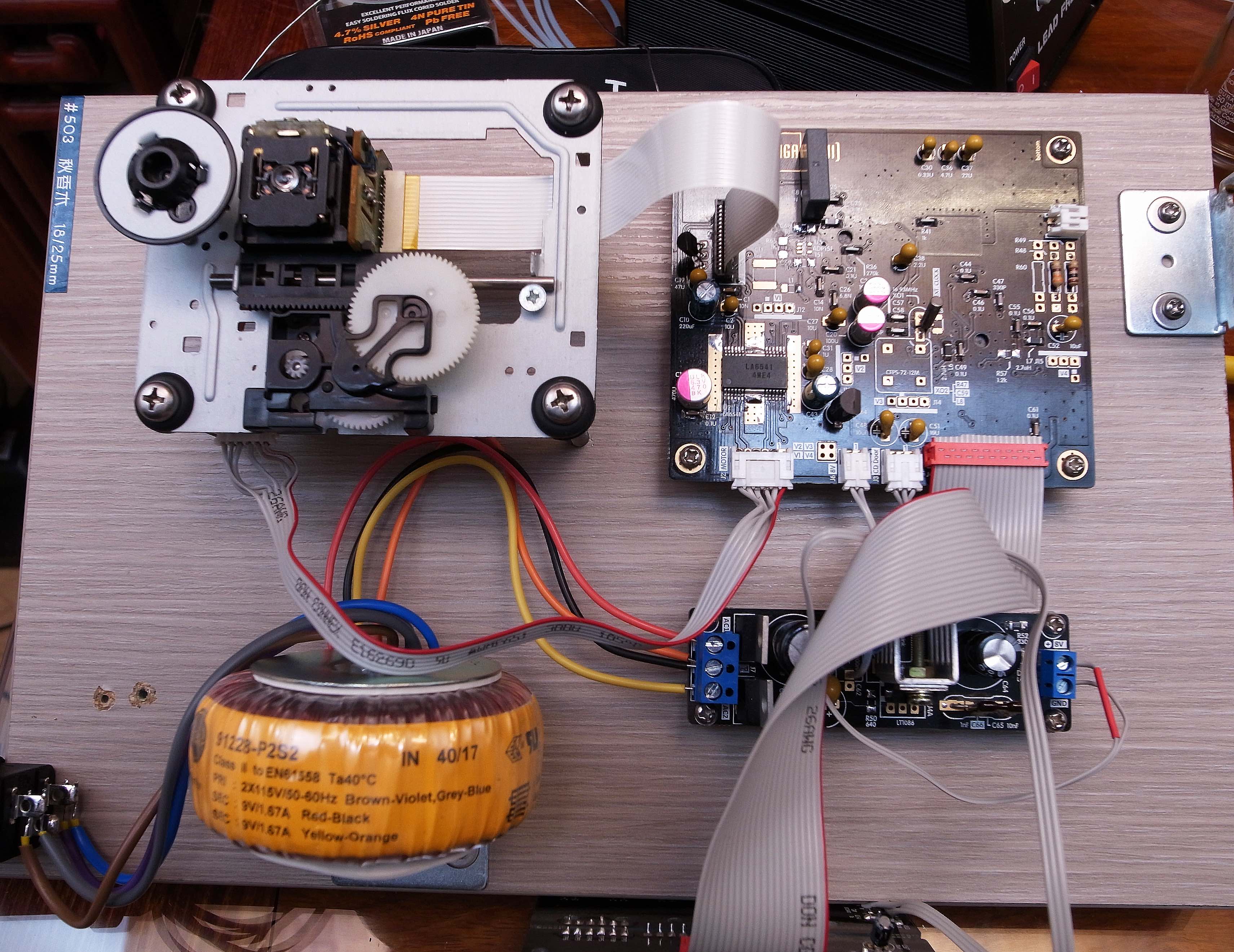

Hi Tibi and the community,
Got the kit for quite a while. Decided to put it together just recently.
And my black shigaclone doesn't work properly after finishing all the soldering.
So here I am. XD
Here is what I've got:
1. The backlight doesn't go on.
2. Missing digits on the LCD.
3. If the ribbon cable from the laser module to the main board being connected, the LCD doesn't show and the motor won't spin. But if disconnected the ribbon cable, the motor spins and the keys seems to be functional.
The output voltage from the regulator board is 7.95V. V1 is only about 350mv. (Is V1 a point of J12 with a white square mark above it?) The voltage of V2,V3,V4 is similar.
Check the threads and don't know which point to start trouble shooing with.
I attached some photos and a movie clip. Please kindly shed some light.

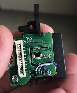

Just did the laser mods. I had forgotten what an incredible difference those caps make (also what a pain in the a@@e it is to implement!)
I got some spare lasers that have both a cap and a resistor next to the laser pins. Can you please remind me - do they both come off or just the cap?

Lee,
You should measure 5V at V1, V2, V3 and V4 square point. Try to resolder backlight, but will not work witout 5V at mentioned V1-V4 points.
Please check also if you removed solder protection bulb for laser.
Missing digits may be due flat cable was twisted too hard. Check continuity or press connectors.
