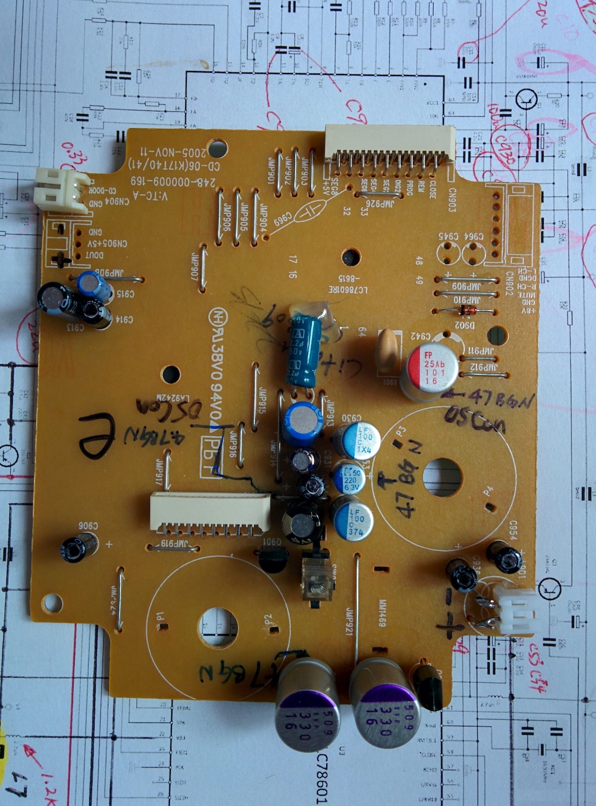

While we are on this topic, any words of advise to approach the original Sanyo laser that has the 2 x5r's on the ribbon instead of the pcb, Tibi?
I managed to modify the newer style laser pick up, but the original Sanyo looks 10X more intimidating!!

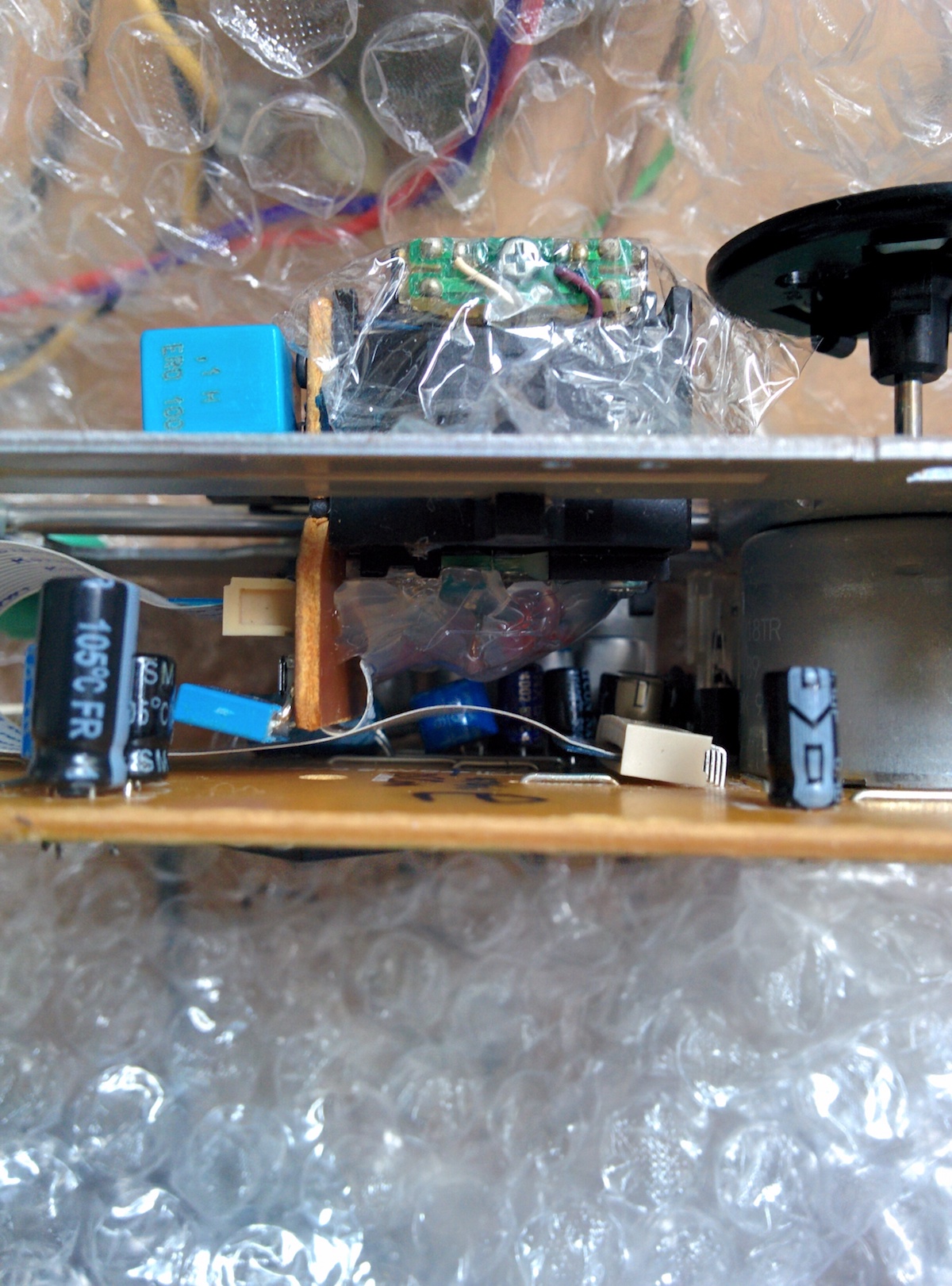

Four caps on laser head and wow!
I succeded in getting four caps on the laser head, so far so good.

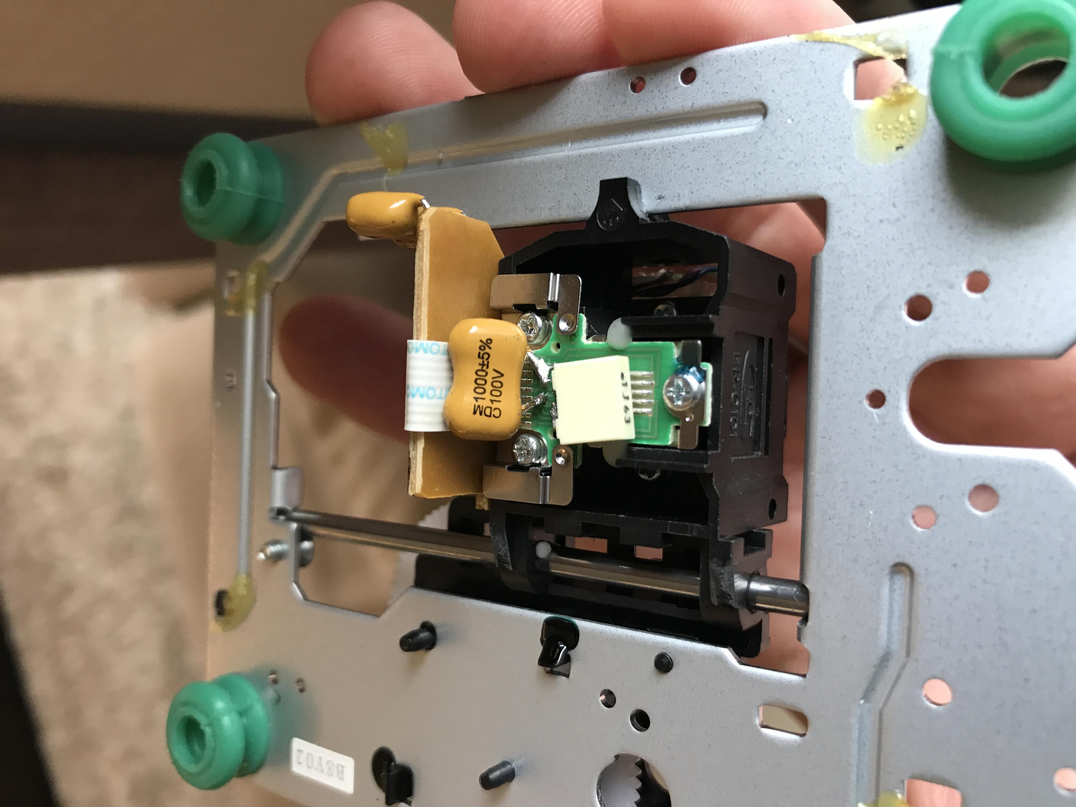

Just did the laser mods. I had forgotten what an incredible difference those caps make (also what a pain in the a@@e it is to implement!)
I got some spare lasers that have both a cap and a resistor next to the laser pins. Can you please remind me - do they both come off or just the cap?
Since I have Tibi's Shiga reborn, I also plan to give the original (JVC) Shigaclone to my brother. There seems to be somewhat tight space between the laser and the board. Do you happen to have some pictures of the laser mods in the original Shigaclone?

It’s a headache of a job isn’t it? But also one of things you get better at every time you do it - my next one will be perfect first go!
So with the caps that I am using on the tape you can see the Arcotronics is laying flat and the silver mica lays the other way - so even standing up it is just below the height of the pcb. Take care also with the silver mica bypass on the trimmer - I have had to bend mine perpendicular to avoid the cap that is now in the C906 position. This mechanism has a few skipping issues and I suspect the small vibrations from the motor spinning mean a dodgy contact point at one of the new caps so I need to touch the iron back to my joints to make sure they are sound. Then of course once I am happy then I will use the hot glue to make sure everything stays where it should.
On the laser pins you may see an extra bit of lead under the Vishay - this is where I had to repair the trace to that pin after my overheating pulled it clear of the pcb.
Clayton

Thanks for the pictures, Clayton.
LOL, I dodged (or should I say avoid gutlessly) to use 2 unknown (but very very low ESR and ESL, according to the Deree meter) Mouser purchased polyester caps to the Vref and Vcc decoupling due to the smaller sizes. These caps still make a big wow improvement in the pick up connected to the MK I board.
I also pulled the Vref copper trace by accident. So, I had to repair it by
1. solder one leg of the cap to the ribbon, and
2. solder a wire from the cap to pin 9 of the chip.
It is good for now. I will work on a new pick up with silver mica when I gain back my confident to tackle this area again 😱
