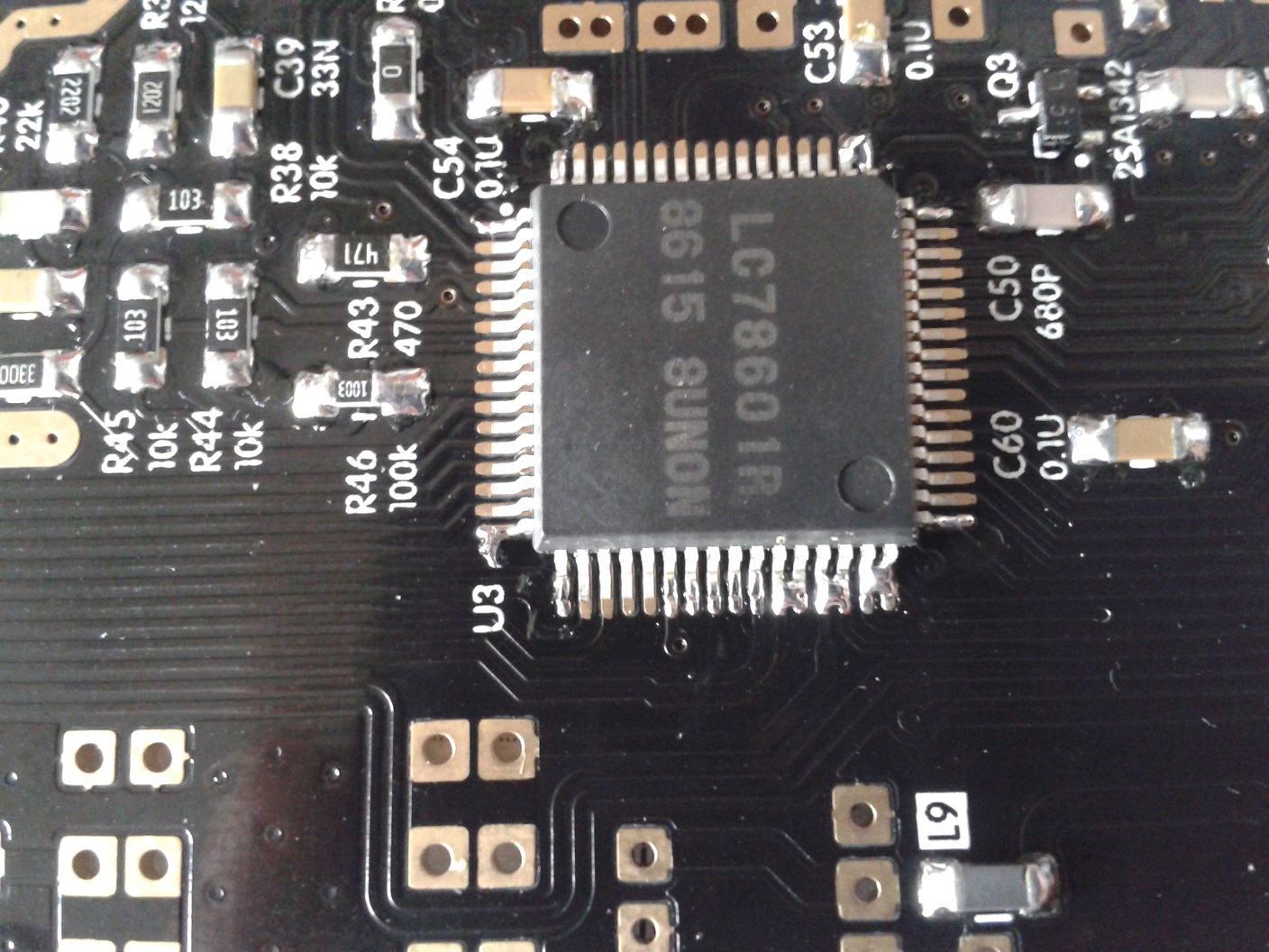

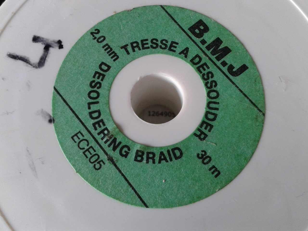

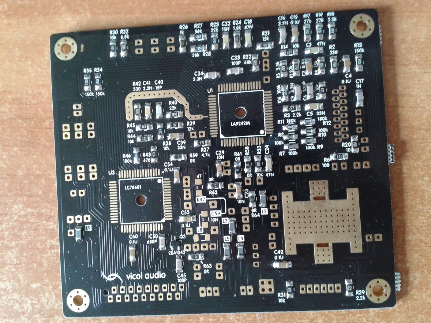

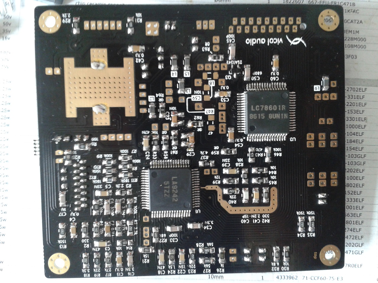

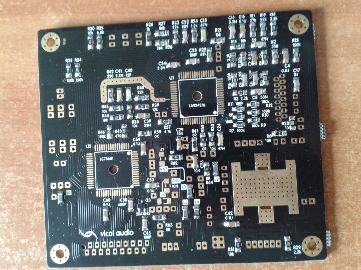

Firsts stage
I need to solder first all SMD components .
Then after finish SMD solder I take the first IC .
If there is to much solder I use some braid to remove excess .
Then the next IC and on the other side again solder solder solder...

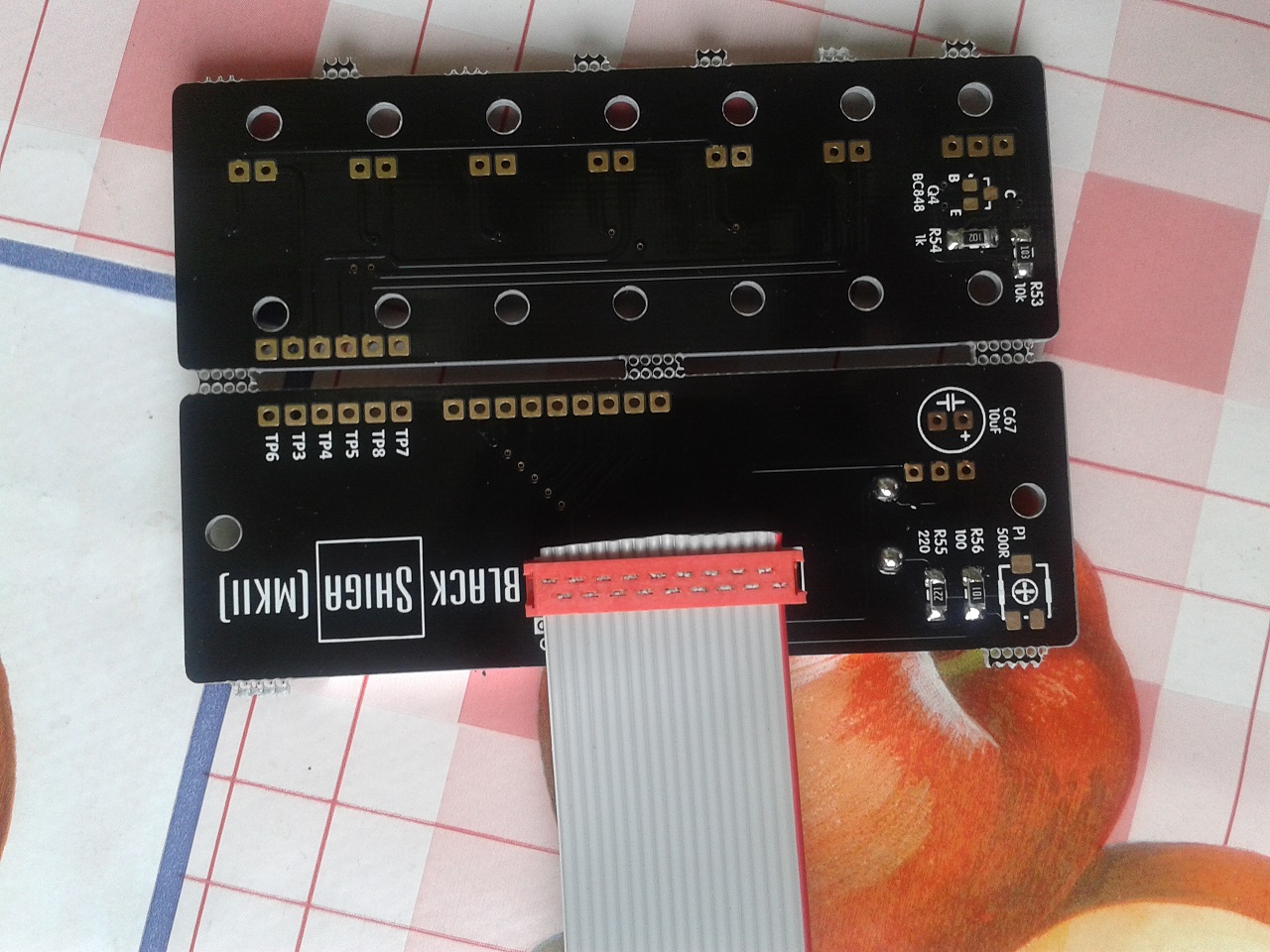

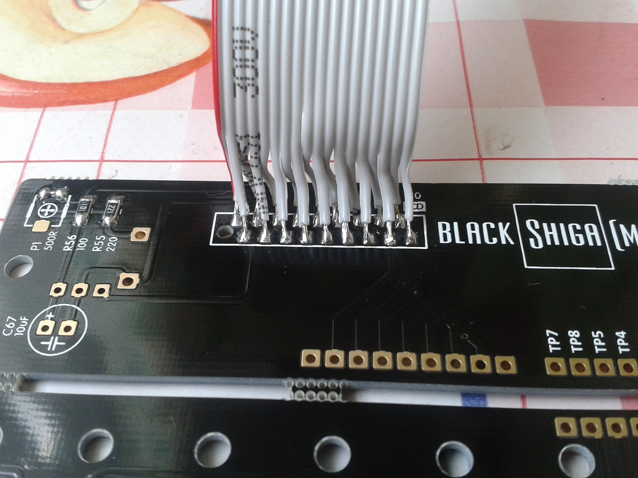

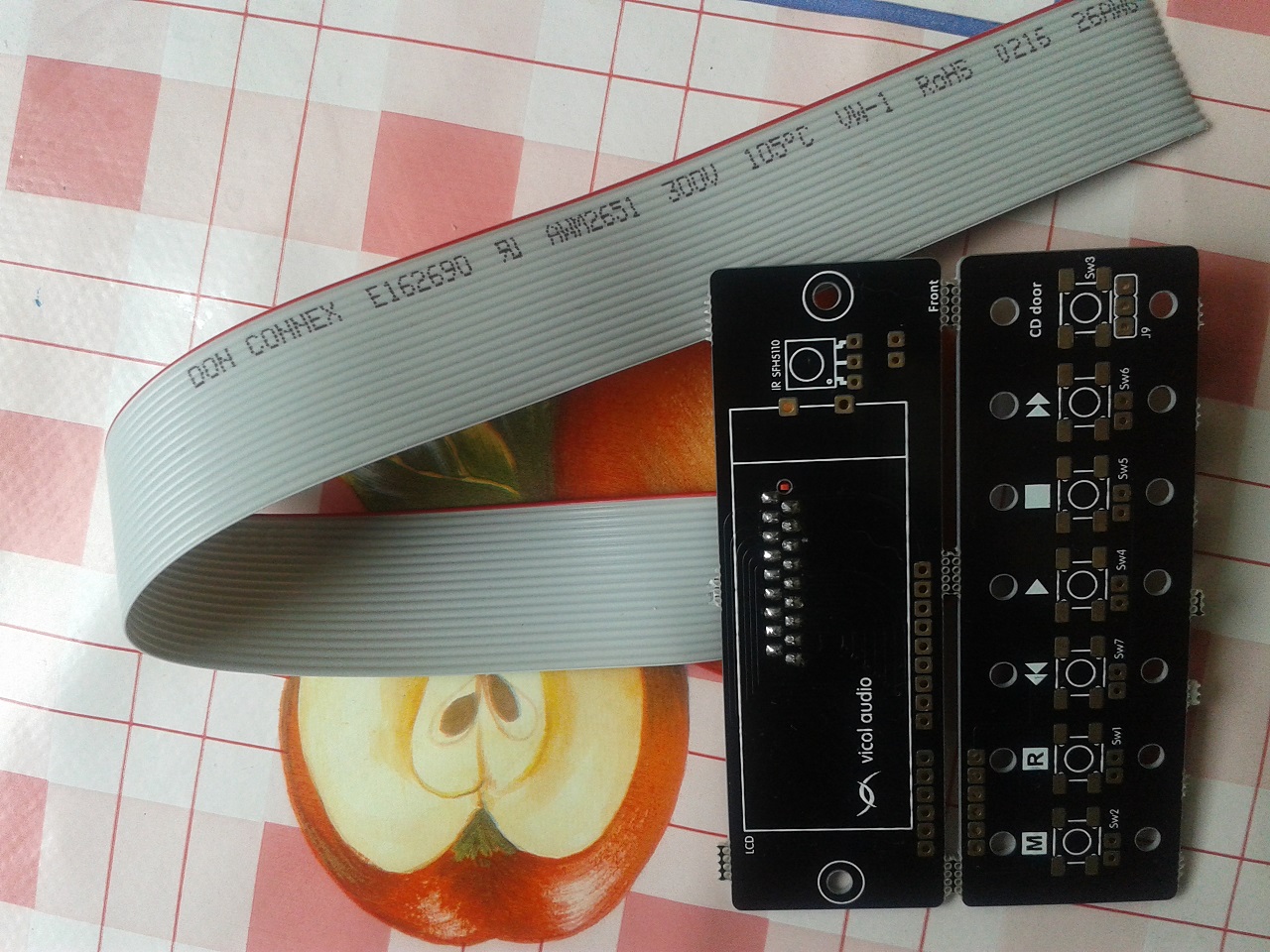

The display/LCD board have a strict order of solder :
first connector ( or ribbon direct if you do not use connector) and then other components.
Then we solder the power board and then testing .

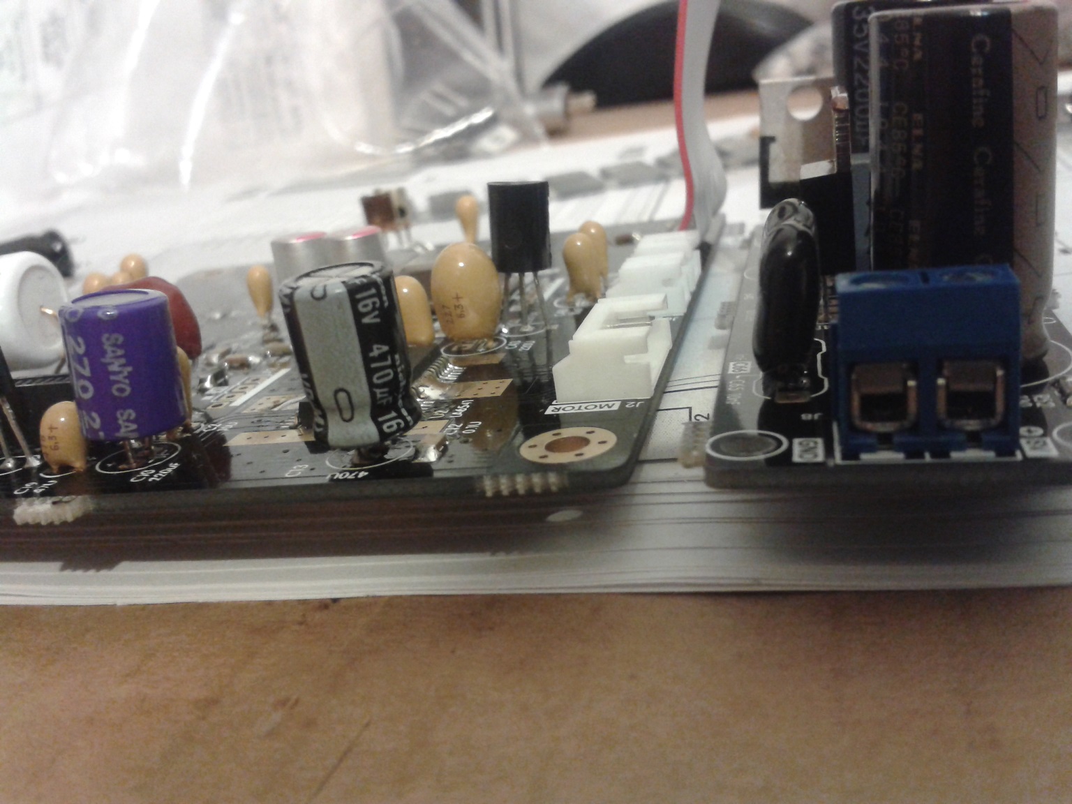

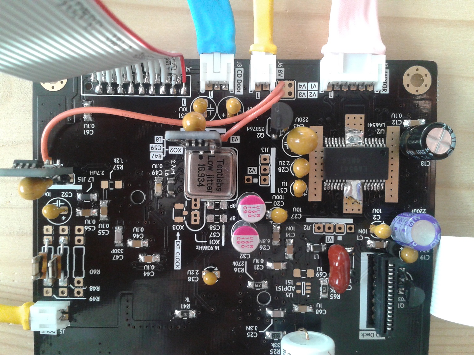

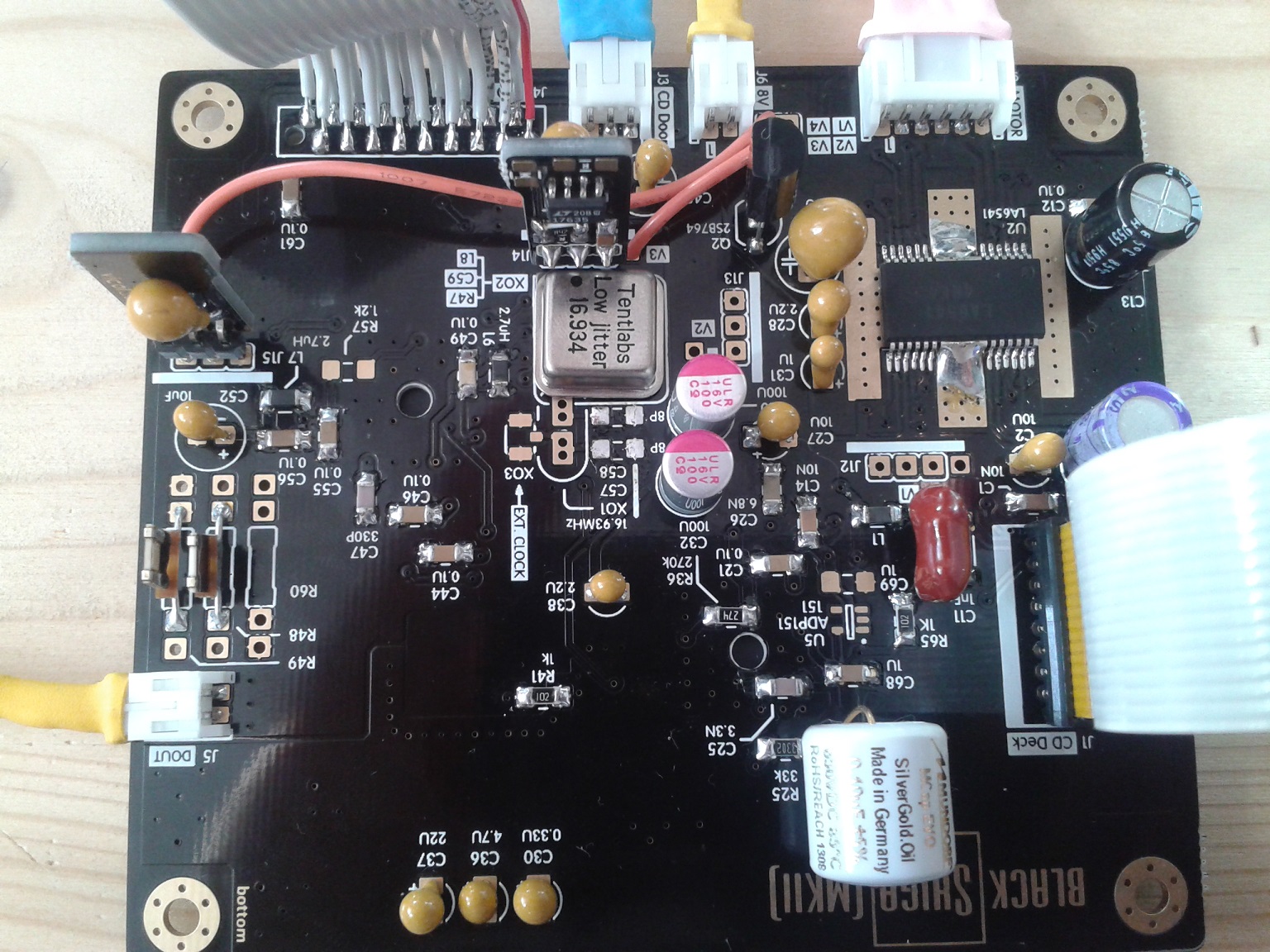

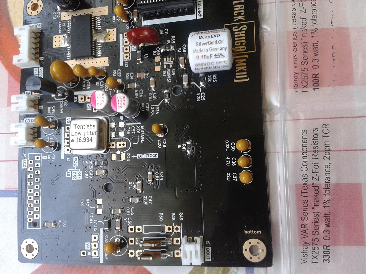

Modding phase
I have some favorites modding on to do list :
- C8 = 100nF Silver Gold Oil Mundorf
- Clock Tentlabs Low Jitter 16,934Mhz (this means out with C57 ,C58, X01) and solder L8
- V3 and V4 miniregs , out with L9 ,L5 , solder wire for 2 miniregs
- C10 = Oscon Sanyo 270uF/10V
- C13 = Nichicon VR(M) 470uF/16V
- R48 , R36 Naked Vishay Resistors
- C11 1nF silver mica

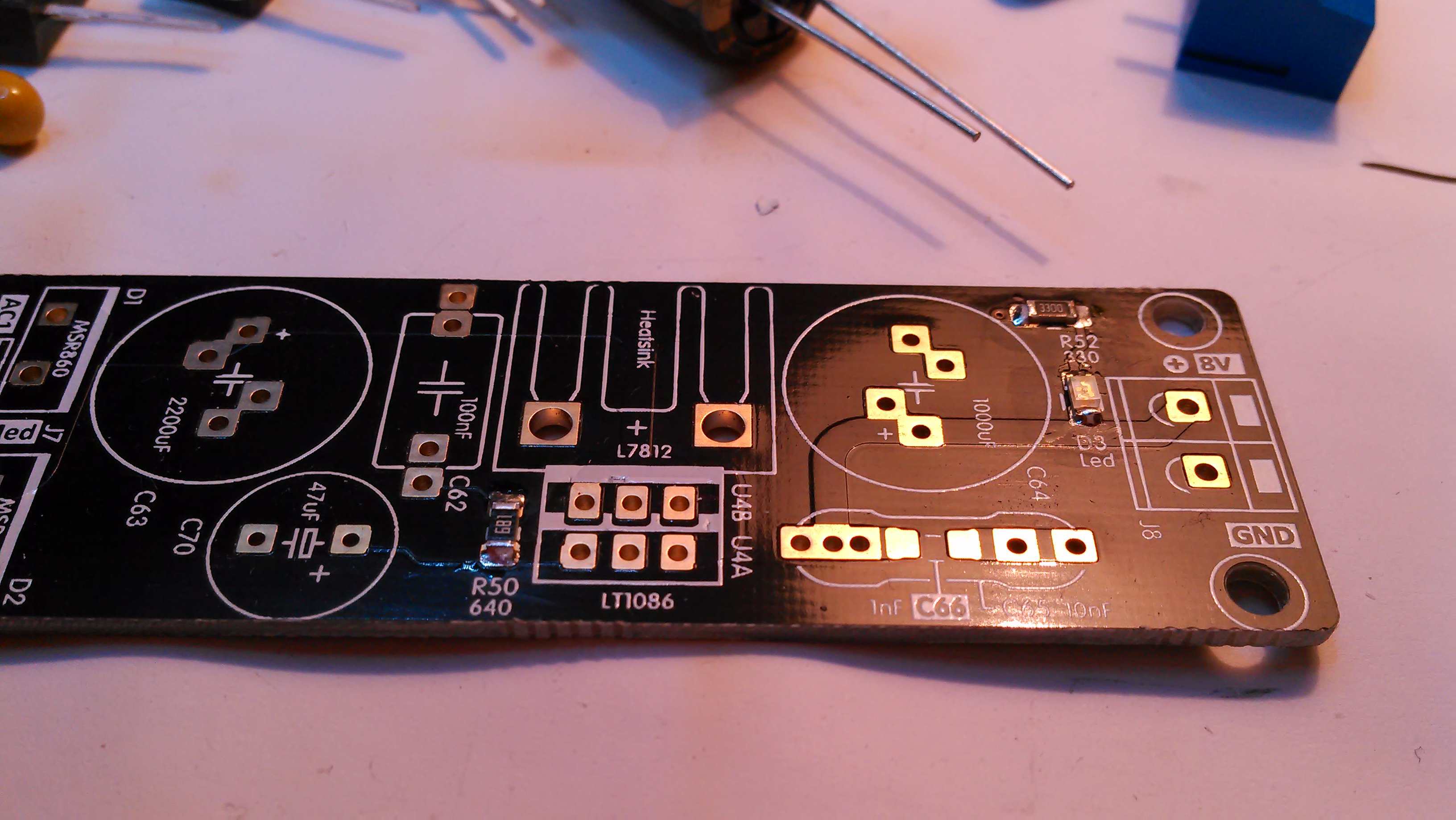

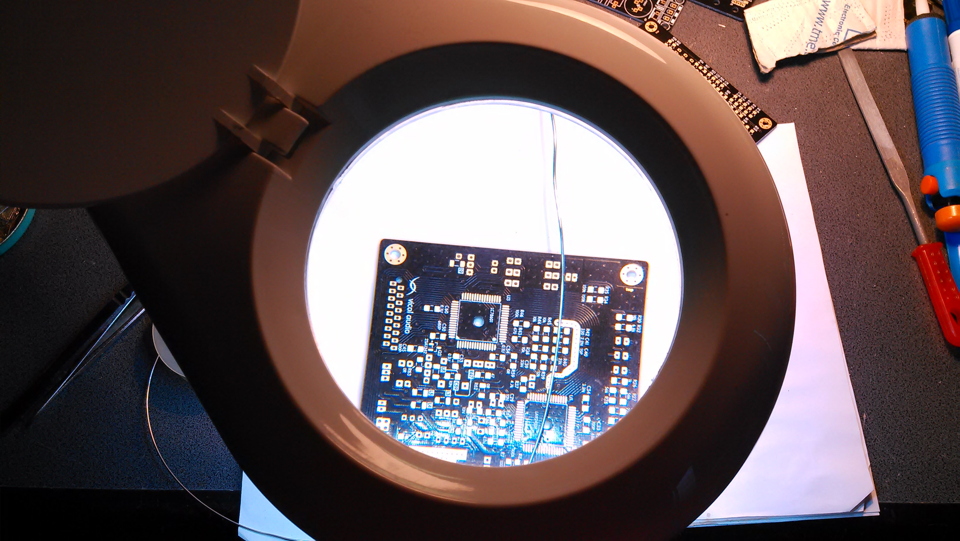

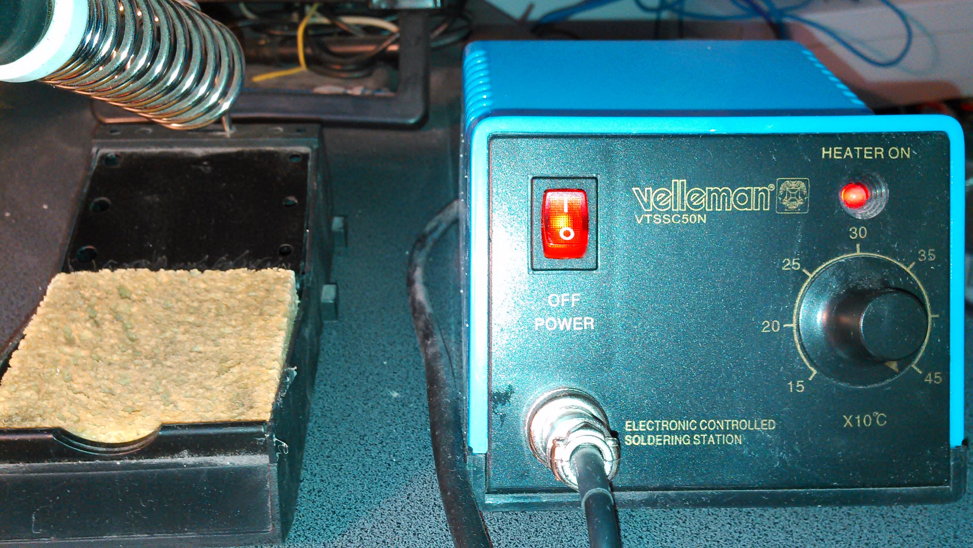

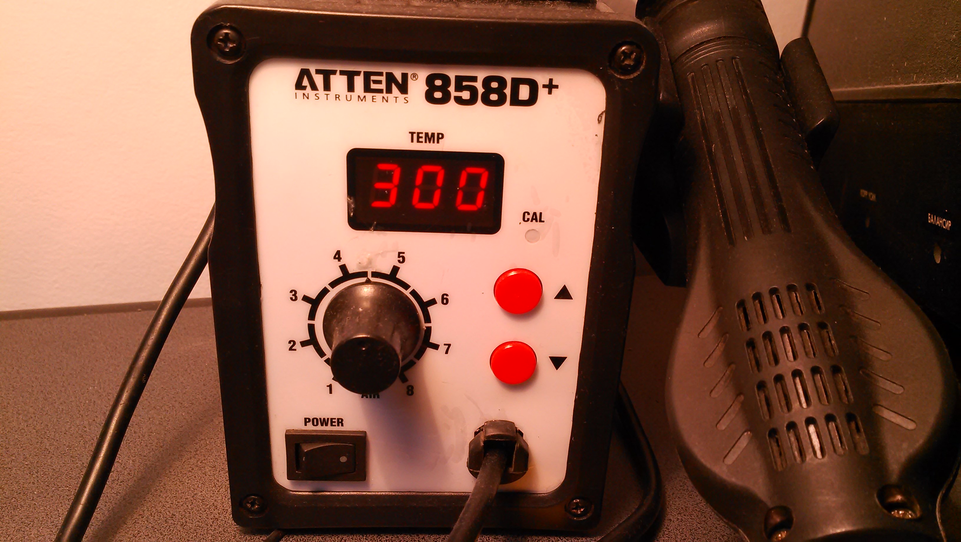

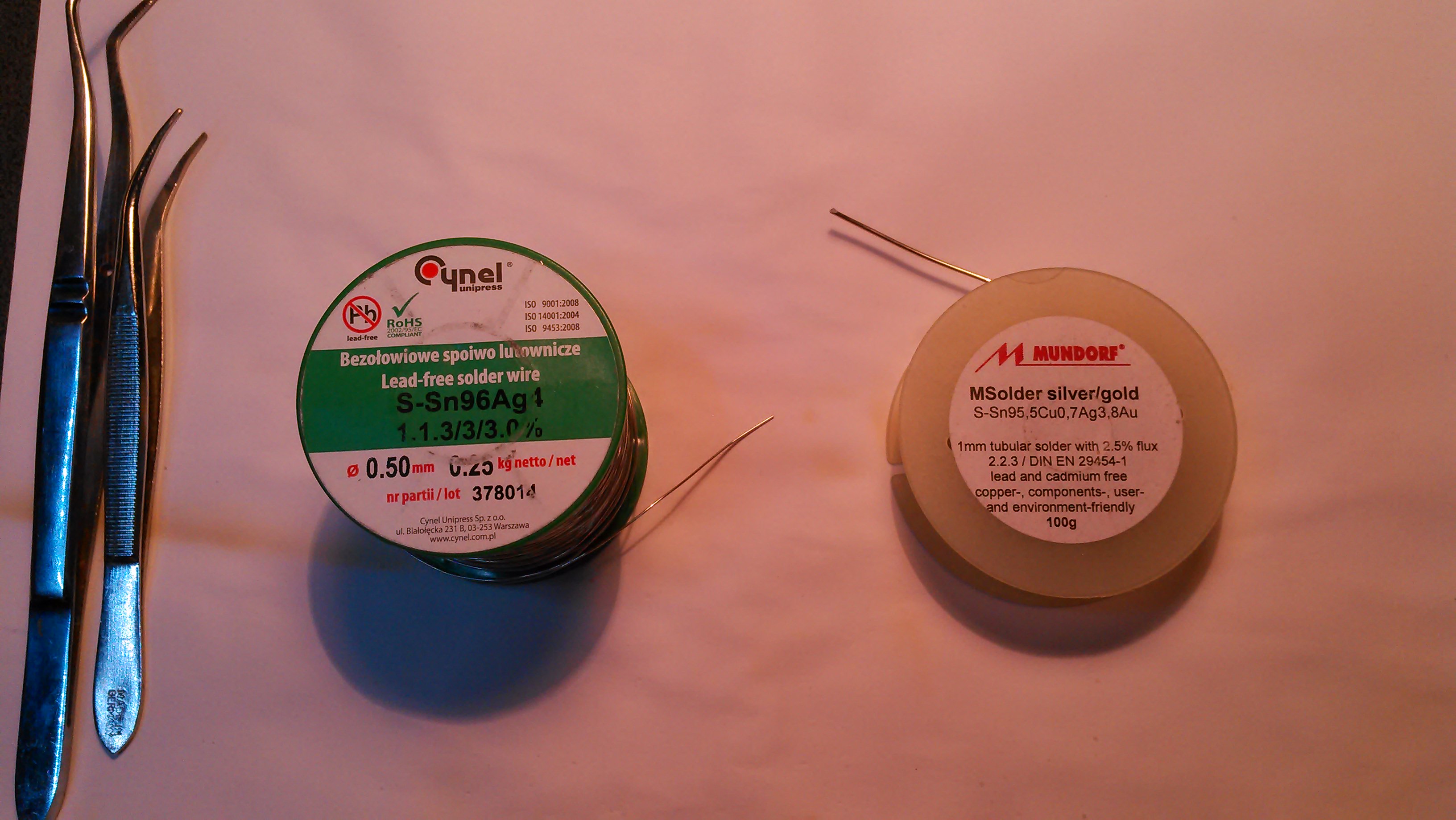

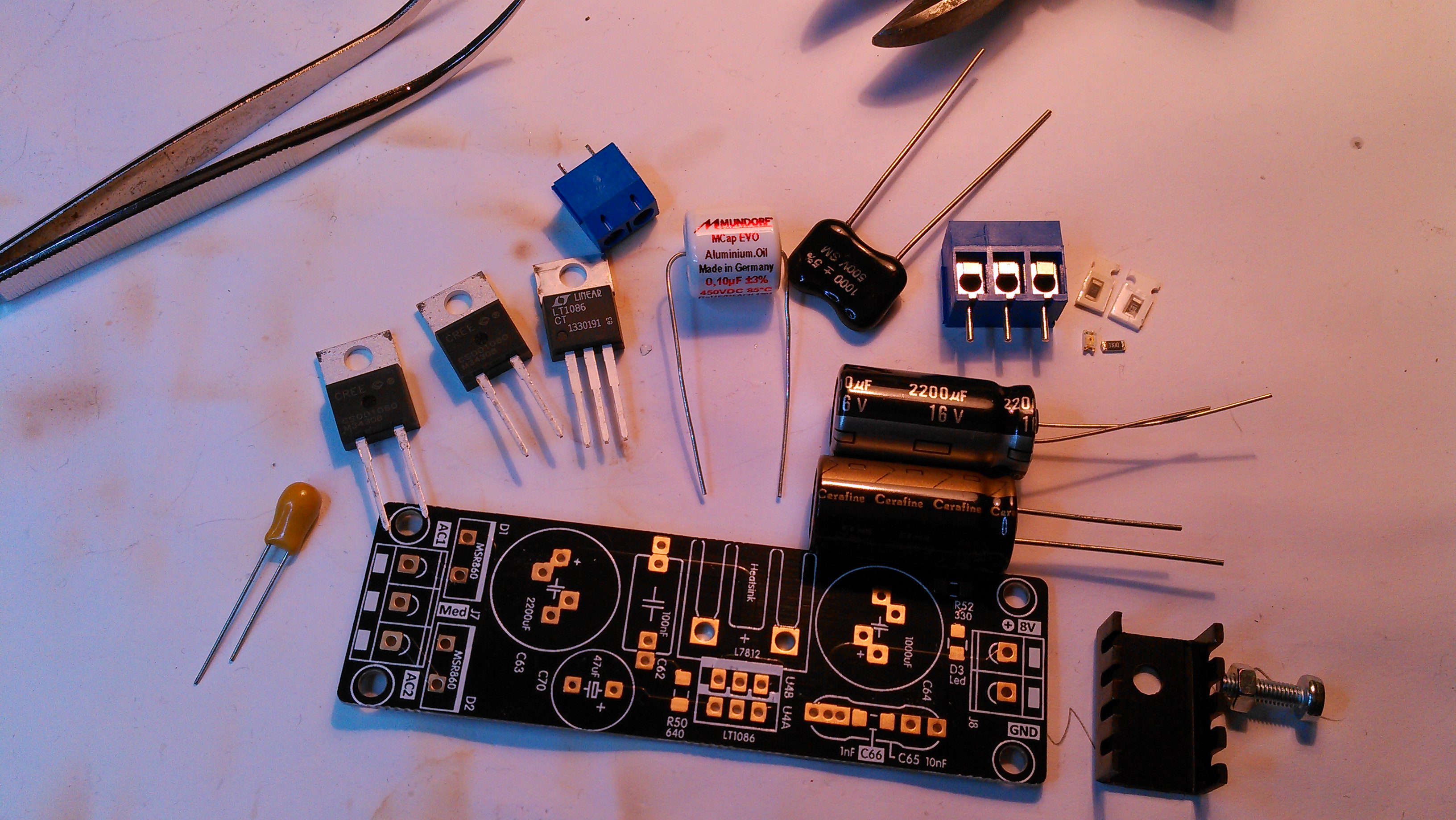

Here is how to build a modified power supply for Shiga MKII.
I'll start with tools I use.
Two tweezers, one for 1206 and one for 0805, flux, different pincers and solder pump.
My preferred solder is Mundorf silver-gold and I use only solder with high Ag percentage and very good flux. Cynel is also good one - SN96A-0.5/0.5 CYNEL - Solder | TME - Electronic components
You will need also a magnifier lamp, soldering station and optional rework station.
Tibi
Tibi
The parts I use for modded power supply.
Instead Soft recovery diodes MSR860 proposed by Peter Daniel, I chose to go for Silicon Carbide Schottky Cree CSD1060A. To my ears these offer a smother and more fluid high register.
The power supply board offer the option for two regulators, standard LM7808 and LT1086Adj.
Beside lower noise and excellent current capability, I got more detail with LT1086Adj, so this is my first choice here. LM317 is out of discussion here, performing under standard 7808, so don't waste your time.
As Black Gates are history, for primary 2200uF cap my choice is Panasonic FM decoupled with an oil cap. I used Russian PIO with great results, but new Mundorf EVO series are quite amazing, compact and performing very very good. Any HF spikes and noise are very nice cleaned.
You can get them from partsconnexion. Very good value.
For output cap my choice was Elna Cerafine decoupled with a 1nF silver-mica. The cerafine will provide excellent low esr, stabilizing LT1086 regulator, while 1nF silver mica, with his ultra low ERS/ESL, will clean further any HF noise.
IMHO this is the most cost effective power supply who will sensible improve your Shiga MKII.
Tibi
Tibi

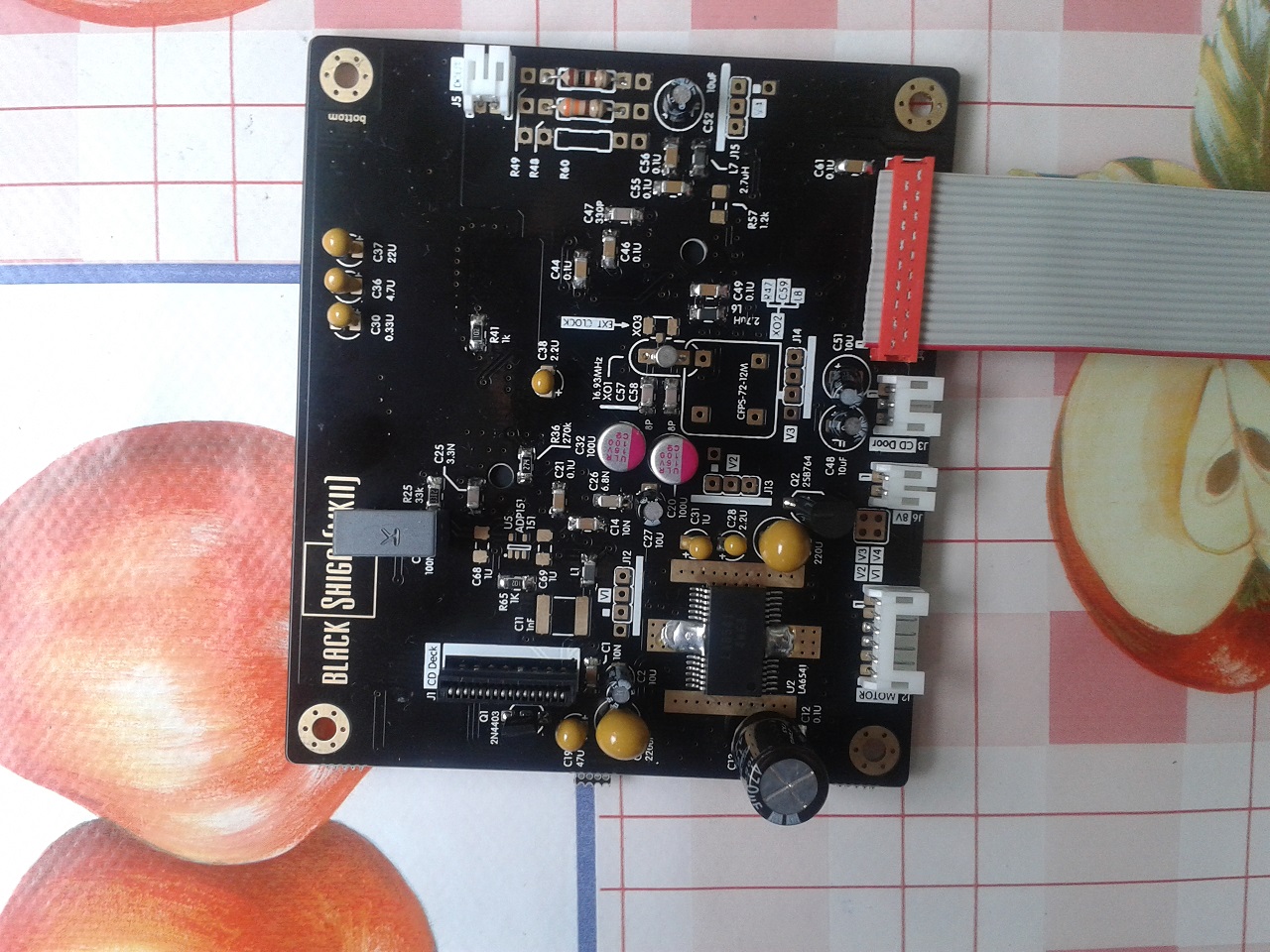

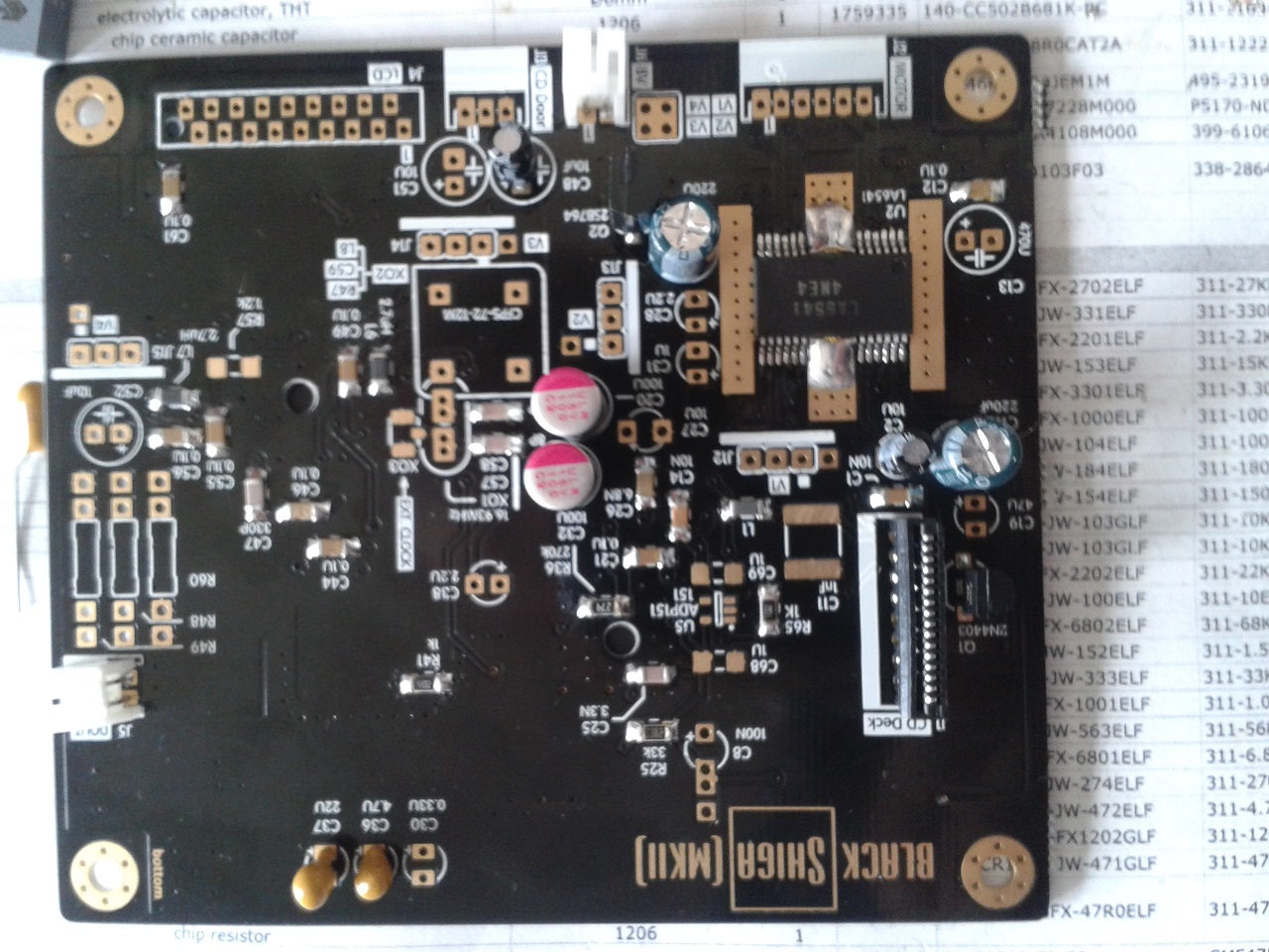

Yes, I started with the SMD resistors. The 100R ones are missing but I rather take that thru PM or in the GB thread. There were a bunch of SMD capacitors without markings so a LCD meter seems to be a mandatory tool I will take these last and solder in the ones identified first to see what they are meant. Maybe they are the same value all of them . Otherwise - marvelous quality.

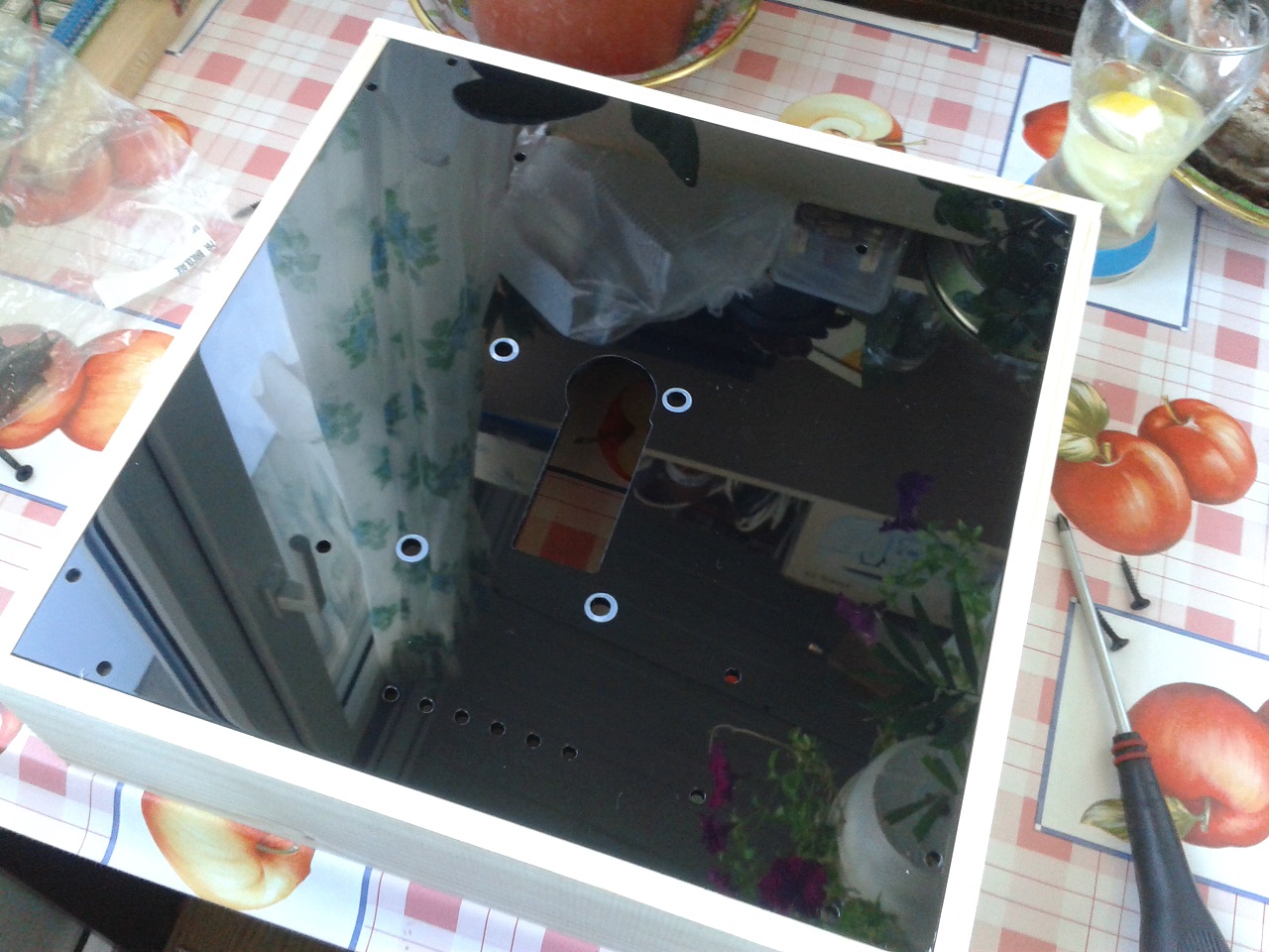

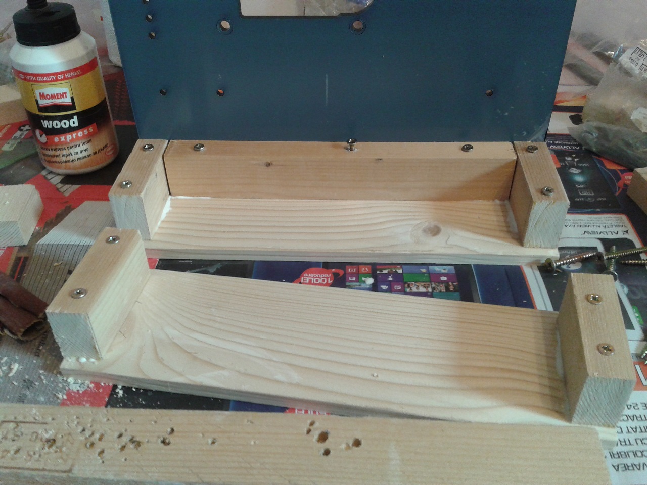

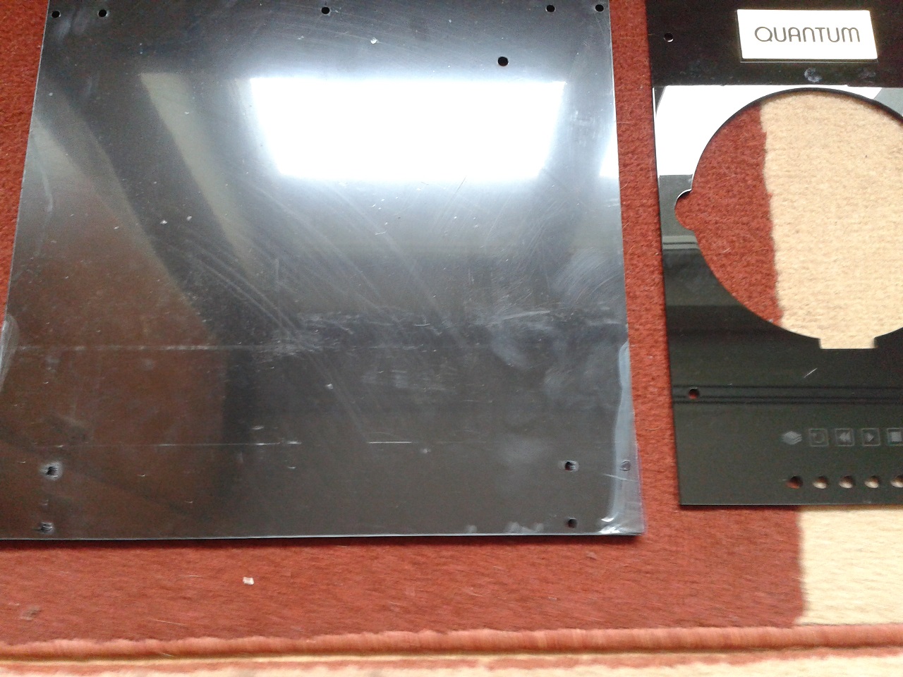

Case will come

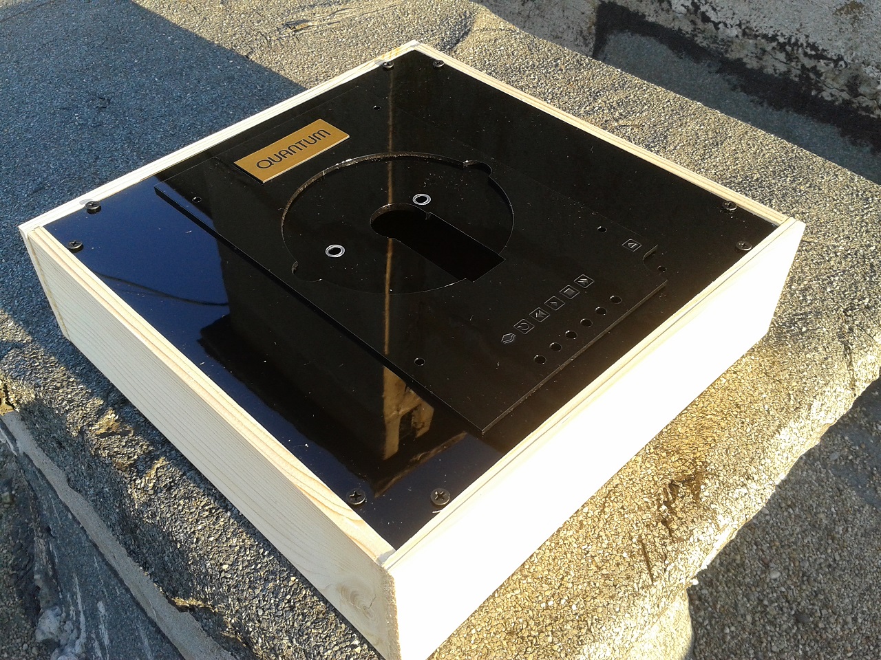

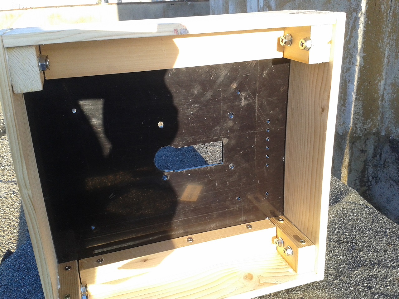

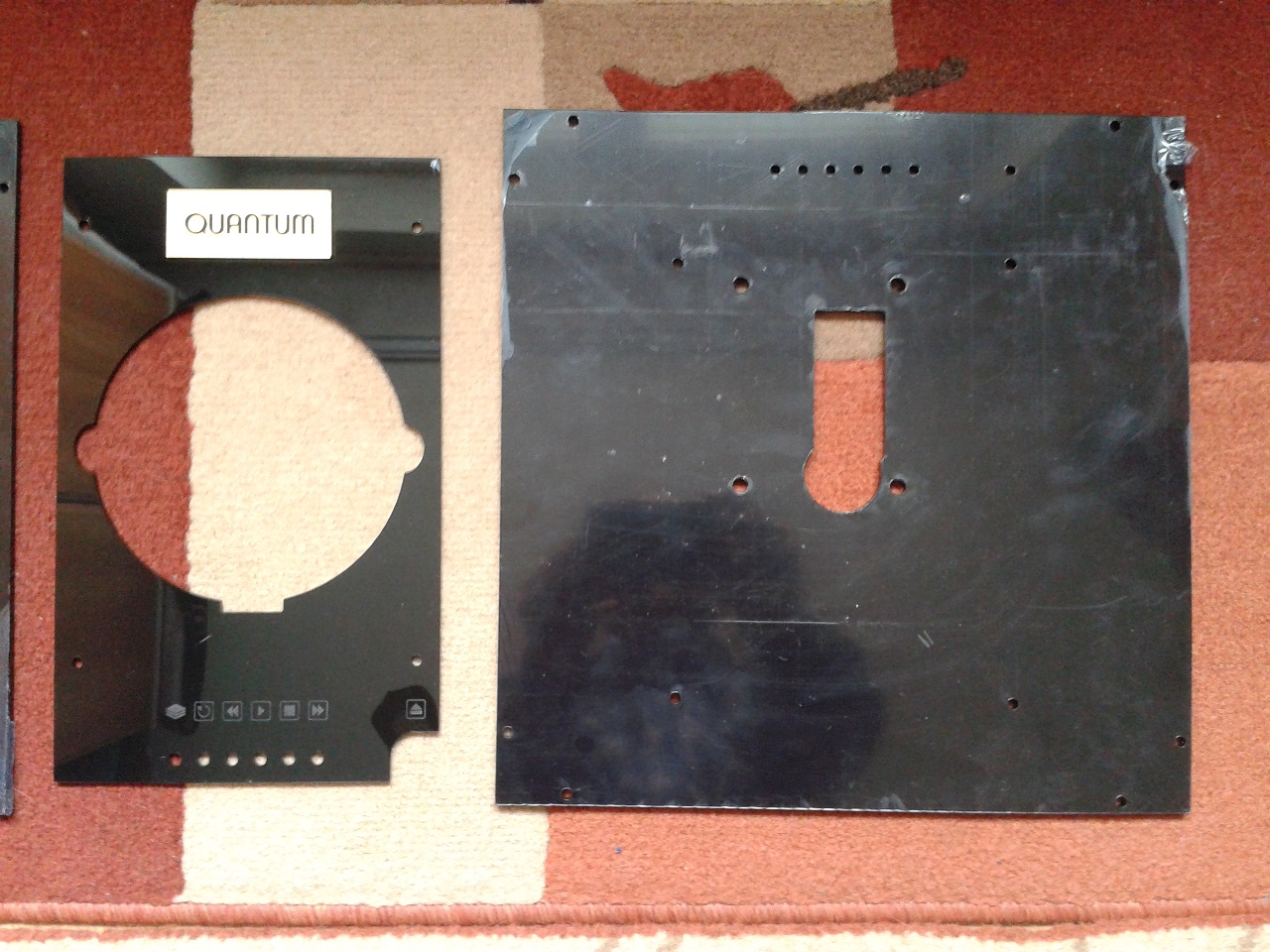

Gone to some little enterprise from my town and got 2 plate : one for cover and one for bottom .
Like in pictures .
Also i buy one piece of wood of 10 cm wide , 2,5cm deep and 2 meters long .
Must now work to do front panel rear panel and rest.
Like in pictures .
If you are missing 100R resistor than means all other kits are missing this part too.
I mentioned several times that a LCR meter is mandatory to finish SHIGA MKII.
On first SHIGA GB I did my best to mark all parts. People started to solder these without measuring and switched 3,3nF with 33nF, 10nF with 100nF and other parts too. This lead to non functioning kits or malfunctioning ones.
So, I decided do not mark these parts and force you to measure them.
Please measure resistors as well, because 3300 is not the same with 332.

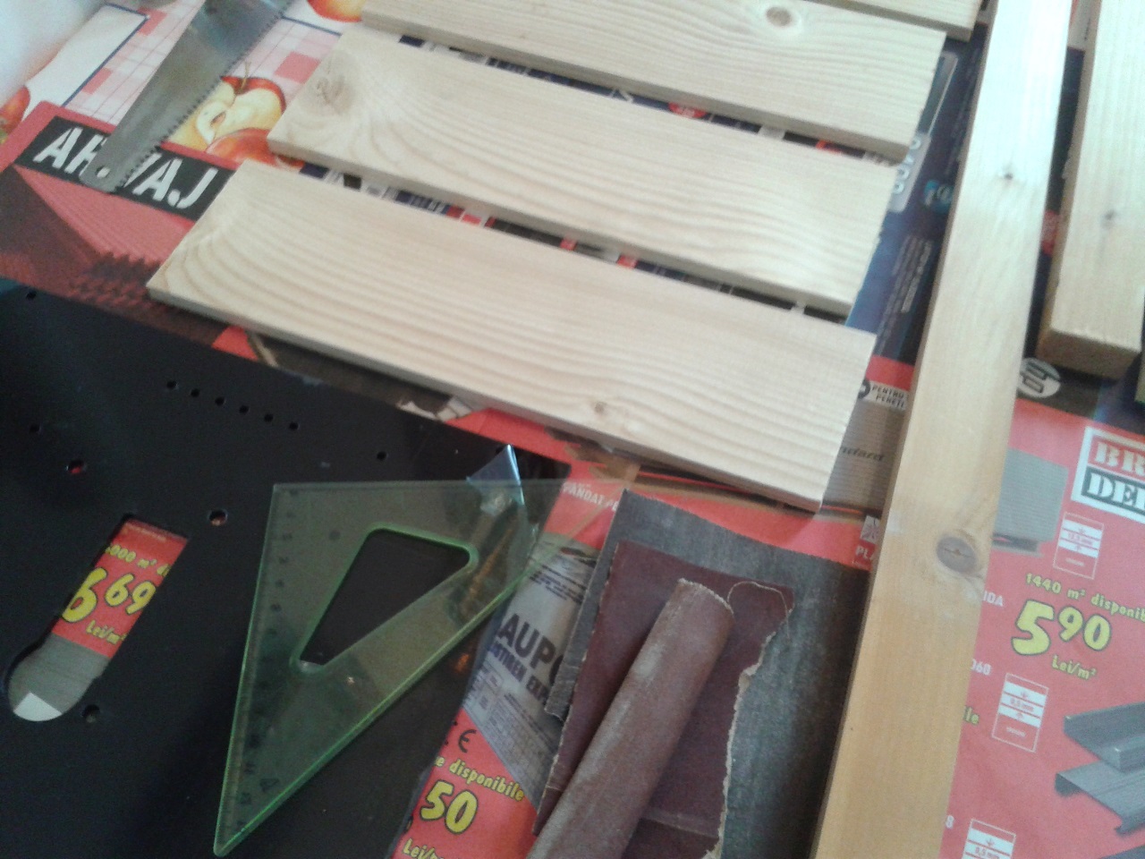

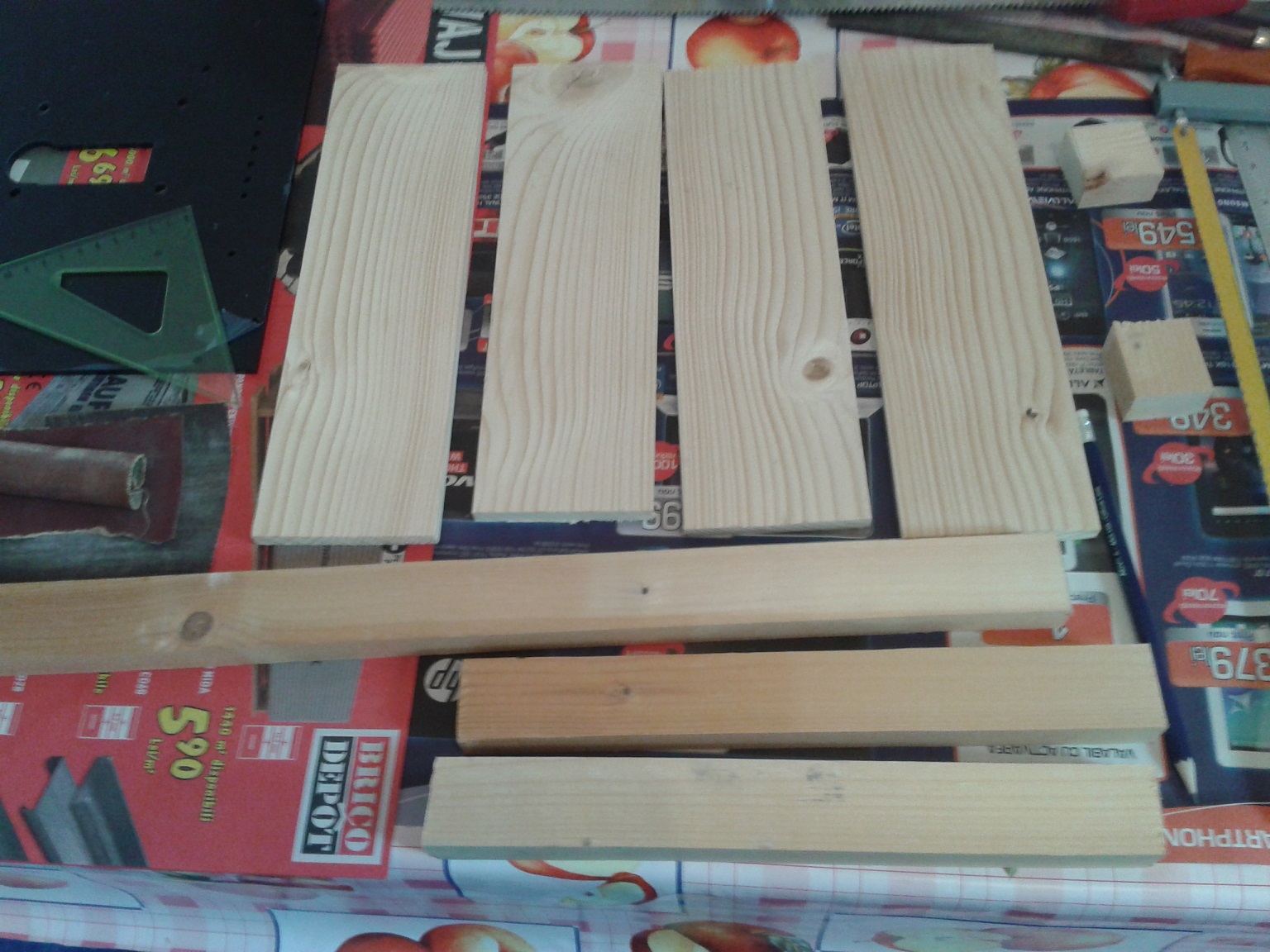

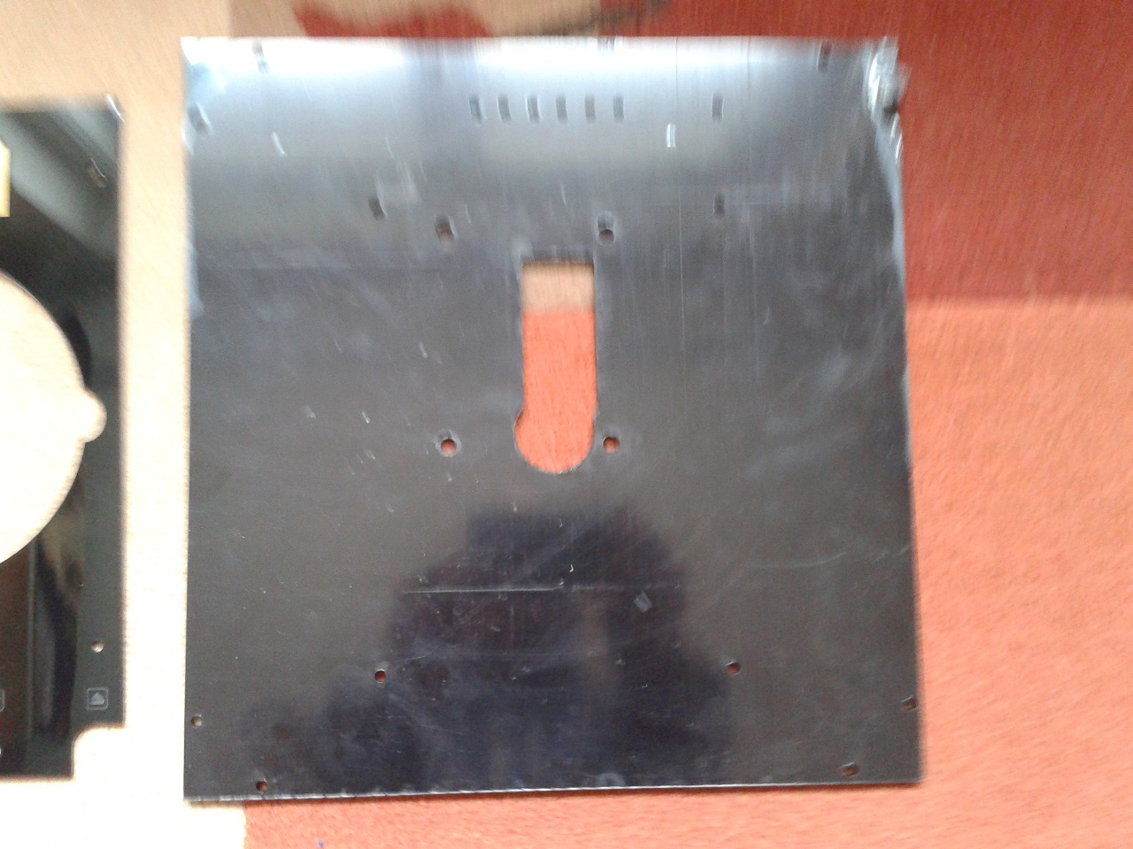

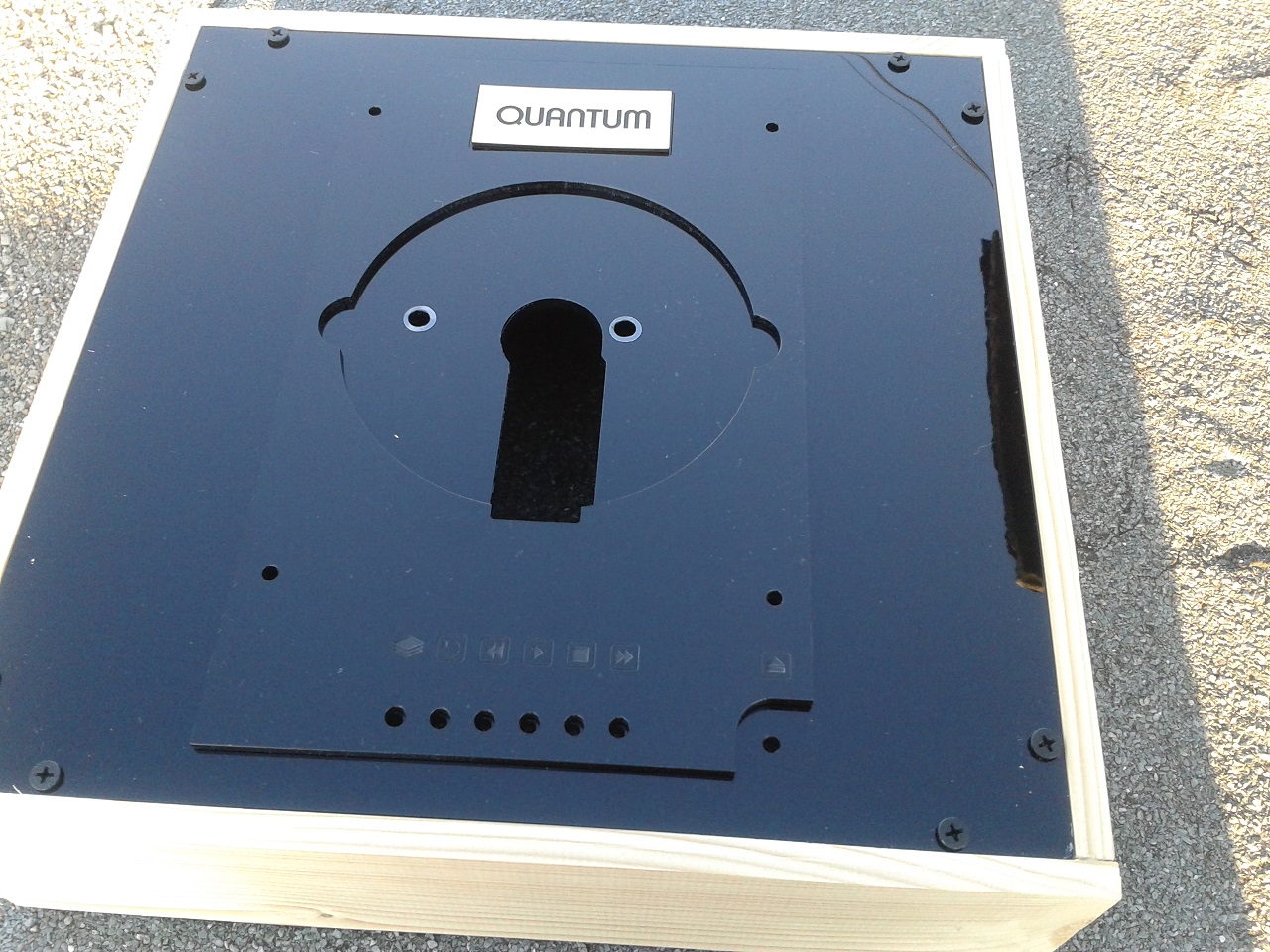

Now after a day work at case , I am at stage where follows retouch and to make holes for LCD on front and on back holes for SPDIF , Power and power button.
I have attached pictures during the working and till the actual stage of case.

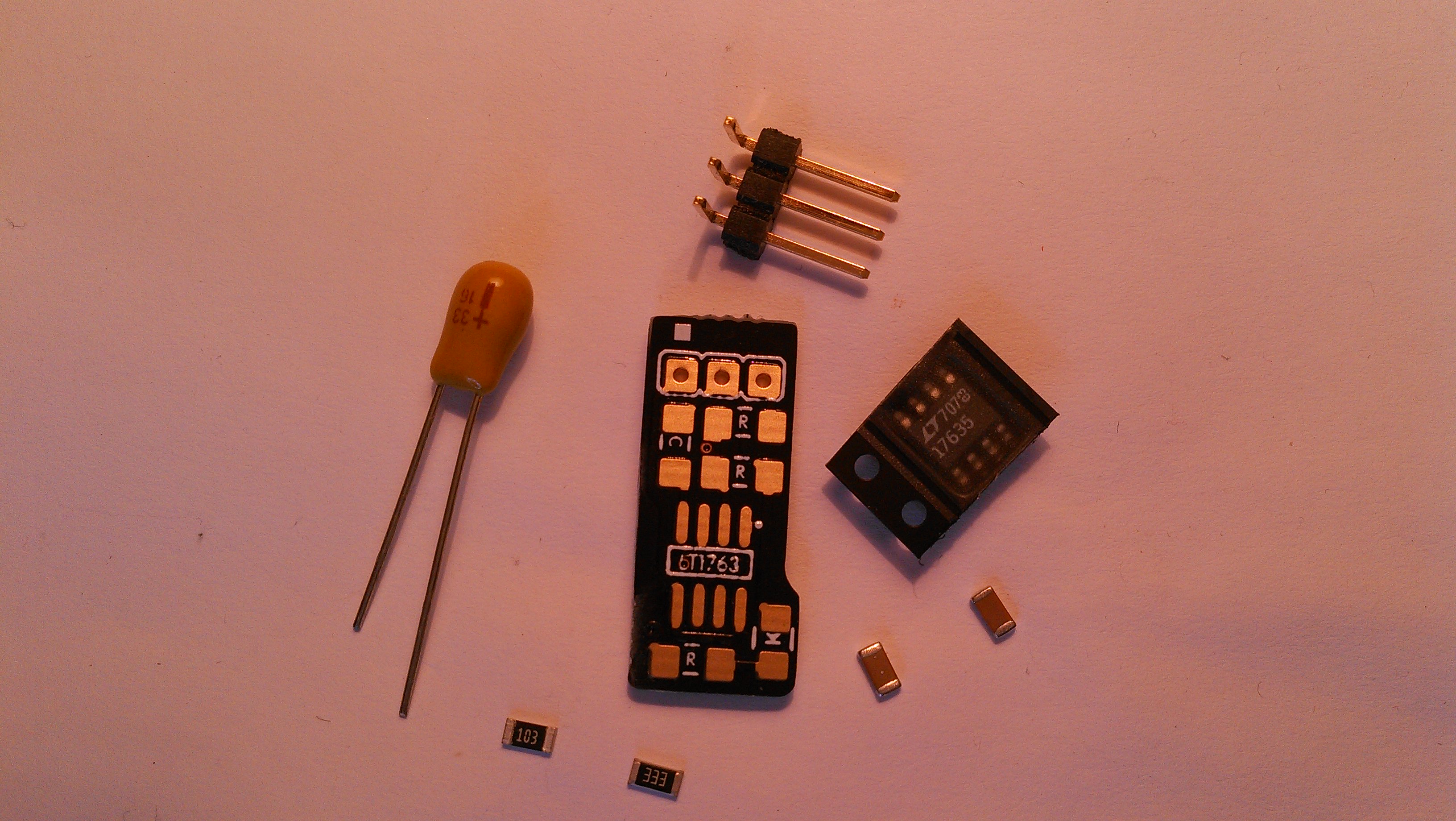

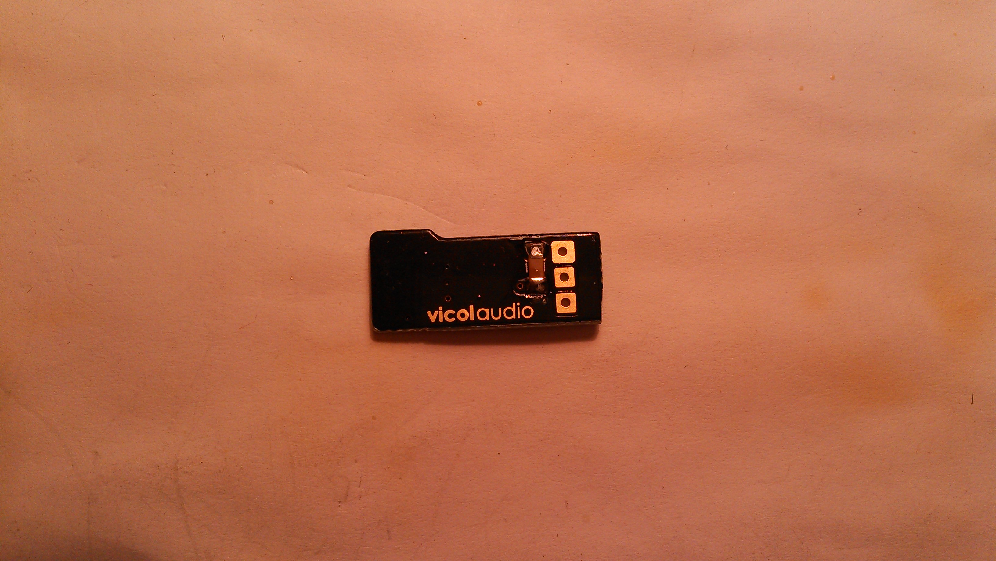

Building minireg
Building ULN LDO minireg.
You got in your KIT two minireg pcb boars. These are optional and have been added as bonus. Even there is space to mount 4 such miniregs, only two can be mounted for V3 and V4.
V3 will power oscillator section, while V4 will power the rest of LC78601R sections.
These will enhance Shiga MKII performance to next level. I highly recommend to use them.
(For V1 and V2 you may use other super-regulators able to deliver at least 100mA continuously. Due laser current needs, V1 and V2 regulators must be powered from a separate power supply, or before main 8V regulator.)
There are two types of miniregs you can build. One using fixed 5V output regulator marked LT17635 and adjustable output marked LT1763.
Will address construction for both.
Parts needed for LT1763adj:
- minireg pcb
- LT1763adj
- two resistors 33K and 10K
- two capacitors 10nF and 100nF
- 33uF/6,3V tantalum capacitor
- pins
Parts needed for LT17635:
- minireg pcb
- LT17635
- resistor 0ohm
- pins
Tibi

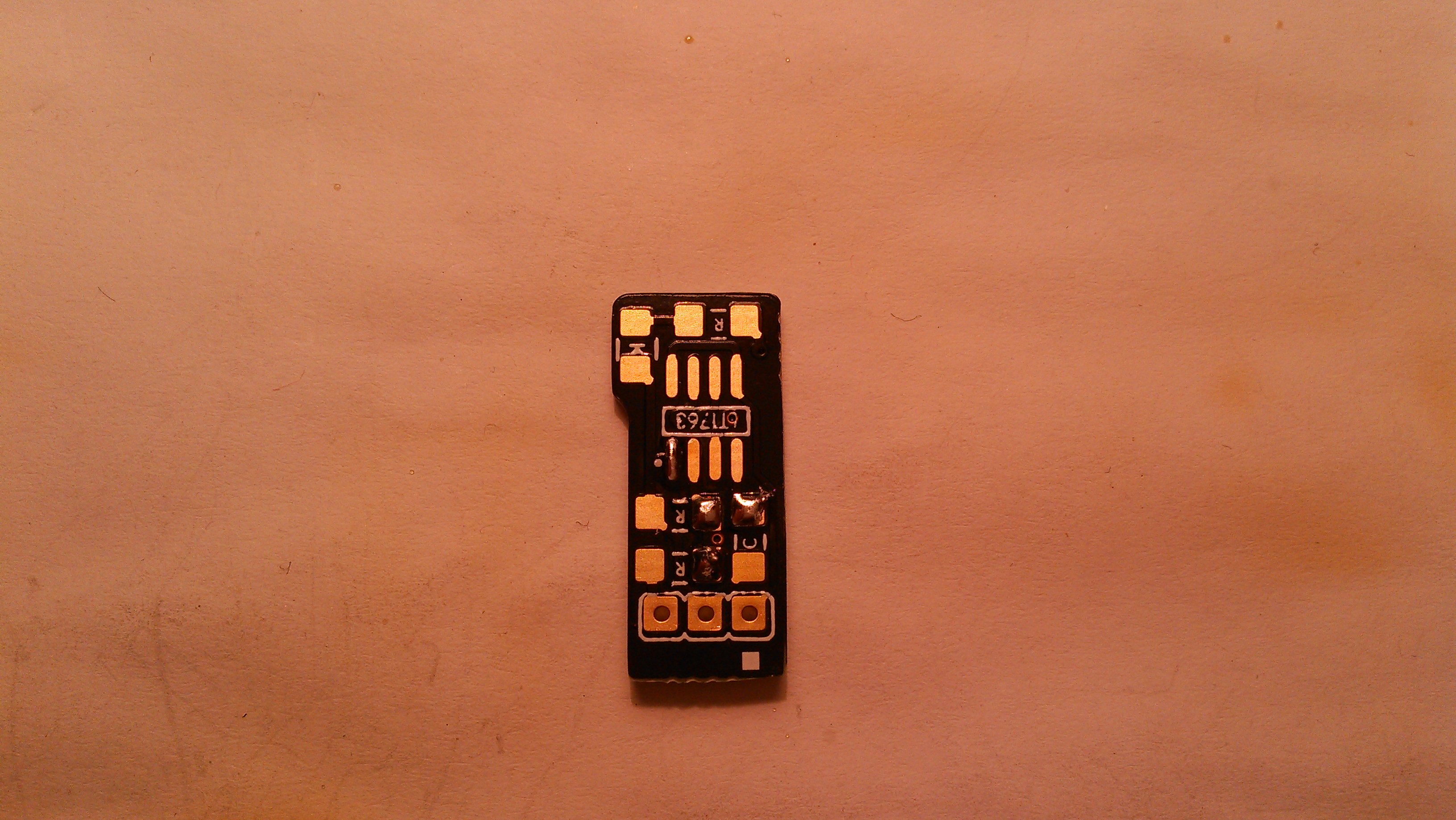

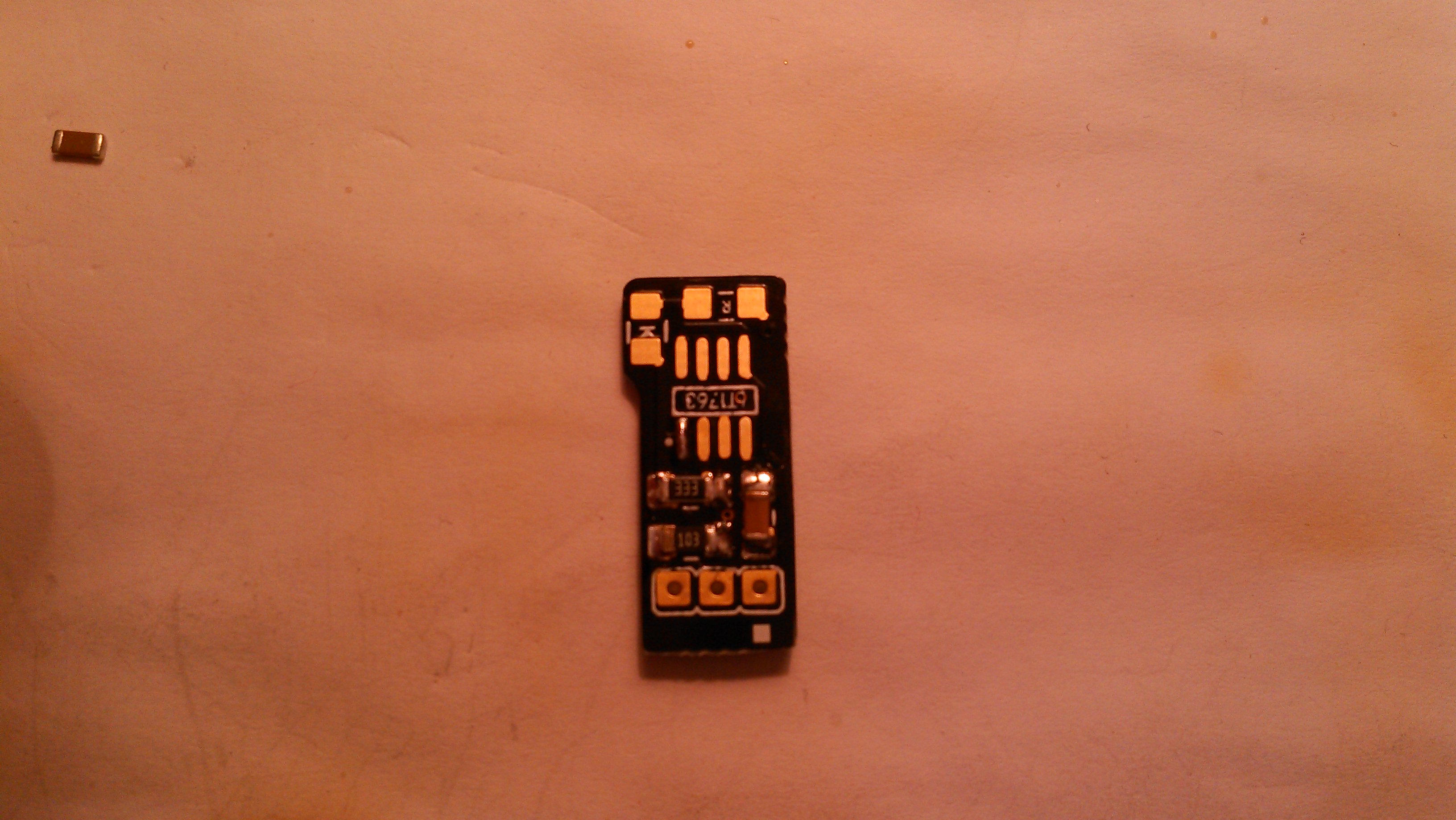

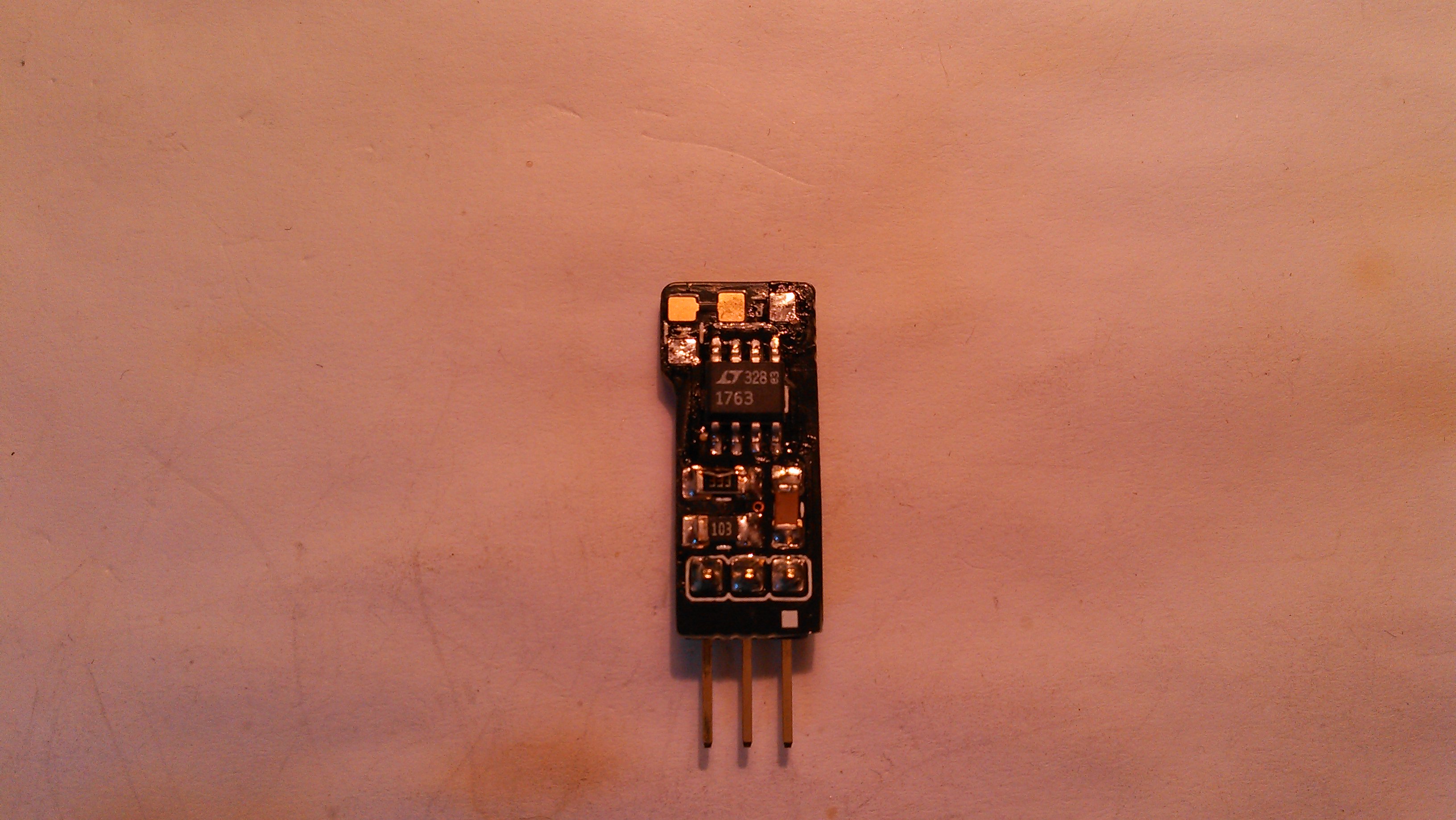

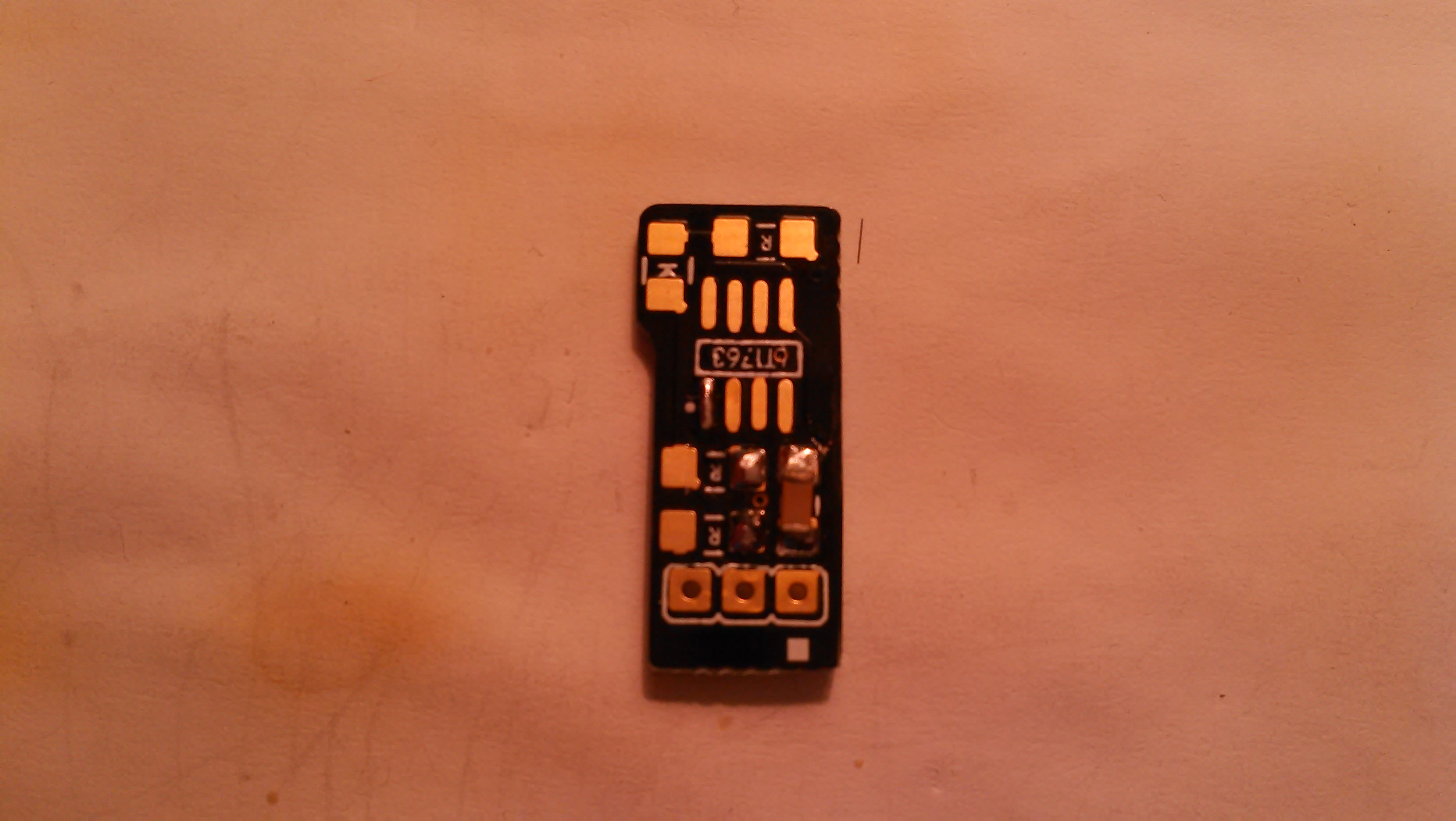

1. first step is to prepare board for smd parts soldering.
Add solder only one one side of each component.
2. next solder 10nF capacitor. This is bypass capacitor. Theoretically this will lower output noise to value specified in datasheet 20uV.
3. solder 33K and 10K resistors as per third picture.
4. reverse pcb and solder 100nF. Add some more solder, as over this 33uF tantalum will be added.
5. solder LT1763 chip
6. last step is to solder 33uF tantalum cap. See below why.
Tibi
Tibi

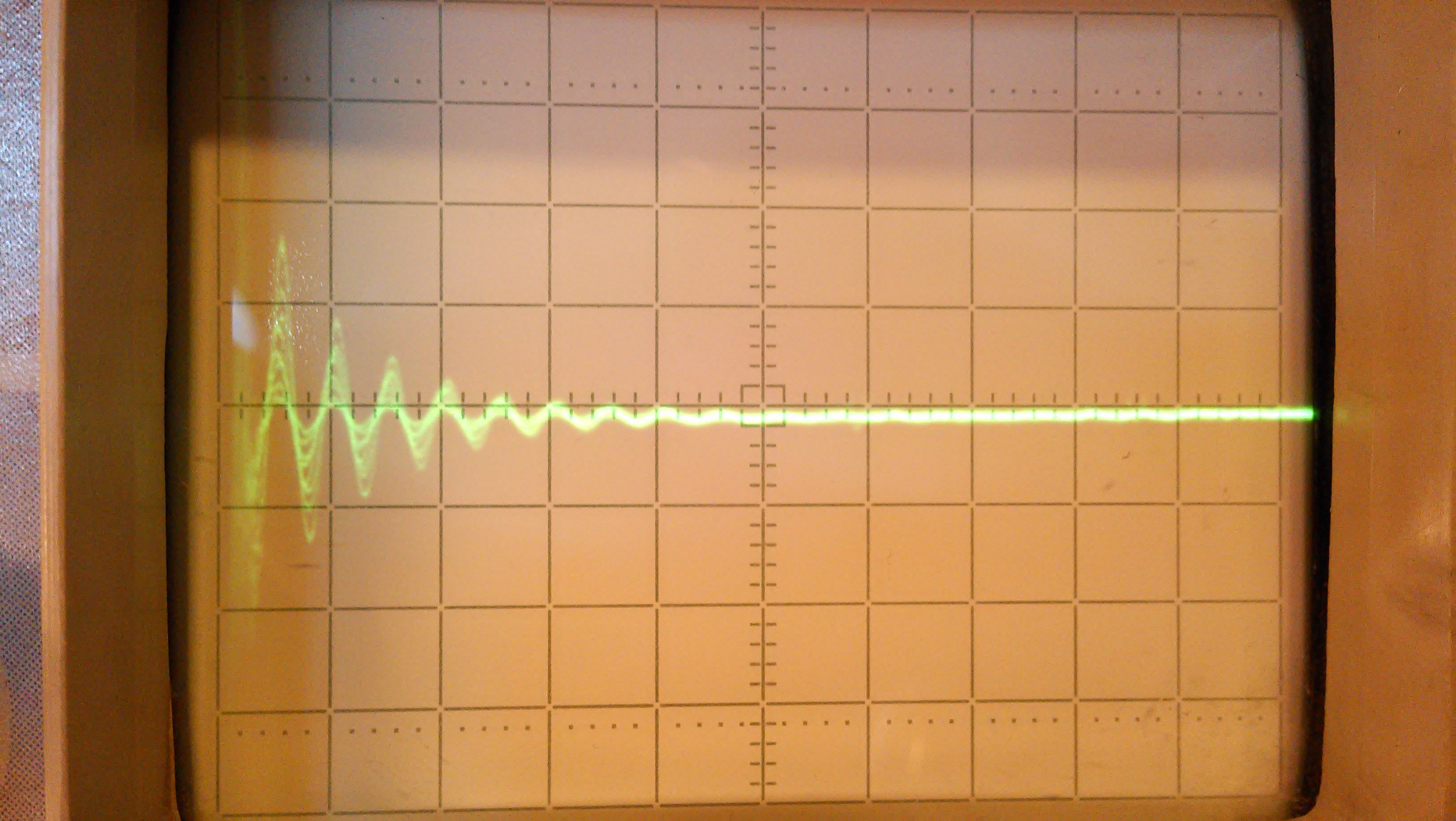

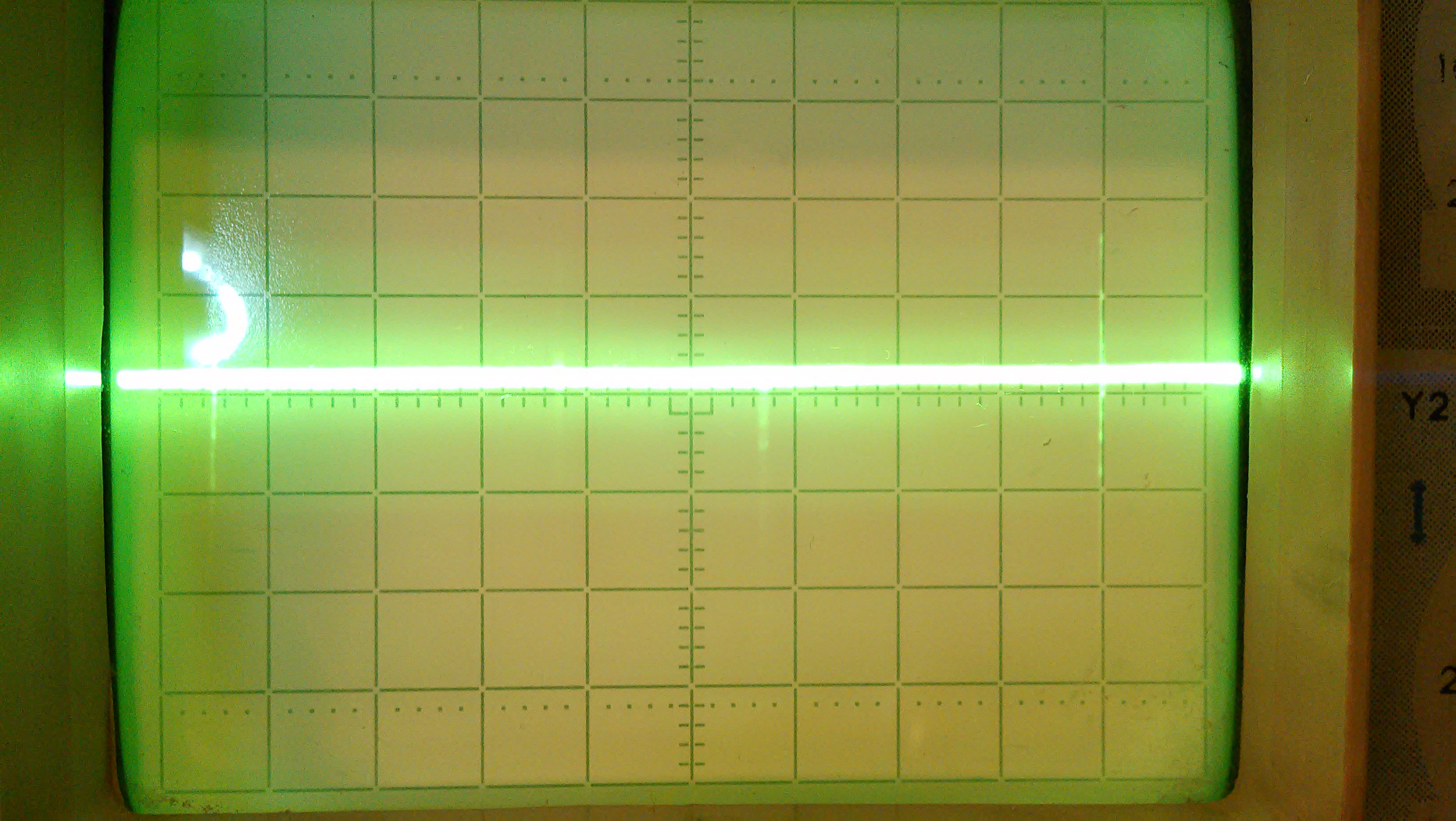

At this stage, if you measure output regulator with a voltmeter, you get a nice and steady 5.2V
However, in datasheet is mentioned that LT1763 is stable only with an minimum 3.3uF capacitor.
Well this is not the case (see pictures), even with a 3.3uF tantalum cap, you still get oscillations at high frequencies.
With 10uF I get a straight clean line. So any cap above 10uF will do the job. I had a bunch of tantalum 33uF so this is the value I used.
Tibi
PS. In below pictures vertical scale is 5mV/div. output regulator noise with 3.3uF cap.
Tibi

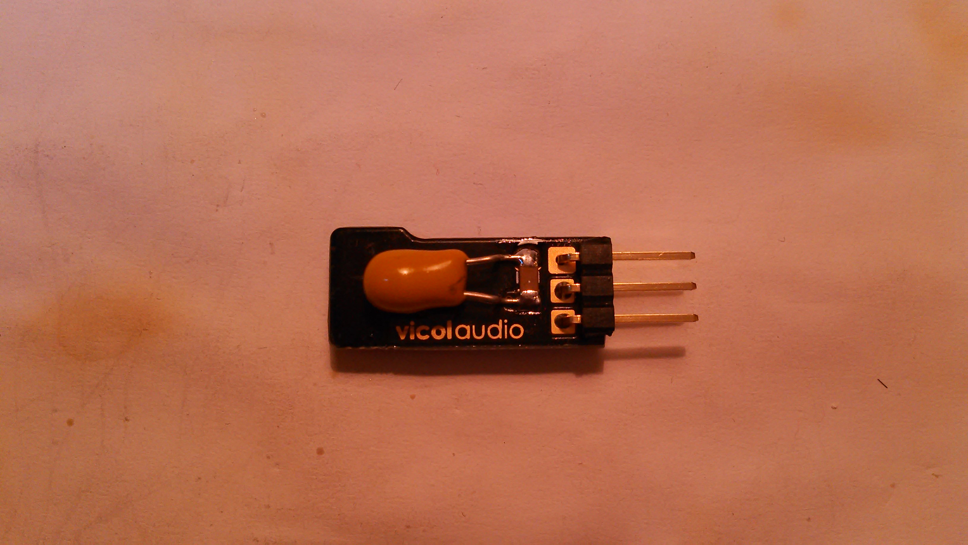

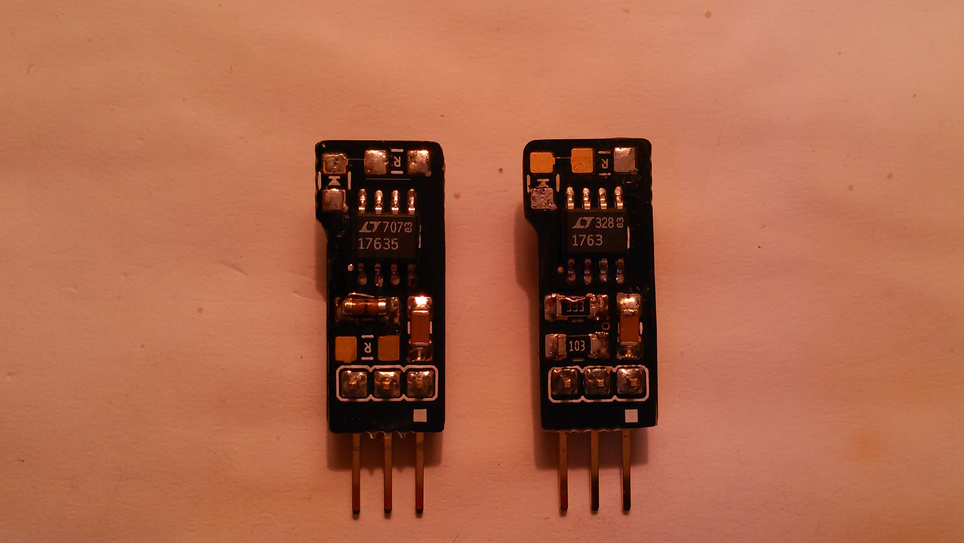

Here are both regulator types.
Left is the one with LT17635 (fixed 5V output).
Right is the one with LT1763 (adjustable output)
The difference is that on fixed 5V output you do not mount 10K resistor and 33K must be replaced with 0ohm.
Tibi
Tibi
A very important observation is do not mix fixed with adjustable regulators.
For proper operation, LC78601R need to have same voltage, or very close, on all power pins.
With 33K and 10K, adjustable version will output 5.2V and in operation this will drop to ~5.13V, while on fixed you get 5V and ~4.9V in operation.
So, take care, do not mix them.
Tibi
Tibi
