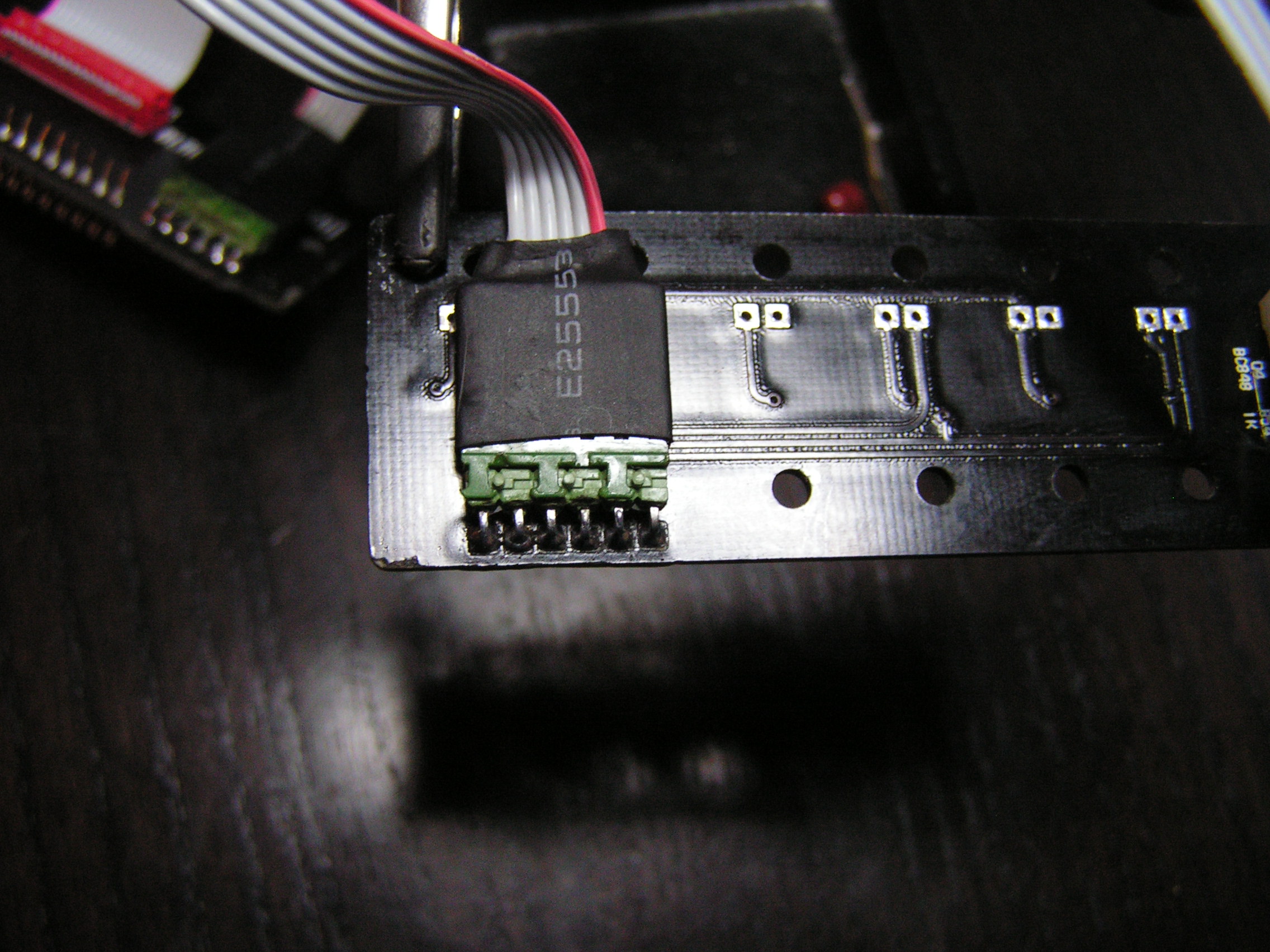

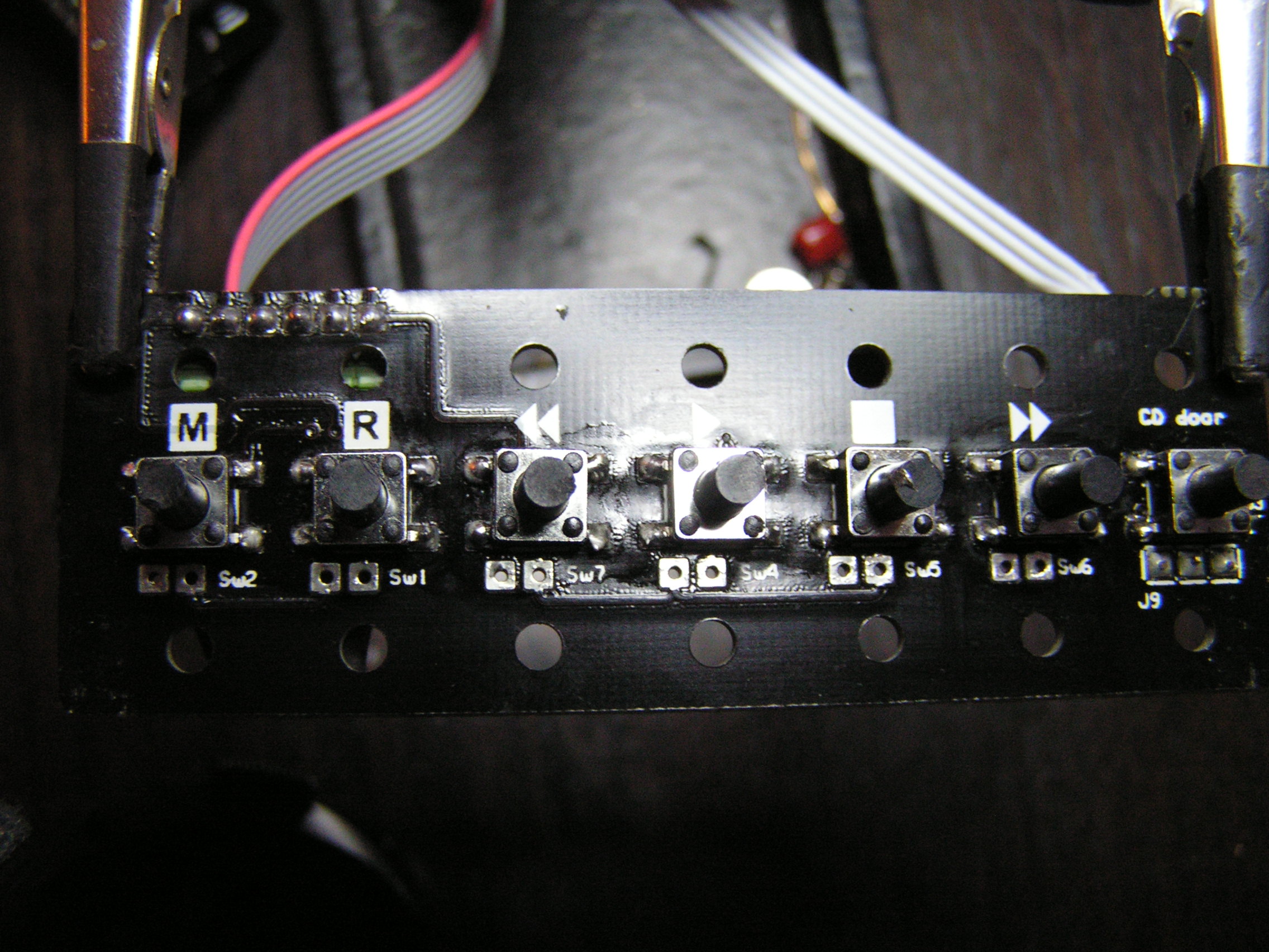

Hello Tibi,
I separated the controle board from the LCD board and use connectors on both boards for the wirering. I measured all contacts in order 1 to 6 with my multimeter on "beeb". Firering up the cd player it reeds TOC but does not respond to the control board. If I press CD door it responds and reads TOC, but if I want it to play, nothing happens. I feel like an nono and don't know how to proceed. Please help.

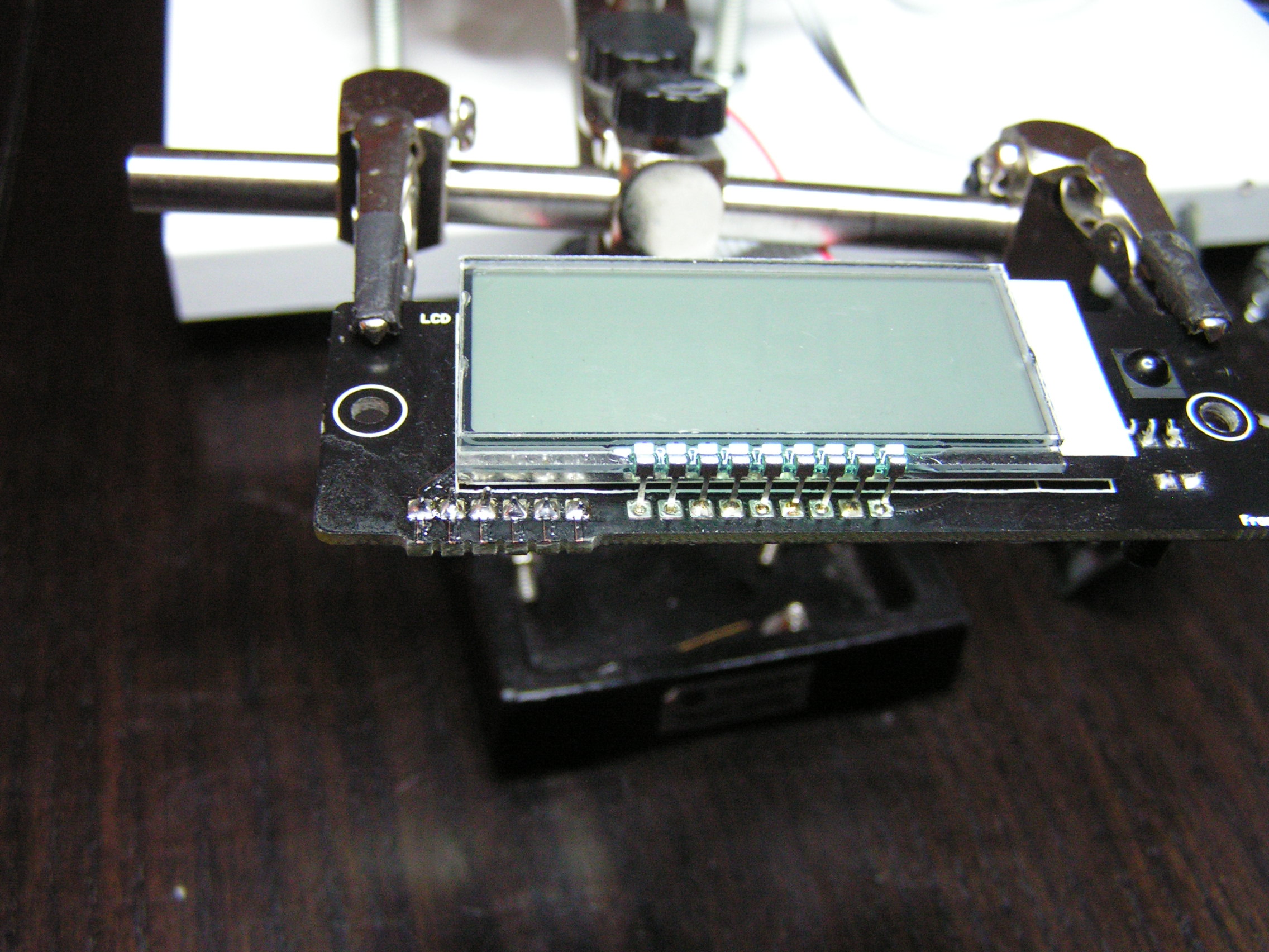

Hi Tibi,
Attached various pictures.
I measured signal between pins LCD and corresponding pins on contol board. They all connect. I don't know if pins make the right contact with the board.
Can I measure that in some way?

I think you have a shortcut between first two pins, from left, on display side.
Tibi
Tibi
I noticed the picture was confusing, checked it afterwards. There is no shortcut between first two pins.
Robert
Robert
Unless is a soldering issue, or some wire do not make contact, I see no reason this do not work.

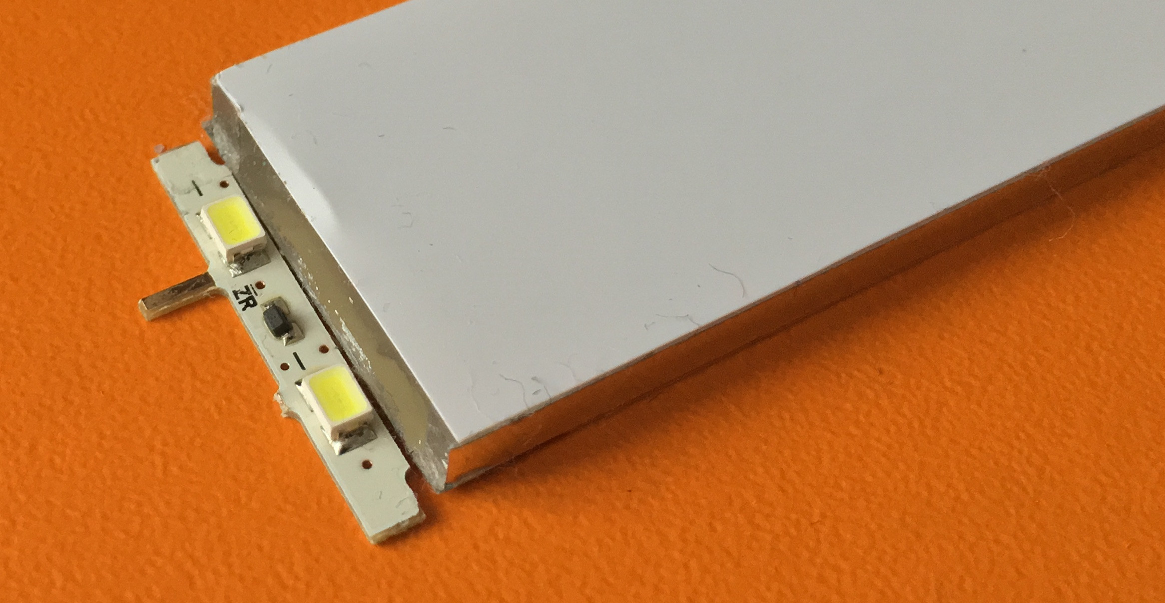

1.) Checking the bachlight I noticed that one pin from the backlight is loose. The pin is correctly soldered to the board but it is loose on the backlight side. How should I fix that?

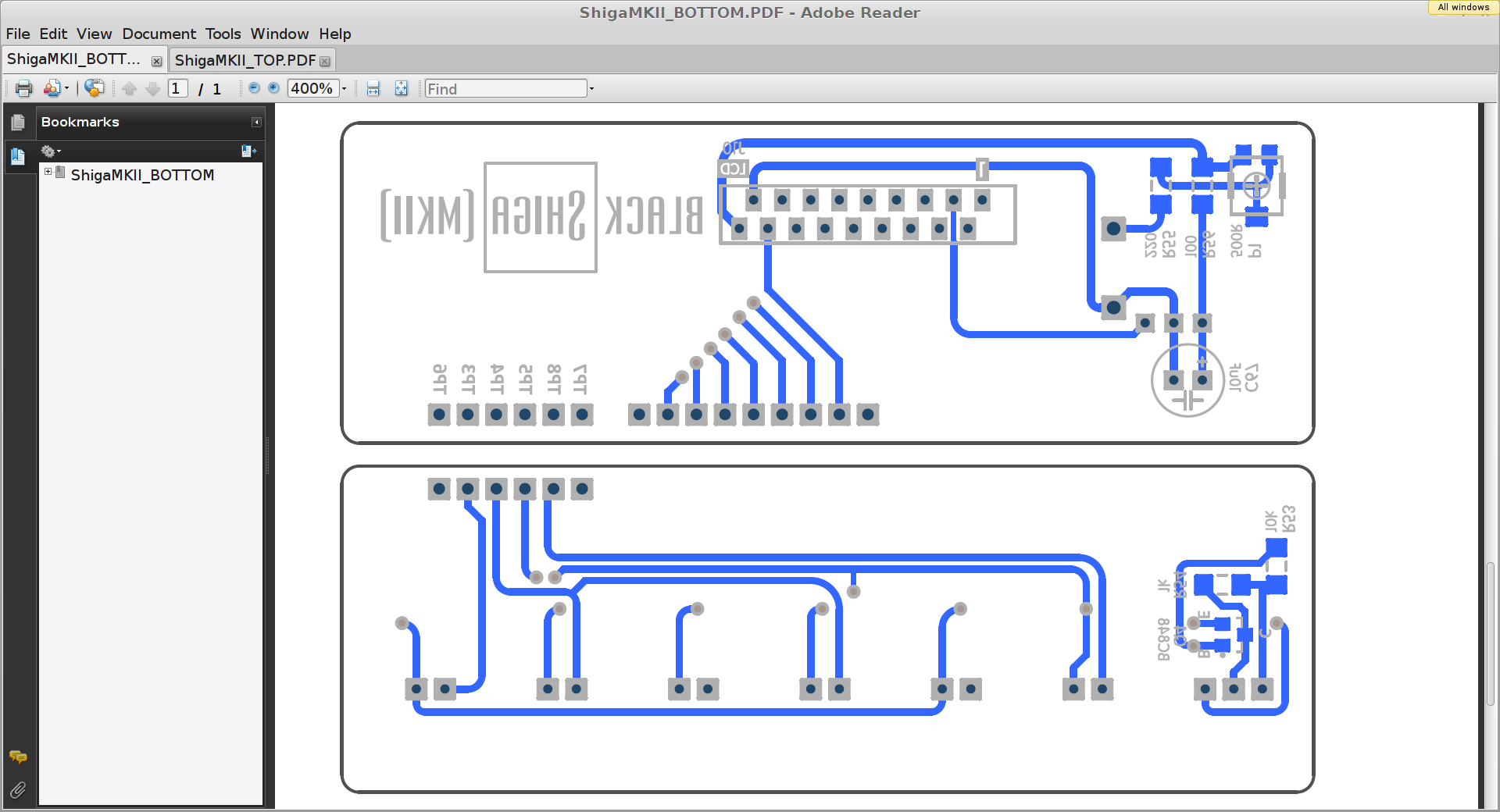

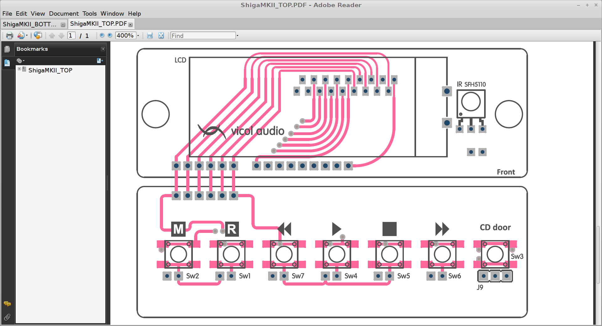

2.)The connectors I soldered to the boards and the wires connected to them give a signal when I measure them with a multimeter. If I'am correct the switches on the board are triggerd by current. So shouldn't I be able to measure the current to these switches?

Hi Robert,
1. Backlight have no pins. It is just a small piece of PCB with two leds stuck to a plexiglas. The "pins" are made of PCB as well. If is loose, than the plexiglas was forced and need to be glued again.
2. Switches are connected on a matrix. I have attached PCB top and bottom traces. Follow traces and see which solder point does not make contact.

HI Tibi,
Replaced IC's still no go. Was doing LA6541 and I realized I had a LA6541NH which looks the same except 4 NC pins next to smaller Gnd tab. They align over gnd pad so can be lifted out of way. I attached specsheets I think for both. I also can wait for regular LA6541. Also do switches have an orientation on CD door pcb to work right? Thanks!

Hi Steve,
You may use LA6541NH, pins 7,8,21,22 are NC-not internally connected and you can solder them to gnd tab. Switches must be horizontally mounted - pins left-right - to work.

Thanks Tibi on IC info! So according to button spec sheet schematic I have top pads as one leg and bottom pads as one leg and they connect with button switching. Also I attached V1-4 info from instructions to double check I have done correctly. Thanks!
