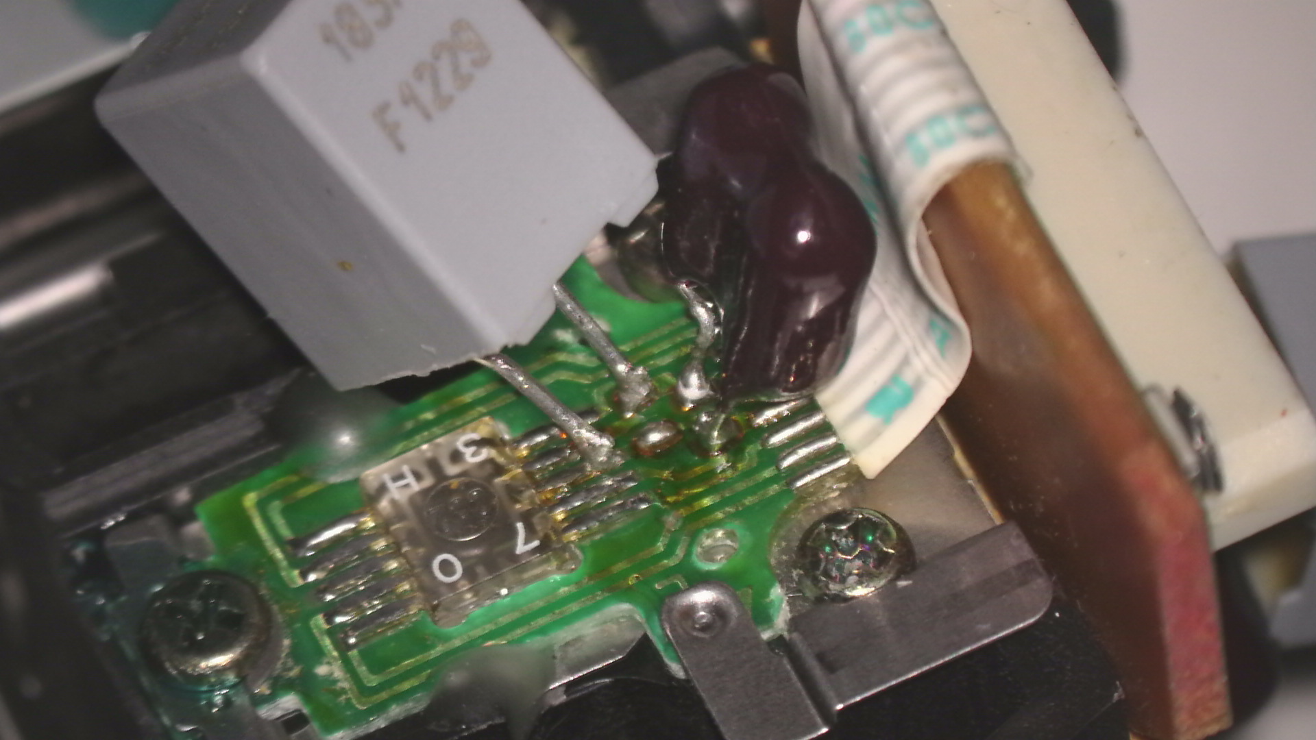

I managed to break the ero1837 loose during handling. Gave me a few days setback, waiting for a new laser unit.
I have never soldered such small parts before, vacuum tubes preferred for many reasons...
Could not managed without serious magnification and light ( old eyes...)

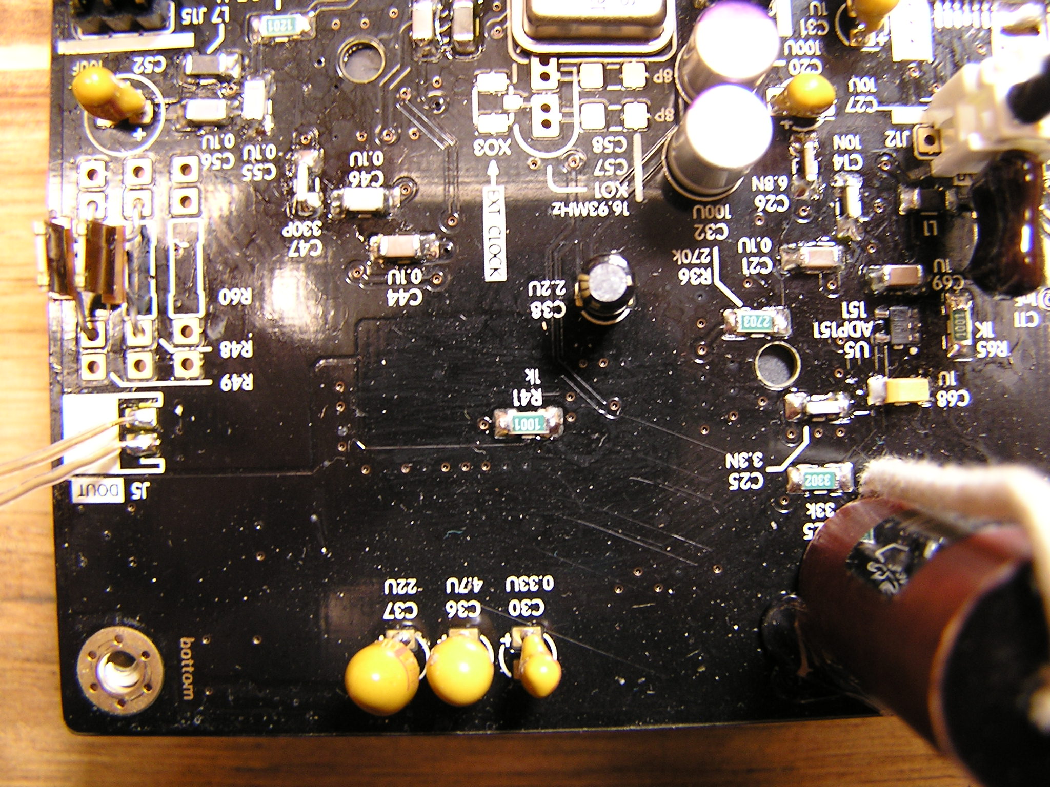

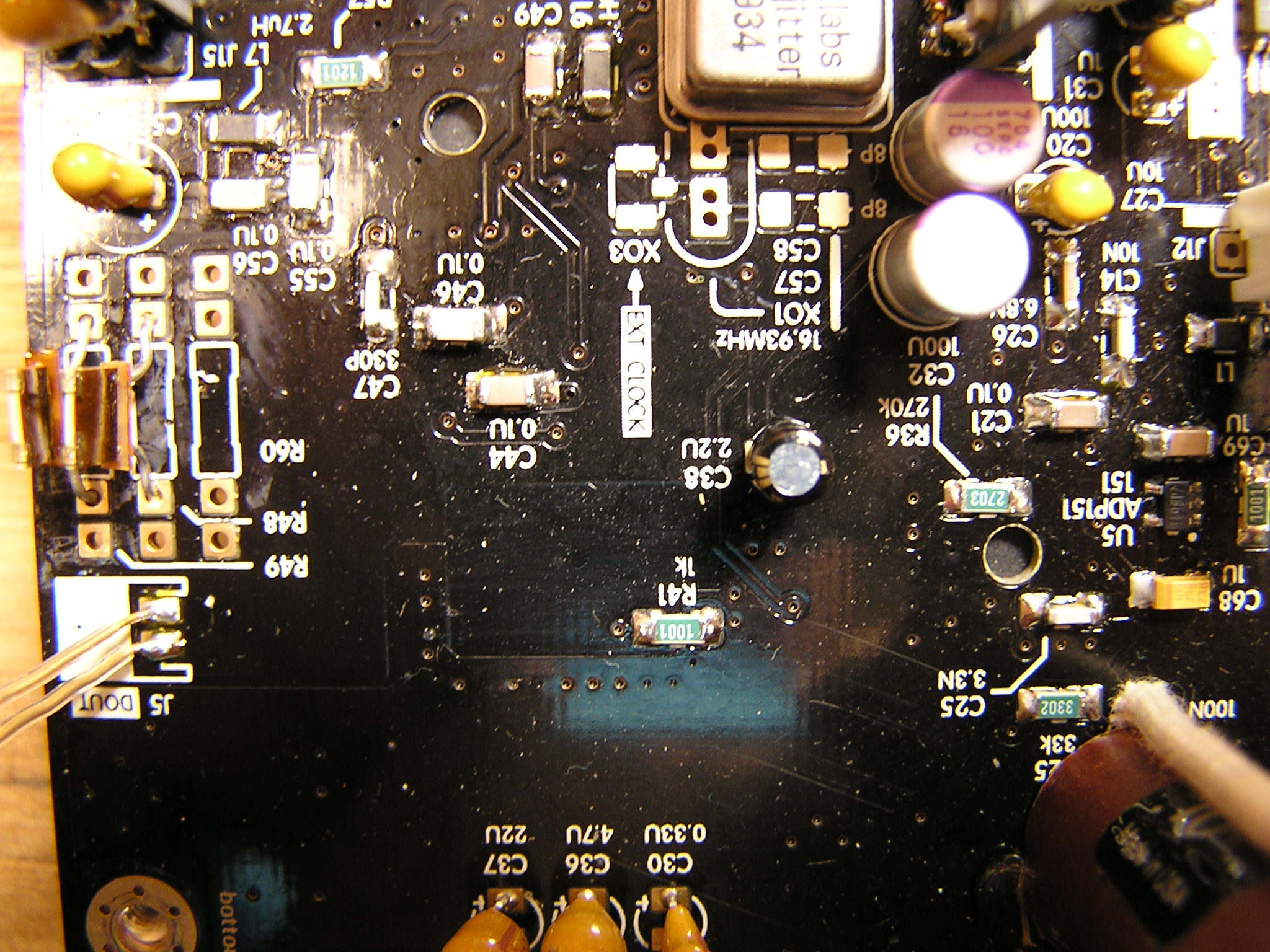

The board on pic is not to be moved before securing parts with glue.

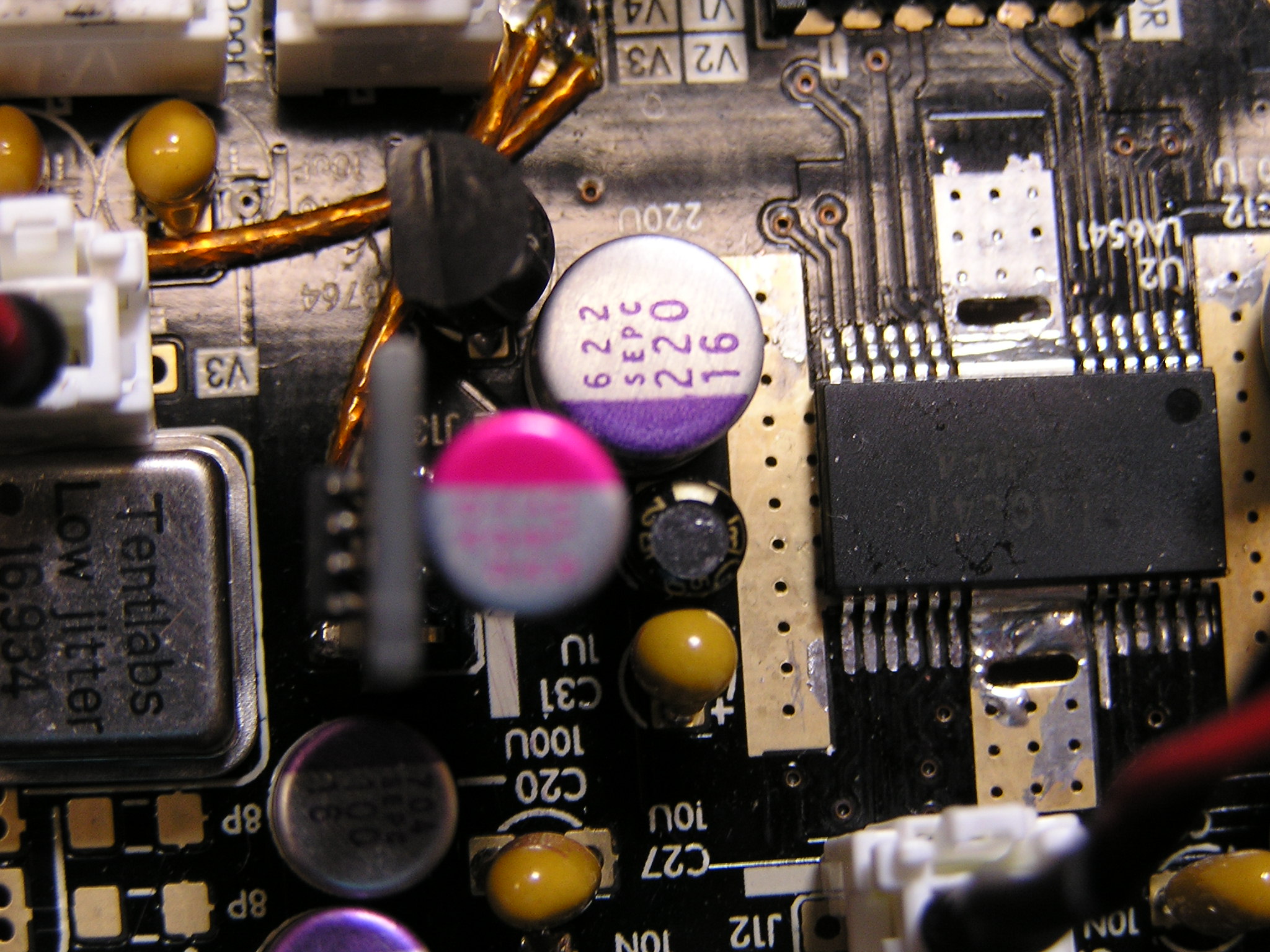

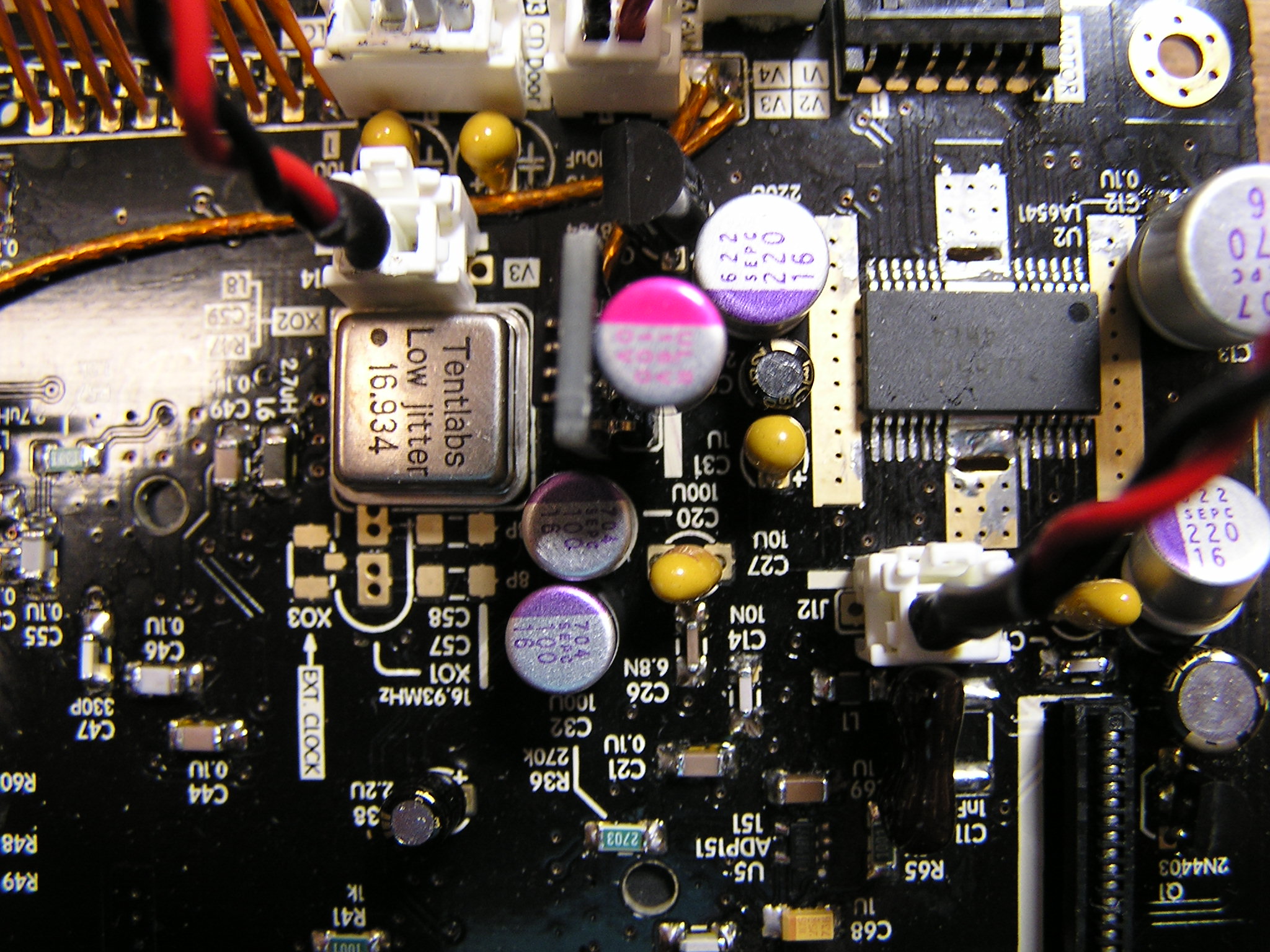

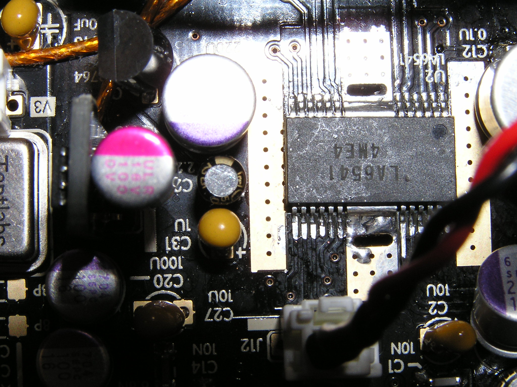

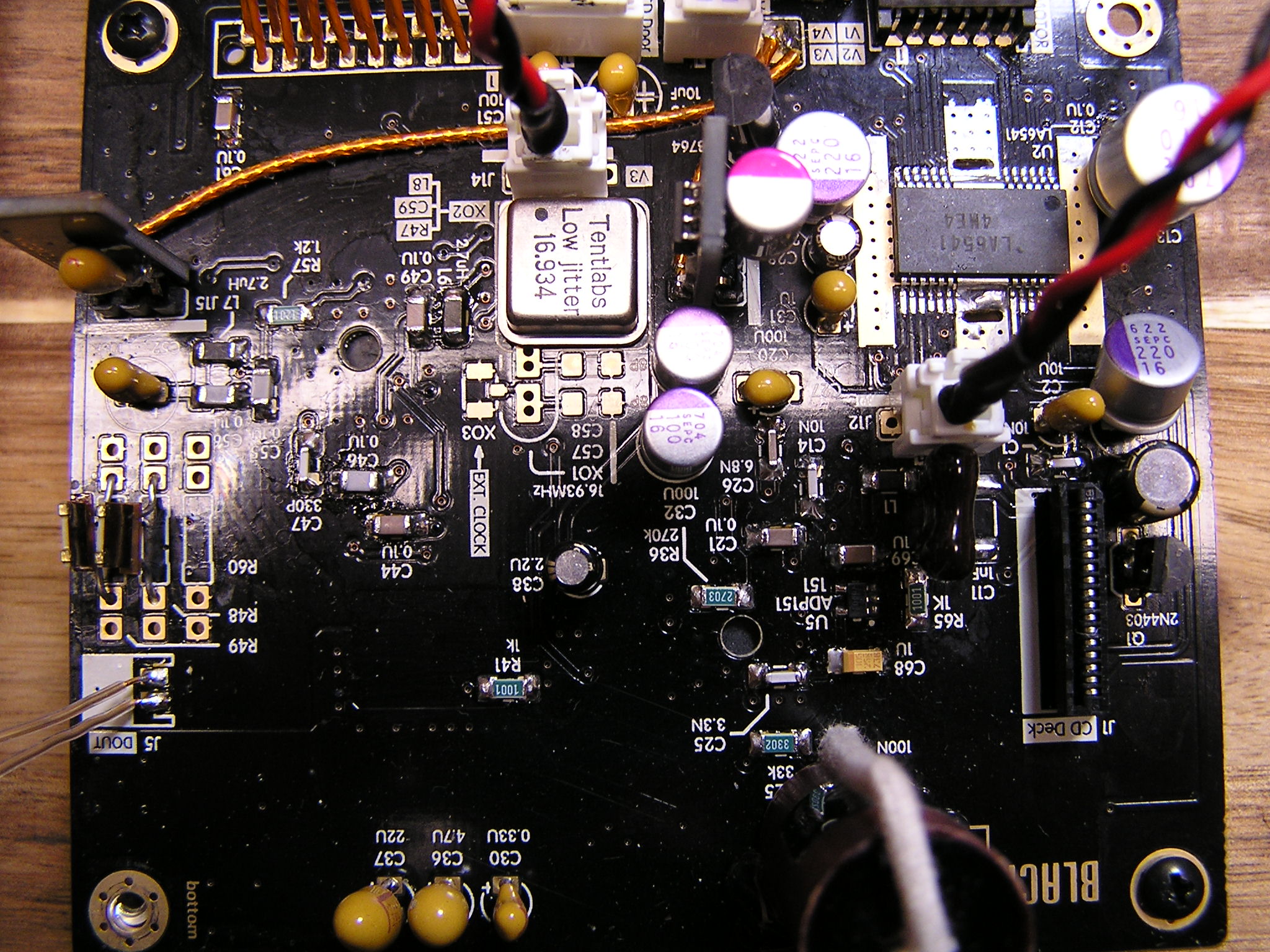

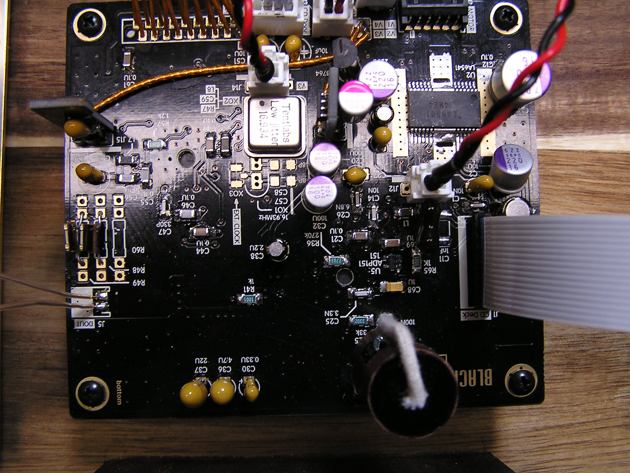

Hi Tibi and all builders,
I am having trouble with CD mech; when powered on motor drives sled in but will not stop [unmodded stock unit too], also I don't see laser light but have good voltage swing at base of Q1. I have redone cables connections. LCD display seems OK but switches do not do anything as motor just drives continuously in one direction. I need some input as to what to check next please. Appreciate any input, thank you all.

Some more info from Steve: CD mech drive
Motor: 1=Gnd
2=5.08V
3=5.07V
4=2.48V
5=3.77V
6=3.76V pin 1 pcb to pin1 CD mech
J1 ribbon pairs left to right fron J1 side of pcb
1-9 = 3.78Vea
2-10=3.78Vea
3-11= 1.1V- Gnd
4-12= 5.1V- Gnd
5-13= 2.56Vea
6-14= 2.56Vea
7-15= 2.56Vea
8-16= 5.1-2.58V
Are these right? Thanks

Sorry to be so disjointed but the final bit of info is that the spindle does not spin either also pin one of CD door is going pin1 as shown earlier in this thread. thanks again

Steve,
I suggest you to check again cable from motor to main board.
There are several problems that may generate same behavior.
Except power supply and miniregs V1 to V4, there is not so much you can not test on Shiga MKII with a voltmeter. Entire Shiga MKII is a feedback loop. If something is wrong along this loop entire circuit will fail and may fail same way with with various causes.
First you need to check what you have done before this to happen. Any modification you done prior this must be removed. Check any shortcut you may be done while soldering.
If CD do not spin at all, than check 3 wire cable for CD toc reset.

Hi Tibi,
Just spent a bunch of time checking solder continuity on IC's, all check good. Can't tell you how much time I put into initial solder but was "extremely" meticulous. Here is what I see now. Q1 base 4.89V but no change when CD door switch pushed, no voltage drop. Used 2N4403 PNP. I followed thread that showed position of pin1 on control board to pin 1 on pcb. What does Q4 do for switch function? I am using an unmodified CD mech for testing to take mods out of equation. I am using Salas Reflecktor D for V1 with highest mA 1.0R current setting [650mA I believe] this should be enough as I have seen it in other builds. Have cleaned all contacts. Cleaned rosin after every part during assembly, and used ESD mat at all times, solder blob off. I've gone to the pinout schematic 20 times today just to be "sure". Time to take a break and come back with fresh eyes later.

Tibi thanks for getting back so quickly. I will recheck the toc cable. The wire connection is 123 to 321 not 123 to 123?
IS this right for TOC connection??

Steve,
Can you please post several high resolution pictures with your shiga ?
I need to see everything. 😀

Hi Tibi,
Yes I'll get some pic's sent as soon as work and home let me have sometime in the next few days. I feel like it is the command board as I am getting good voltage to it but the switches don't seem to be doing anything. Can you say what I should observe on the transistor Q4 also. Thanks for you time!

Steve,
Command board will not work until toc is read.
I need macro detailed pictures and eventually a short movie with the behaviur mentioned by you.
Tibi

Will do with pics, if my power supplies difference is too much can this cause startup issues. Reflektor D's @ 5.13V and miniregs 5.02V. After warming RD's settle @ 5.08V this can take sometime to reach though.

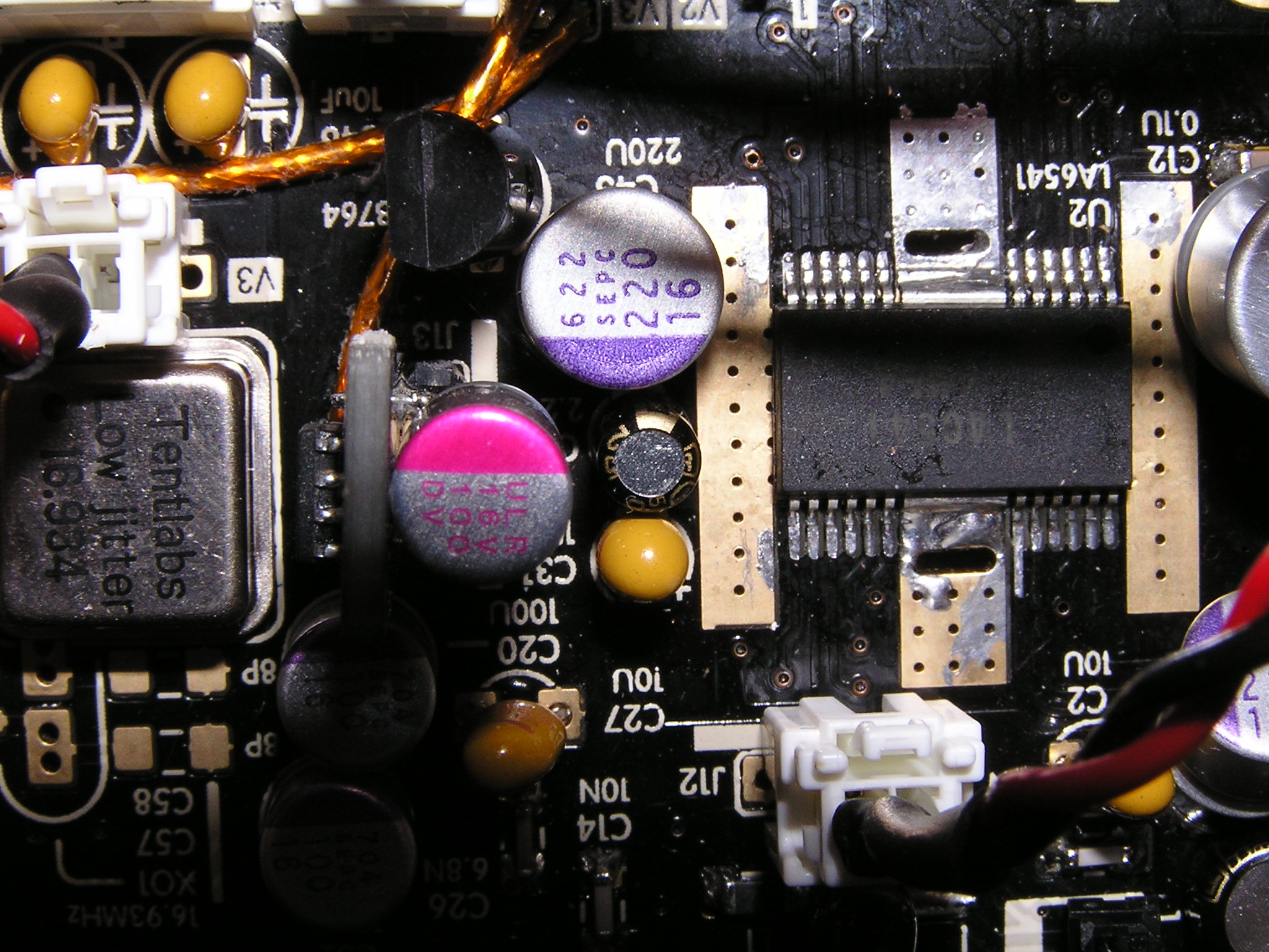

Hello Tibi,
You suggest 1nF 500V Silver Mica across Tentlabs power pins. Can you please indicate those pins or better show a picture of the underside of the board with the cap.

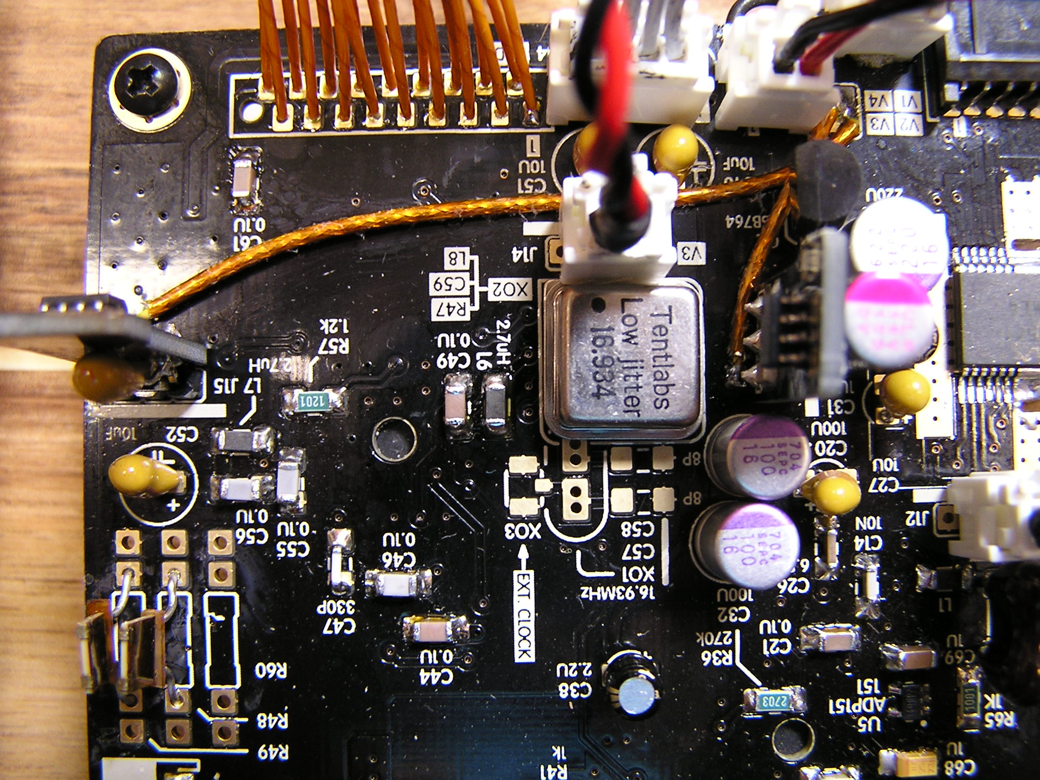

Hi Tibi.
Here is the first 10 photos
