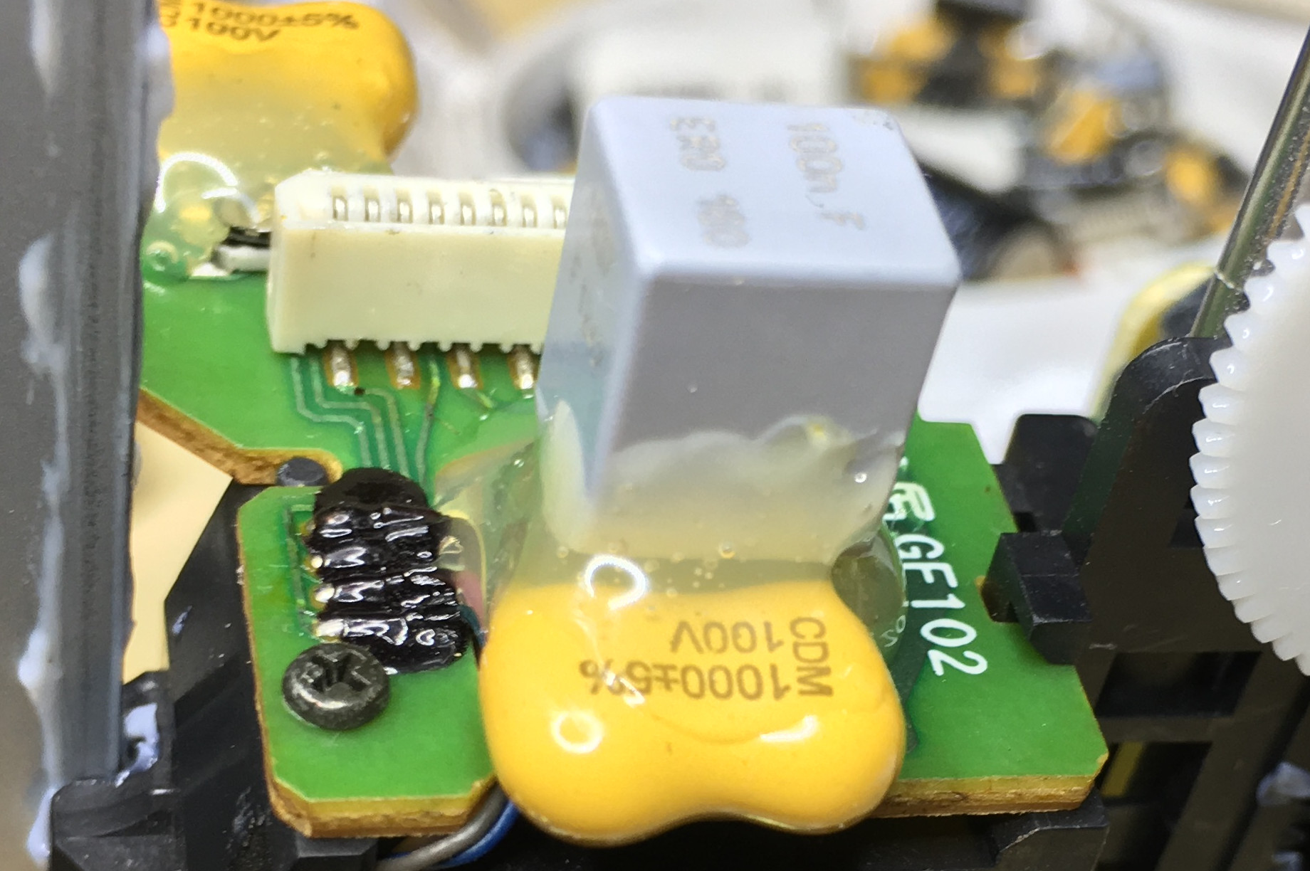

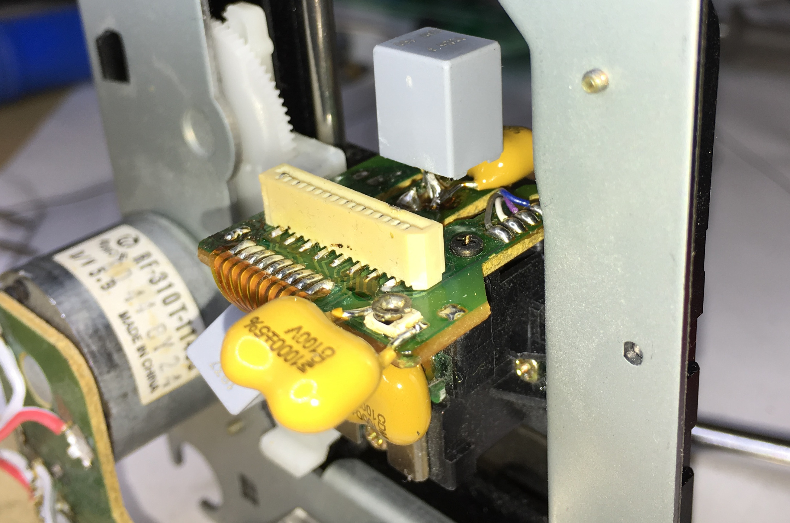

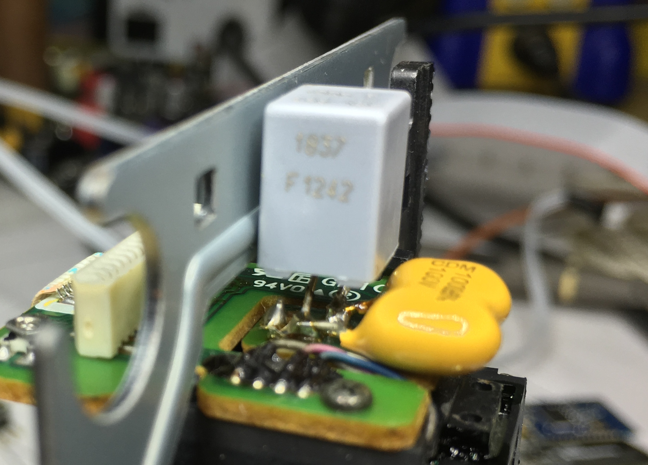

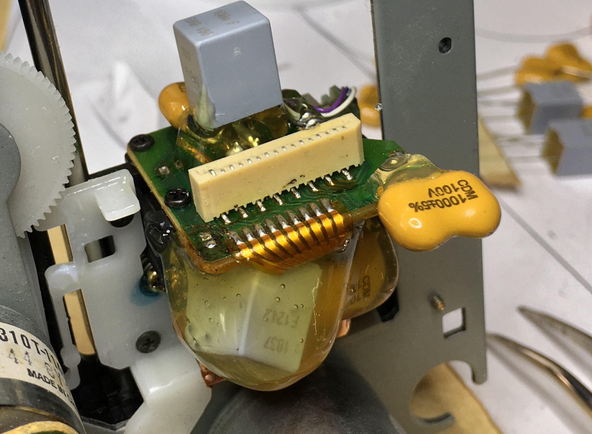

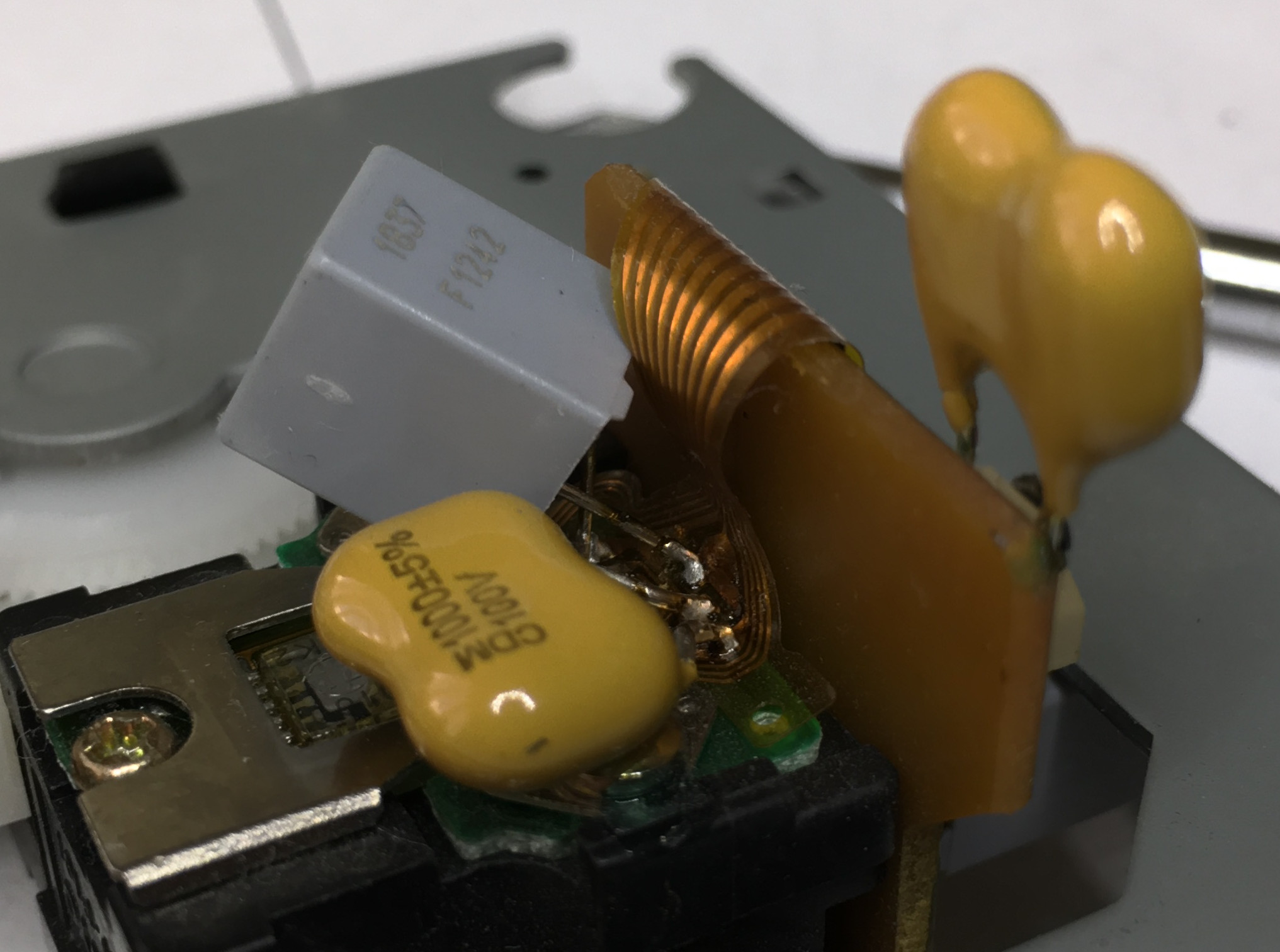

I'll add some.

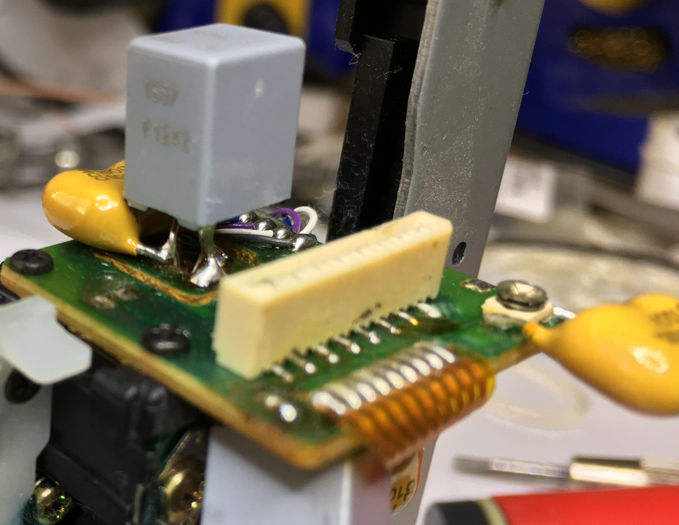

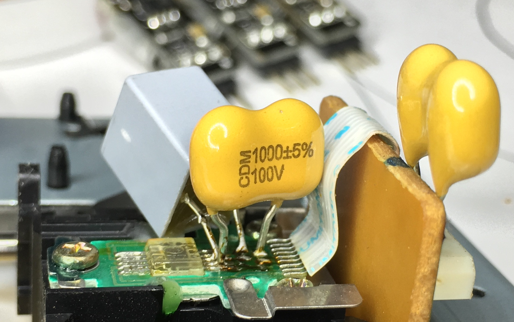

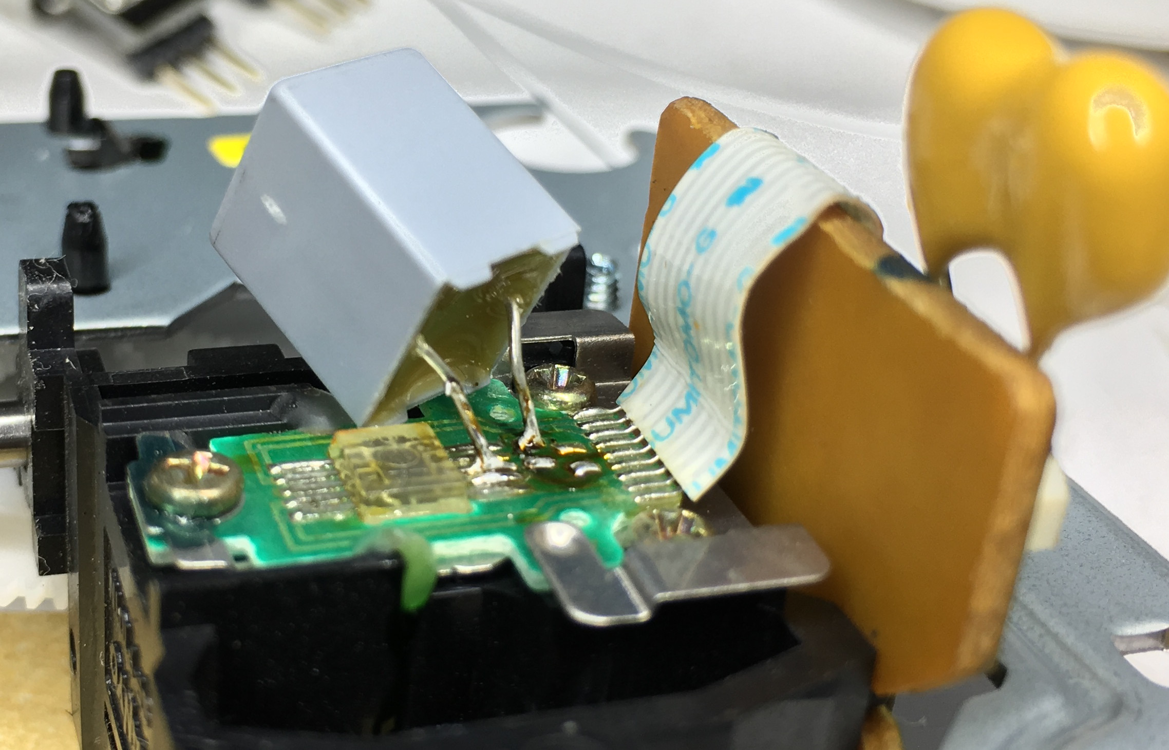

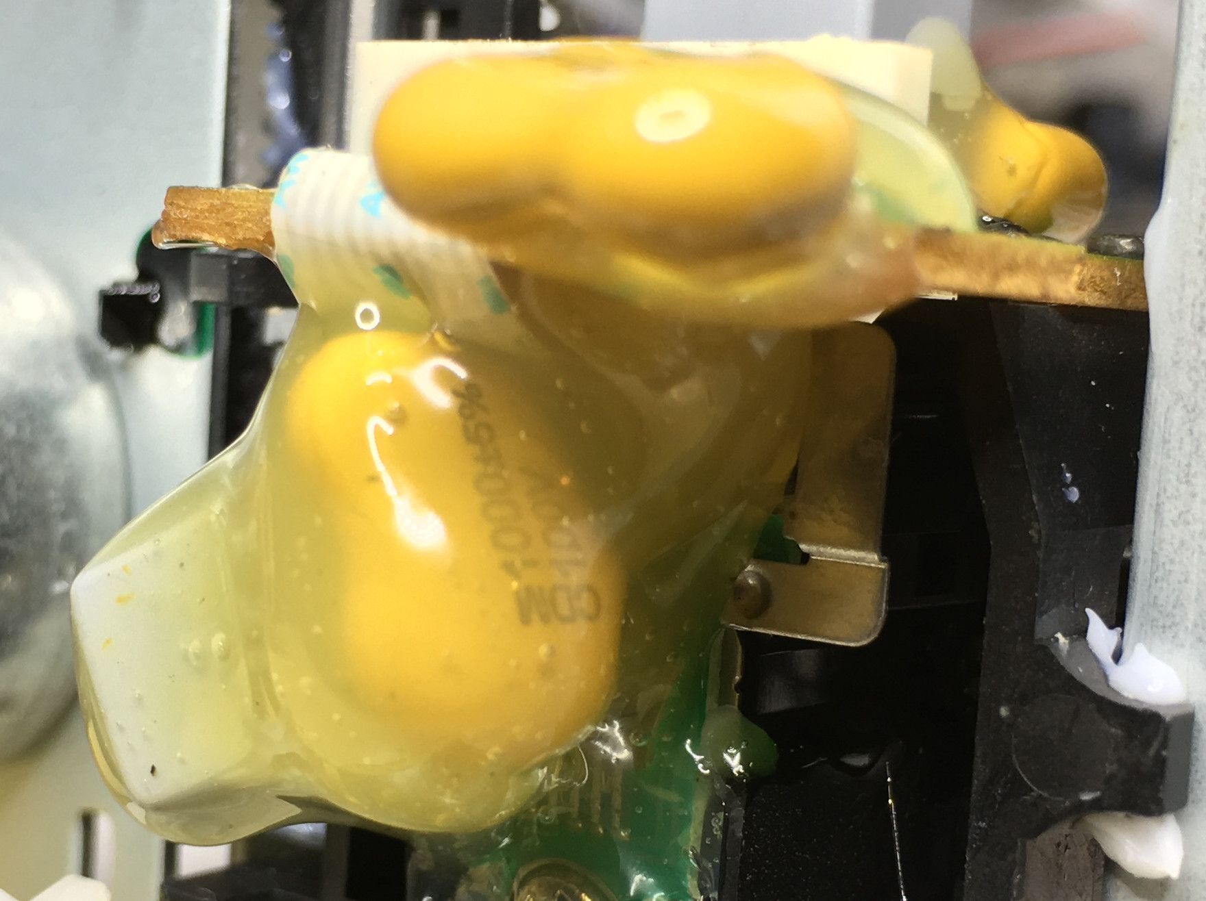

In the meantime, here are mods on CD mechanic.
Tibi

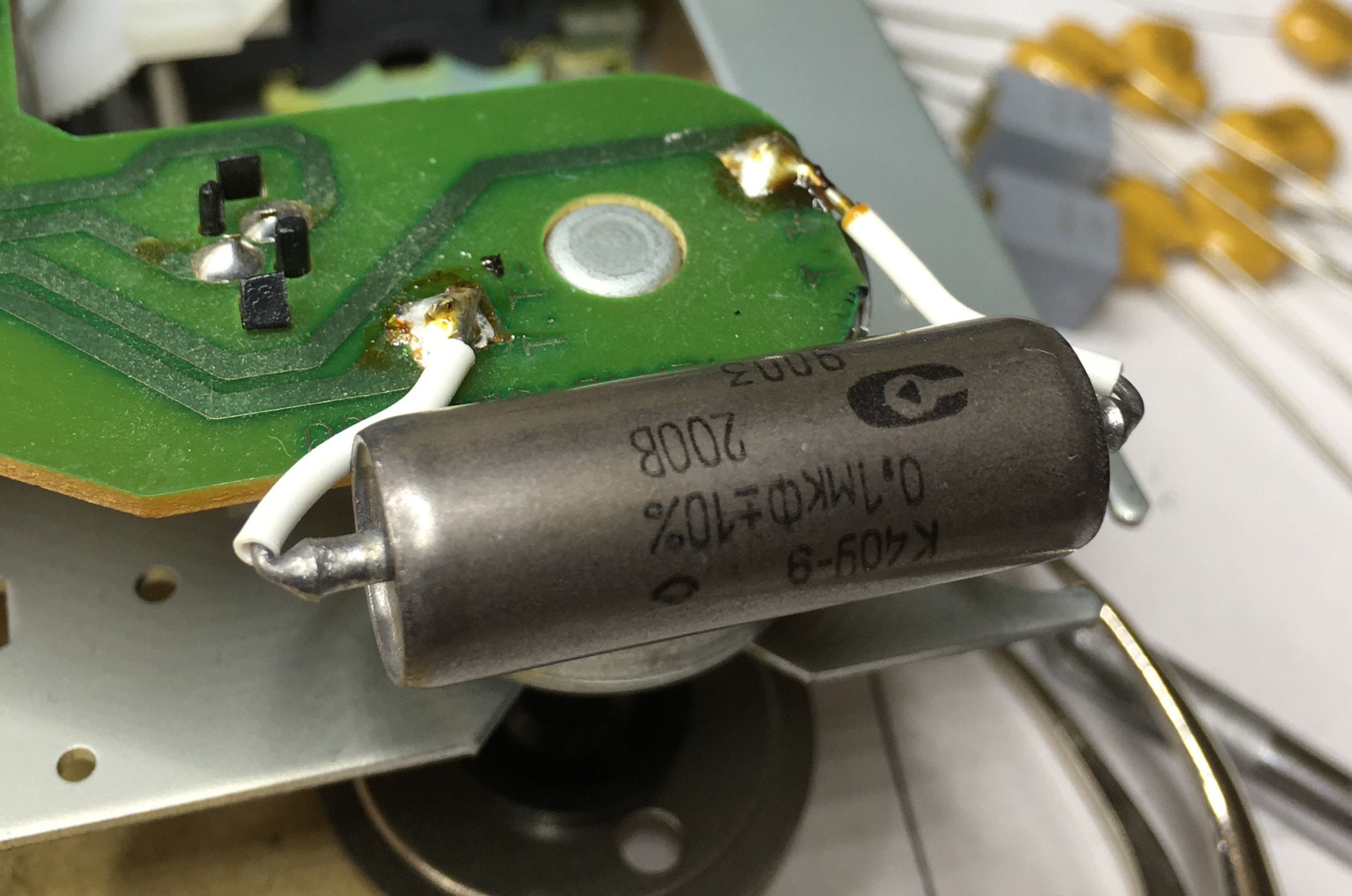

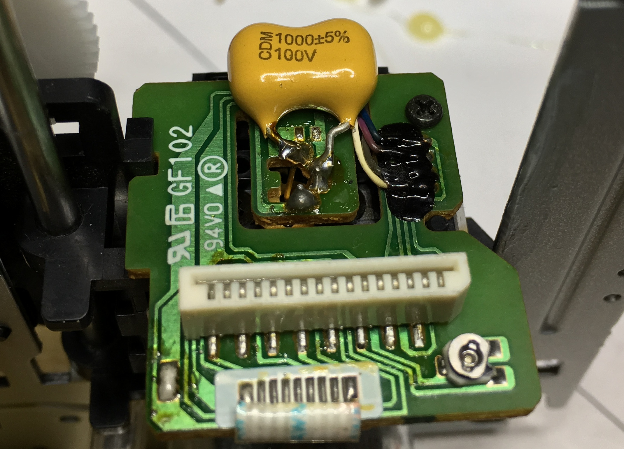

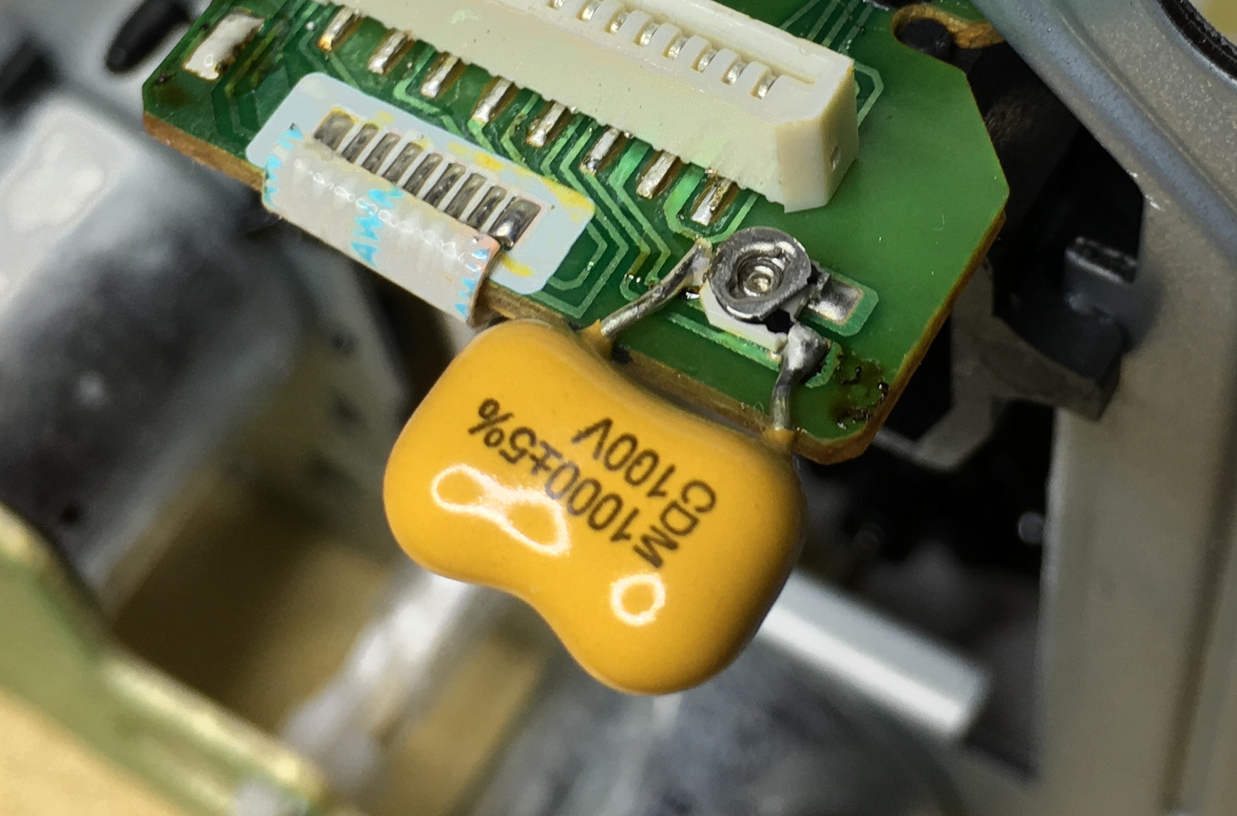

Mods for new CD mechanic.
There is same 100nF PIO across turntable motor.
Tibi
Tibi
