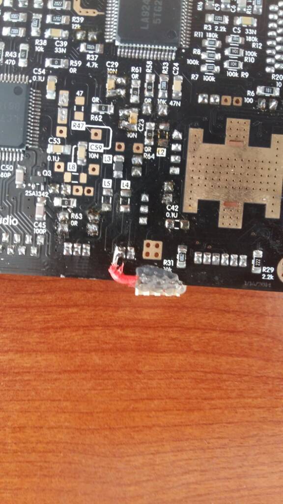

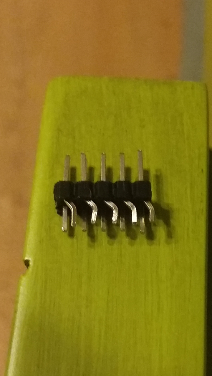

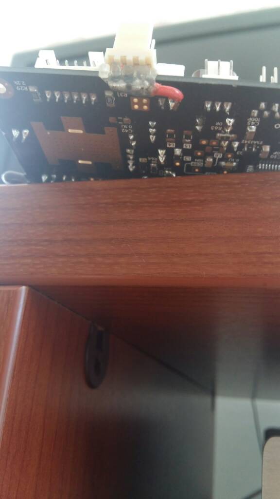

I am having trouble with the header for 18P ribbon cable for LCD. Pin alignment is only correct on bottom of main board and display side of LCD board. Main board I can work with but it seems on LCD display direct solder is only option. I guess I could do 2 single rows of pin and socket? Has anyone else seen this or am I totally missing something??? Using TE/Conn female header with male wire IDC housing. Unable to find part number in original BOM from US suppliers. [Molex picoflex the same deal] Thanks for any help!!

Here is my approach, you just have to bent one row of pinsDear friends,

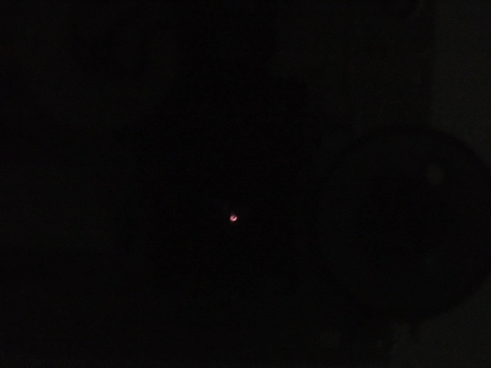

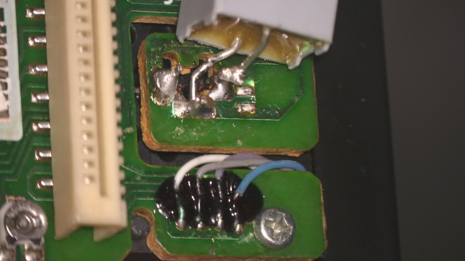

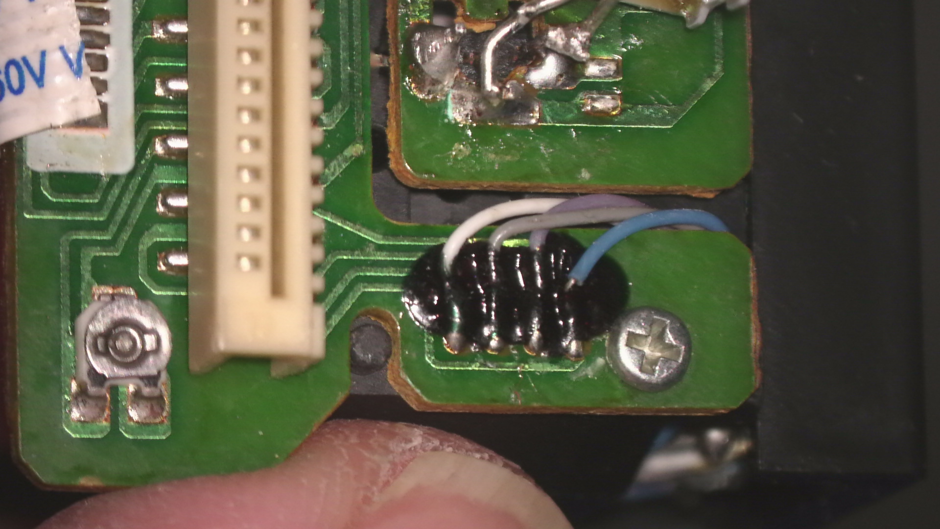

Received my kit from Vicol some days ago. Made a test mounting on a board.
It was running well. Started on the recommended mods. Attached Pics of the
laser pin area, after soldering. (taken through a Zeiss dental microscope)
I have replaced the smd cap with ero 1837 100nF.
Transport starts running but does not read toc.
Attached a pic of laser at startup, to verify it is not fried.
May I ask for help to sort out what went wrong ?
