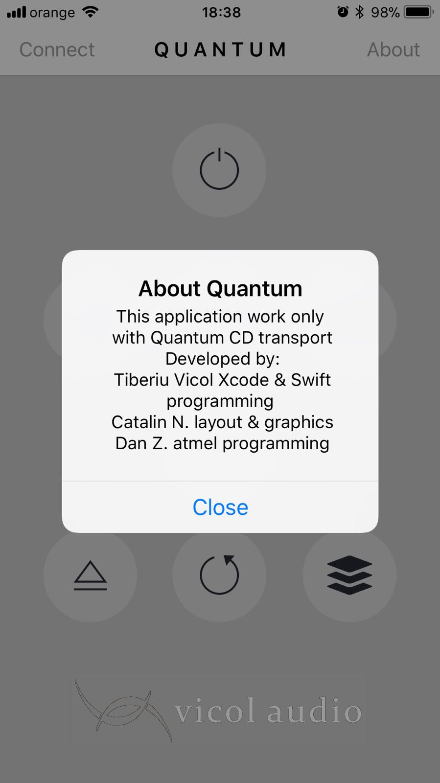

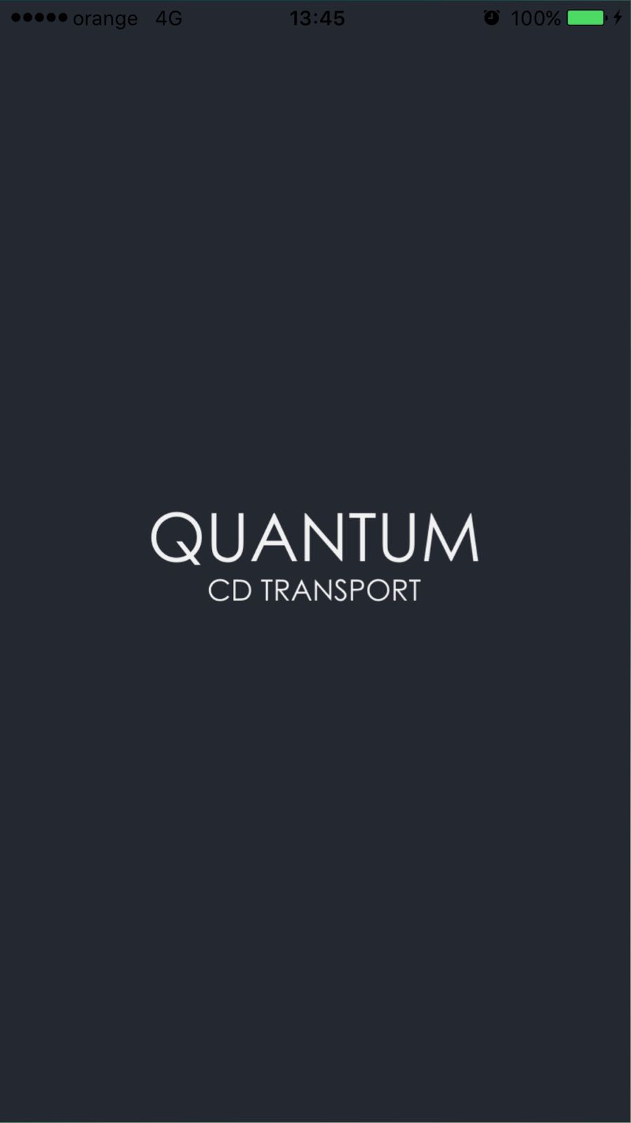

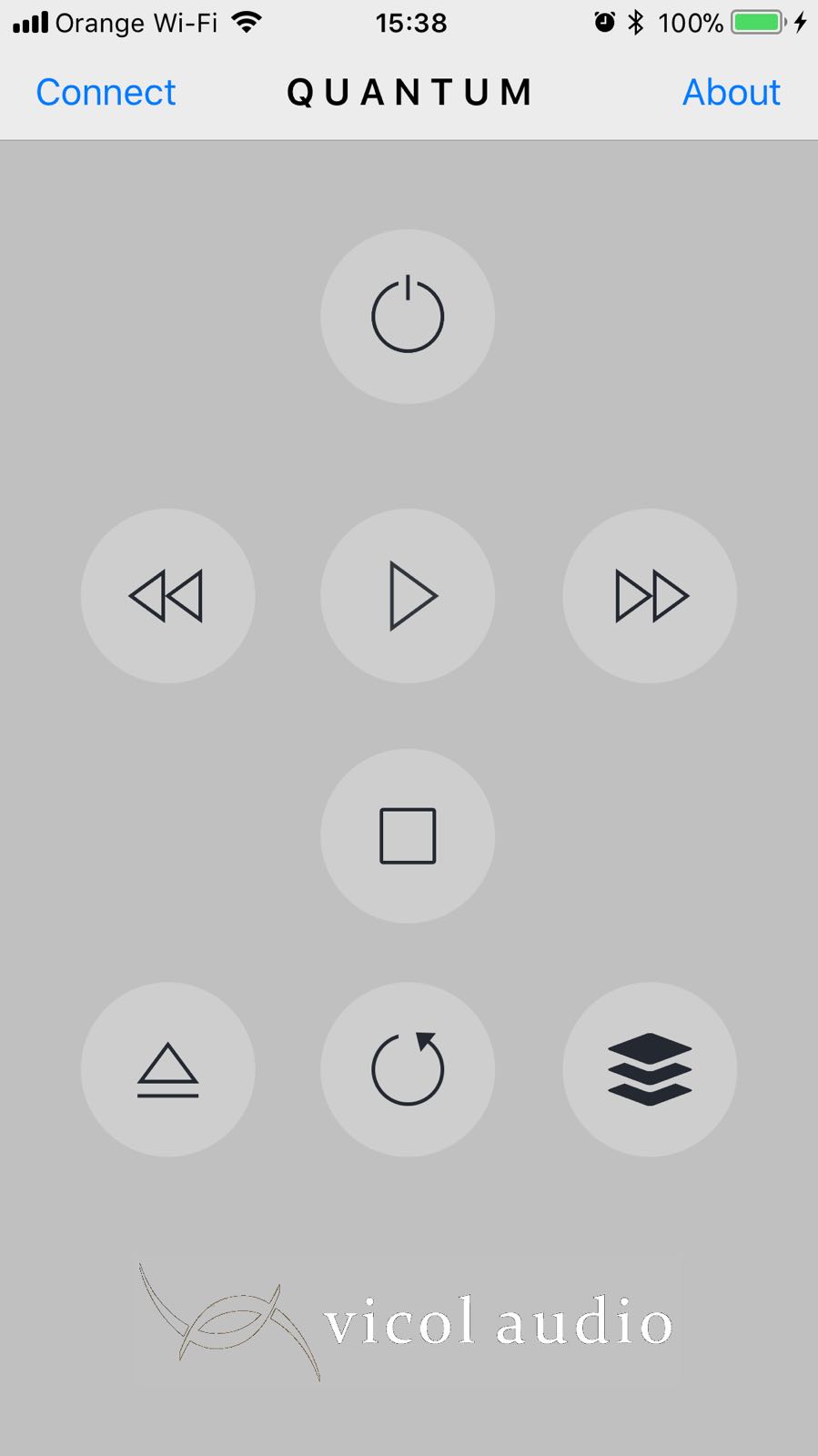

IOS is coming to Shiga and Quantum
A quite long journey, but finally IOS is coming to Shiga and Quantum. Iphone support only BLE (bluetooth low energy) and implementation of this was quite a challenge for us.
Tibi

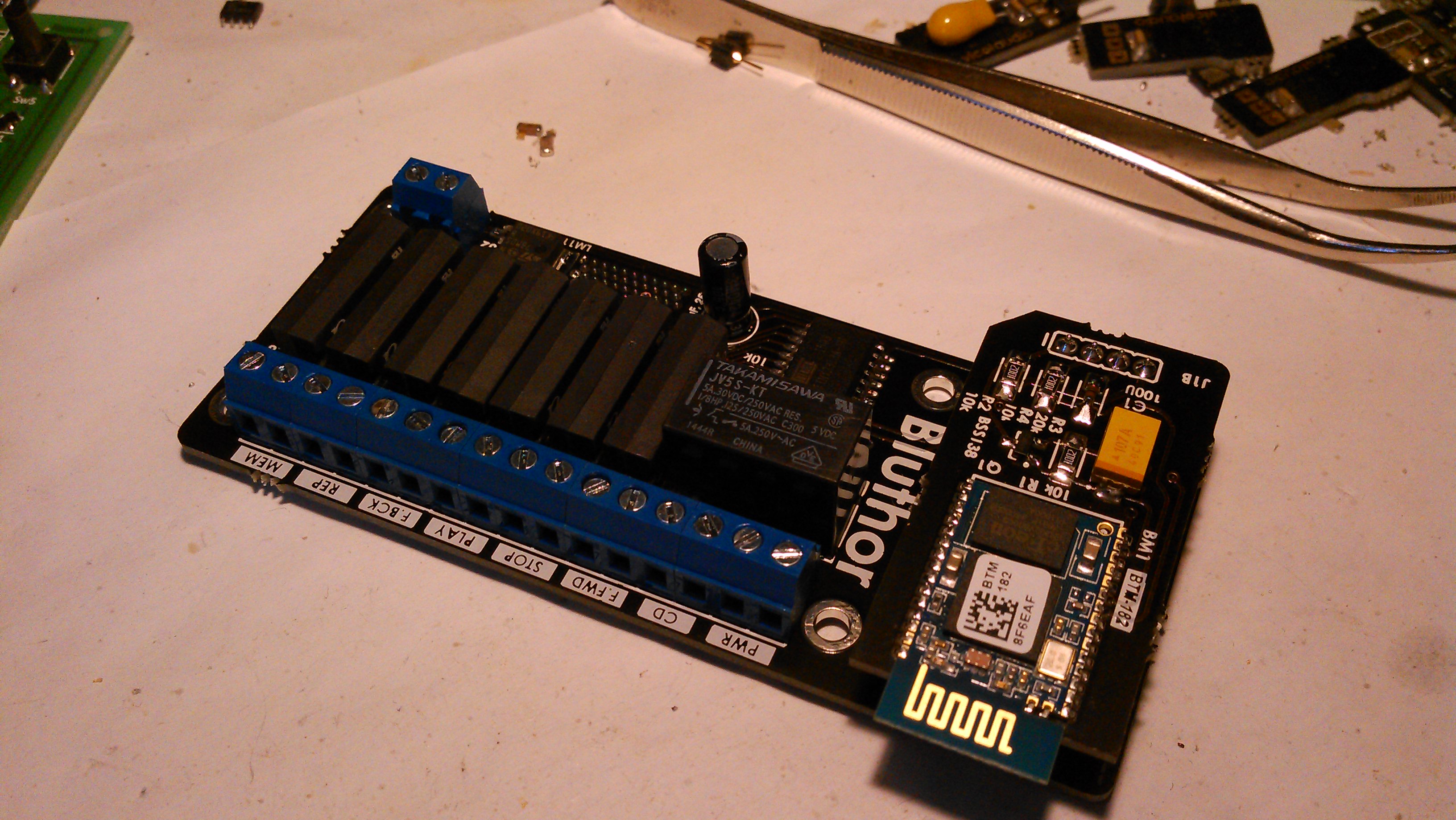

Hi Tibi,
can you tell us more about the remote control? Price, installation, etc.
Bluetooth remote control (called Bluthor) is based on a module that was developed by us several years ago.
The module can be used with any CD player that have or not have remote control, adding bluetooth remote control feature.
The main idea behind Bluthor is that he make use of REED relays across any existing push-button to simulate button press.
There will be two modules. One for Android and one for IOS.
Applications are available for download from Quantum web-page.
Apple make use of smart BLE technology, therefore we had to use different bluetooth modules.
Installation on Shiga MKII is straight forward, as we have already designed Shiga MKII for Bluthor. If you look on main display board you'll see that under each push-button are two small holes. These are designed for Bluthor connection via wiring.
You may power Bluthor from same power supply as Shiga MKII. Bluthor have his own regulator and accept unregulated power in range of 8Vdc to 15Vdc.
On 1st December Bluthor price will be 59 euro. Afther that 79 euro.
Bluthor is already integrated in Quantum CDT and people love it.
Brgds,
Tibi

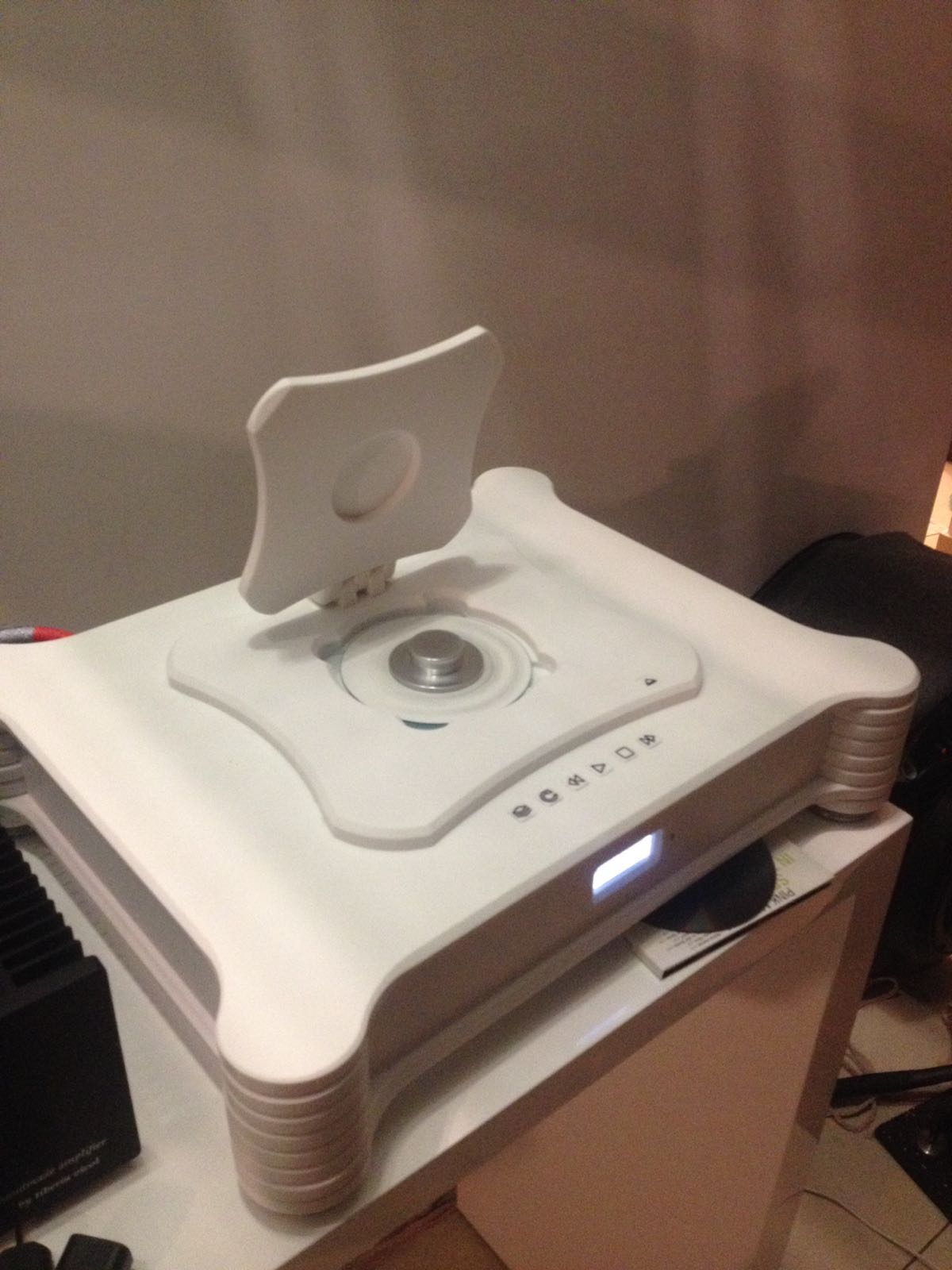

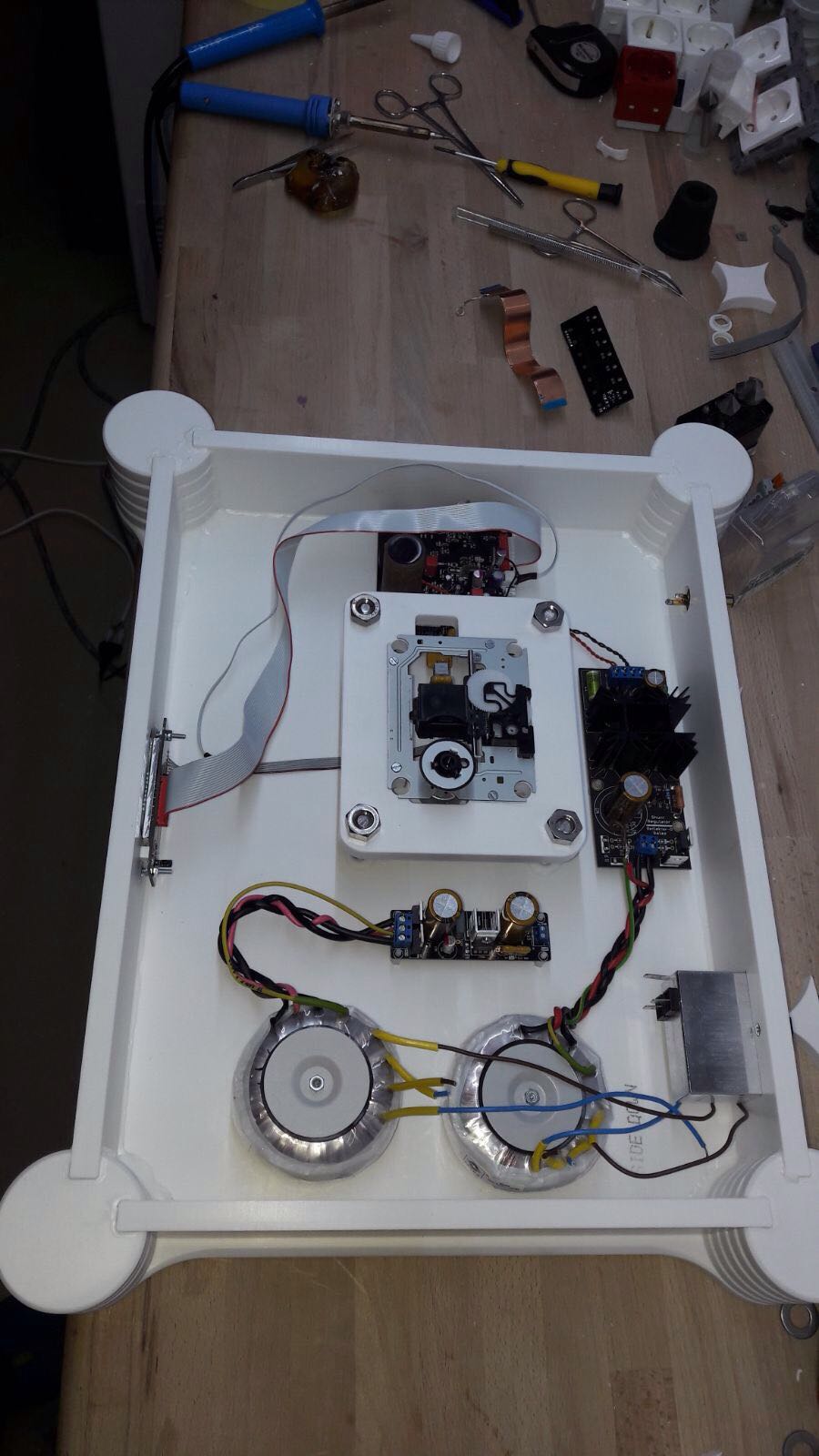

Gorgeous Shiga MKII high-grade implementation by an audiophile fellow.
Tibi

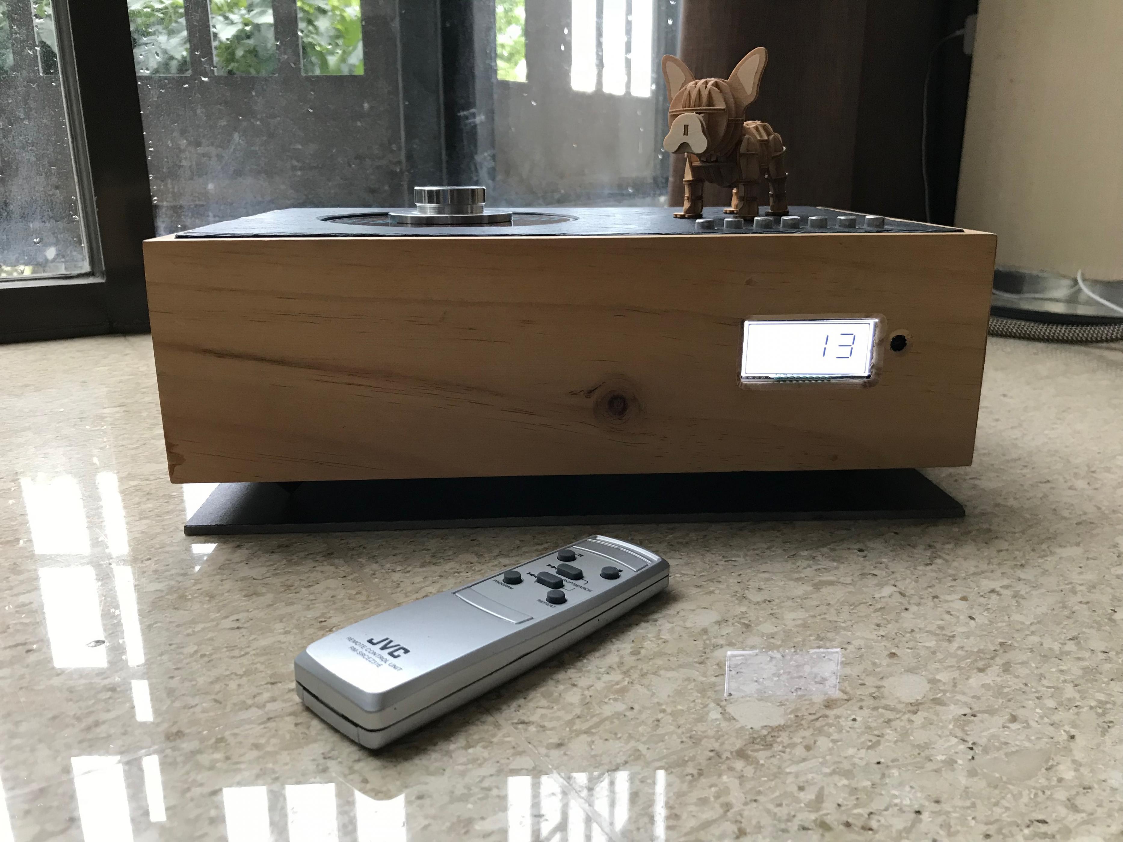

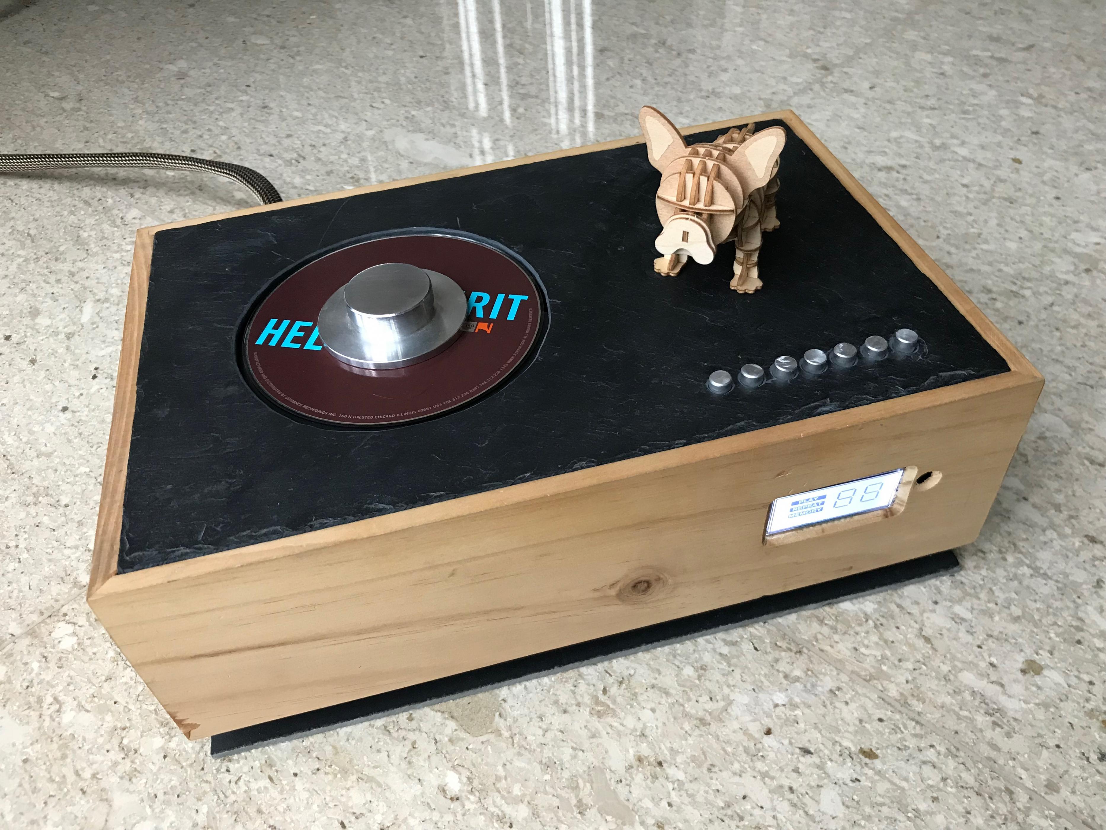

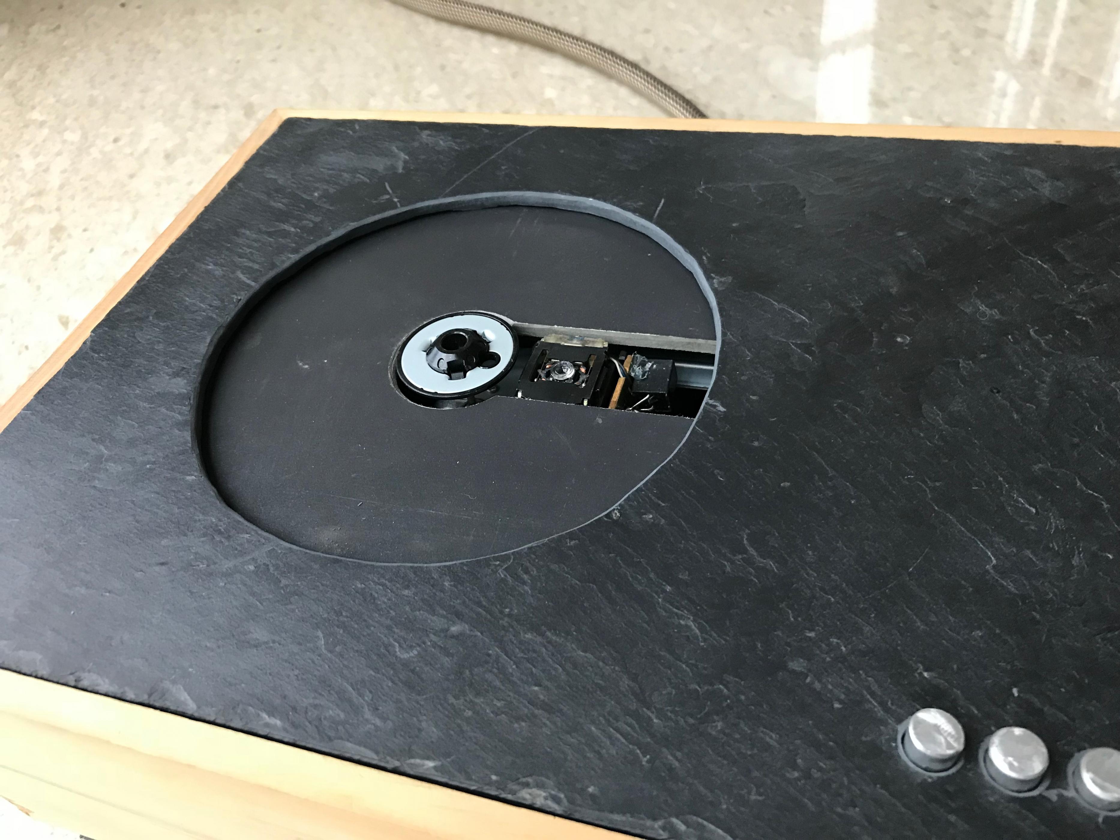

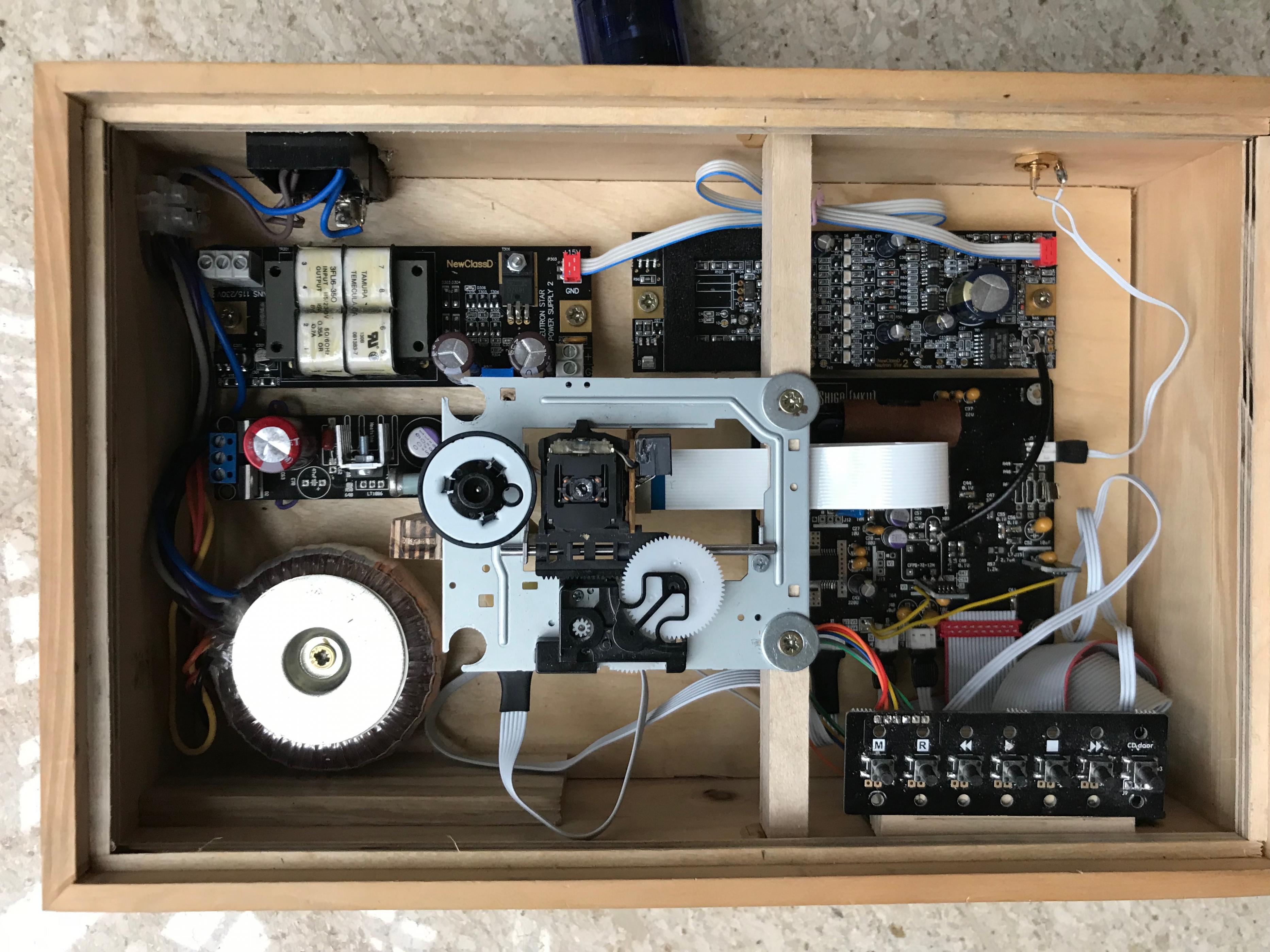

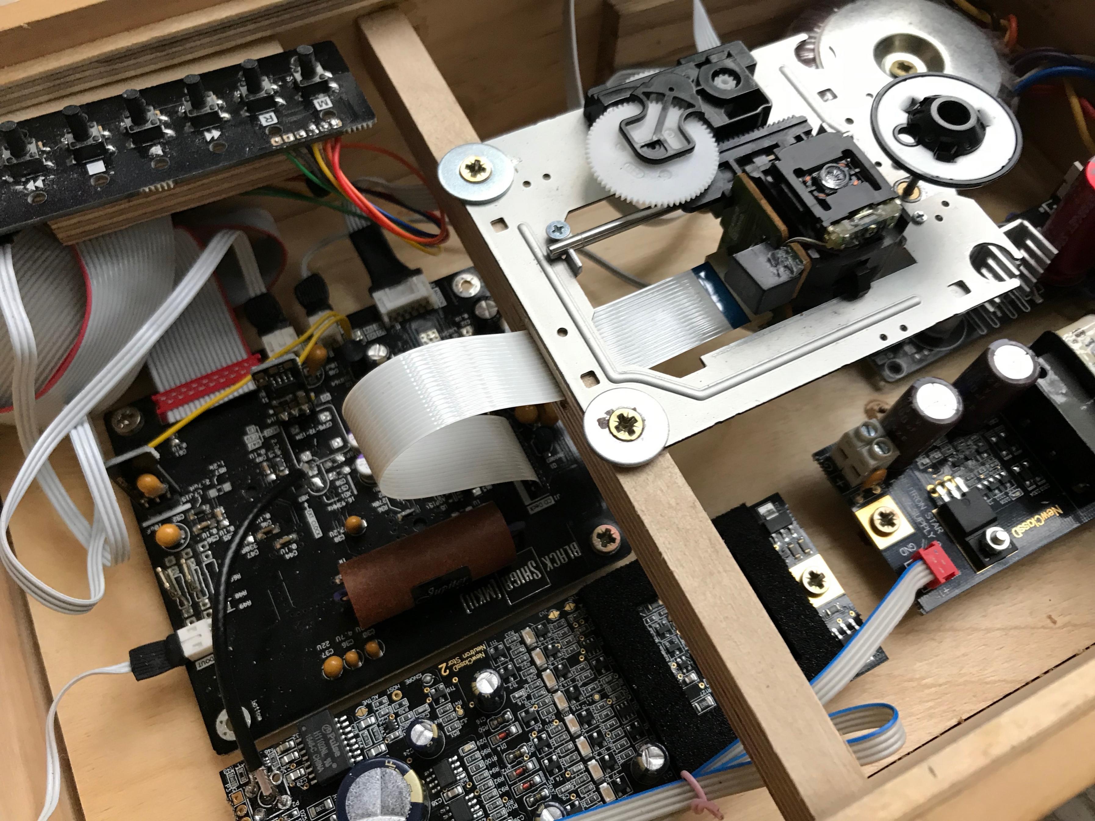

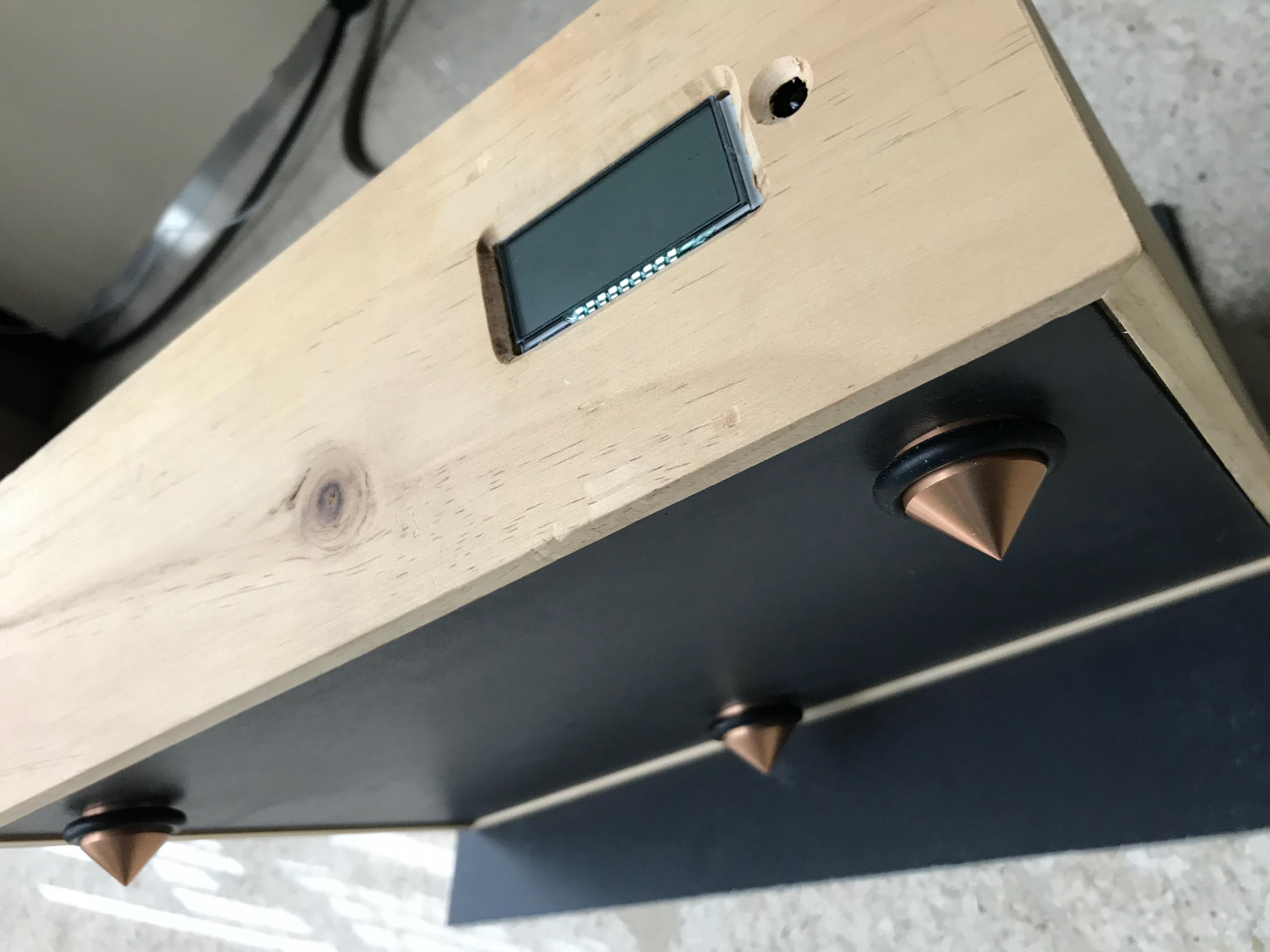

Shiga Black "Temporary" Home

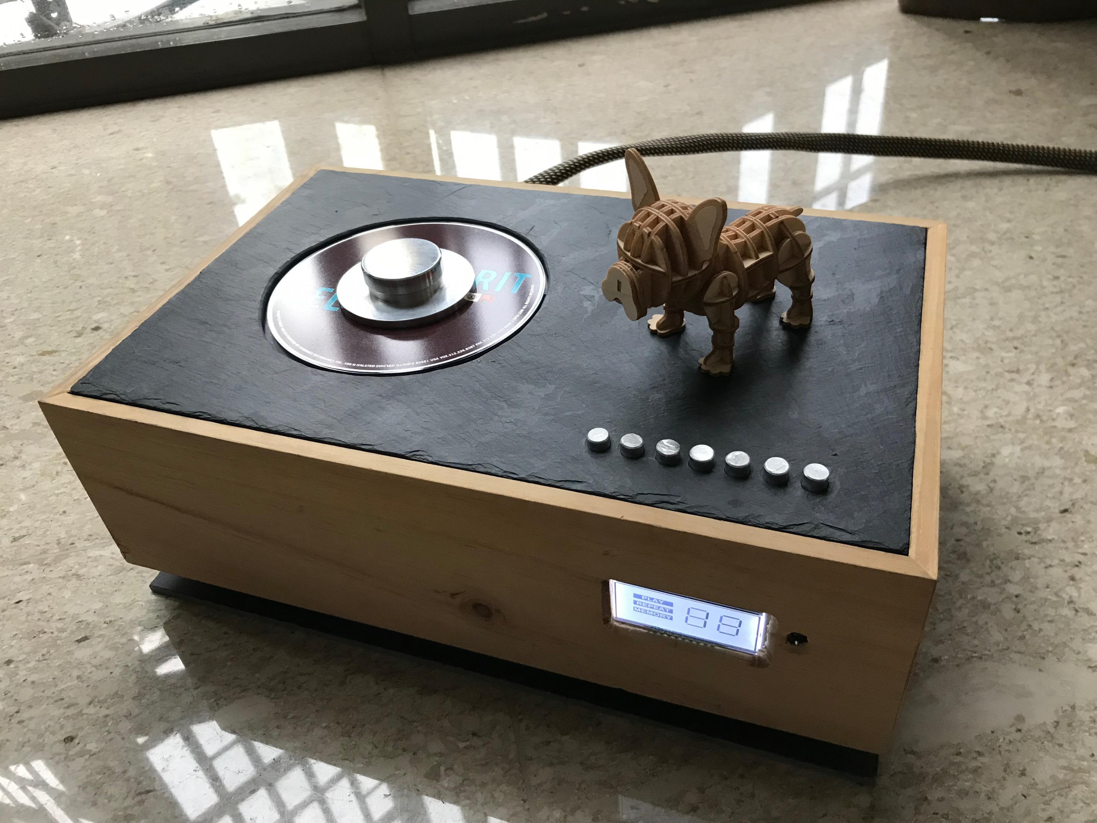

Hello all
Sharing some pics of my Shiga Black "Temporary" enclosure. Inverted commas temporary because I know that temporary is likely to be a long-time ;) Its not perfect but then that gives me greater incentive to make the "permanent" enclosure. It could do with some sanding and a spot of varnish and a bit more tidying up but for now I'm going to leave it alone and finish some of my other projects.
The top is a two layer construction using faux slate for the laser cutout and then real slate for the disc cutout. There is more faux slate on the bottom to help with mass loading.
I can't remember where the box came from - possibly charity store find?
Jupiter Copper Foil Paper & Wax Cap in C8
NewClassD Neutron Clock and PSU
Vicol miniregs in V3 and V4
All the recommended mods to the laser
Cryo treated gold plated phono for output
Things left to do
- LT regs in V1 & V2 and add separate PSU
- change toroid to r-core
- LT regs in PSU
Cheers
Clayton
