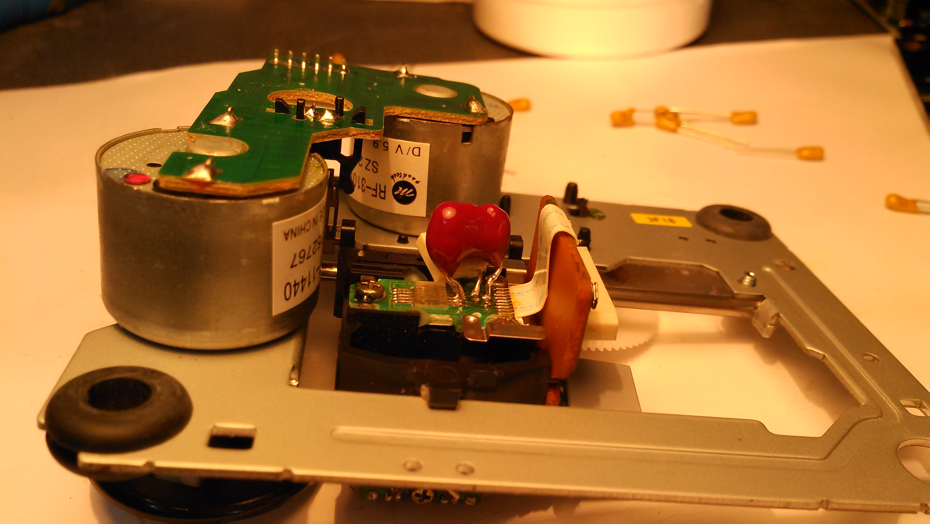

On many of your pictures of the SP-F101N I look at the rubbers you use to mount the mecanism and they fitt perfectly. (see atteachement) I have not been able to find them. Where did you get them? If possible please give me the partsnumber.

I'm having problems with my black shiga. I think the main board is the problem (?). My sanyo cd mechanism will not start up even after changing ribbon FFC cables, using contact cleaner and checking the motor wire harness. I've even substituted 2 different sanyo mechanisms and no response. The display board works, the power supply board measures OK. How can I check if there is power going to the mechanism? Thanks

FIX-GR-30 FIX&FASTEN - Man?on | TME - Componente electronice
tom
If is a new mechanism you need to remove solder protection bulb.
Tibi
Tibi
Tibi, I'm afraid no go even with the removal of the solder protection bulb. I will try another mechanism, failing that I will check the continuity of the ribbon cable and the motor cable.

Some high resolution pictures may help me identify the issue.
How do you inserted ribbon cable ?
After toc reset, does optical unit move and focus ?
Does the disc spin ?
Have you looked with a phone camera to see if laser is operational ?

The optical unit does not move at all on startup and pressing the CD door button to start toc does not do anything. The disc doesn't spin. I'll try to use my mobile phone to see if laser is working. I have a feeling it's the 6 wire motor cable is faulty as changing ribbon cable does not solve the problem. I may make another 6 wire motor cable and try. I have been connecting and disconnecting it many many times. Will report back on the progress. Thanks once again

Some good news. I've managed to get the unit working but using a spare mechanism. I found out that the CD door 3 wire harness to J3 connector is directional. The ribbon cable to mechanism and 6 wire motor cable is not directional. However, my CD door button does not read the toc after inserting a new CD. I need to turn the whole player off and restart. Secondly, the original mechanism (with your laser mods) would just go the start of the sledge and wouldn't stop with the plastic gears just grinding away. Any suggestions?

Hi Tom,
Please remove solder protection bulb on moded CD mechanism. Unit was extensively tested, I do not see any other reason why this should not work.
Please check if toc reset cable is properly inserted.

Finally solved the problems! The modded CD mechanism was not working as the connections were loose and needed resoldering at the terminal end. The toc cable was also faulty and needed resoldering. This is a great player but it is not designed to be dismantled and reassembled too many times as the connectors are fragile.
